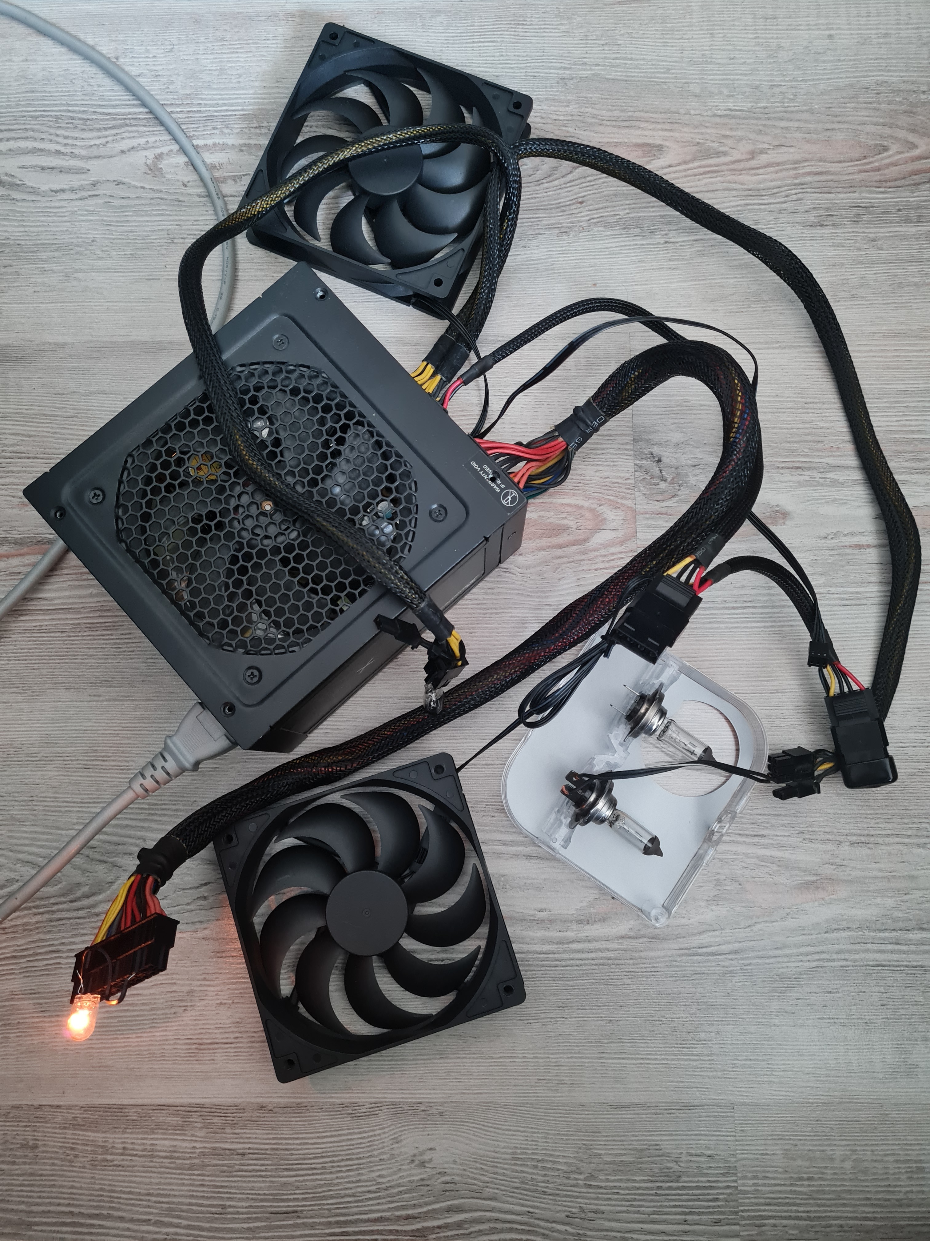

    Put a load on the PSU (like an HDD or two, or possibly more stuff, like a few 12V auto bulbs on the 12V rail) and try powering it on by grounding PS_ON signal. Does the PSU turn On normally? Can you do this a few times in a row both quickly after each other and spaced apart in time?
    Now repeat the above test, but this time, after you power on the PSU, put a load on the 5VSB rail - preferably something heavier that can draw at least 1 Amp from it. Now remove bridge between PS_ON and ground to make the main rails of the PSU turn Off. After this, pull PS_ON to ground again to see if it will start. What I'm trying to determine here is if the PSU can start when the 5VSB is loaded. All of the caps in the PSU appear to be reputable Japanese brands, so I don't think they would be the issue here. If you do have an ESR meter, though, perhaps it may be worthwhile to pull out and check the caps on the 5VSB output filter (the brown KZH caps close to the smaller transformer.)

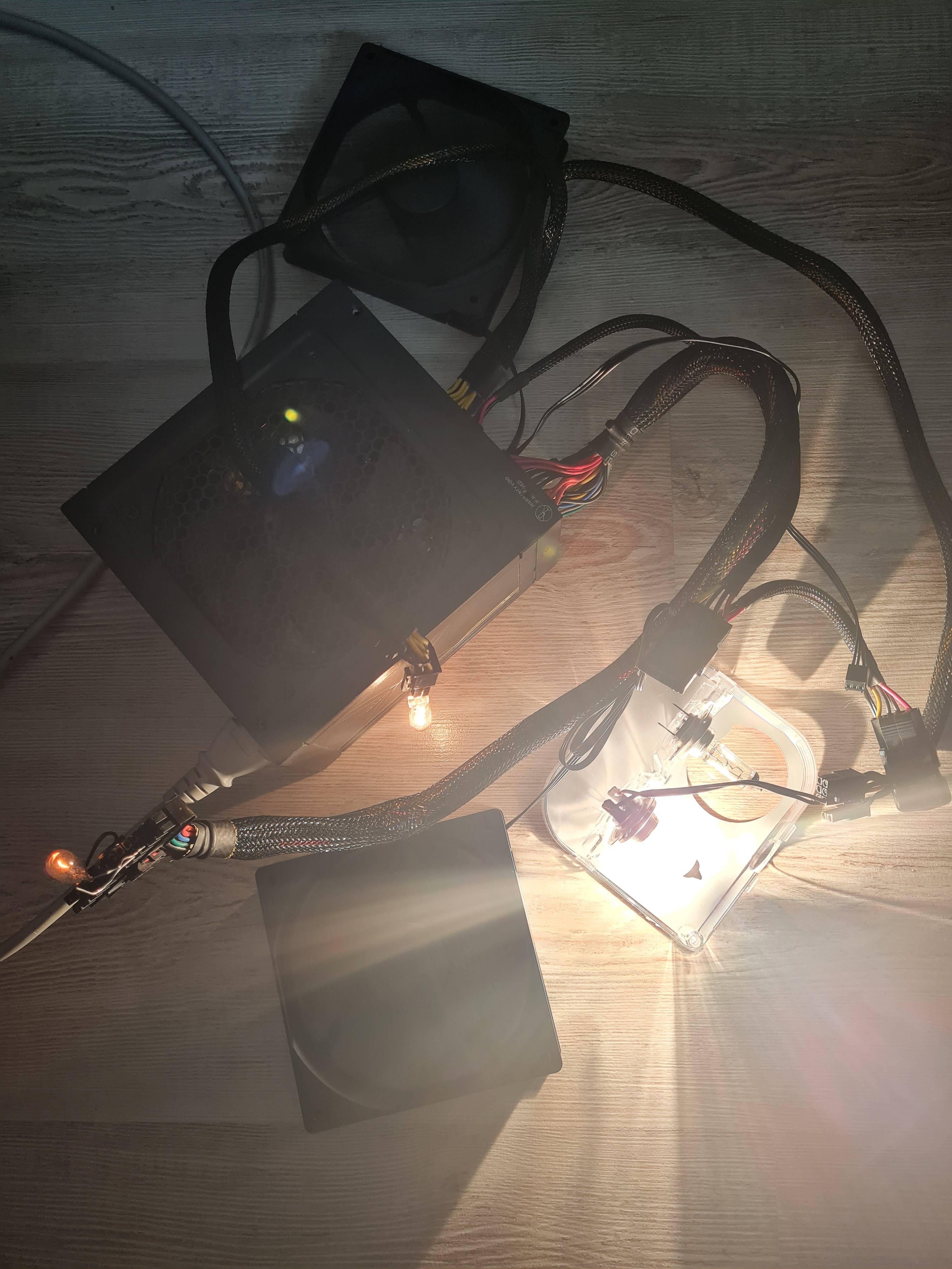

      I tried your first suggestion nothing on the 5VSB rail, the PSU started every time.

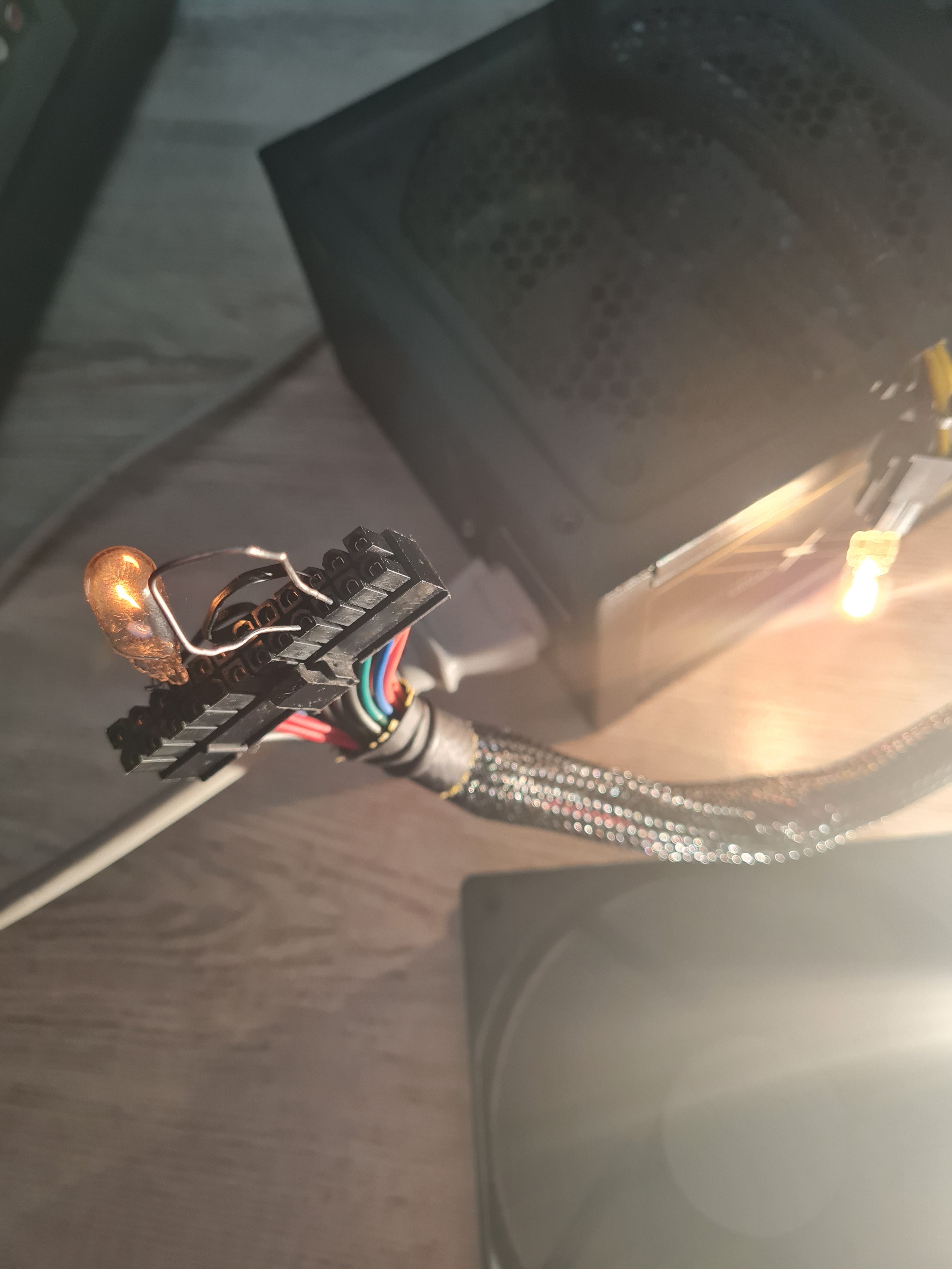

      Then I tried you second suggestion to put something on the 5VSB rail I only had a 12V bulb I think 5W, I put it on the 5VSB the light was dim but it emitted light and the PSU started every time again! (maybe the light bulb is not enough?)

          Yes, it's possible the load on the 5VSB is not enough to show if there are any issues. I think 12V 20W or higher bulb would be better (2x 20W might be enough to put 2 Amps on the 5VSB.)
