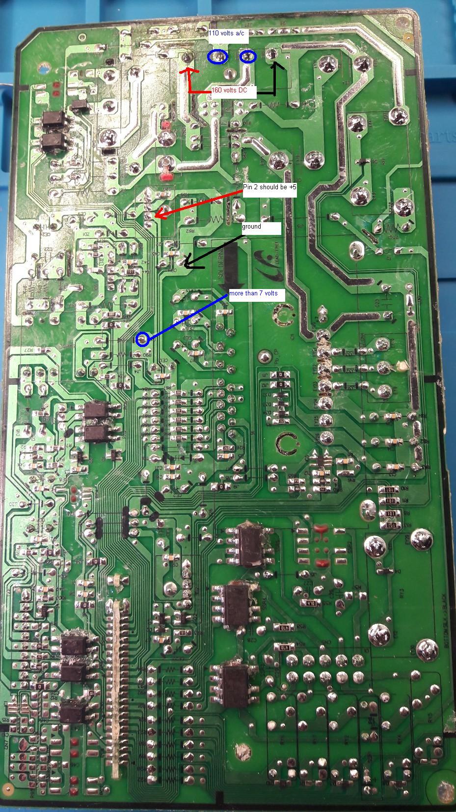

    The small fuse is ok , it is in the same trace as the door mechanism. Check this link :
    https://tweakers.net/ext/f/pM1cYoGVz...nBAOE/full.jpg
    The trace for the fuse is on the outer right side of the board and you will find F2 on top.
    Do you think this board is a double layered board? I saw a small crack near the small relays. The crack did not damage the traces , i checked it with a multimeter for continuity.
    So unless its a multi layered board the traces are all fine.
    There are no service manuals for these models right?

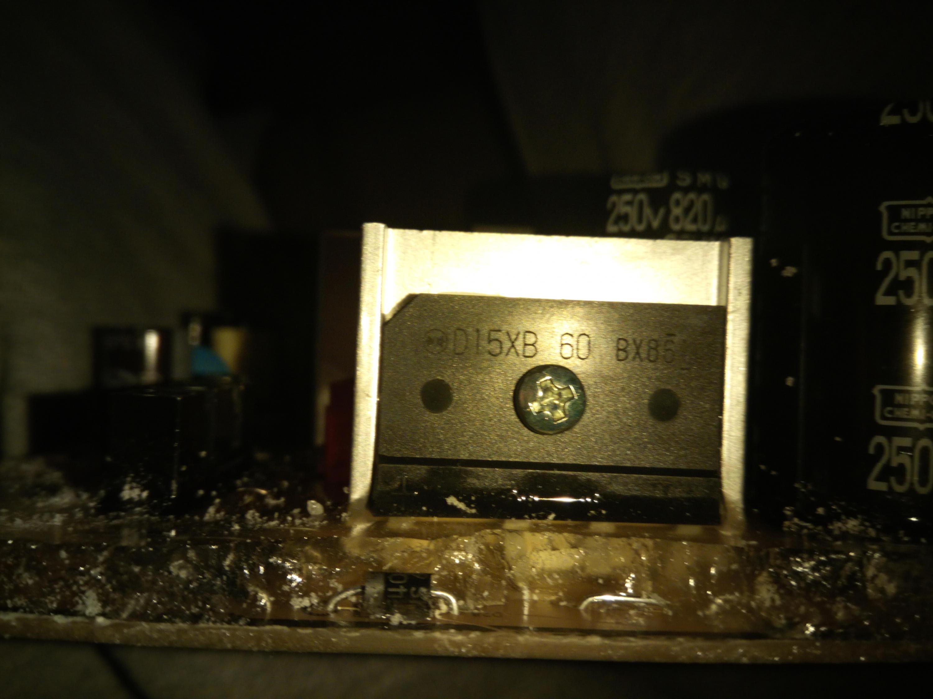

      The bridge rectifier is the ic on the heatsink left on the picture right? It has 4 pins. Ill upload a picture of the part.

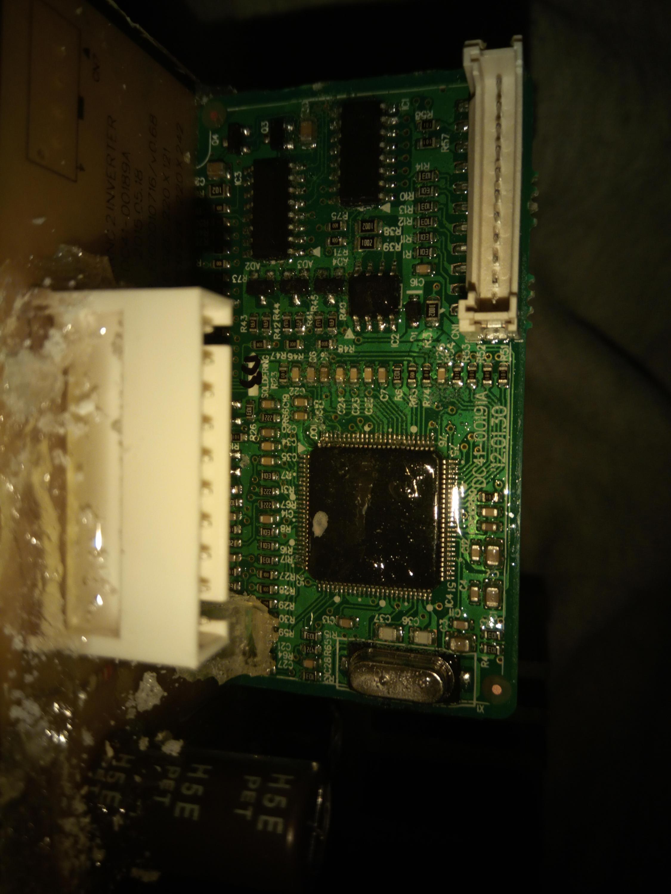

        Pictures of the parts.

          yes thats the bridge rectifier in the second picture, it will have a/c voltage on the 2 center pins and dc on the 2 outer pins. it connects to the 2 large capacitors and it supplies the voltage to the ipm, which converts the dc into 3 phase ac to drive the motor

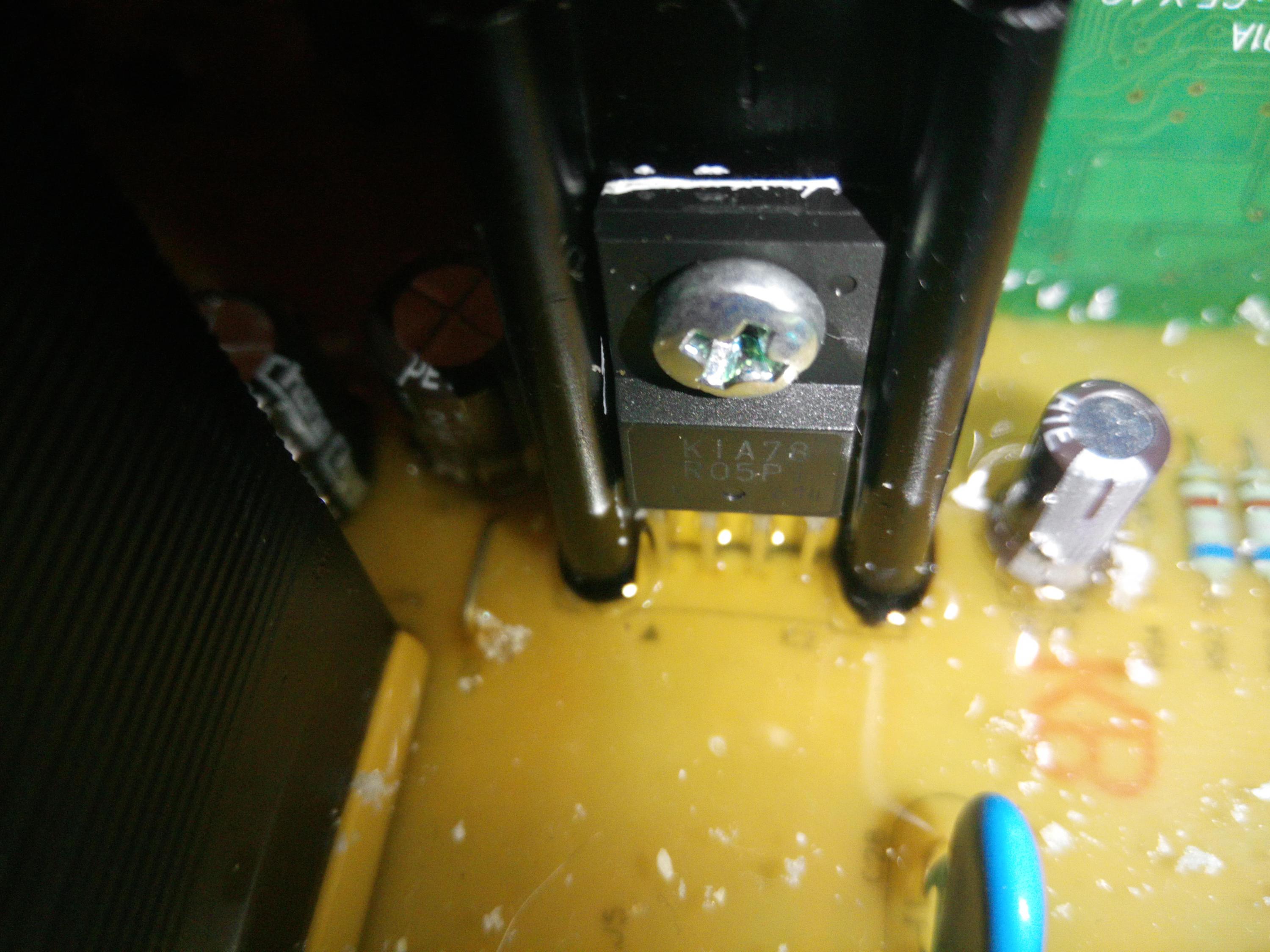

              Did you check that output and the On/Off control of the 4 legged 7805 when the washer does that weird thing?

                  Did you check the voltage on the voltage regulator ic?

                        So i measured the voltages on the rectifier. If you look at the picture above of the rectifier the voltages from left to right are : 48v dc , 110v ac , 110v ac , -57v dc.
                        I removed the plug from the white connector next to the big heatsink which you say is from the motor. It is going down into the machine so i guess its the motor cable. I measure +/- 3v AC on all 3 pins???
                        So its either the ic under the heatsink or the big relay that is not turning on the motor signal? What do you think?

                            to measure the voltage on the bridge you measure the a/c across the 2 center pins, then to measure the dc voltage out you measure across the 2 outside leads.

                              DC is 312V
                              AC is 230V ( europe ).
                              Diode measures 0V using ground from the machine. Voltage regulator measures +/-45V on pin 2. Also using ground from the machine.

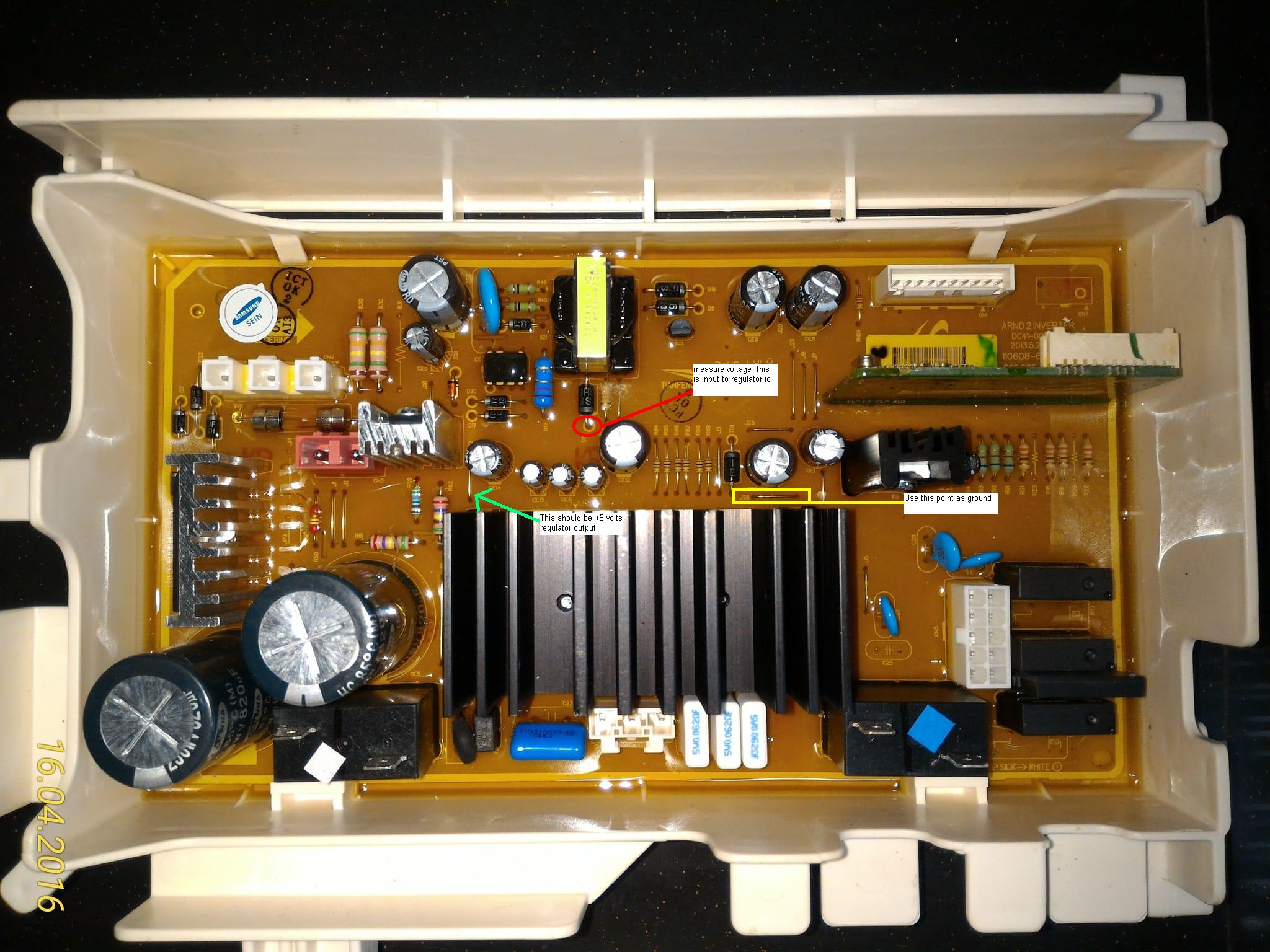

                                You CAN NOT use the machine as ground to measure those voltages. thats why they are wrong. that is a +5 volt regulator it should have + 5 volts on it, That voltage supplies a lot of the circuit, if it is missing nothing will work.
                                Use J26 (next to CE2) for ground,
                                Also check the solder on the pins of the smps transformer, they don't look that good in the picture but that might just be the lighting.

                                    "Voltage regulator measures +/-45V on pin 2." (on a 5 volt regulator?)
                                    You must be familiar with the difference between HOT and COLD ground in televisions
                                    Ever measure the voltage on the main filter cap in a smps using chassis ground.
                                    There are two (4 pin) voltage regulators on this board, are they both KIA78R05PI ? I suspect the one is a +12 volt regulator

                                      The other one is a KIA78R15PI , so it's a 15v regulator.

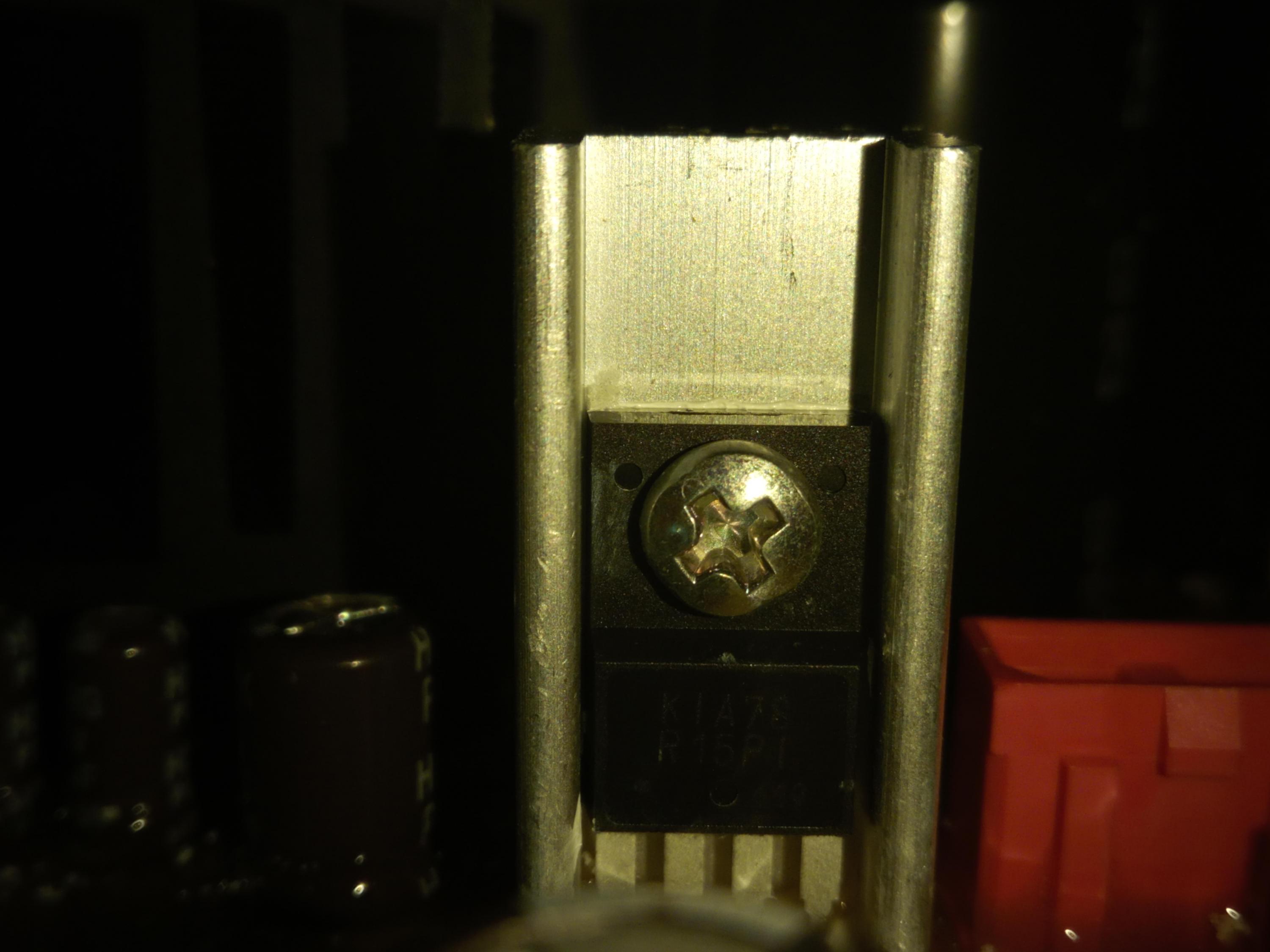

                                        The regulator you marked is a KIA78R15PI and i measure 12.3v using ground on the board. ( Got a fluke meter ).
                                        Datasheet says it needs to be 15v. So either they used the wrong part or it does not give enough output?
                                        To make sure i also measured on pin 2 , same voltage.
                                        The diode measures 17.3v on cathode.
                                        The other regulator near the ground marking is a 5v regulator.
