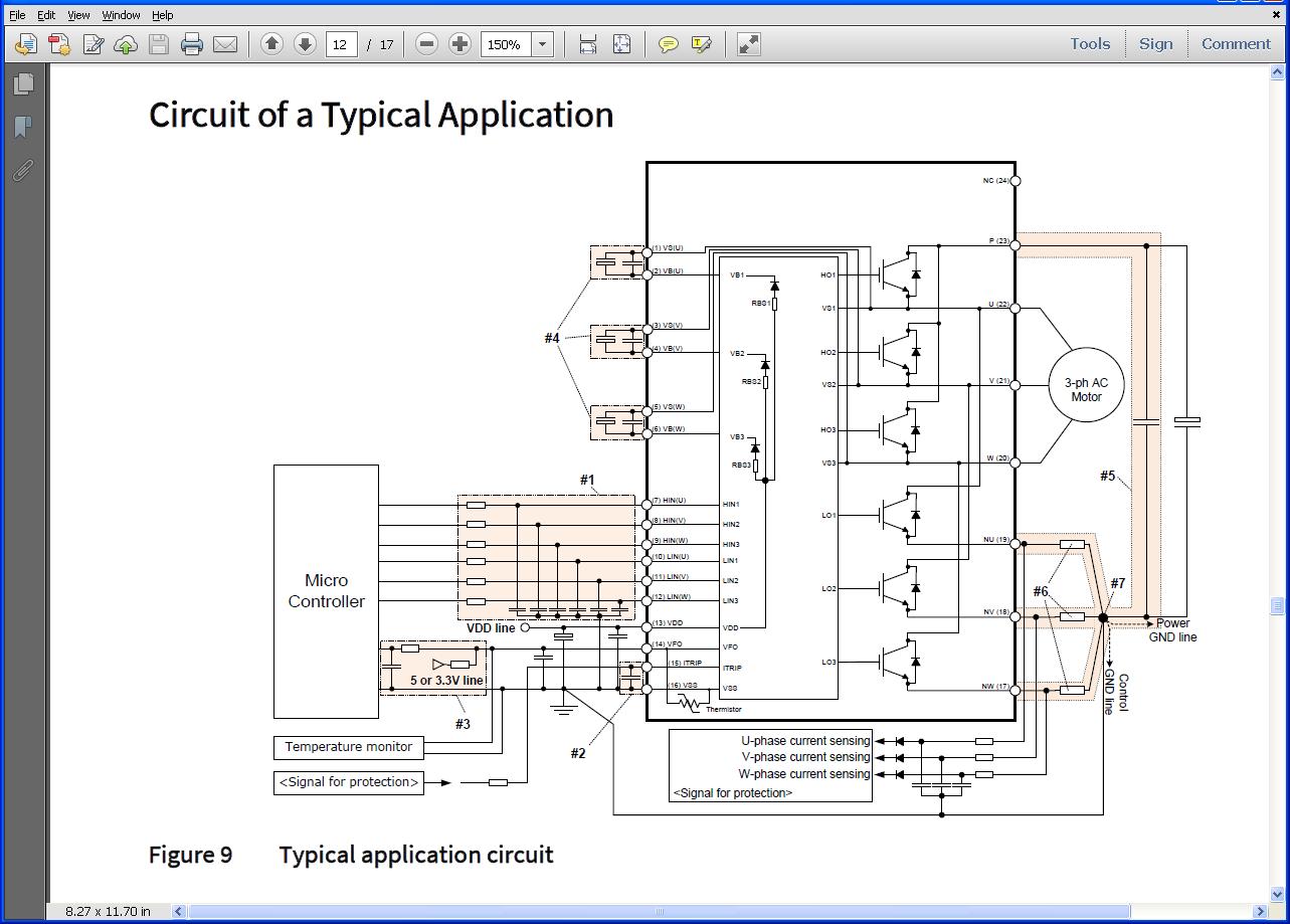

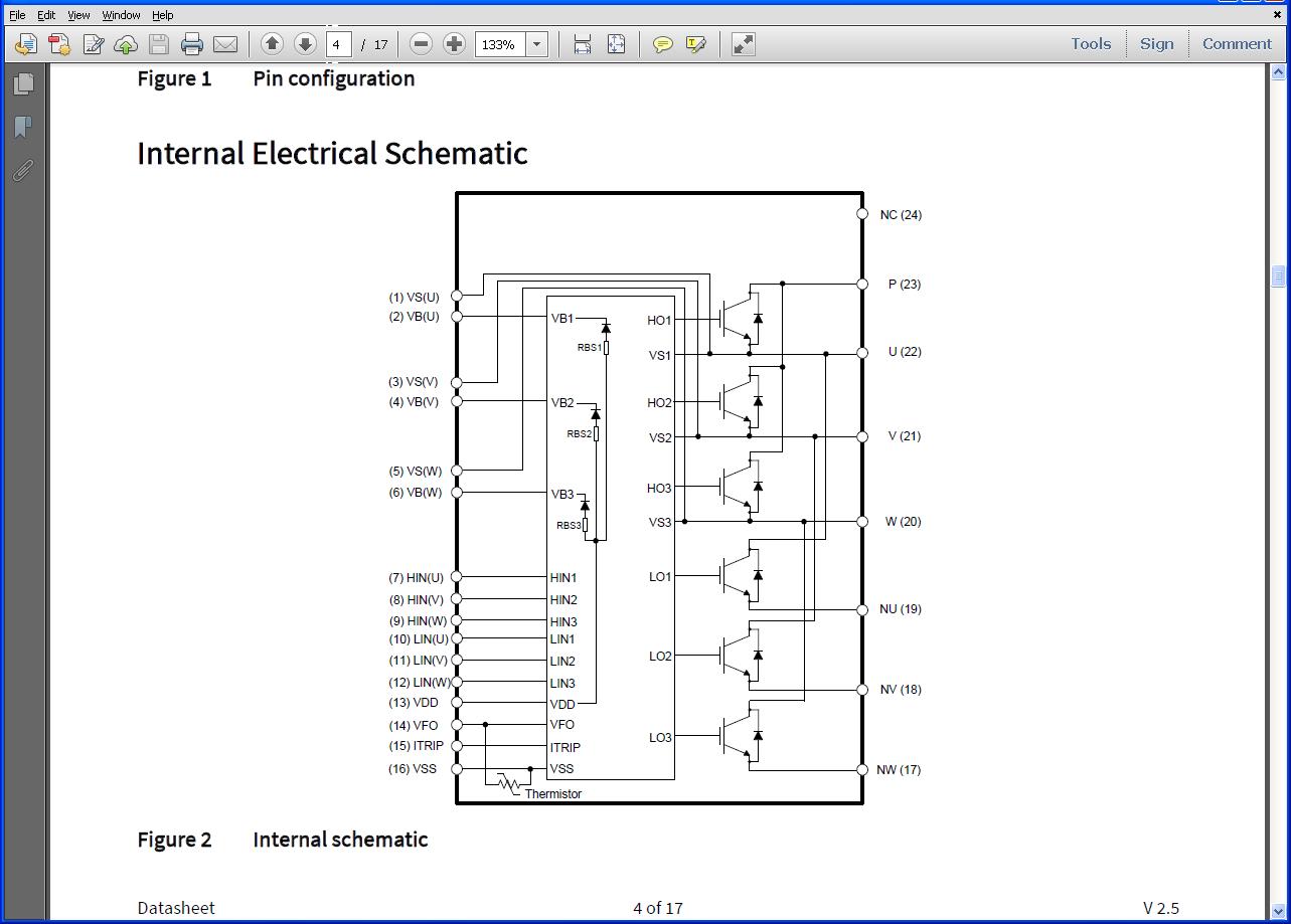

    I bet the problem is the (ipm) actually it is a CIPOS. I am going to take a guess and suggest you check that part.
    You should be able to diode test the output, check between P-U, P-V, V-W, W-NU, V-NV, W-NW. this should be the layout looking at the back of the board
    The voltage on the KIA78R15PI is a bit low and might effect operation, it supplies the low side control of the cipos ic, depending on what the part number is it should be around 15-16 volts

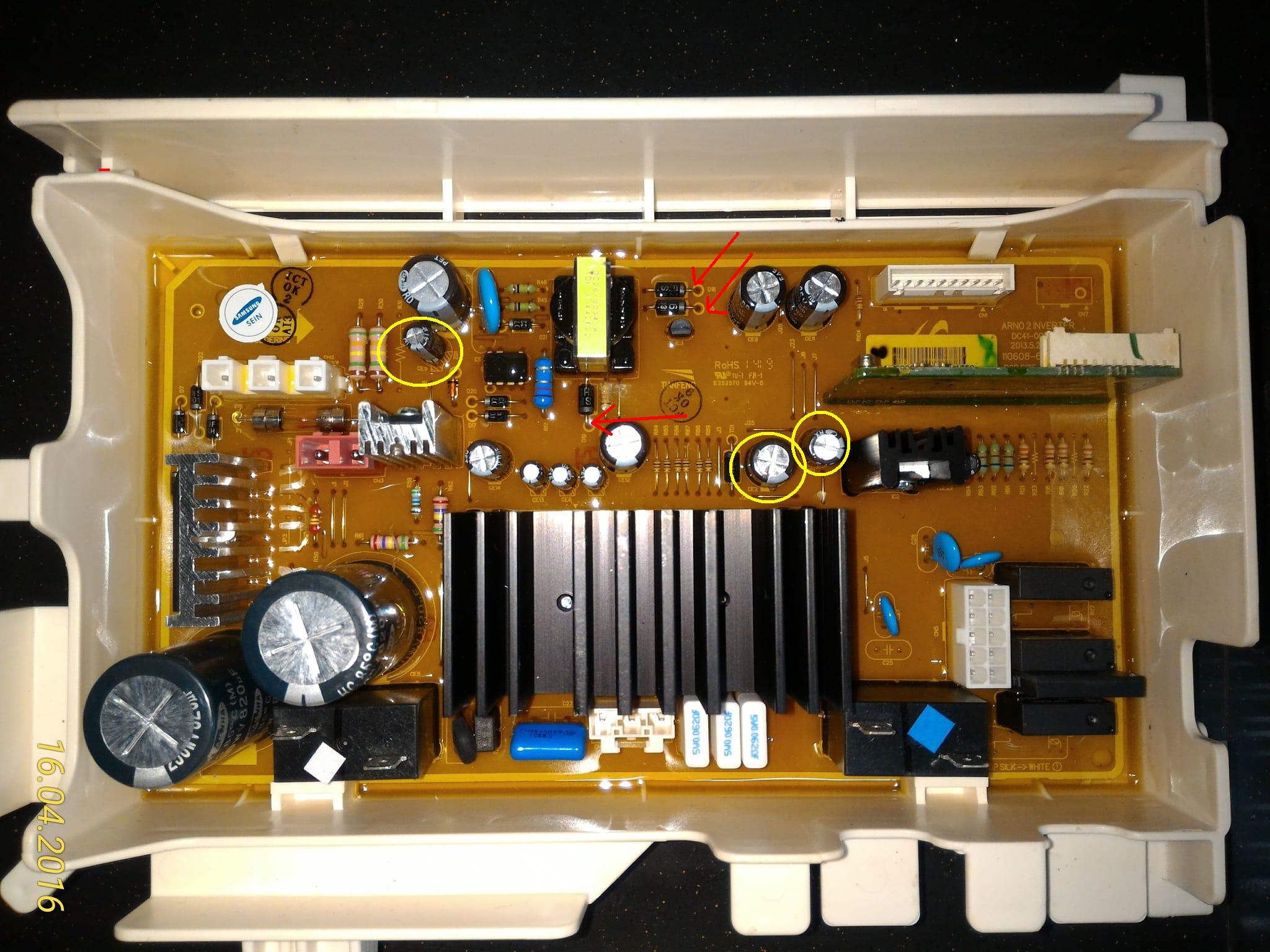

      I took the gamble and heated up the topside of the board with a heat gun with most heat going to the capacitors. The voltage on the regulator changed from 12 to 13.5v and its now running a program. Im waiting to see if it finishes the program.
      The regulator has to be 15v , i measured on the good board.
      So either because of heat the board expands and fixes a loose connection OR the heat charges for example the capacitors or spool?
      What do you say?

        Check the input voltage to the regulator and see if it changes when heated, I believe the cipos ic requires a minimum of 14 volts, 12 would be too low for it to operate.
        There are 3 diodes that supply voltage from the transformer the one you measured before supplies the regulator ic, the other 2 are D5 and the one beside it, check there voltage also.
        The cap CE9 in the primary could be bad and it would effect all the output voltages, the other 2 I circled are the input and putput oc the 15 volt regulator ic. I marked with arrows the output voltage test points

          Thanks for the pictures , helps people in the future.
          It did not finish the program because the voltage went down to 13.2v. I heated up the board again and just in the area of the small caps. The diode voltage goes from 17.3 on cold start to 16.9/17 when heated so the input voltage goes down. It looks like its stabilising if that makes sense.
          I got it eventually to 13.6v and it ran the motor again.
          Funny thing is that the voltage is fluctuating when it goes below 13.5v because it tries to start the program and "pulls" down some component.
          The upper right cap that is marked in the picture above is not standing straight on the board like all the others. Maybe the silicon pulled the capacitor out because of vibration?
          I got the caps so i can swap them?
