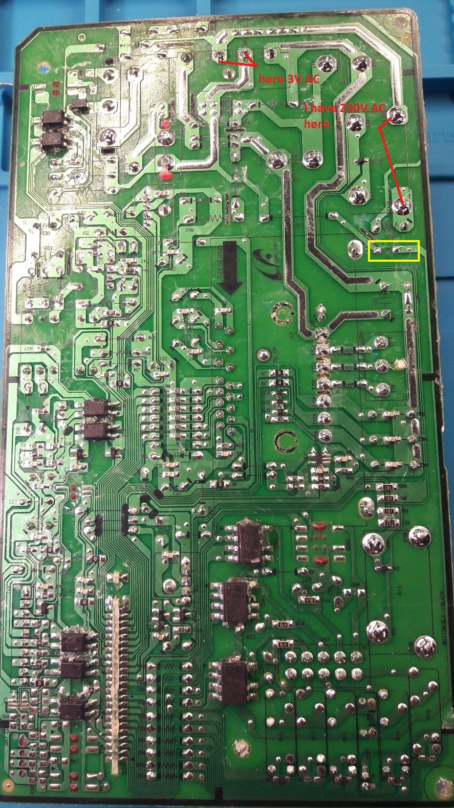

    Hi, I have similar problem, so I will not open new thread. First of all sorry for my bad english.
    So, I have same washing machine with same mother board. My problem was same as Moreno83 so I decided to resolder all joints. I made so stupid mistake, used flat screwdriver to clean silicon from the bottom side. During cleaning I shorted something (small spark was visible), didn't remembered what it was. Now washing machine is dead , no power at all. I replaced both KIA78R05PI with KA78R05CTU and KIA78R15PI with KA78R15CTU. I also replaced all 7 optocouplers. I have 230V on relay but on bridge rectifier middle pins is only 3V AC. Any help is useful.
    Thank you!

      I attached photo to previous post but it doesn't show it, so here is the link of a photo.
      https://imgur.com/a/R5qFFkH

        Re: Powersupply washingmachine. Relay problem?
        There is a small (black) square fuse near the large heatsink labeled F2, check it, If you are lucky thats all that's blown.
          Both fuses are ok :/
            Solved, one smd jumper was demaged. R_J thank you for the replay
