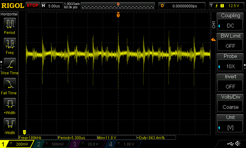

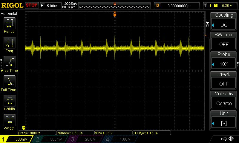

    What currently doesn't like is the spikes on 12V and 5V buses. Please see the attache files.
    What can be the reason for such spikes? Main big filter cap? It is CapXon 470uF/420V and its value is also OK.

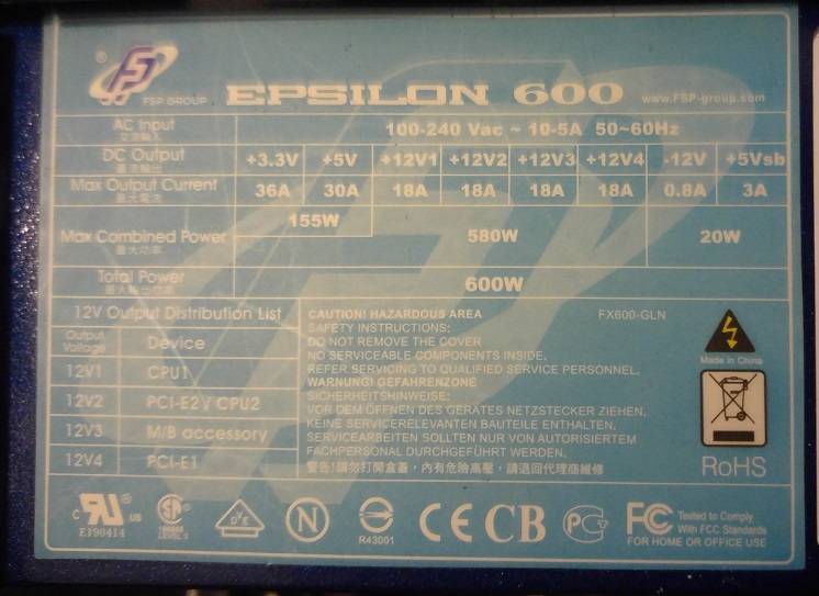

    i recommend u post photos of the inside of the psu and where that small cap is located inside the psu.
    we need to see if its a group regulated design. from the power label u posted, it looks like it could be. if so, if u use a 12v hungry cpu and gpu, the 12v rail will sag and the 5v and 3.3v rail will go high. u need to load all 3 rails at the same time to keep them within spec.

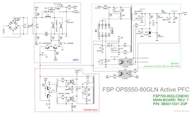

      Thank you for the reply. The attached schematic is very similar to my PSU.
      The replaced cap was C15, which in my case was 100uF/25V.

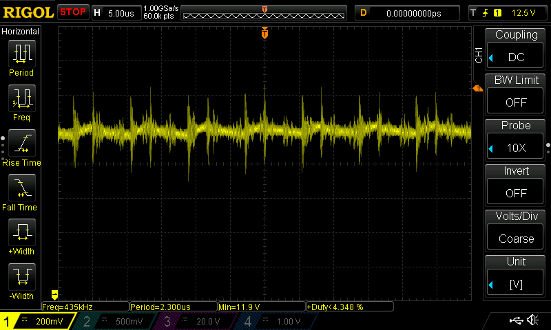

        I replaced all caps, but the problem is still here - big spikes on all rails, with load and without. What is the usual voltage on the main filter cap? Currently is 400V.

          leave the 400v cap alone, it's not related to 200KHz spikes with what looks like some kind of resonant echo.
          check the output diodes and snubber parts.
          and what caps are you fitting??
