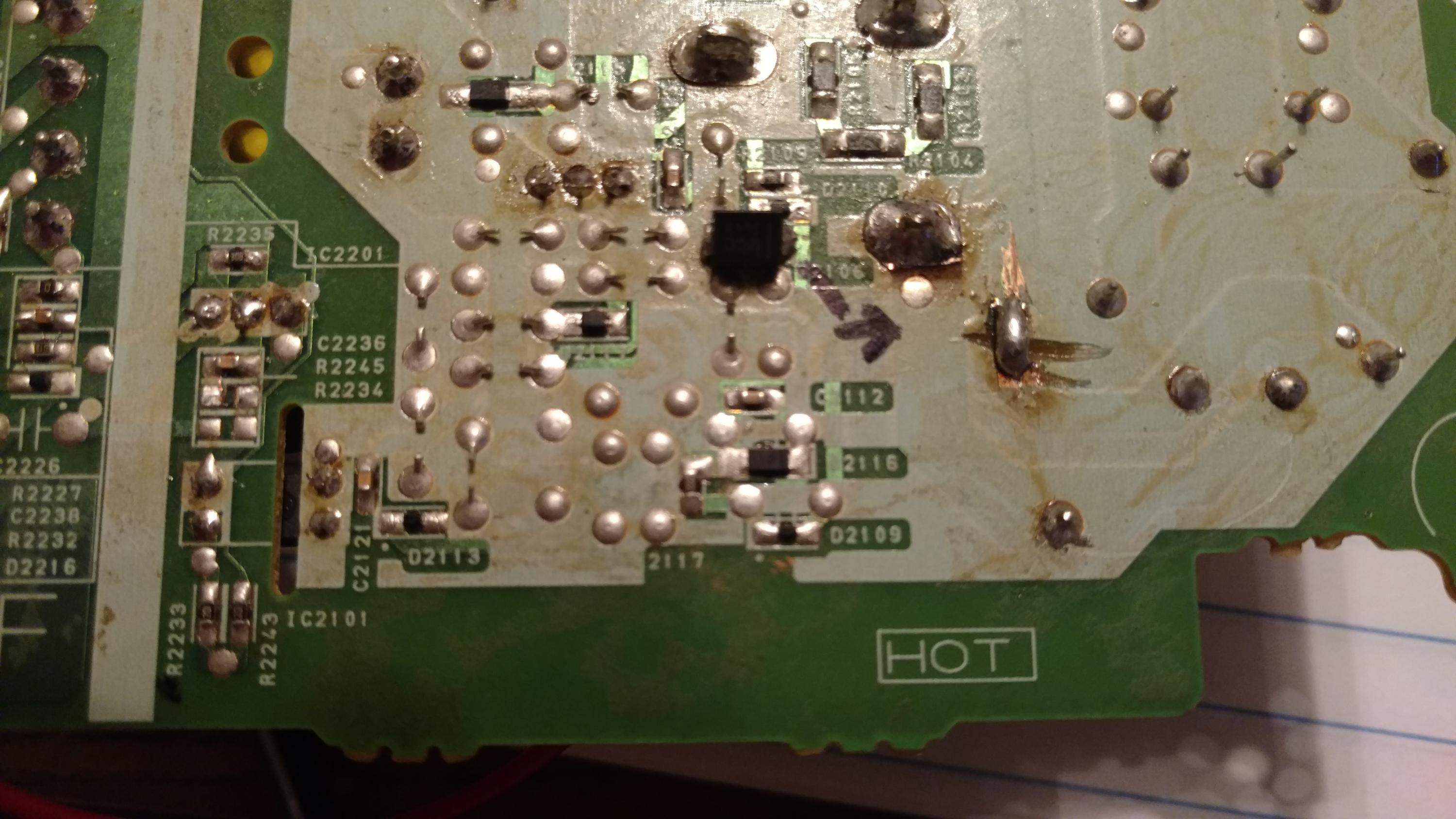

          Zener diodes D2108 D2111 D2117 D2197 are missing from my board. They are printed on the circuit board, just not there.
            That doesn't quite make sense, because in post #64 you mentioned this:
            Originally posted by johnfin
            I checked those components, caps and diodes are large in size and easy to check. What I have been trouble checking is the small diodes on the bottom left of the schematic. D2108, D2109, D211, D2113
            So D2108 and D2109 should be there, according to that earlier quote. Also, I don't see diodes D2117 and D2197 on the schematic. What would these correspond to from your power supply?

              Cant test them because i cant find them. Lol. See pics. D2108 is missing, D2109 on bottom. 2197 is typo, sb 2107, see pics. I looked at pdf schematic, you make it look simple and while the schematic is simple, integrating that circuit into what i have is another story. If i could get that to work, a bunch of people would be thankful because the original design is junk. Can you explain how that circuit splices into what i have.
