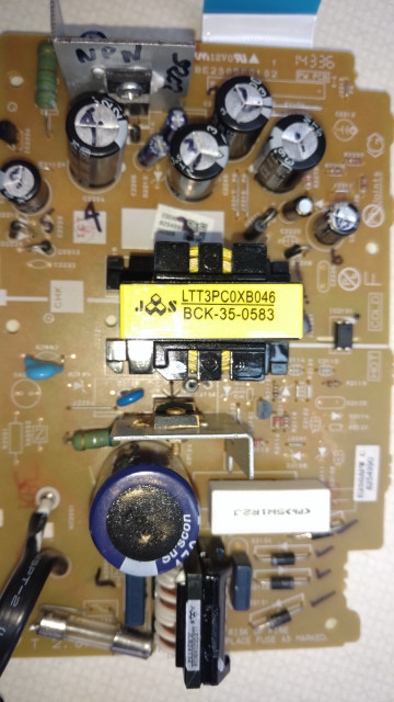

Should i check all of those tiny parts on the bottom of the board?
It wouldn't be a bad idea.
But I suggest starting with the main switching transistor on the primary side first (the one attached to the heatsink) and also everything directly connected to it. The fact that your light bulb stays lit means either that transistor is faulty or whatever is driving it is faulty, making it stuck fully turned on all the time when it shouldn't be (it should be switching at a high frequency.... hence the name switch mode power supply or SMPS for short).

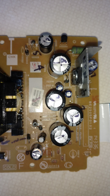

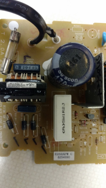

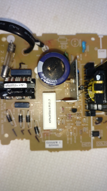

If you provide bigger pictures (ones where we can actually see the board designators for all of the parts), we may actually be able to give you more detailed instructions what to check and how to check it.
MOSFET is fine. Must be a tiny part on bottom or tranny because I have checked all of the other parts.

So you have a fault somewhere else, that is for sure. Now the pictures you provided are still way too small for me to be able to trace anything, so I can't tell you if that 2-transistor oscillator circuit actually has self-limiting circuit to prevent the main transistor from getting stuck ON. Thus, I suggest replacing the optocoupler and 431 shunt regulator on the secondary side if you have some spare ones.
Funny you should mention that, did it, opti and all 431's. Pulled all caps and put them on an esr and sprague tel-ohm. Both the mosfet and NPN are fine. Next to the diodes again. Been down this road once and again the last part left is the tranny.
Possible good news. I think I found the bad part. Fingers crossed. It was one of the last transistors in the primary side. to-92 case. C3032. It tested ok before with a b&k transistor checker but I dont trust the machine now. I used the multimeter and he transistor is no good.
Well, no luck, the new transistor did not work. Bulb still bright. It either the tranny or the small parts on the bottom.
Well, you only have like 15 SMD parts on the bottom side, and most of them appear to be resistors with a few diodes and ceramic caps, so that shouldn't be too hard to test. Ceramic caps and diodes you test for short-circuit (bad) and resistor test for open-circuit or abnormally high resistance (may have to remove some of them for the measurement, though).

Its closer to the mdr515 schematic, not exact though. I need some help diagnosing this thing. Can I put a signal tracer on the transistors, and mosfet to see if it is switching? I would like to check it out when the power is on and bulb on. As far as the small parts on the back of the board, some are micro transistors, not just resistors and diodes. I was told not to remove the transformer yet when I did the short went away so how about this, cut some of the output lines on the transformer that dont return to the primary side so I can try to isolate the problem.
