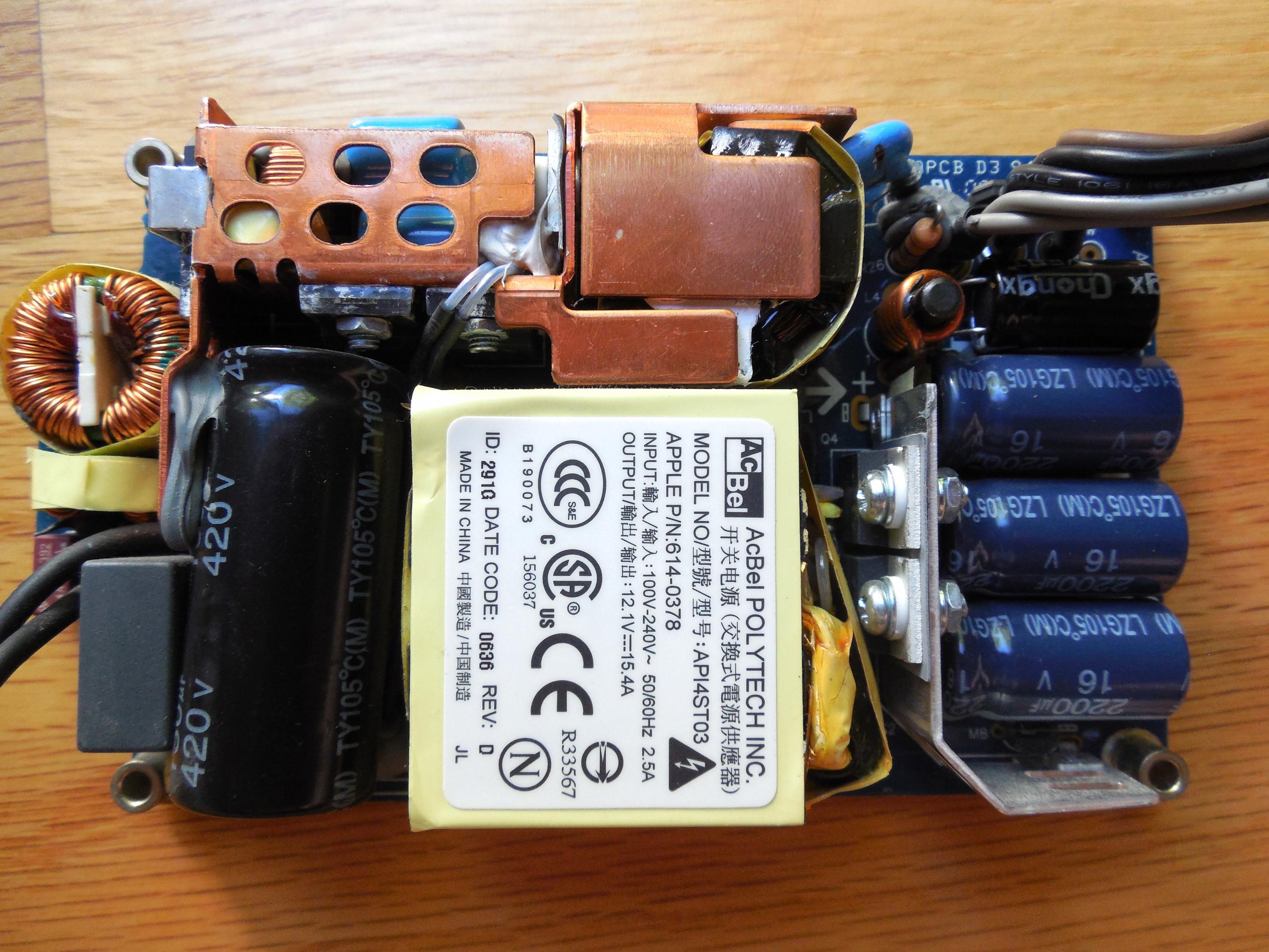

    PSU = AcBel API4ST03. Pic attached.
    iMac automatically attempts to boot without pressing power button when power cord plugged in. LED1 is on, LED2 flashes on briefly every few seconds along with HDD and ODD fan kicking just slightly. LED3 never comes on. ODD makes no noise, HDD is removed. This pattern repeats indefinitely. Known good PRAM battery installed, PRAM reset performed. I understand we have trickle power with LED1, LED2 shows logic board is attempting to start and failing every few seconds.
    PSU makes a 2 noticeable sounds
    - Buzzing sound whenever power cord is plugged in
    - ~2Hz clicking/arcing sound if PSU is disconnected from logic board (either at the 5 pin PSU output connector or the 2x7 logic board connector) Sound file is here https://drive.google.com/file/d/0Bwn...ew?usp=sharing
    - Disconnect the Inverter board makes no difference on the sounds or boot pattern
    - Can't really isolate which component is making the buzzing or cycling noise.
    PSU output measurement shows 12V on both grey wires. 0V on brown
    PSU did have 1 bulging cap (1000uF 16V). I've substituted with some cheap Chinese cap (1000uF 25V, black color next to output wires) I have for now (I've read this forum and know I should get better caps) But for now PSU doesn't behave any differently before or after this cap replacement.

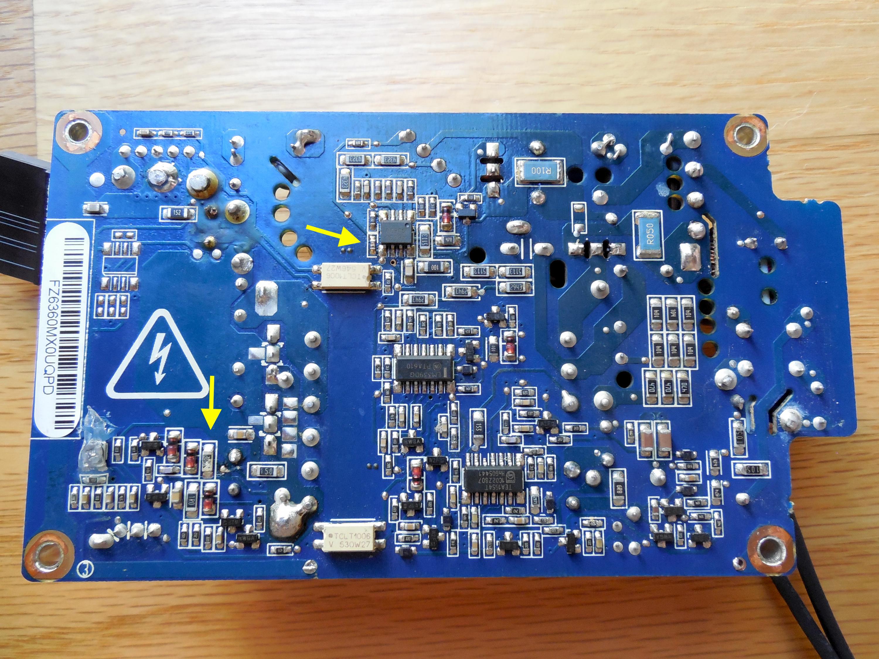

    Couple of resistors have blemishes on top. See yellow arrows on the pics. Just to the right of the lower left arrow is the 2 solder points for one of the blue caps with some blemish between. Looking at the capacitor legs from the other side, I see no sign of leaks.
    I guess here is my question
    - Based on the LED patterns + 12V PSU output, and noisy PSU, is the problem further downstream in the logic board or could still be the PSU?
    Thanks for any thoughts in advance. My knowledge is digital+computer science guy so analog+power supplies are beyond me

    For starters, recap the unit with proper caps. Trying to diagnose it with failed caps will leave you with bruises on your head...
    The ticking sound is the switcher trying to start, failing, and restarting.
    These need a little bit of a load to run correctly.
    Place a small 12V lamp or two across the 12V output. Automotive 194 marker lights would be best.

      The resistors in your pics -
      Upper - 33kΩ marked 333 -> Reads ~27kΩ one way and ~33kΩ the other
      Lower - 27Ω marked 270 -> Reads 270Ω both ways
      Don't miss the 2 tiny caps under the Mains cap. They are:
      Outer: 68uF / 25V / 6.5mm X 12mm / 105°C - Ltec TK series
      Inner: 22uF / 50V / 5mm X 12mm / 105°C - Ltec LZG series
      Both should have an ESR around 1.2Ω to 1.6Ω.
      The Mains cap should have an ESR around 0.2Ω.
      150uF / 420V / 18mm X 40mm / 105°C - Ltec TY series
      PDFs attached.
      Ltec product link: http://www.ltec.com.tw/product_e.html

          That ChengX cap looks fake, I don't see a series anywhere, if that is real it should say CD110 or KM on it (likely). Either way that's not a low ESR cap, so don't use that.
          Also, clicking could be it trying to start, but the cap responsible for that may have gone bad. Look for a small cap near the transformer that's gonna be very small, something in the region of 22uf 50v, etc.

              It could be failing to start due to the start-up cap (common with 384x PWM ICs). It could be a shut-down-and-retry current limit trip due to something shorted in the secondary. If the power supply has an OVP crowbar, either a shorted SCR or the PWM going full pulse width could cause this with shut-down-and-retry current limit.

                You can test the small startup cap in a cheap way (As Toasty said a replacement on eBay is only $20).
                Find a hair drier with color of your choosing, then heat the area that Toasty described in post #3
                (main filter capacitor, the startup caps are located under it).
                Heat it up to at least 50°C or so but don't go crazy above 100°C...
                Then try starting it, if it starts then replace the small startup caps.
                And of course all the output caps because if one has leaked all are going to go soon anyway...
                Rubycon YXH would be an excellent replacement for those. (But not from eBay, most there are counterfeit!).
