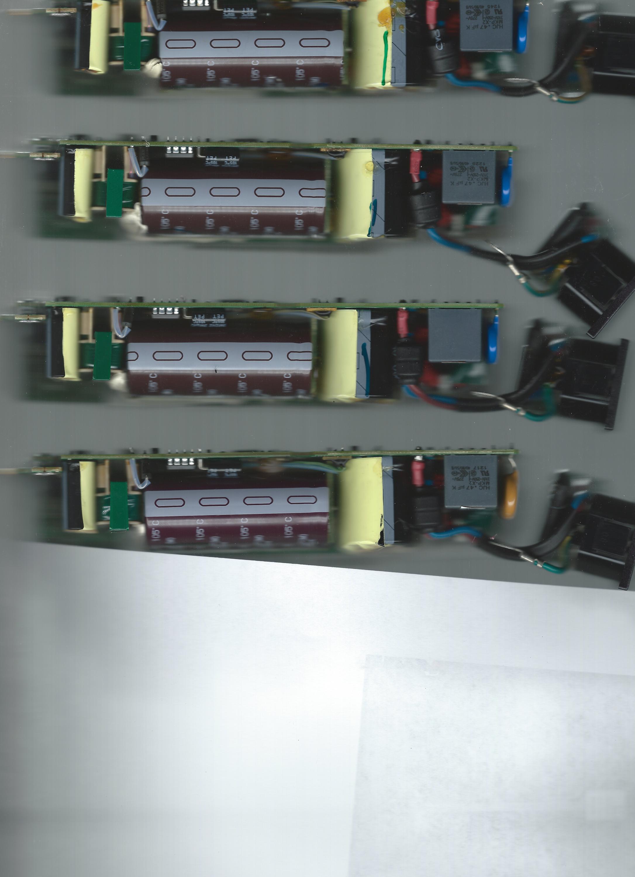

    Hello
    I have 15 failed power supplies, all Emerson AA27020L units. At $400 a pop to replace they are starting to get a bit expensive. These all failed in the last 6 months so I am starting to think there is some common failure with them. Does anyone have any info on them and why they fail so I can take a shot at repairing them. I haven't seen much on the net about them but I suspect someone somewhere knows something about their secrets..
    TIA
    Mike

    Re: Emerson AA27020L Failures
    post foto's & stuff - upload them here, no linking to other sites!
      Sure thing.. I can take some thorough photos and upload them. I have good and bad psu's does it matter if I take a pic of a bad one or a good one? I opened a bad one and don't see any apparent issues visually.
        • 31248
        bad ones please

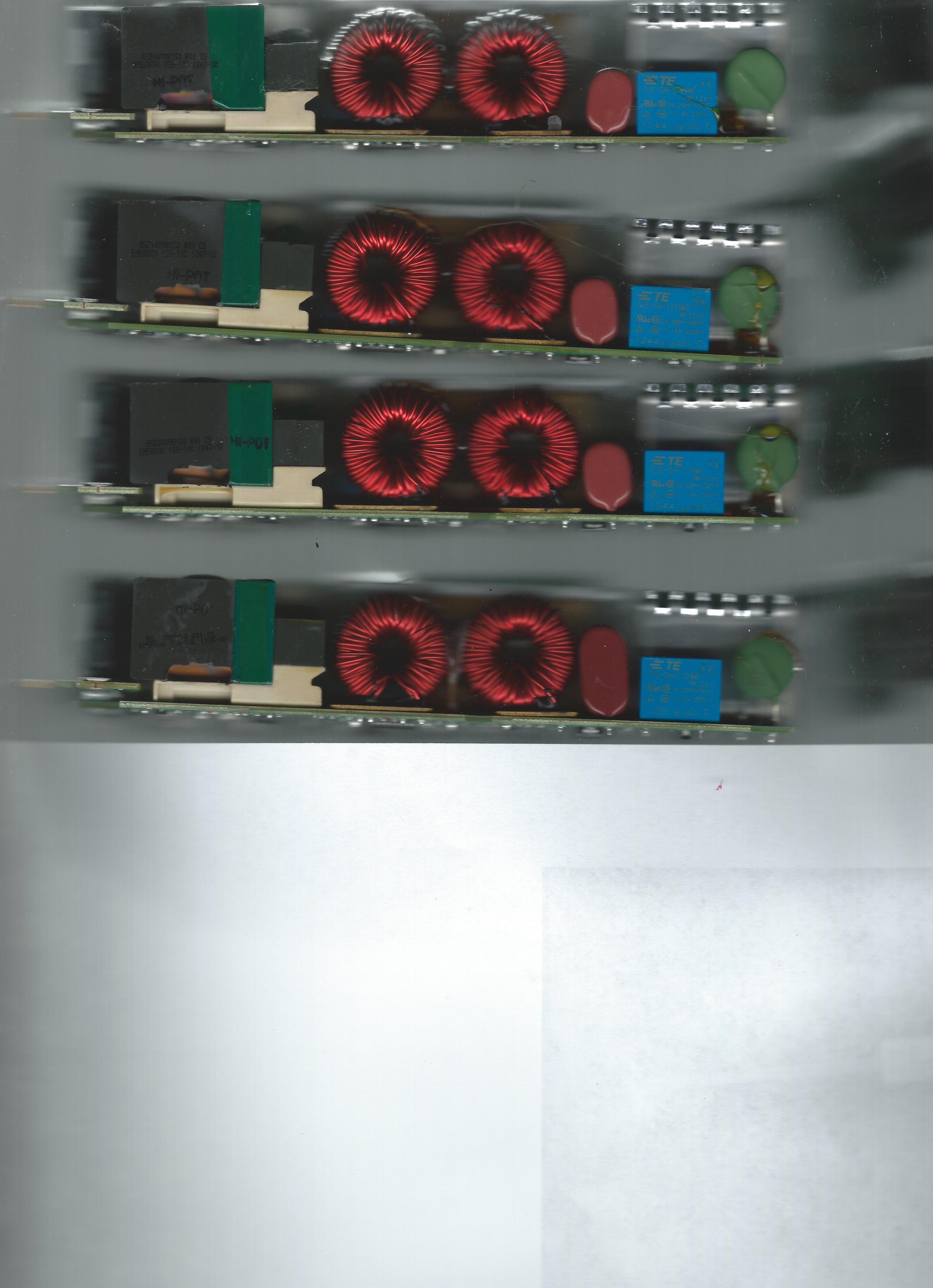

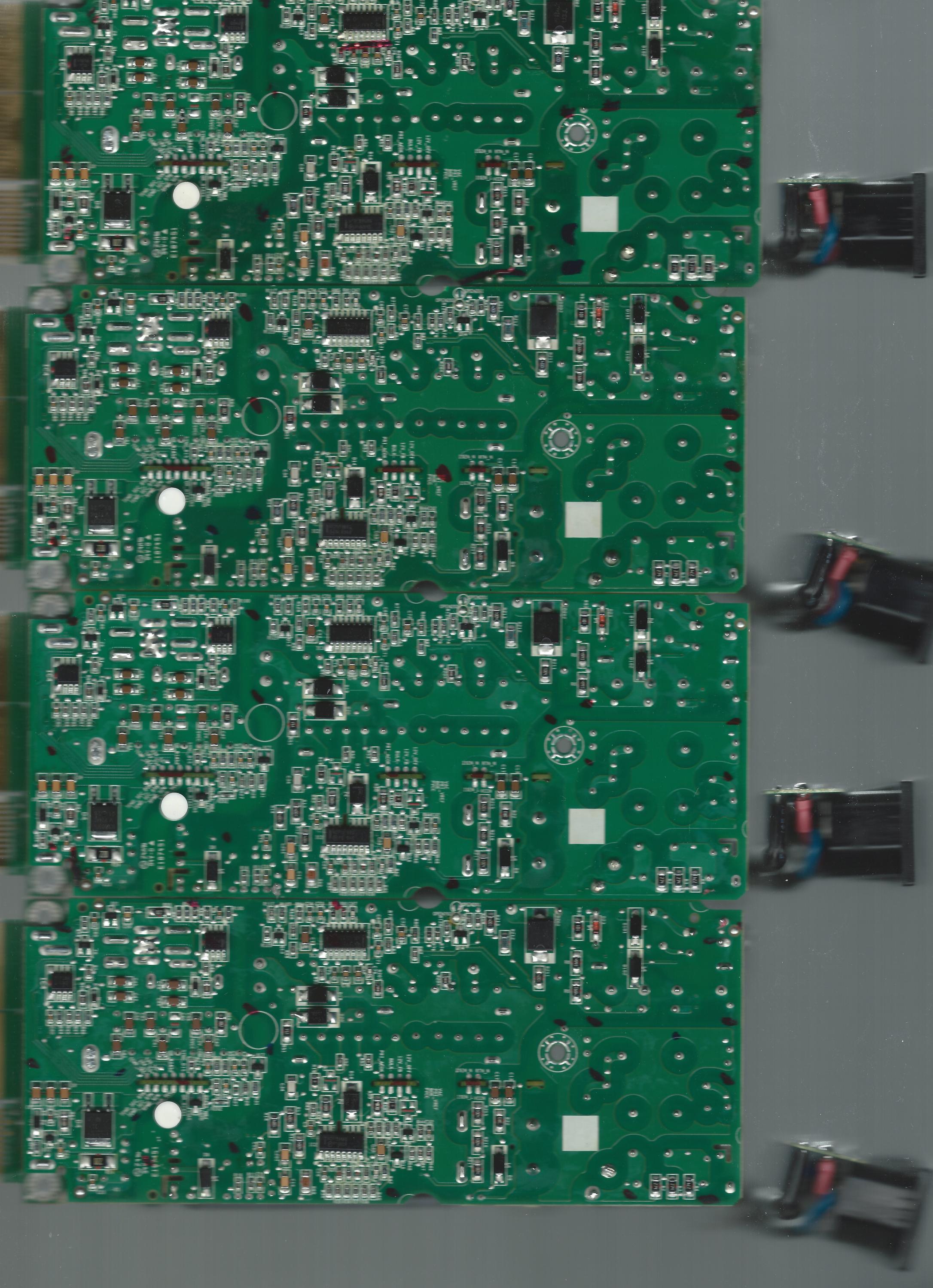

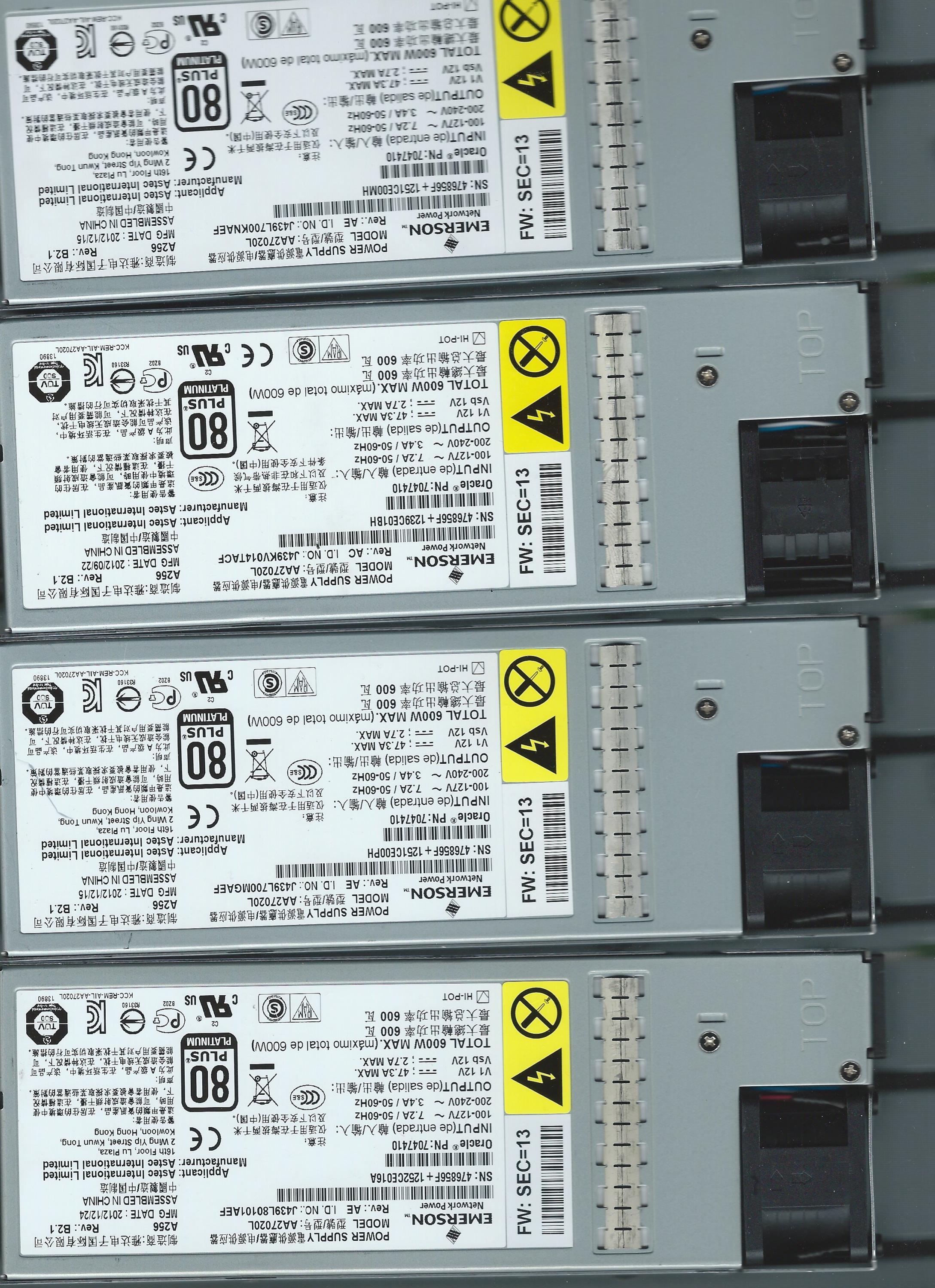

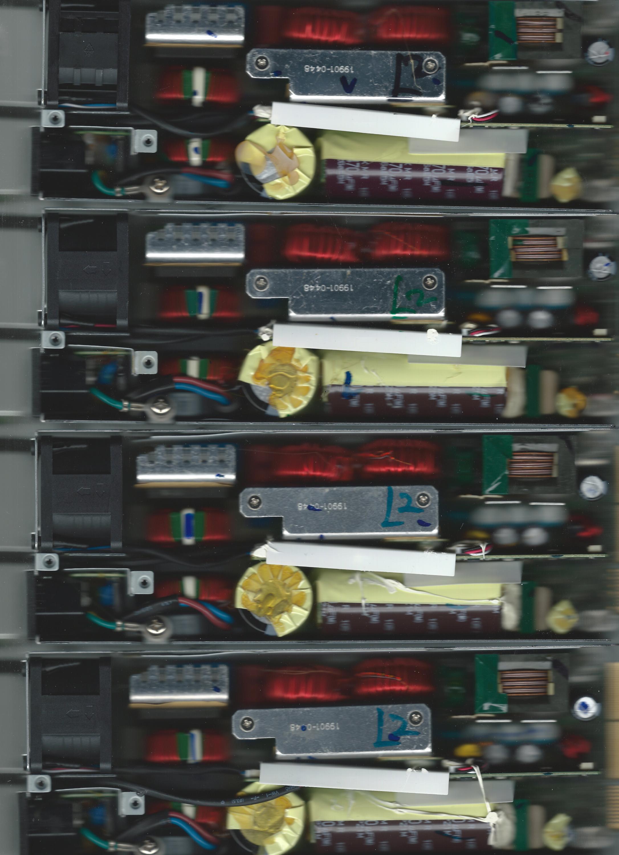

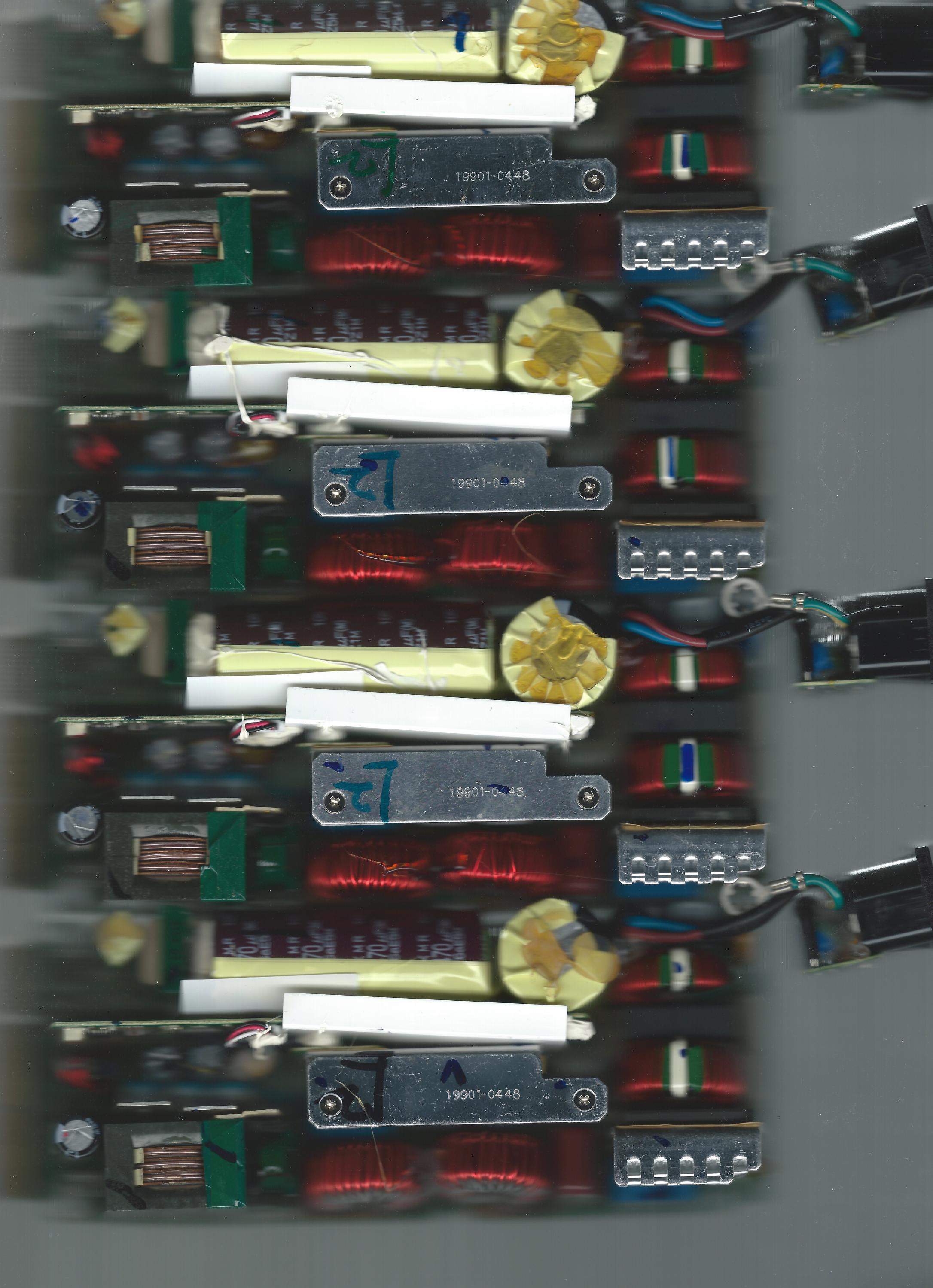

          Pics below of 4 different units.... Let me know if I missed anything.. Or if you need a 4K picture of one view.
              Adding a little to c.c's post above, it should be OK to power those on with no load. Look for the 12VSB pin and see if you have the standby voltage. That's a server PSU, of a type with a 12V standby voltage. I think the pin will be a single "finger", on the side opposite from the label. Also, look at the voltages on the other single pins, as you might see internal 5V or 3.3V housekeeping voltages. The chassis will be ground.
              Then, as c.c said, check the voltage across the big 450V rated electrolytic capacitor. If the PFC is working, the voltage should be around 400V. If the PFC is not working and your input voltage is 120VAC, then the voltage across that capacitor will be around 165V. Make this measurement carefully, as that is on the primary side. You do not want to short anything to the chassis, and you want to be careful for the sake of your safety.
              So, the first things all this checks are the Standby circuit and the PFC. If the PFC doesn't work, everything after it will be shut down. If the Standby circuit isn't operating, nothing will, as that provides the primary and secondary housekeeping voltages necessary to operate everything in the PSU.
              BTW, do pictures of just one PSU. Doing four at once just makes everything smaller, resolution for each PSU is worse, and the lighting is not optimized for any one PSU.
