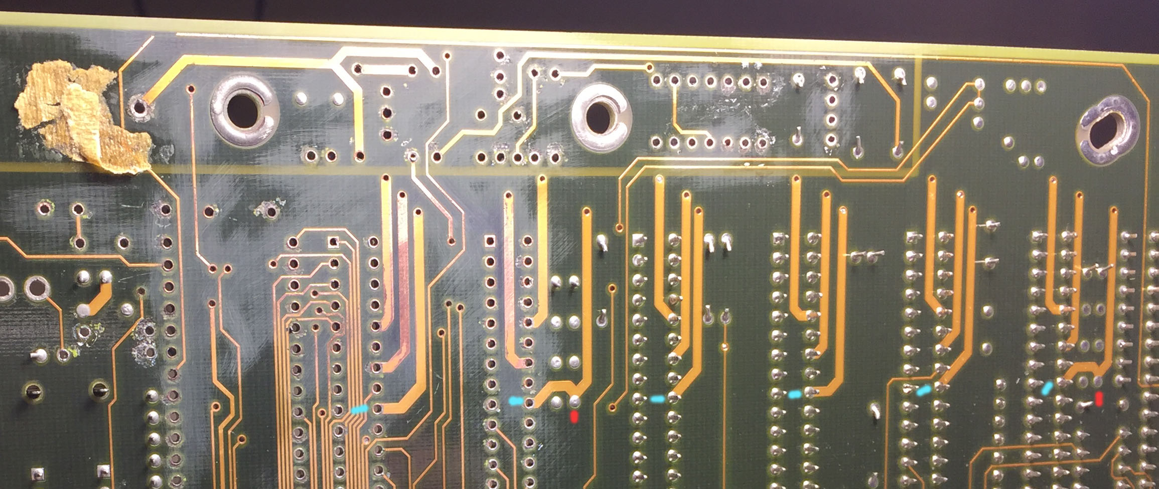

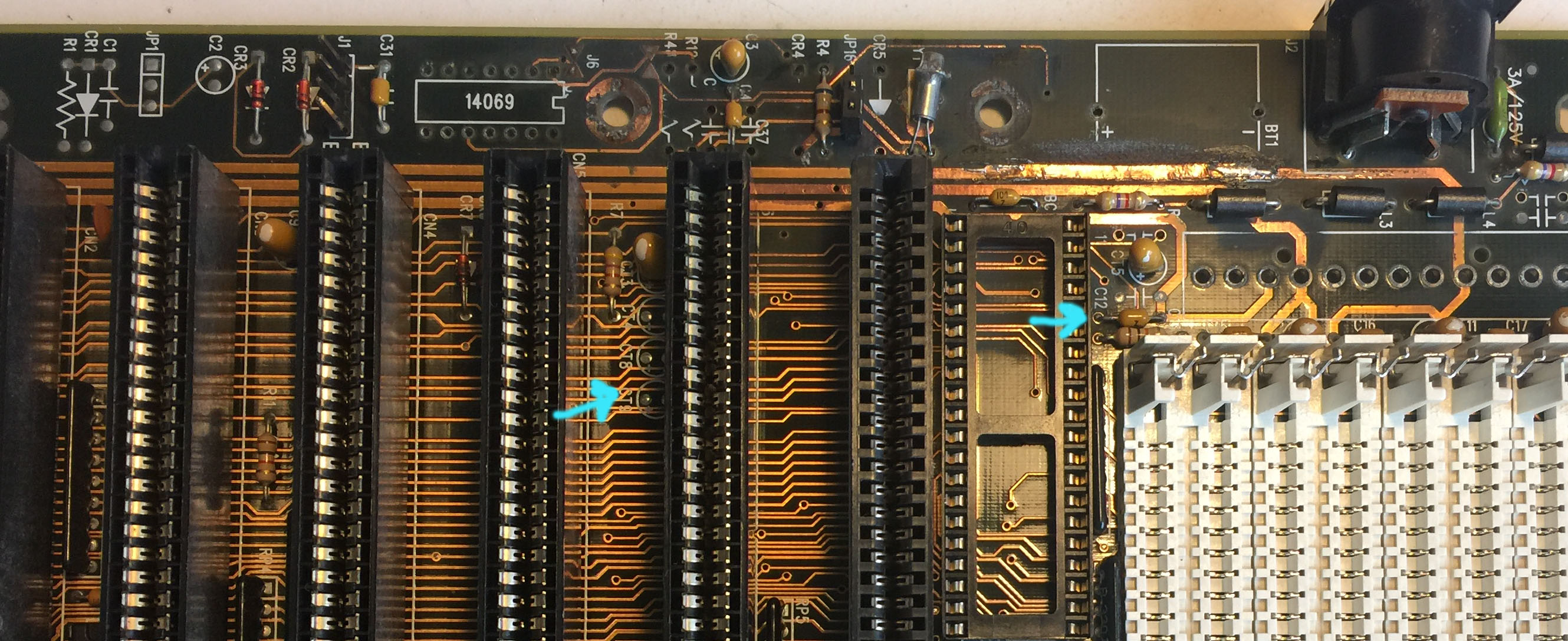

          The board itself has one tantalum cap on the +12V line - a cap I replaced due to corrosion/oxidation. I pulled it off another motherboard (a 386).
          It is interesting that there appear to be two additional spots for caps that were not placed on the motherboard (cost cutting, I suppose?) for several of the power rails - including +12V. I marked them in red on the bottom photo (ISA slot 2 and 6). This photo is during the restore.
          The blue arrow on the top photo shows the intentionally missing cap for slot 2 as well as the only cap (the one I replaced) on the +12V line (at least across the ISA bus).
          I suppose I could use a different cap near the +12V line and even add others down the line - but I (at this point) am not sure that it is honestly where my problem lies.

            You measured that one? After 20 years I would not expect any of those caps to be OK.
            • ckrtech
              • Dec 2014
              • 113
              Re: AT Power supply experience
              I didn't measure it. And you wouldn't expect any of the caps to be OK? Why is that? I ask since they are tantalum capacitors for which age should be irrelevant.
              That being said, I am uncertain about heat and moisture history as it wasn't in my possession for a number of years.

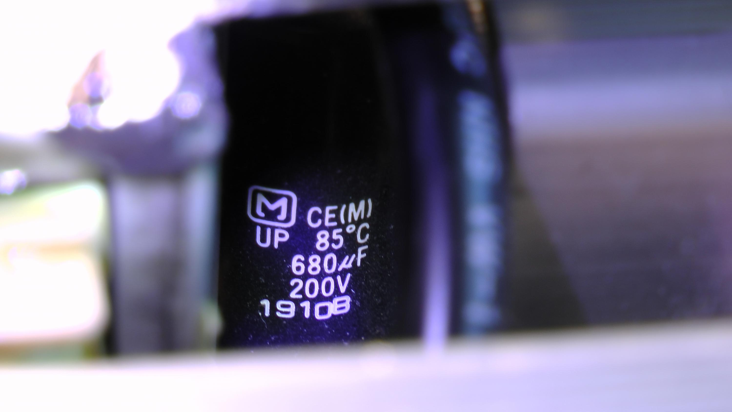

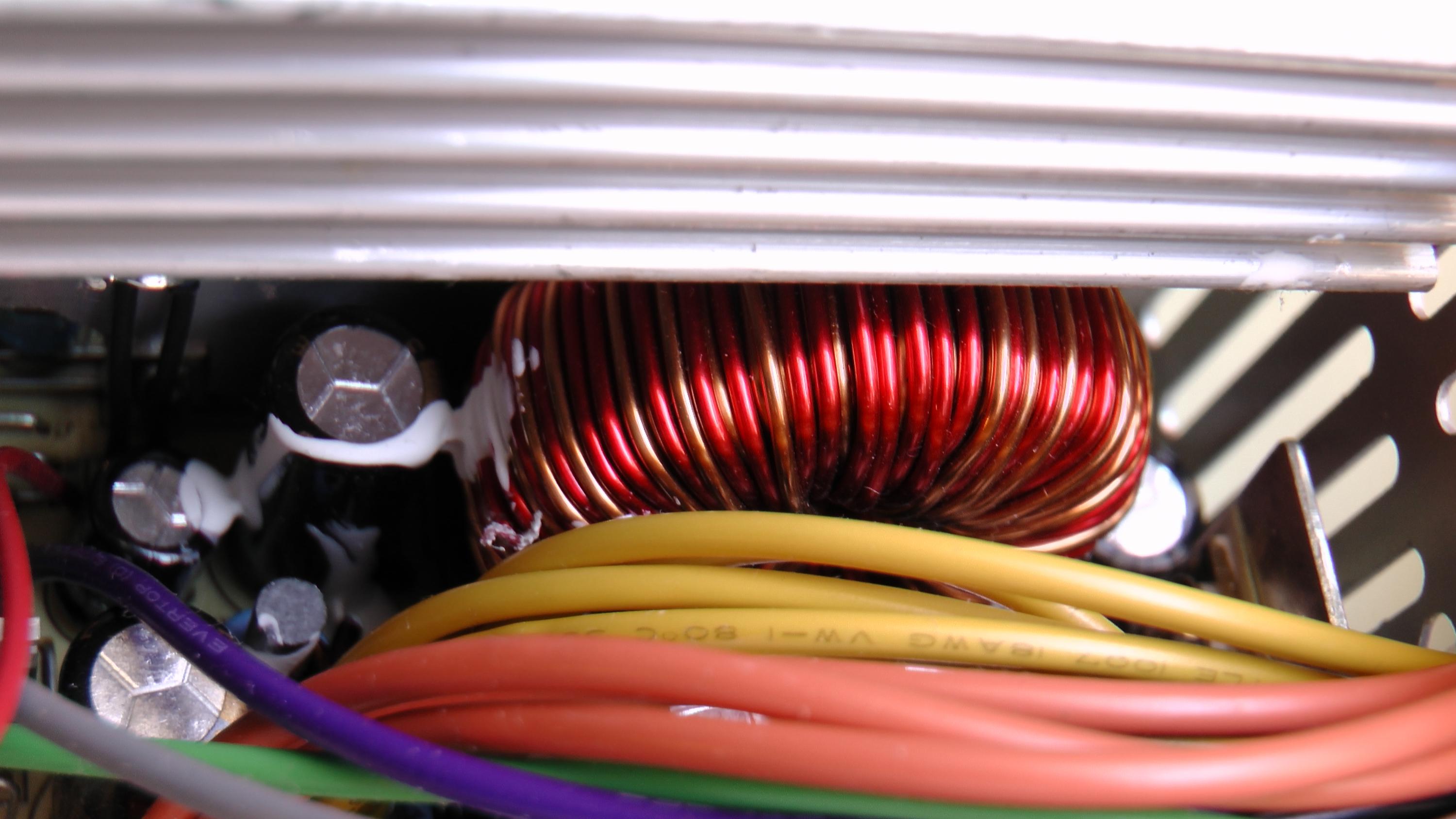

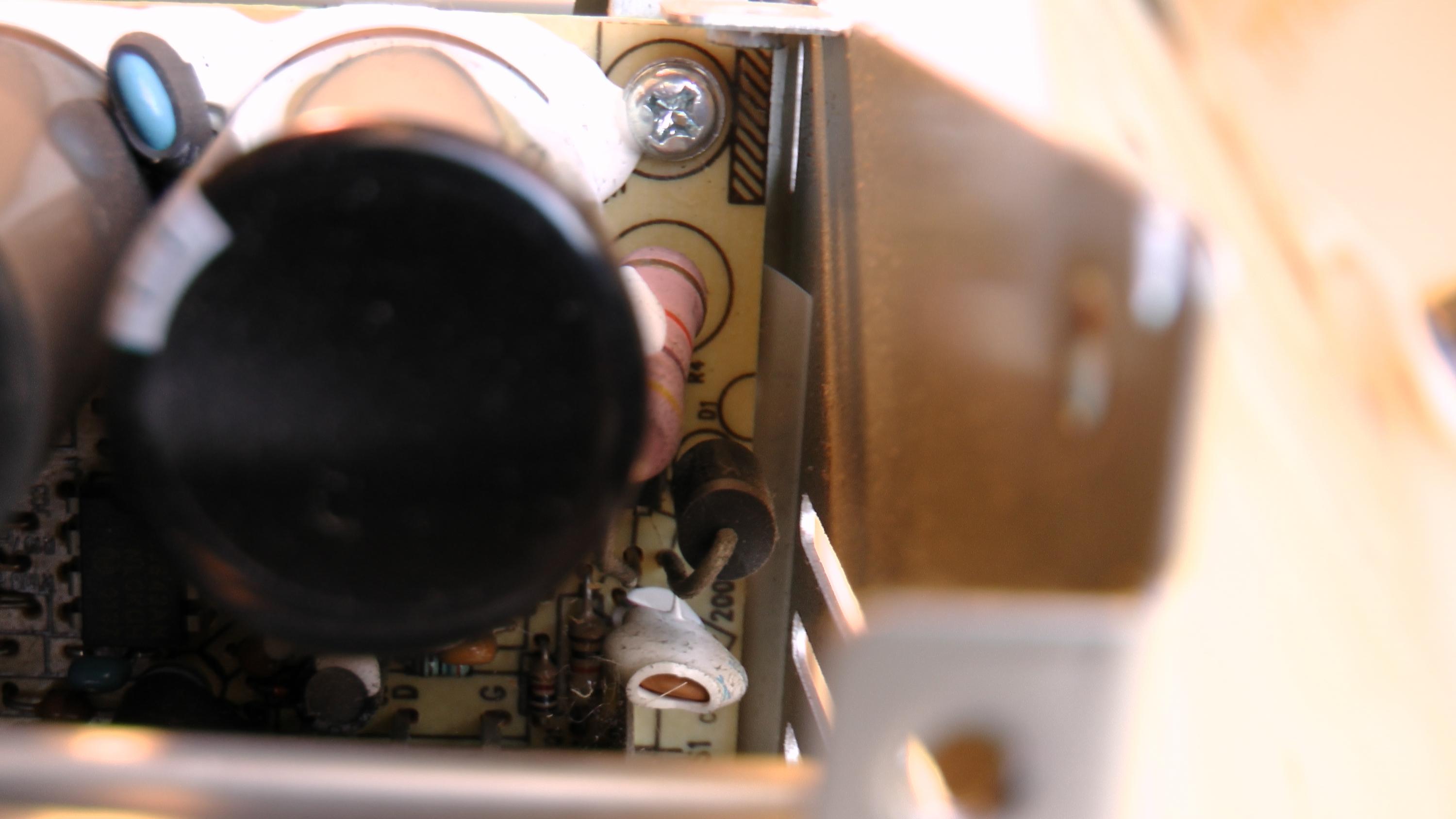

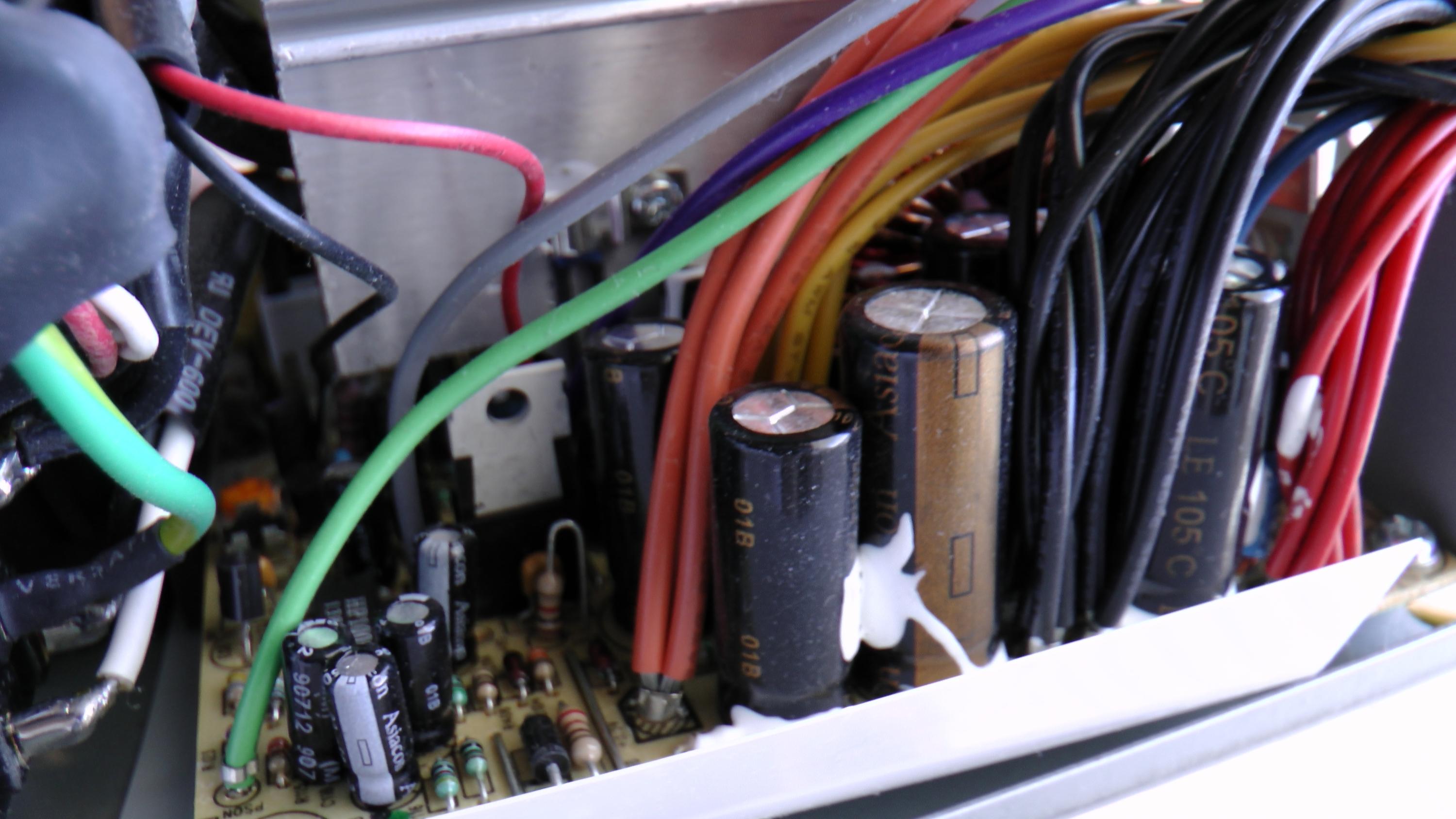

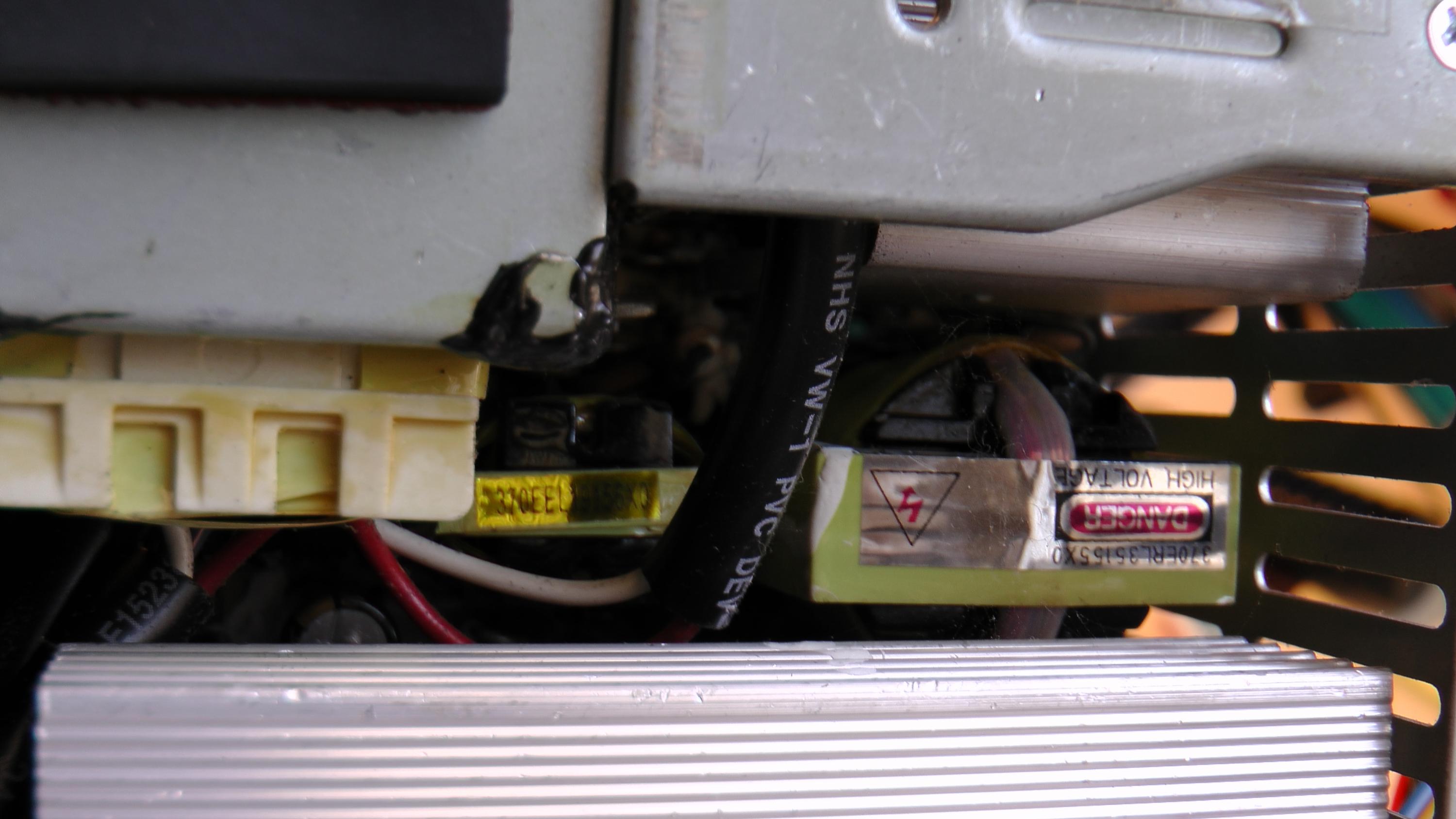

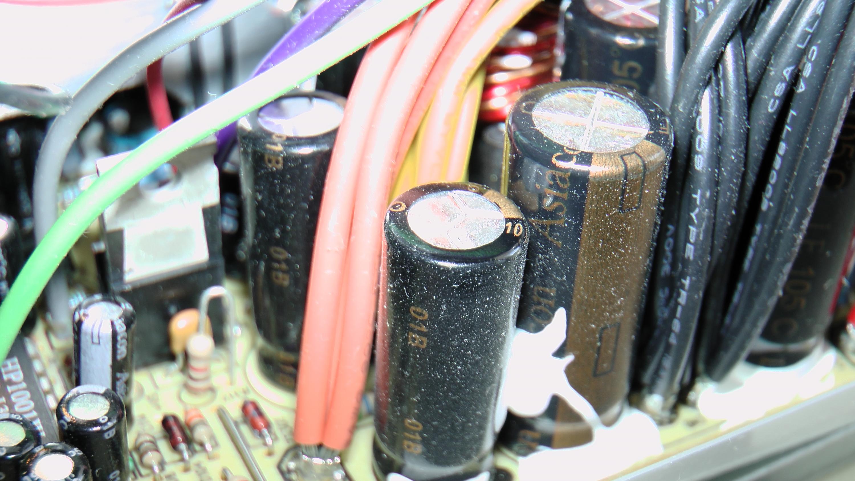

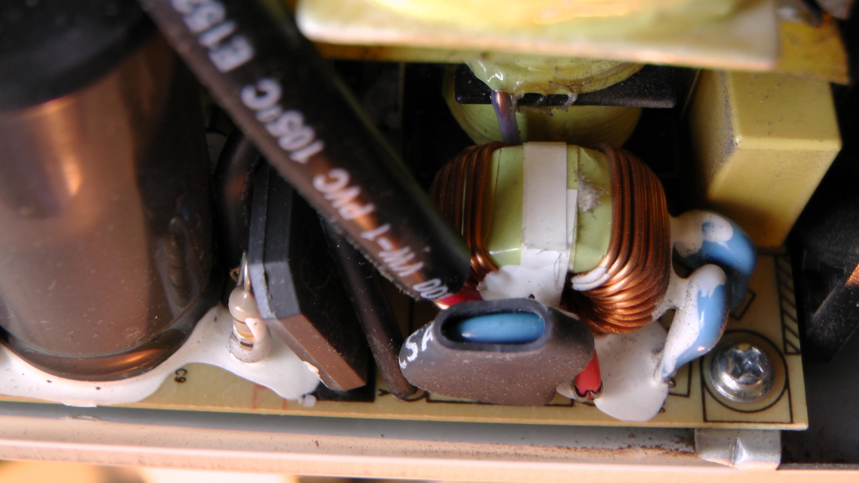

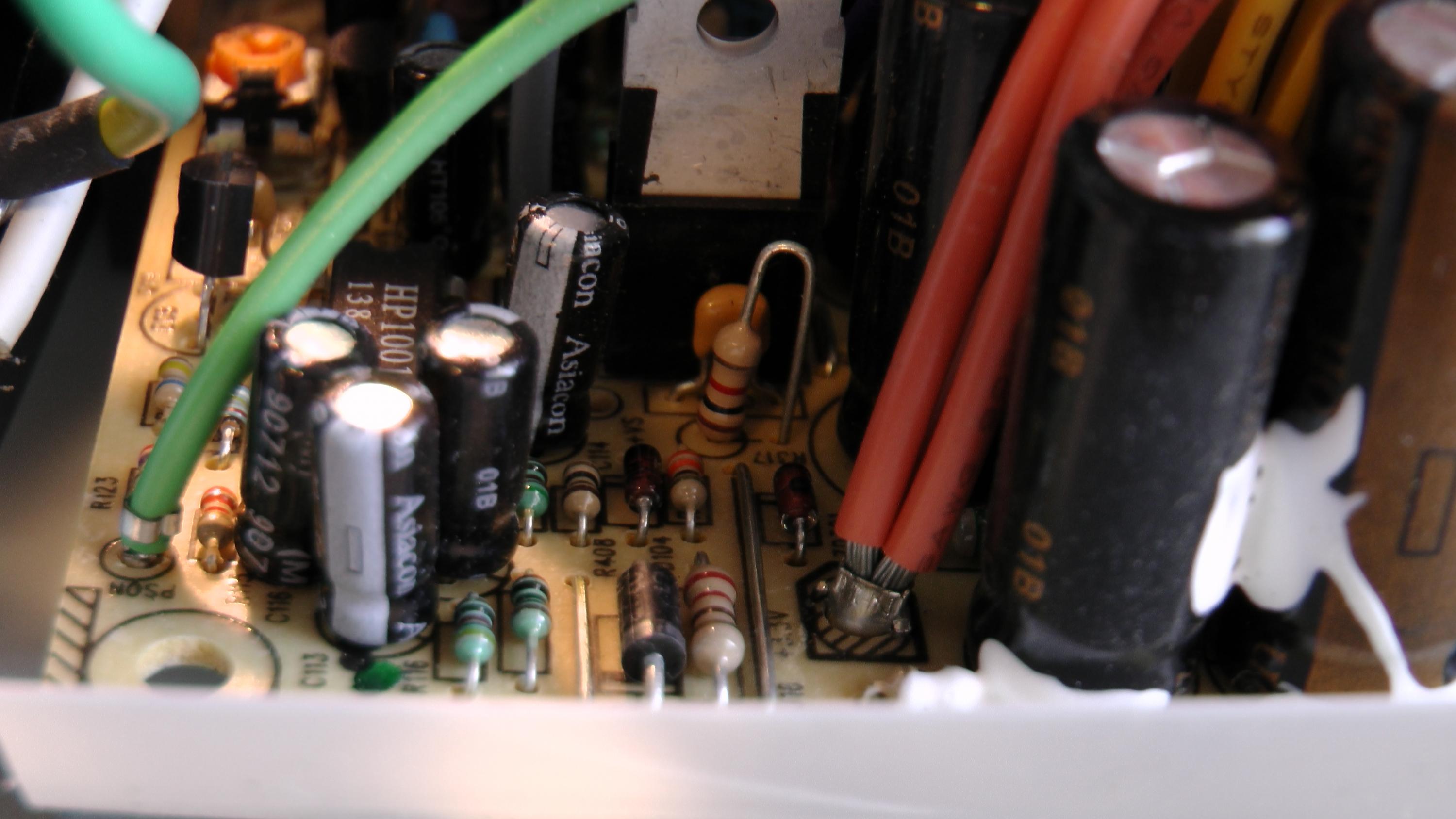

                        The bench/test power supply I am currently using is a Dell HP-P2507F3P.
                        Looks like majority of output stage are "Asiacon." They look OK - but I know that means absolutely nothing.
                        I'll try to add some photos of it.
                        And at some point we'll get some photos of this AT power supply that I have had since 1993/1994. (Maybe I can replace the holy-cow-loud-fan in it as well)
                        I am still skeptical that it is simply only the power supply at this point - unless this motherboard was just not designed to handle a +12V that isn't short of perfection.
                        Would be nice if I could scope this thing with a load that isn't a mobo.
                        • ckrtech
                          • Dec 2014
                          • 113

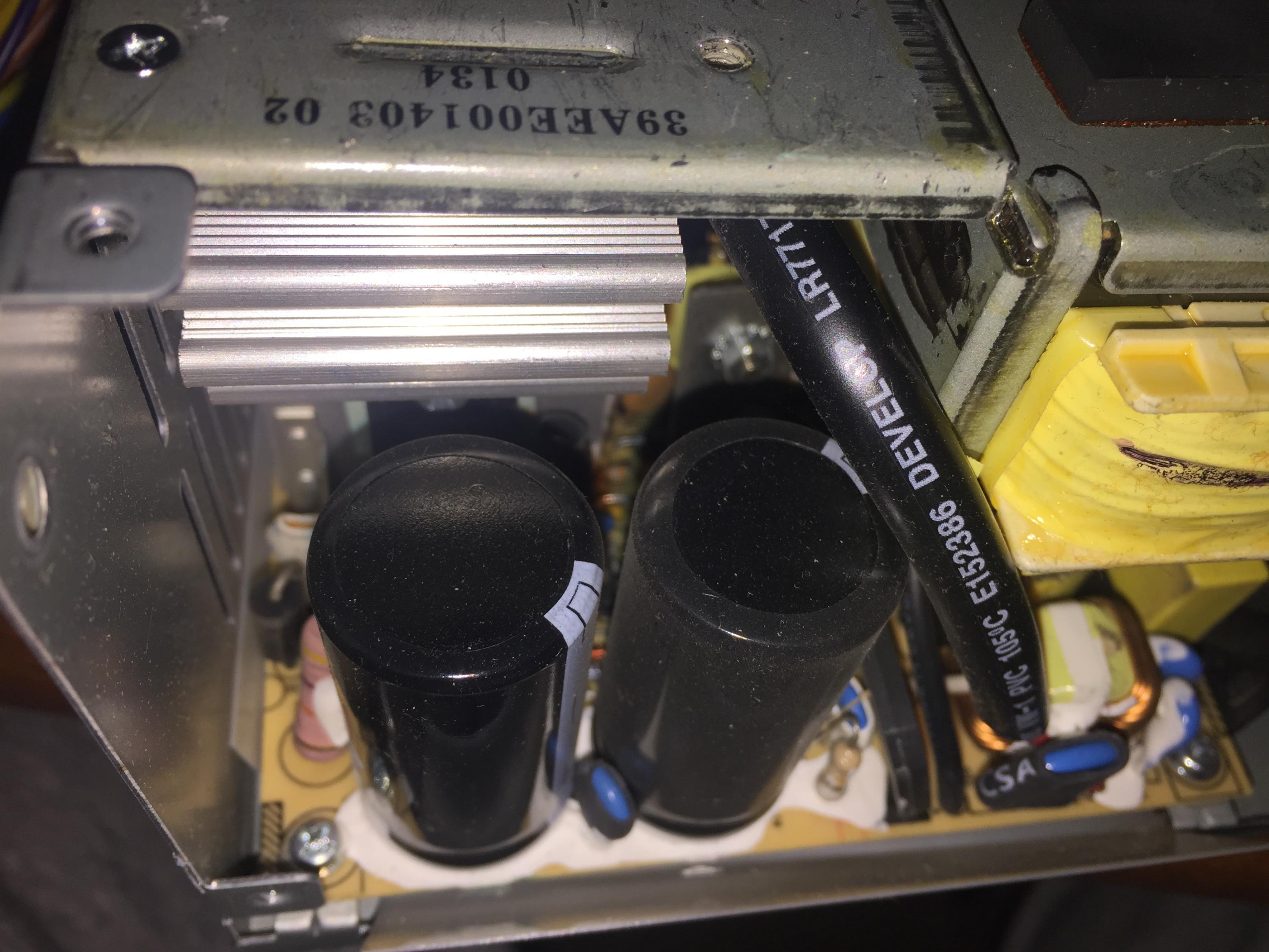

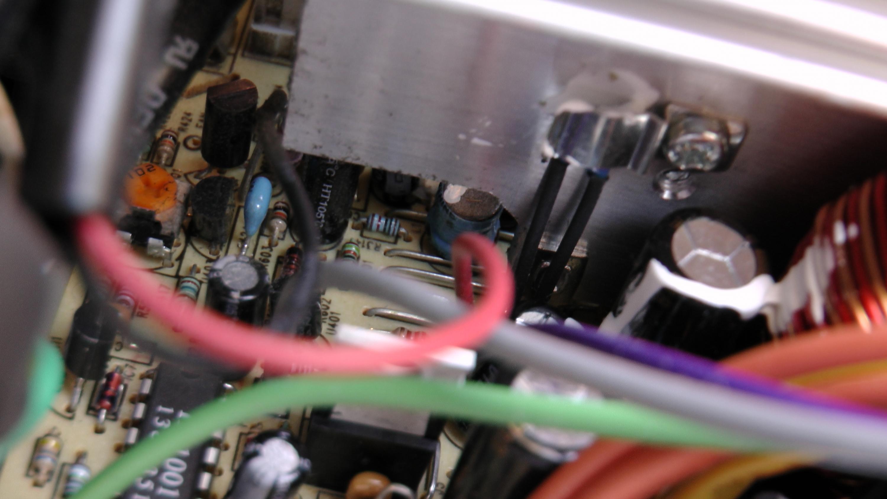

                          Photos attached of Dell ATX. So difficult to get good photos of this tank without a teardown.
                          Interestingly, I built a second 486 with some other parts I had around - different board, processor, case, PSU, etc. That power supply tends to have the same reaction to hard drive reads in the scope when viewing +12V, but the AT clock signal is rock solid regardless of drive access, Doom running, etc.
                          I suspect my motherboard used in this main project of mine is letting noise into the signals, and that is causing instability.
                          Nevertheless, again - Photos of Dell ATX used for bench testing have been attached.
