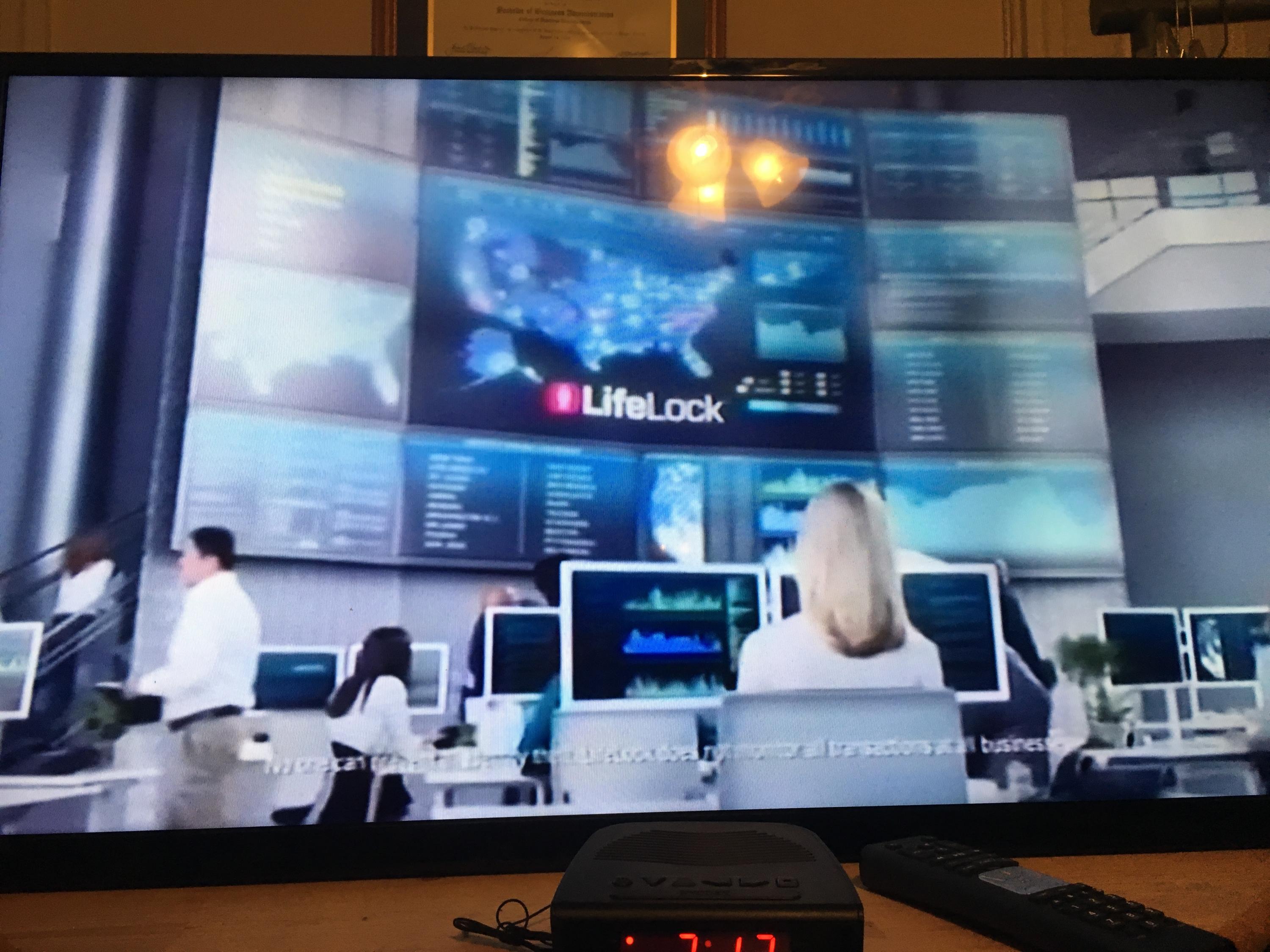

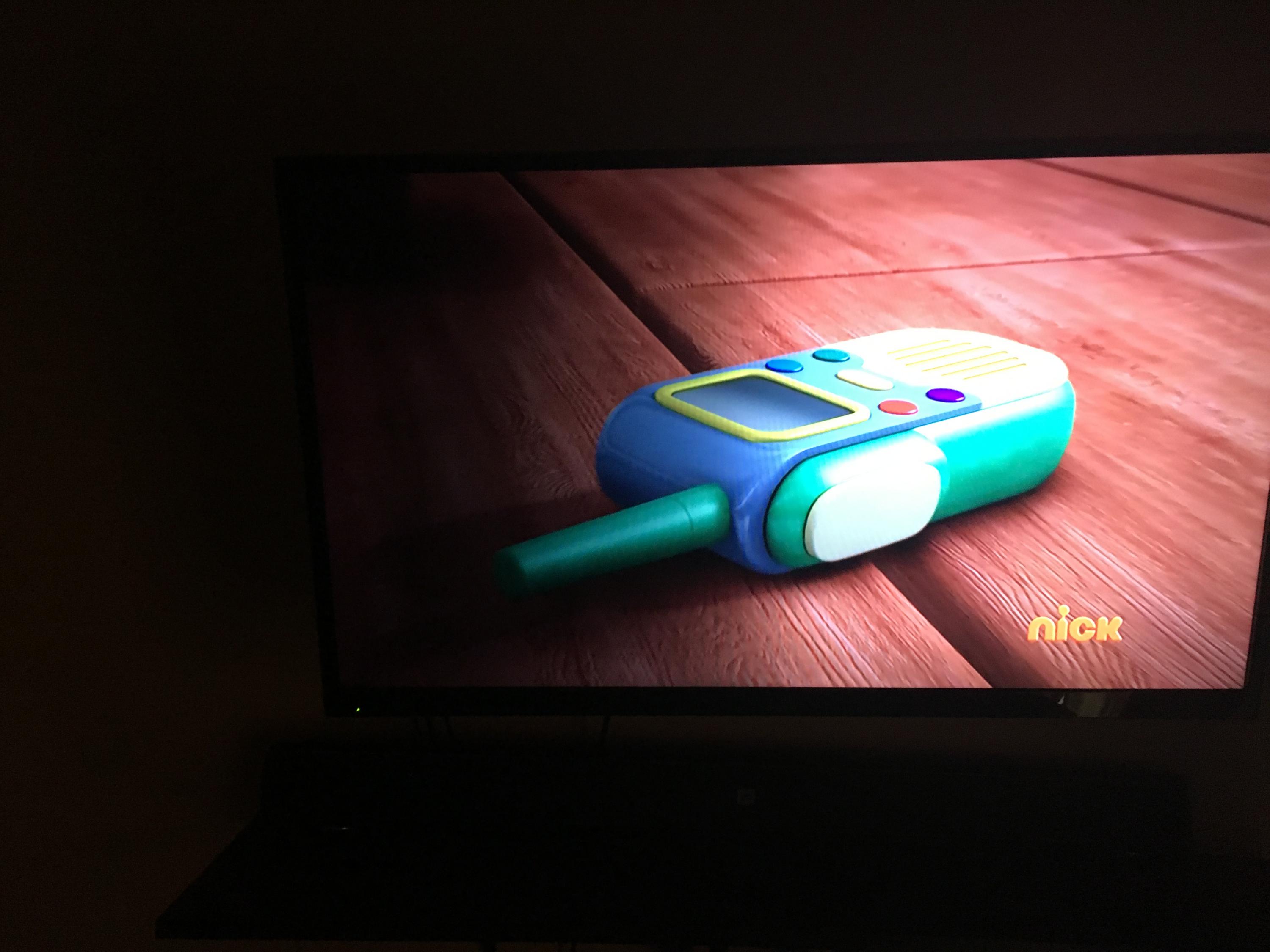

Sanyo Half the screen very dim is a power supply problem see photo
    • Jul 2011
    • 6037
    Here are two photos of what going on

    Looks like Leds are out in panel.

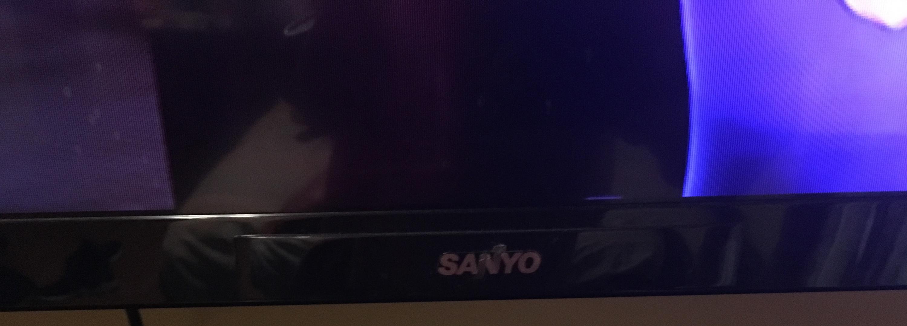

      Re: Sanyo Half the screen very dim is a power supply problem see photo
      You are very right there one LED strip was not working at all
      I had bought some led strips from Electronic GoldMine about year so go I got working but you can see the leds circles more so on the right but it's watch able
      If gose out it again it might end up in the land fill

        The one thing I found interesting is that there is 20 leds on each have of this panel
          Yeah thats normal tbh for cheaper sets, also be sure to turn the backlight down. Glad its fixed
            Yea so am I
            I replaced all the back light LEDs on this set
            I had four strips of one style and four of another style that might be one reason for one side does not look as other side
            But that what came when I ordered them from Electronic GoldMine
            It was (20) strips of different sizes in a bag if I remember right I think it they were $20.00 a bag I was going to make 4 foot tube to replace the florcent tubes in my shed but i did not do this project because I did not have enough of the same size to do it that why I had what I need to do this repair
