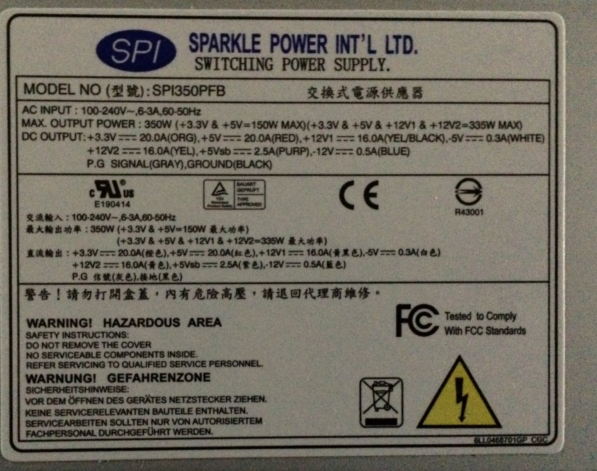

What do you think will it do 350 watts
Sparkle Power Supply SP1350PFB Good-Bad

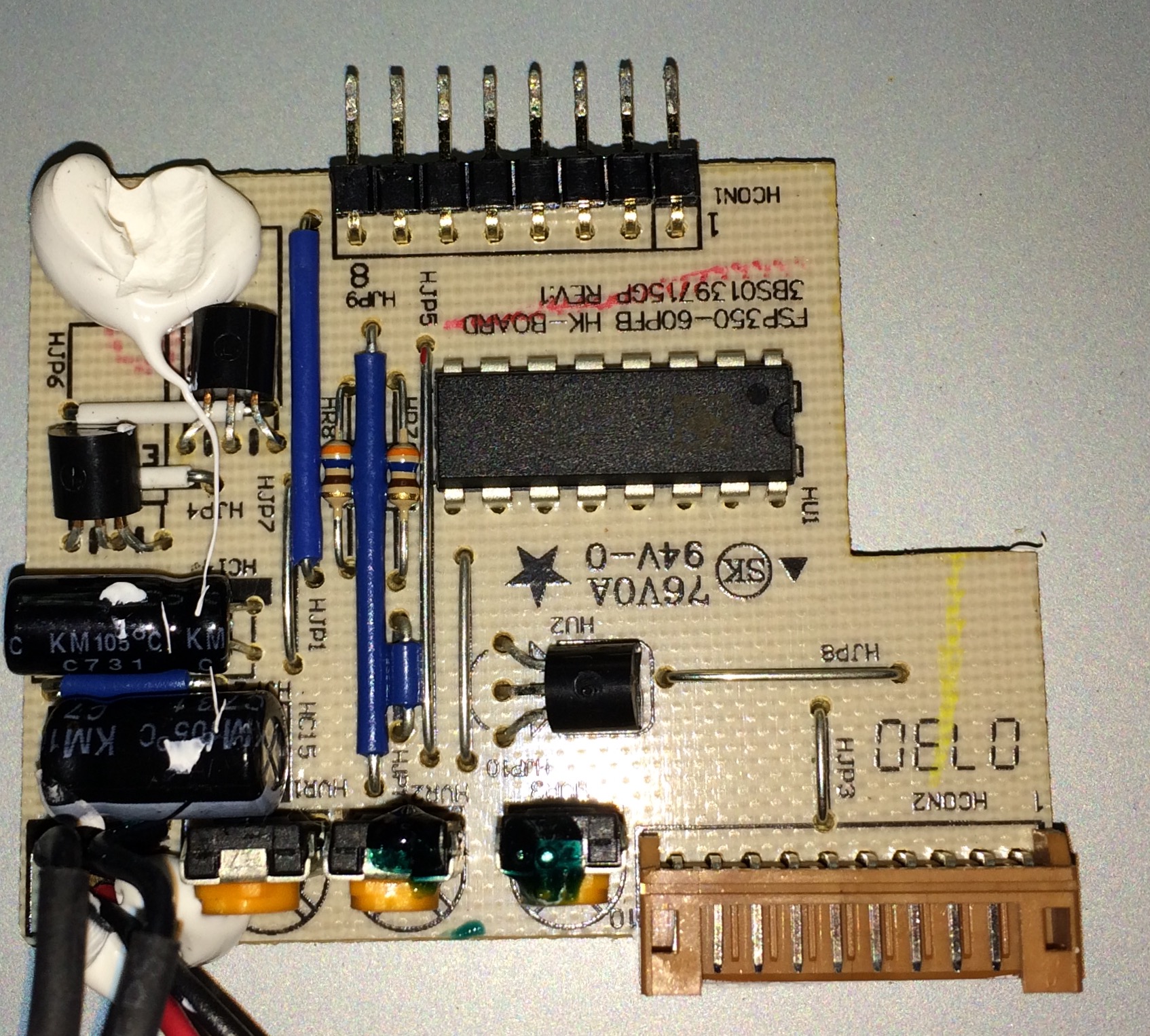

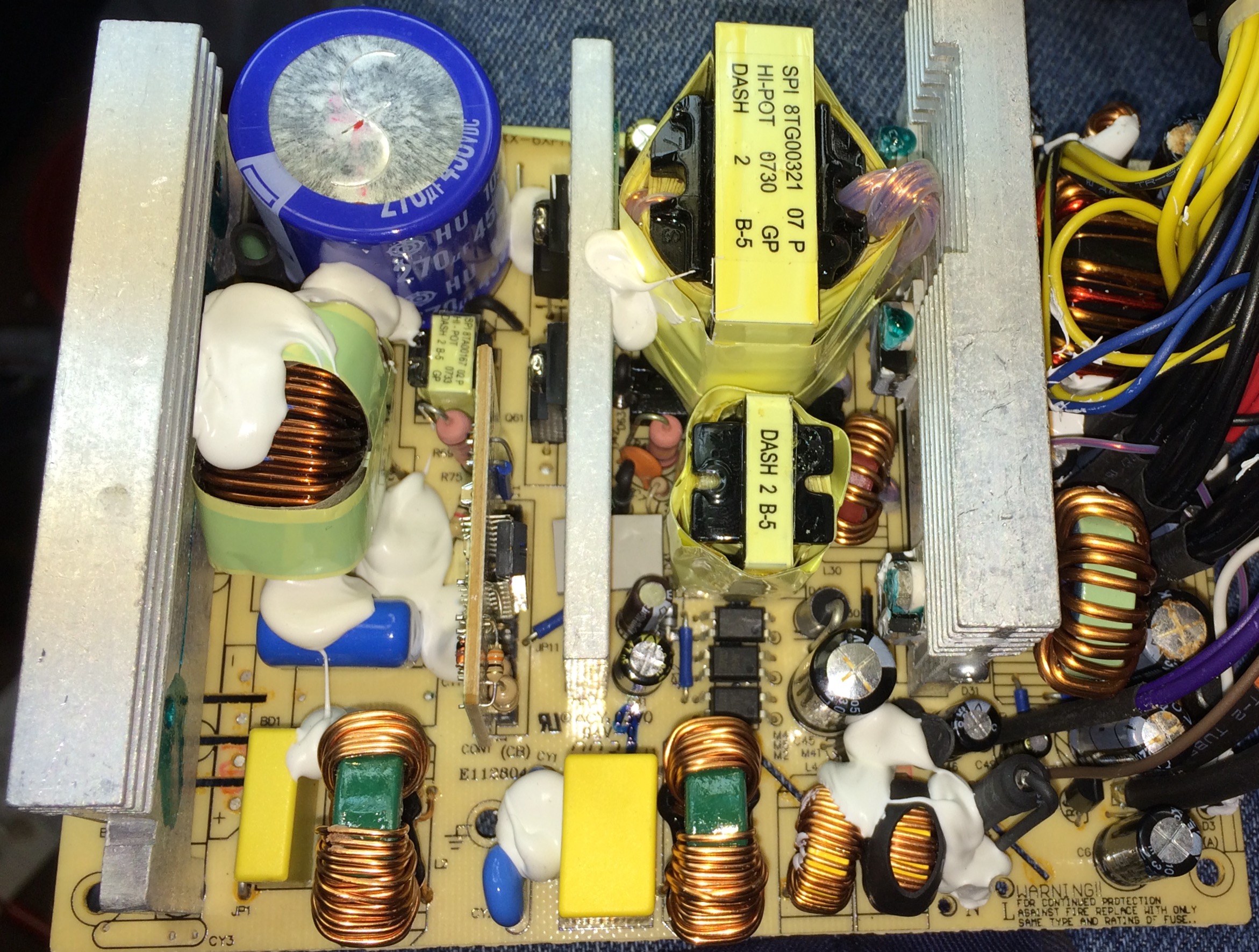

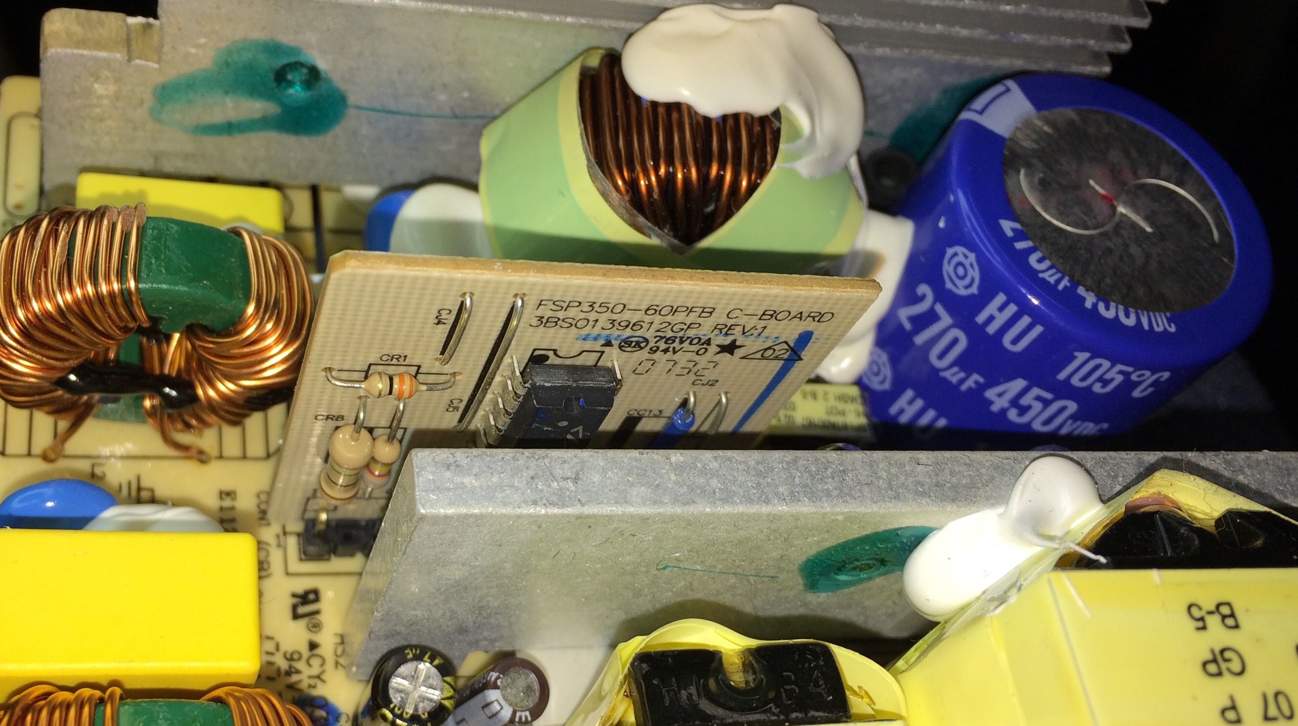

Here are more photo
I bought these new - old stock surplus so who knows how long they been sitting around on a shelf
I paid $12.00 plus $9.00 shipping each
I bought two of them this one has not been recap yet the other one has been recap with
KY , KZE , LYX this power supply seems to work ok with these capsLast edited by sam_sam_sam; 11-04-2016, 02:58 PM. -
Re: Sparkle Power Supply SP1350PFB Good-Bad
Yeah, it is FSP, something like those HHN thingys, something like FSP Epsilon.
Not the greatest thing, but for a 350 more than enough, but rather +5V havy, sadly...Comment
Sparkle, despite a name that sounds odd to speakers of English (very close to "Spark", not a good association, IYKWIM), is solid. I'd like the heatsink to be a little more substantial, but with really good airflow it could be alright. One of them has caps that have puked their guts; at 6+ years old, that's not horrific.
Trying to change it to an 18V or 24V P/S could be challenging. The +5V winding turns ratio won't allow for that. And I would not be confident that the +12V winding (probably a winding "stacked" on top of the +5V winding, to take advantage of the +5V regulation) has that much capability. IF the +12V winding is capable, the duty cycle will be much greater, making your minimum AC voltage higher. If the output caps are 16V, you'd have to change them to 25V or 35V parts. Similarly, IF the +12V winding might be capable you would have to find the feedback divider resistors and change the ratio, specifically the "upper" resistor. If you can find it, I'd suggest starting with a potentiometer of 5X-10X the resistance you're replacing, adjust to the voltage you want, measure the resistance of the pot, and install the standard value resistor that is closest to that value (or just keep the pot).
I don't even want to think what would happen to the loop compensation or how to adapt it (maybe if there's a cap across the resistor you changed, find a value that keeps the RC time constant the same?)!
You might be able to pull it all off, but I wouldn't bet on it. But it sounds like you're doing this for fun and learning, so have fun. You definitely will learn.PeteS in CA
Update—> I know that this is a very old post but it is the switching power supply's that I have quite a few of them
Like I said earlier in this post I bought even more of them because they kept having sales on them
I probably have about ten of them and some of them are 300 watt ones
and so far everyone have blowed caps on the output power rails and as far as I can tell these power supply were new never used because they are very clean inside of them
The biggest problem with changing the caps on this board is some of traces are very narrow and lift off the
board and there are two caps next to each other one in particular the one near the primary side of the board it a small UF value
The other problem with this board is that the output caps and the wires and inductor are all packed together in a small area which replacing is a pain in the a** to do
I have recapped another one of them yesterday and ran it all night and seems to run all rightLast edited by sam_sam_sam; 12-18-2020, 06:23 AM.Comment
