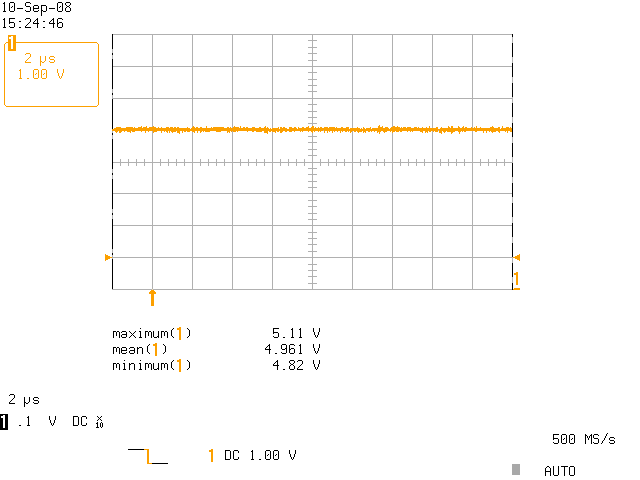

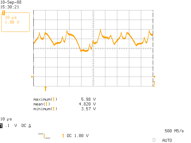

            I think the better way to test the PSU is to attach some load (power resistor) and check the voltages but to check ripple you need a scope.
            You can try to understand if there's high ripple measuring voltages with DMM in AC mode, it is not accurate but if you measured something greater than 0.1~0.2 Vac for sure something is not working properly.
            I have done a test on a small DC/DC converter: I have loaded it at 1.5A, with the original good 100uF cap and then I replaced it with a general purpose 2.2uF, just to simulate a failing cap.
            With the DMM the measures were:
            with 100µ Vout= 4.93V Vout AC=11mV
            with 2.2uF Vout= 4.82V Vout AC=470mV
            You can see also the attached picture taken with the scope; if you look at the "mean" values their are close to the DMM measured values. It must be underline that in both cases the output measured with DMM was within spec, 5V ±5%, but with the 2.2uF cap the max/min voltage were completely out of spec. This behavior is due to the regulator that try to keep the voltage at its nominal value but since the output cap is too low, the output oscillates and the average voltage is around the set value of 5V.
            The "PS tester" doesn't load the PSU and you can't understand if something is wrong, you can only see if the voltages are present and within tolerance.

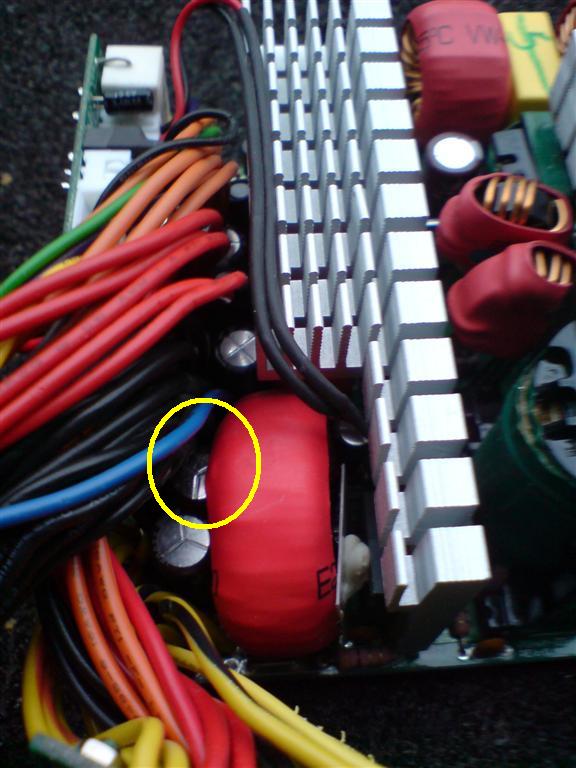

                  i replaced the capacitors. i'm putting the psu back together, and will post results when i try it
                  here are some pics of the unit

                      • PCBONEZ
                        Grumpy Old Fart
                        • Aug 2005
                        • 10661
                        Re: Help me repair a TT850W PSU
                        Looks bloated.
                        Mann-Made Global Warming.
                        - Dr Seuss
                        • kc8adu
                          • Nov 2003
                          • 8832
                          • U.S.A!
                          Originally posted by PCBONEZ
                          Looks bloated.
                          looks like it hatched.
                          • KAMENi
                            • Sep 2008
                            • 21
                            all 3 of them look normal. i can post some more pics...
                            • PCBONEZ
                              Grumpy Old Fart
                              • Aug 2005
                              • 10661
                              If you say so.
                              It looks bloated in pic.
                              Maybe it's a camera thing.
                              - Dr Seuss
                              • KAMENi
                                • Sep 2008
                                • 21
                                there are 3 of them under that bunch of wires, all 3 are 2200uF and 16V and all look the same. none bloated or anything
                                only, i can't read what manufacturer is it. they are the same as the 2 on the pics above, only those are 6.3V
                                it appears they are chemi-con
                                • PCBONEZ
                                  Grumpy Old Fart
                                  • Aug 2005
                                  • 10661
                                  Chemi-con KY series if the same series as caps in photo.
