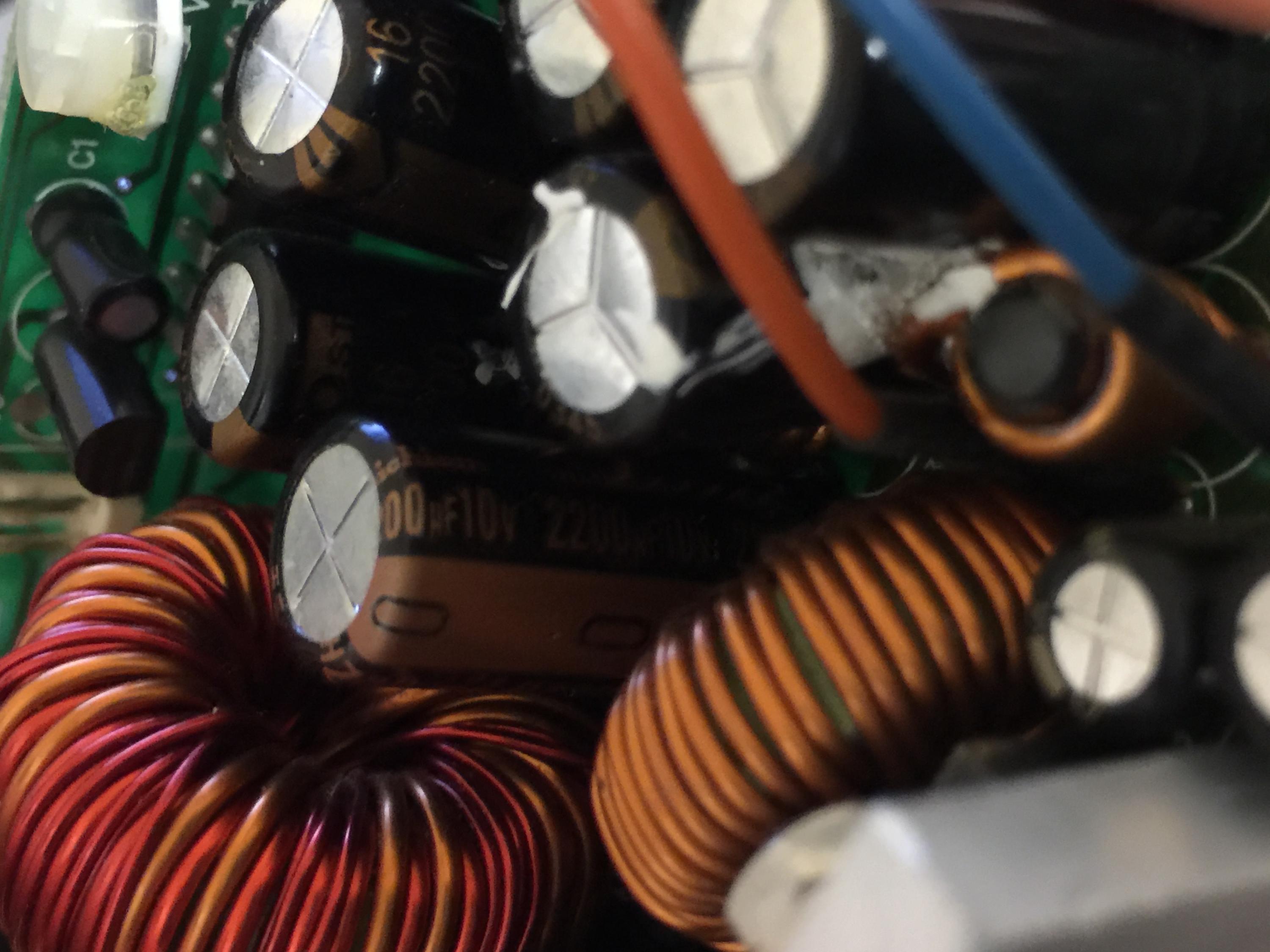

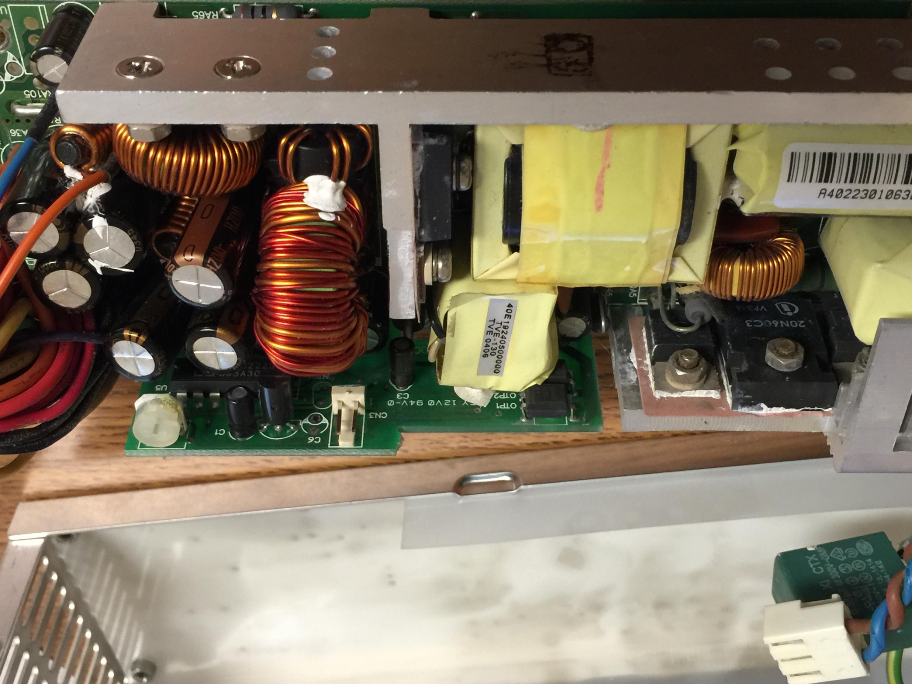

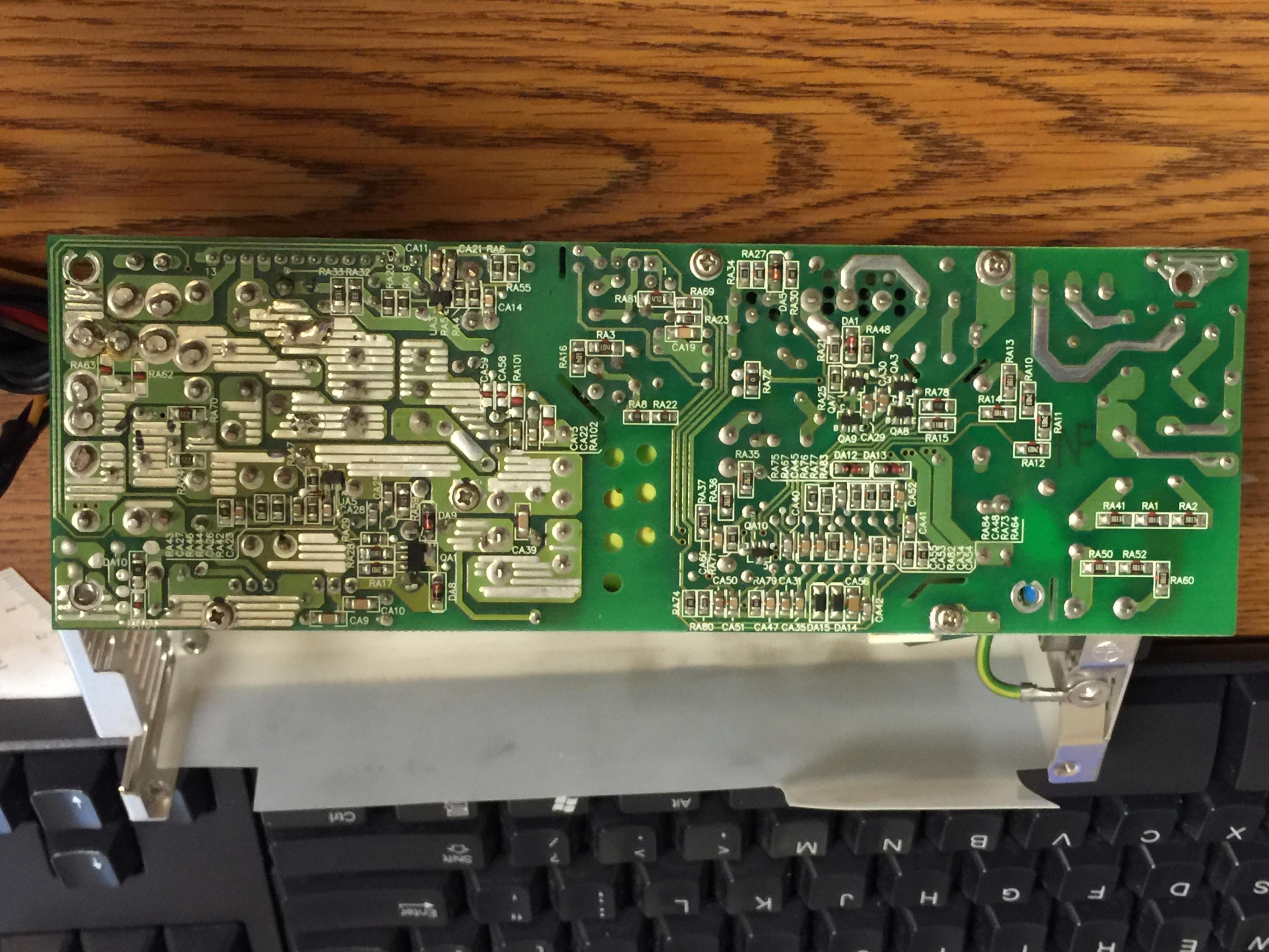

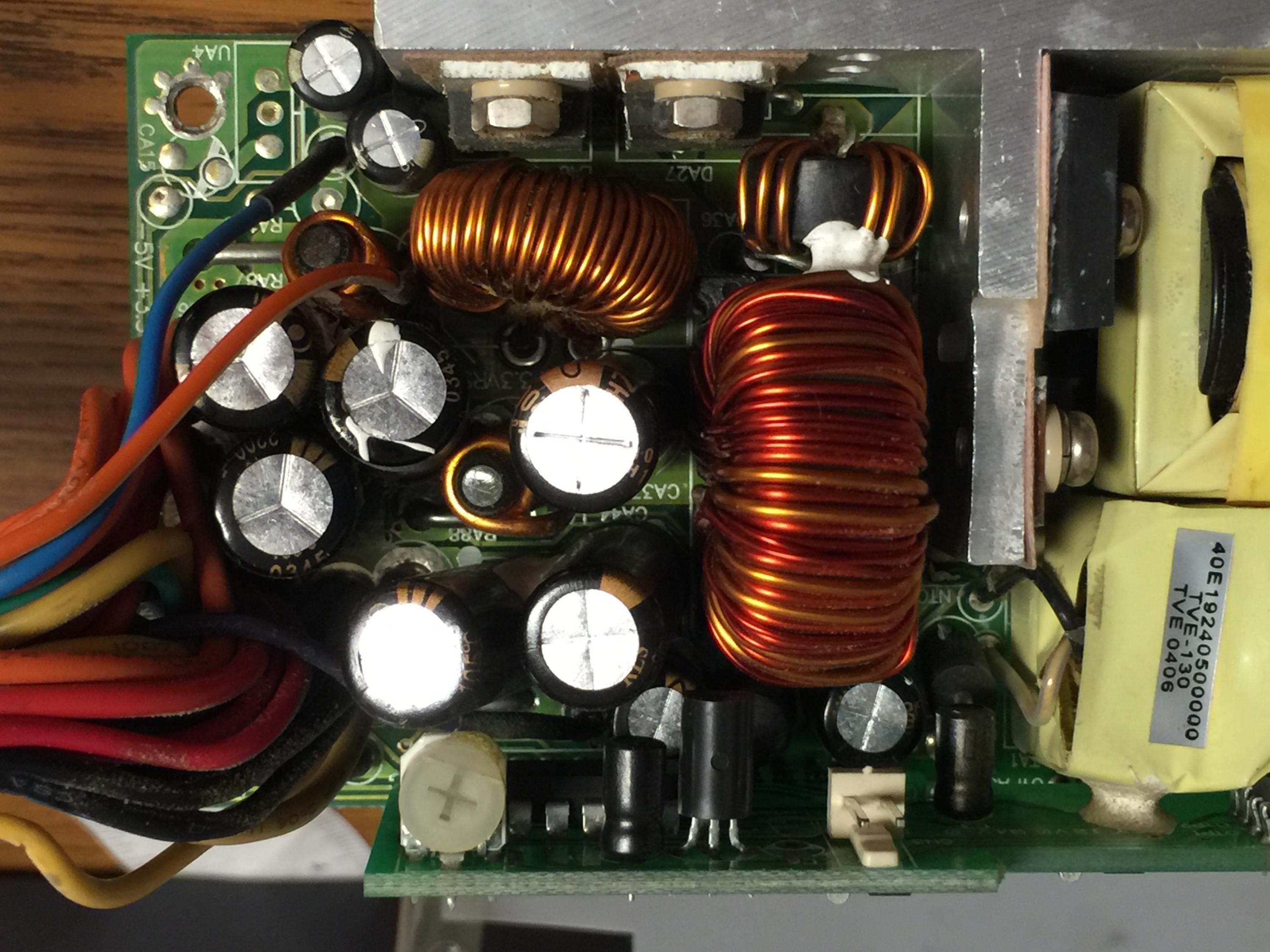

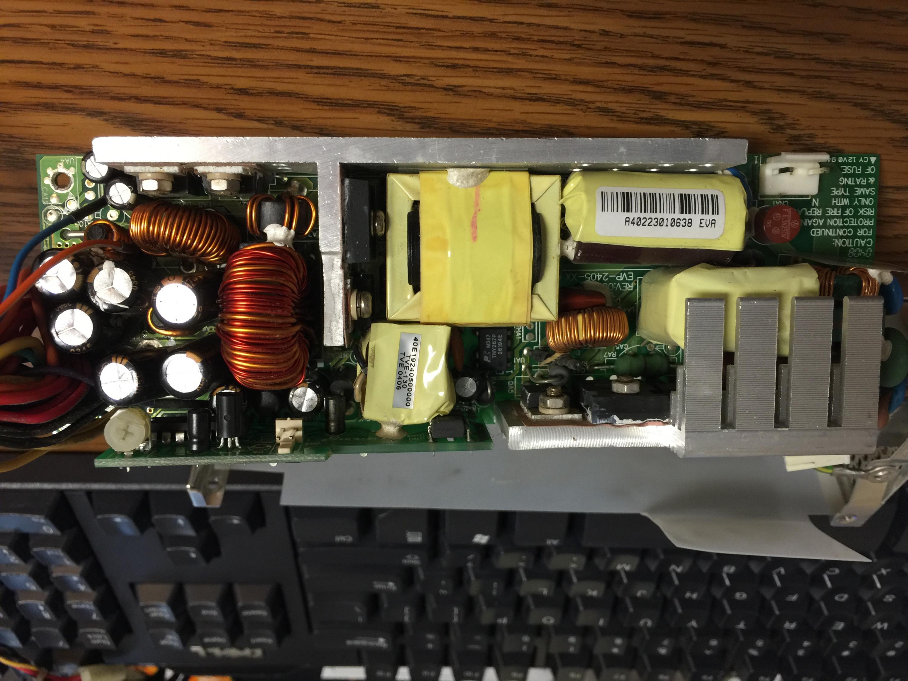

    I have an old shuttle ITX PC that i'm fixing for a client that came in with a bad power supply and motherboard. I found a motherboard online and replaced it and it is running fine now. I cannot find a suitable replacement power supply. (very small dimensions 42mm x 62mm x 190mm)

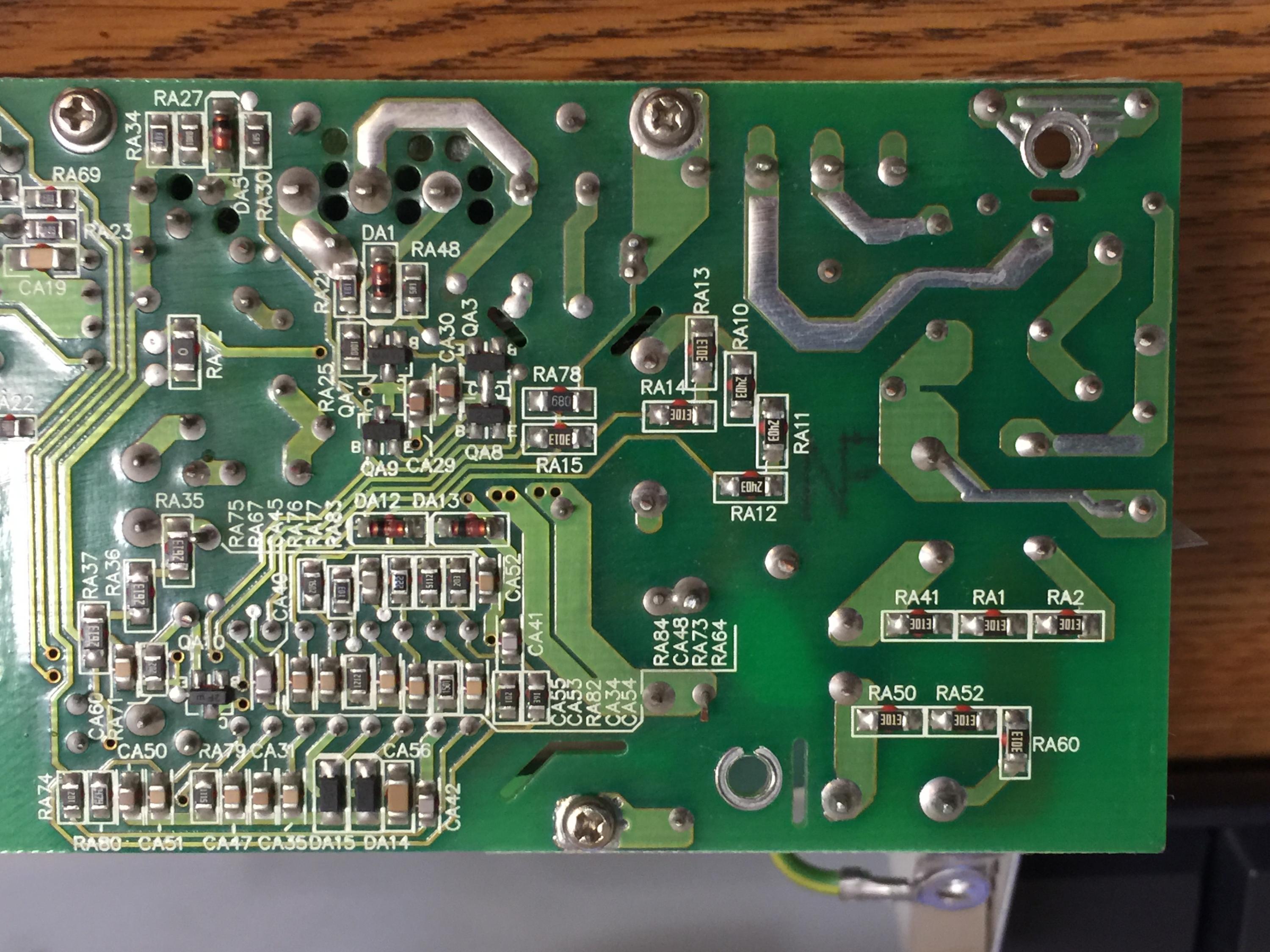

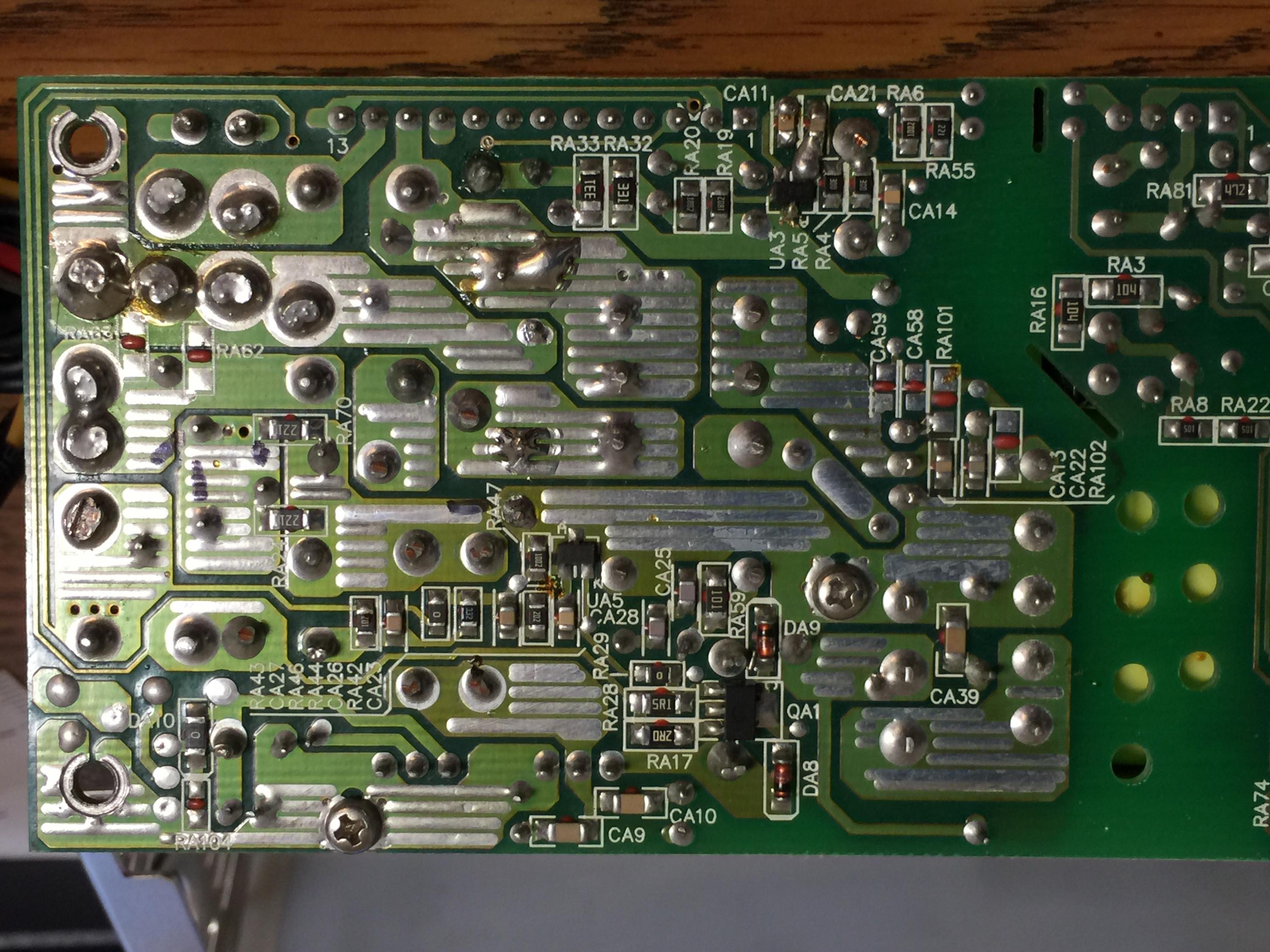

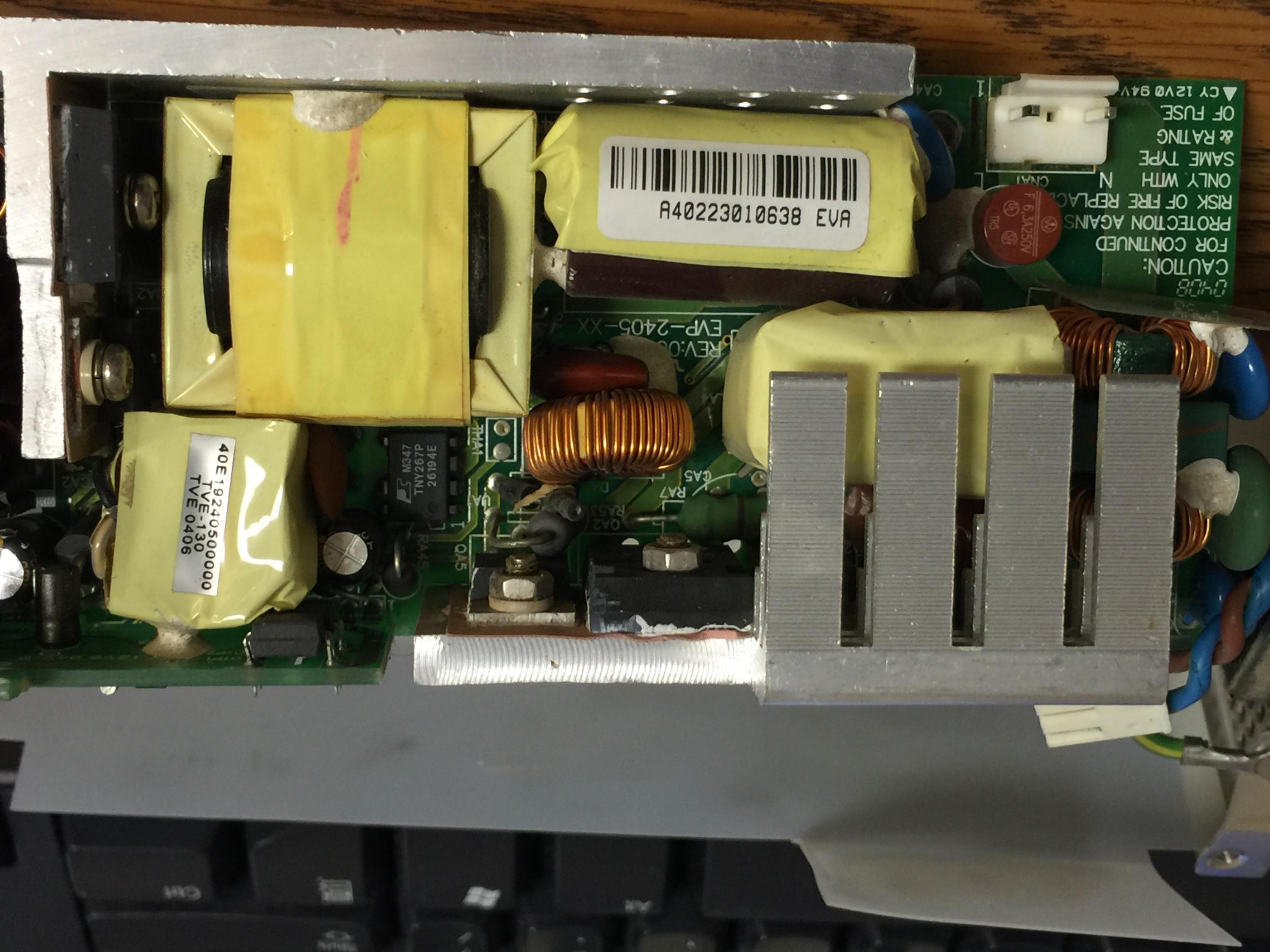

    I am attaching some pictures of the components. When I first opened the unit it had a swollen OST RLS series 10V 2200uf cap. I replaced it with a Nichicon HZ with the same values. I also used my "Blue ESR meter" to test the other caps and they seem to be within normal ranges.
    Please help with whatever you can.

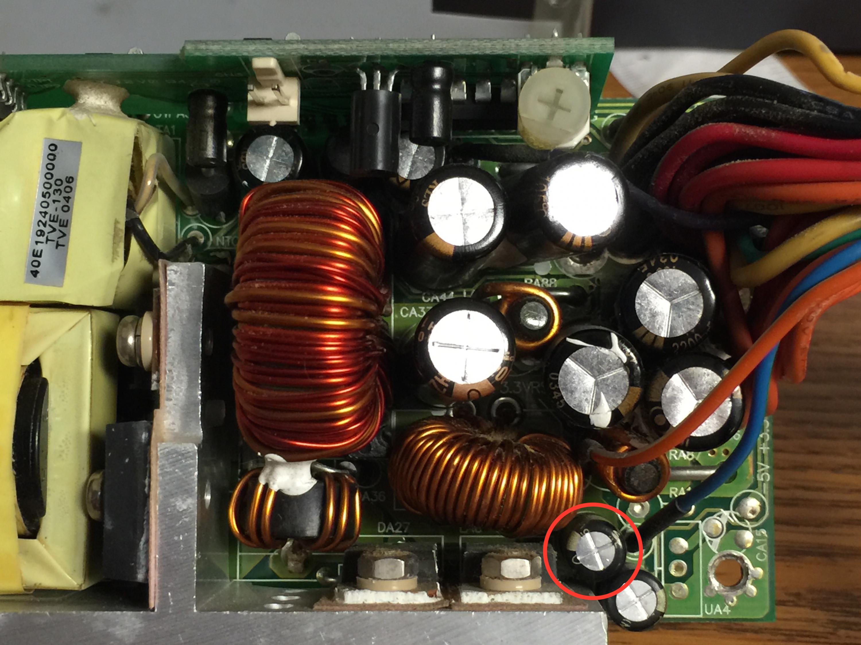

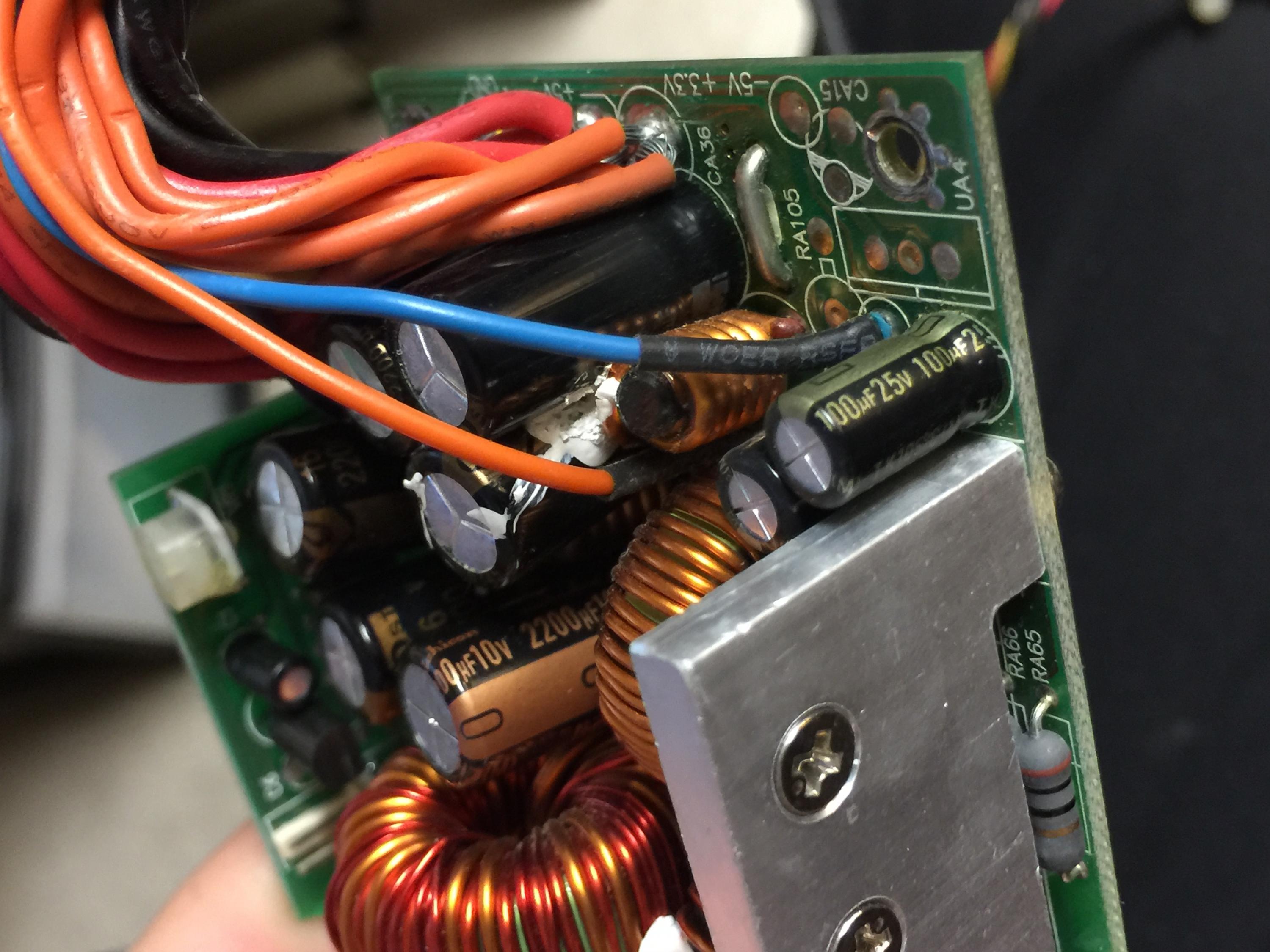

            Thanks to both Japlytic & STJ for the help on this one. I've been slammed at work and just got back to this project. After suggestions from both users I went back over the board with my Blue ESR meter for the smaller caps. I only tested the larger caps originally. I found a small 100uf 25v cap (circled in red on the photo) that wouldn't register on my ESR meter at all, even after removing it from the circuit.
            I have since replaced the offending electrolytic with a Rubycon ZL of the same values and the tiny PSU is back to life.
