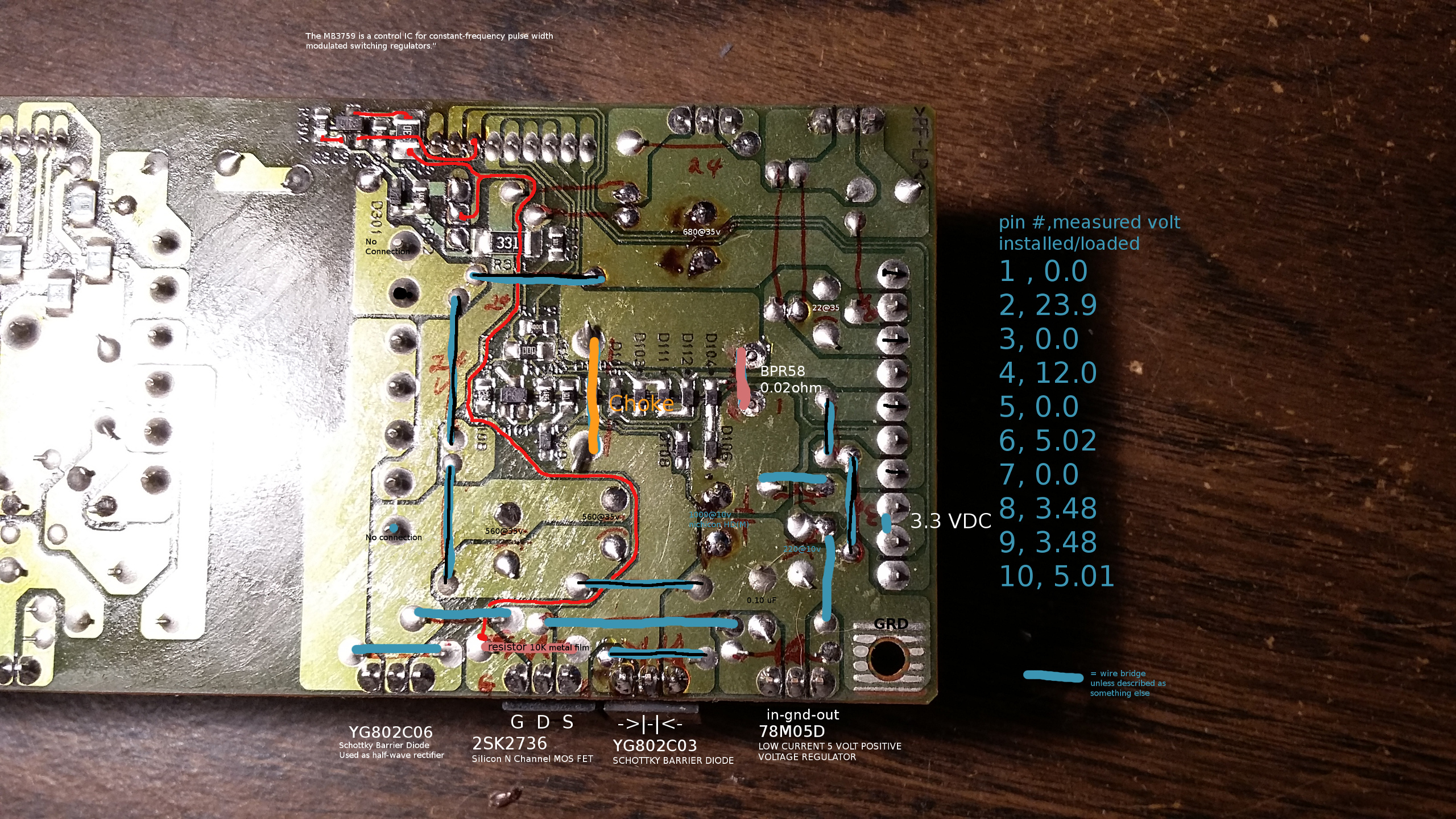

    My HP 4100 MFP (4101mfp multi-function-printer with duplexer) has been giving a 30.01.18 error code. It will function as a printer just fine but I can't use it as a copier/scanner because of the code. Service manuals say to replace the scanner board but I read in a couple other forums that it is actually the power supply that causes the problem. The 3.3 volt output is reading 3.4v and apparently that's just out of spec to cause an error. The error also keeps the whole printer from powering down to low-power stand-by mode. After a power cycle and cool-down period, scanning/copying works for a while but then is halted by the error.
    The other outputs are as measured 5.04 volts, 12.0 v, 23.8 v(24). Pretty precise.
    The caps seem good - tested out of circuit. A current sensing resistor BPR58 0.02ohms (that I may not be able to test properly because it's too low for my meter) seems to not have resistance at all.
    I see refurbished power supplys RH3-2234 available for $200-300. What was fixed?
    Or am I barking up the wrong tree?
    Does anyone have experience with this or similar power supplies?
    I'll get some pictures up in a little bit.

      I realized my ESR-micro v3.1 can be used to measure low resistances. In-circuit it reads 0.02 so I guess the resistor is good. I'm going to run the machine till it fails and re-read the voltages. I'm working on getting the pics up.

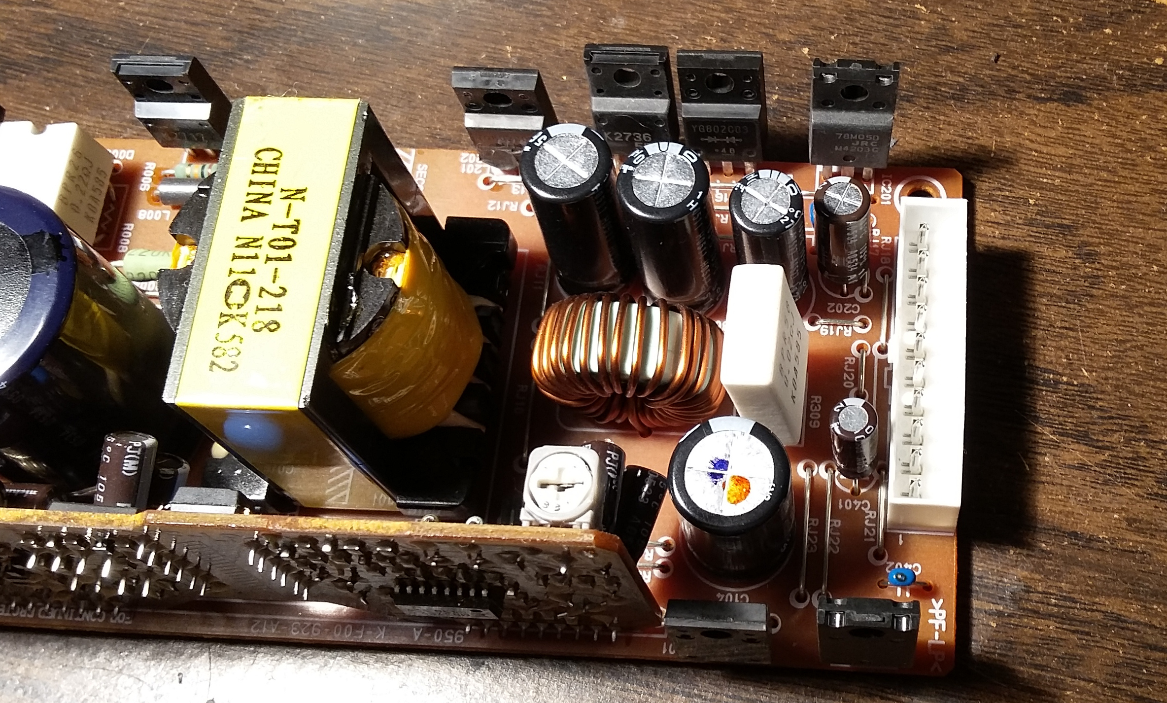

        Well. After much poking around and identifying and looking at some data sheets and tracing some things out and measuring ....
        All the usual suspects (caps and solder joints (a few touch-ups)) are fine.
        12 v has a voltage reg. 5 v has it's own regulator. 3.3 volts is derived by pwm from a K2736 N channel MOS FET driven by a MB3759 Control IC through a A1015 Low-Frequency Amplifier PNP General Purpose Transistor.
        In the printer's old age, something drifted resulting in the 3.3 v line going to 3.48 v causing the 30.1.18 error.
        There is a variable resistor on the daughter board with the IC. I plugged the supply into the printer. While watching my meter, I adjusted the resistor and was able to bring it down to 3.31v. The other voltages are unchanged.
        I've put the printer back together and turned it on. It would only take about 10 minutes or less for the error to come up. It's been running for about two hours. It went to sleep which is something the error state did not allow. I've scanned and copied with it. No error so far.
        <carefully, quietly, patting myself on the back>
        I hope this forum and my story is found and helps other DIYers and the curious fix their HP 4100 4101 MFP printers with the 30.1.18 error.
        I have also read about these power supplies with bad caps. Mine didn't have that problem.
