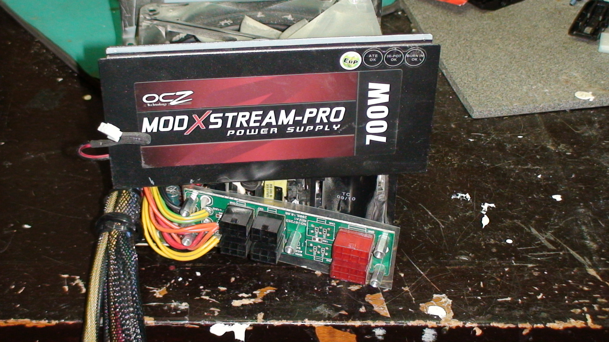

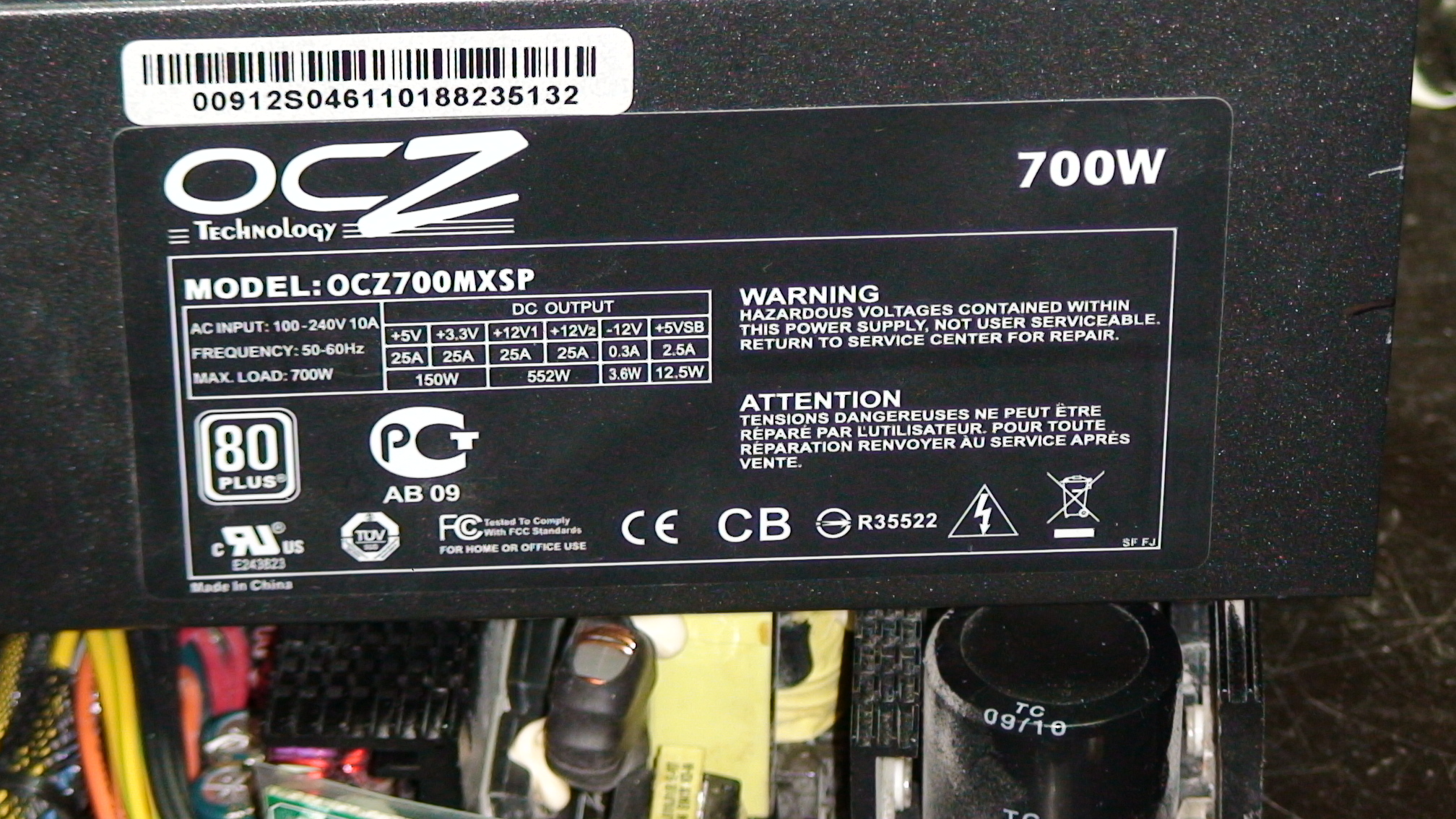

    Hello
    I have a computer power supply which is dead.
    The power supply is manufactured by OCZ model OCZ700MXSP.

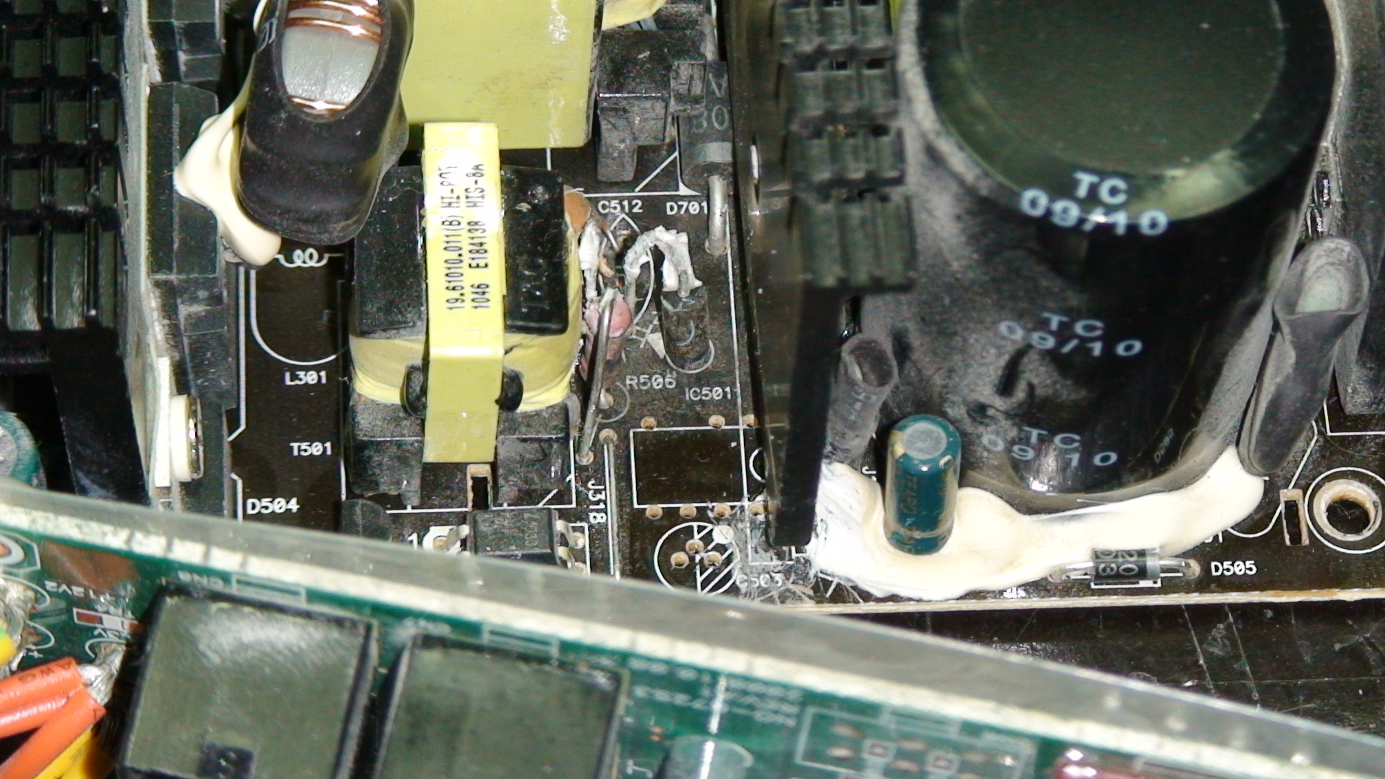

    After some troubleshooting I found a burned IC501. I cannot identify this IC because it is completely burned.
    I was wondering if anybody can help me identify this IC, make any suggestions, and the possibility of getting my hands on a schematic of this supply.
    Thank you
    GD

        It's not the same model PSU, but U501 appears to be a TNY278PN. I would trace your own circuit just to be sure, though.
        TEARDOWN & REPAIR (we hope) of an OCZ MODXSTREAM-PRO 600W ATX PS:
        http://www.eevblog.com/forum/repair/...o-600w-atx-ps/
        IC501 --- TNY278PN, TNY274-280 Tiny-Switch III Family
        https://cdn.badcaps-static.com/pdfs/...b56d9fb7b3.pdf
        Schematic of standby supply (there is an error - the optocoupler is reversed):
        http://www.eevblog.com/forum/repair/...;attach=130780
        Google translation of OCZ repair thread:
        http://webcache.googleusercontent.co...pic240740.html
        It does not turn on, after the storm. Visually - "spaced" PWM duty room (IC501), the marking remains TN, very similar to TNY27x, I put TNY279 - silence, no output voltage, exploded analysis of defective components not identified. Consistently replaced optocoupler (U501), TL431 (U502). corrector power FAN4800IN (U201), in the absence of the original set CM6800G (it was the mention of such a change), - no effect. Question - how correct installation and TNY279 CM6800G.
        Replacement 4800 6800 absolutely correct. It is identical crystals from different manufacturers.
        4800 is not the corrector power - a PFC + PWM. It begins only after the duty room is OK. Even minor glitches in the duty room lead to malfunction 4800/6800.
        To deal with the duty room. TN - is not only TNY 279, and 268, 278, etc. which is often used in the duty room of PD.
        There was mention of the scheme at the PSU, but had disappeared, and all the links lead to "muzzle our site" on trippernye resources.
        P.S. By the way - this PSU full analogue more common Hvirmy binders, namely FSP700-80GLC.
        There used FSQ0270RNA duty room or FSDM0265R. And since PWM duty room data may have several functional analogs, including a pin and the pin, the fact that I was not surprised in this case applied any of TNY series.
        In this case, the duty room, you can put a lot different.

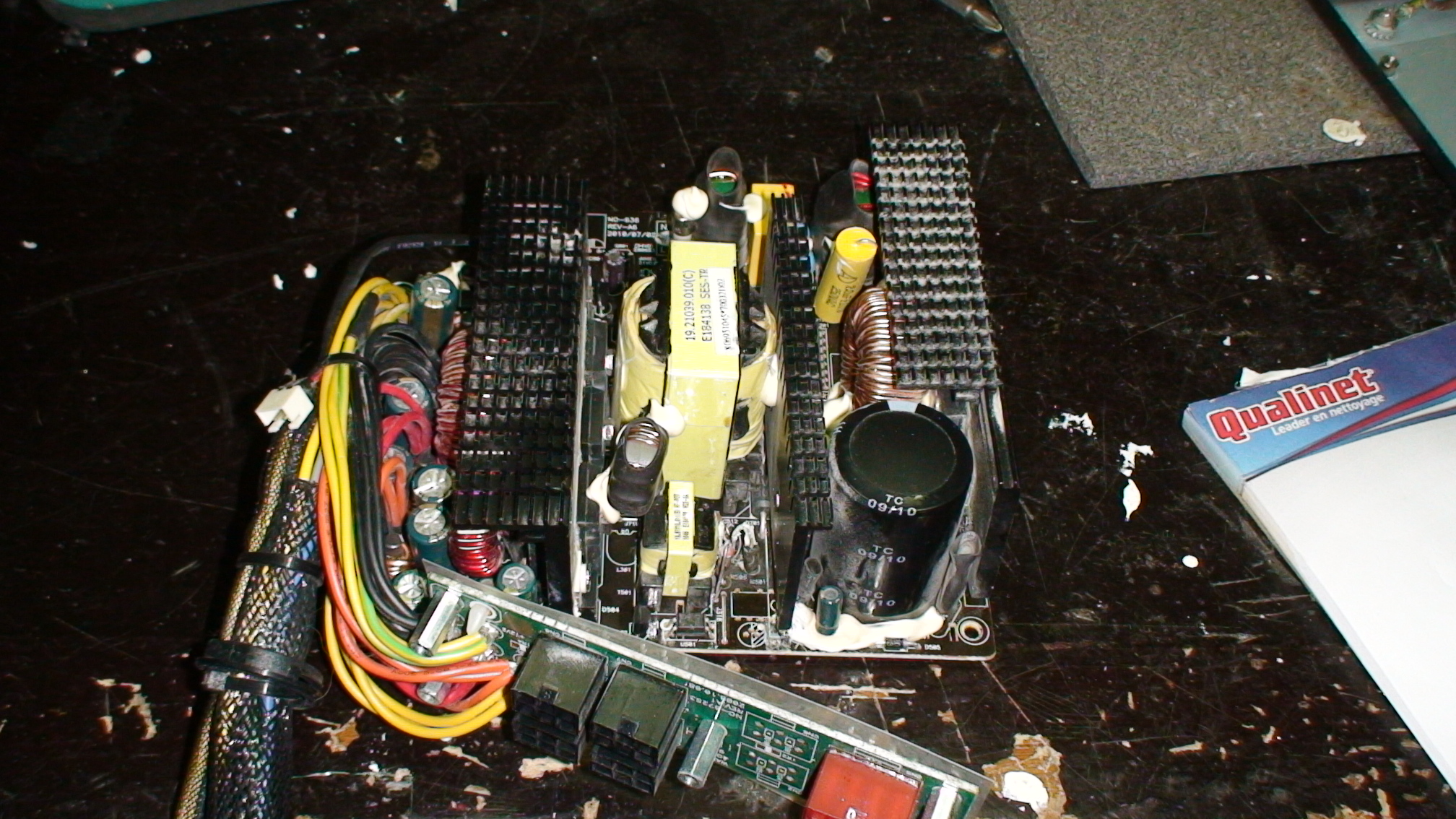

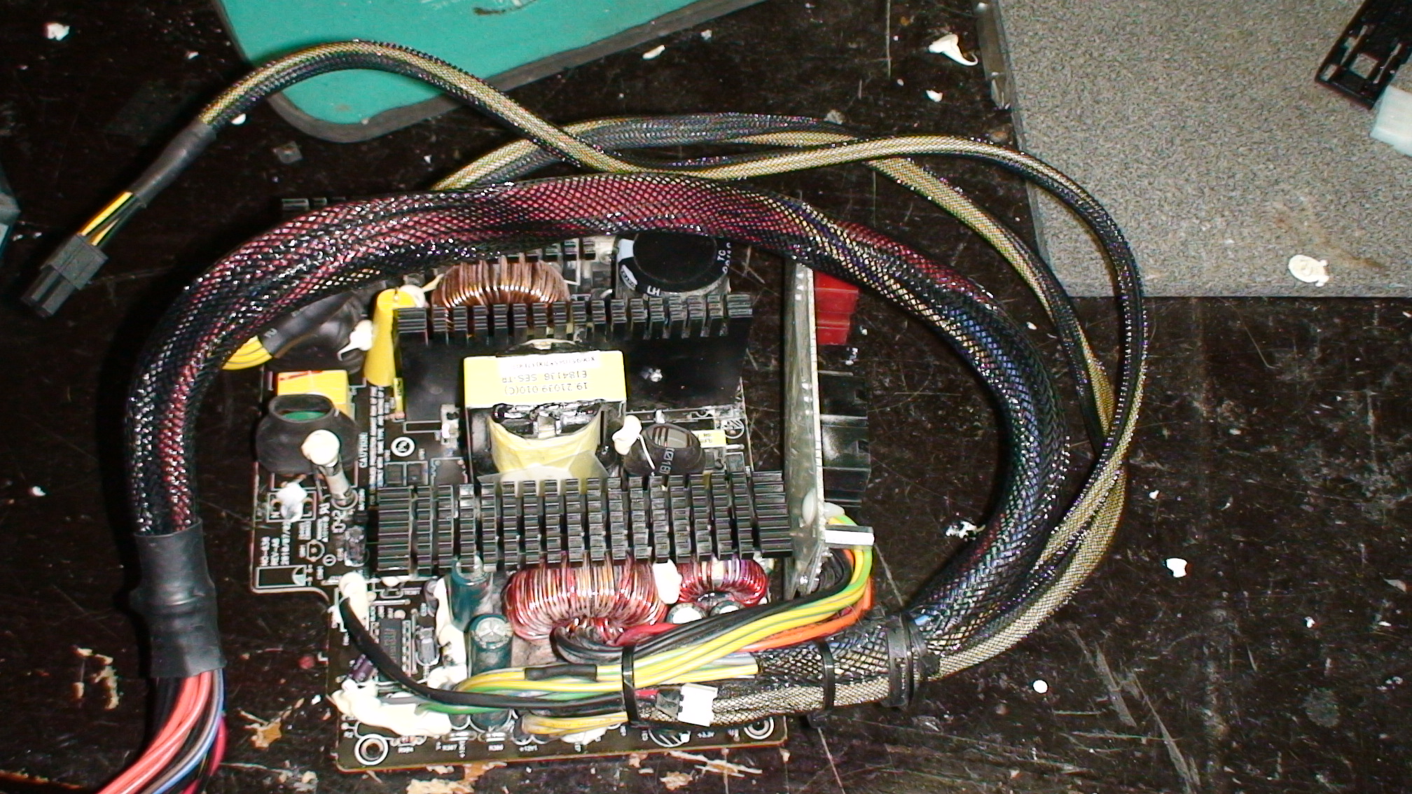

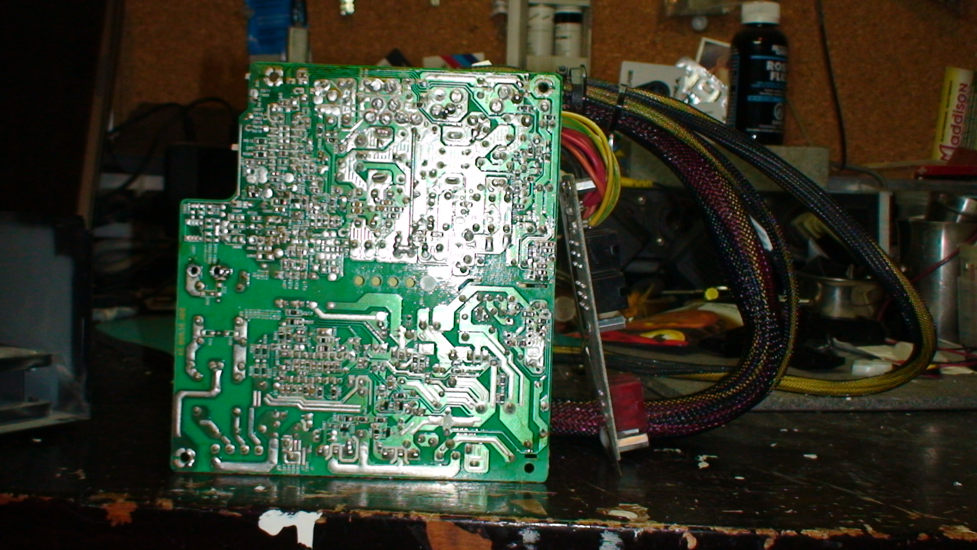

          I have included some PICS of my PSU
          THE CANADIAN
          GD
            • 31163
            Re: Computer Power Supply
            r506 is probably toast.
              R506 is OK it measures 2.2 ohms.
              Diode D501 and ZD501 are also OK.
              Any other ideas are welcome.
              Question: is IC501 output power dependant? Example: for a 600W PSU IC501 is a TNY278PN. For a 700W PSU (Mine), is IC501 also TNY278PN?
              GD

                                I finally found my problem. The main filter cap 470Uf 400 volt read .66Uf on my fluke 76 DVM. Therefore I was getting unfiltered AC volts going to IC501 which was blowing the Sh.....t out of it. I replaced this cap with a 470Uf 450V and now the PSU is working just like new.
                                Thank you guys for all your valuable input.
