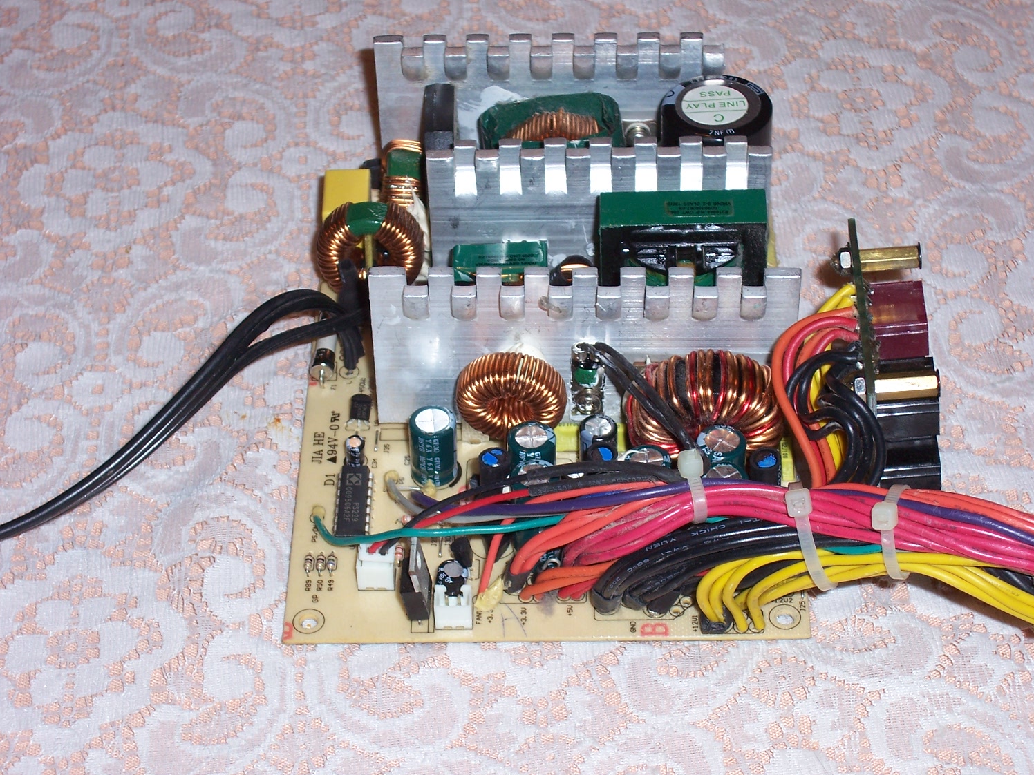

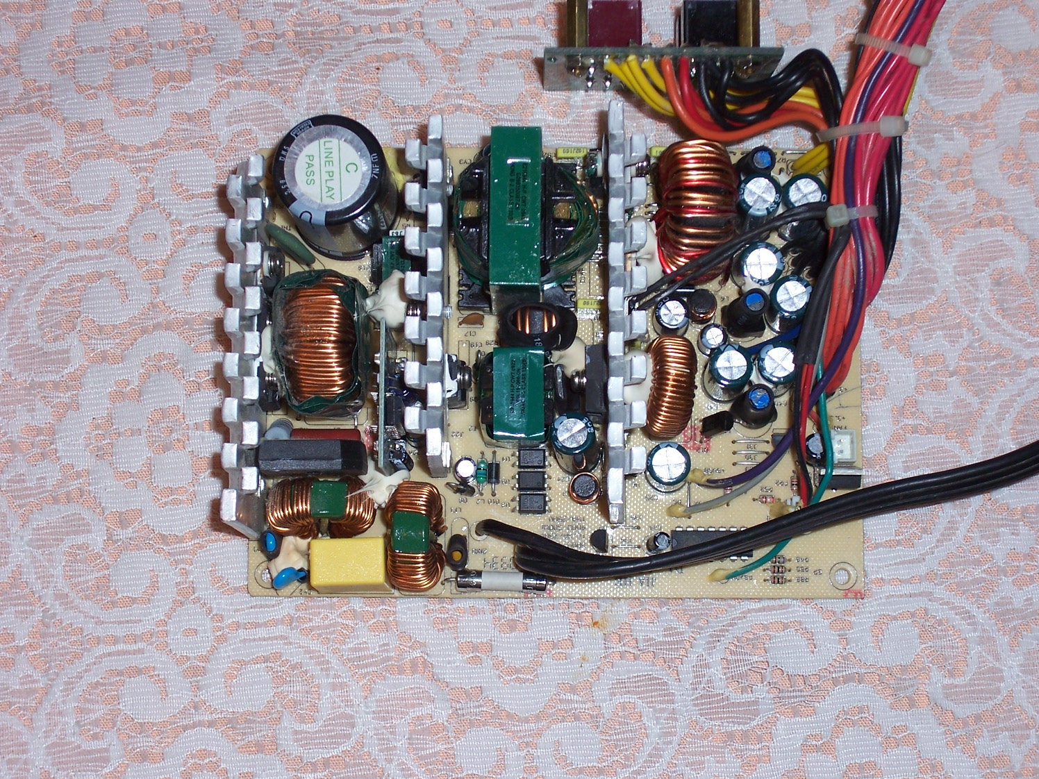

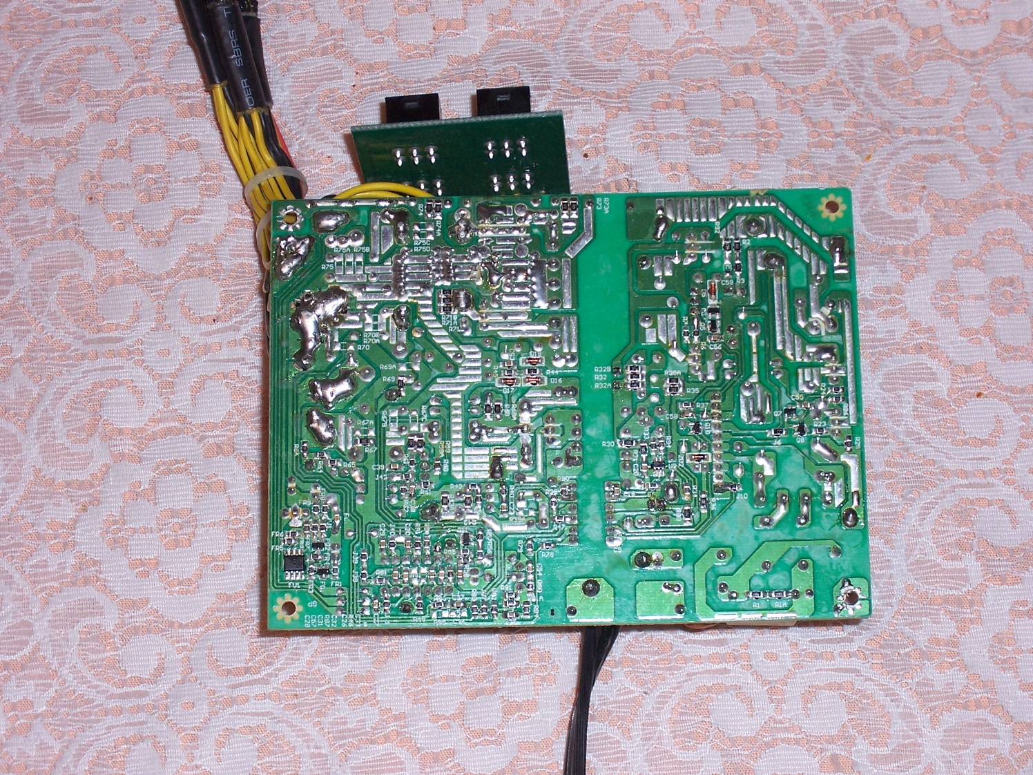

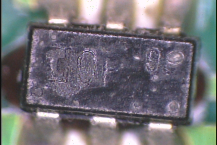

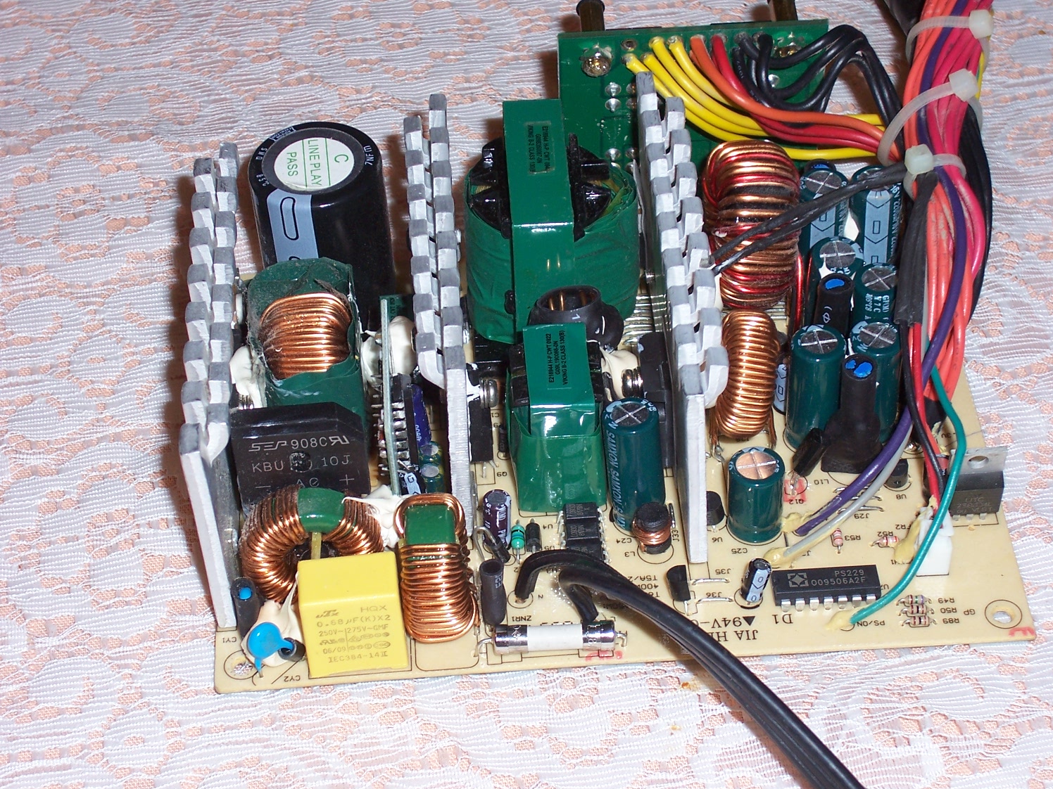

I have a dead Thermaltake TR2 RX-550. This one has me stumped! Fuse OK, 166 volts to the main capacitor, but no 5vsb. For the 5vsb circuit, it has a 6 pin pwm surface mount chip on the bottom of the pc board which drives a TO-220 transistor. I cannot identify this chip. Can anyone tell what it is?????

I went looking for something like that for a TV power supply. I picked the R7731A from this selection.
http://au.element14.com/webapp/wcs/s...4239,111853290
I found parts from many other manufacturers that would have worked also.
The choice was between two basic types where the difference was the function of pin 3.
With one type, pin 3 is for connecting a resistor to set the frequency. Pin 3 on the other type is to connect a thermistor for thermal protection. Send us a close up photo of the surrounding components.Last edited by rievax_60; 12-22-2015, 08:55 PM. -
Re: Thermaltake TR2 RX-550 dead
That is functionally the same as the R7731A and a few others that I found. Pin 3
is used for a frequency setting resistor.Comment
