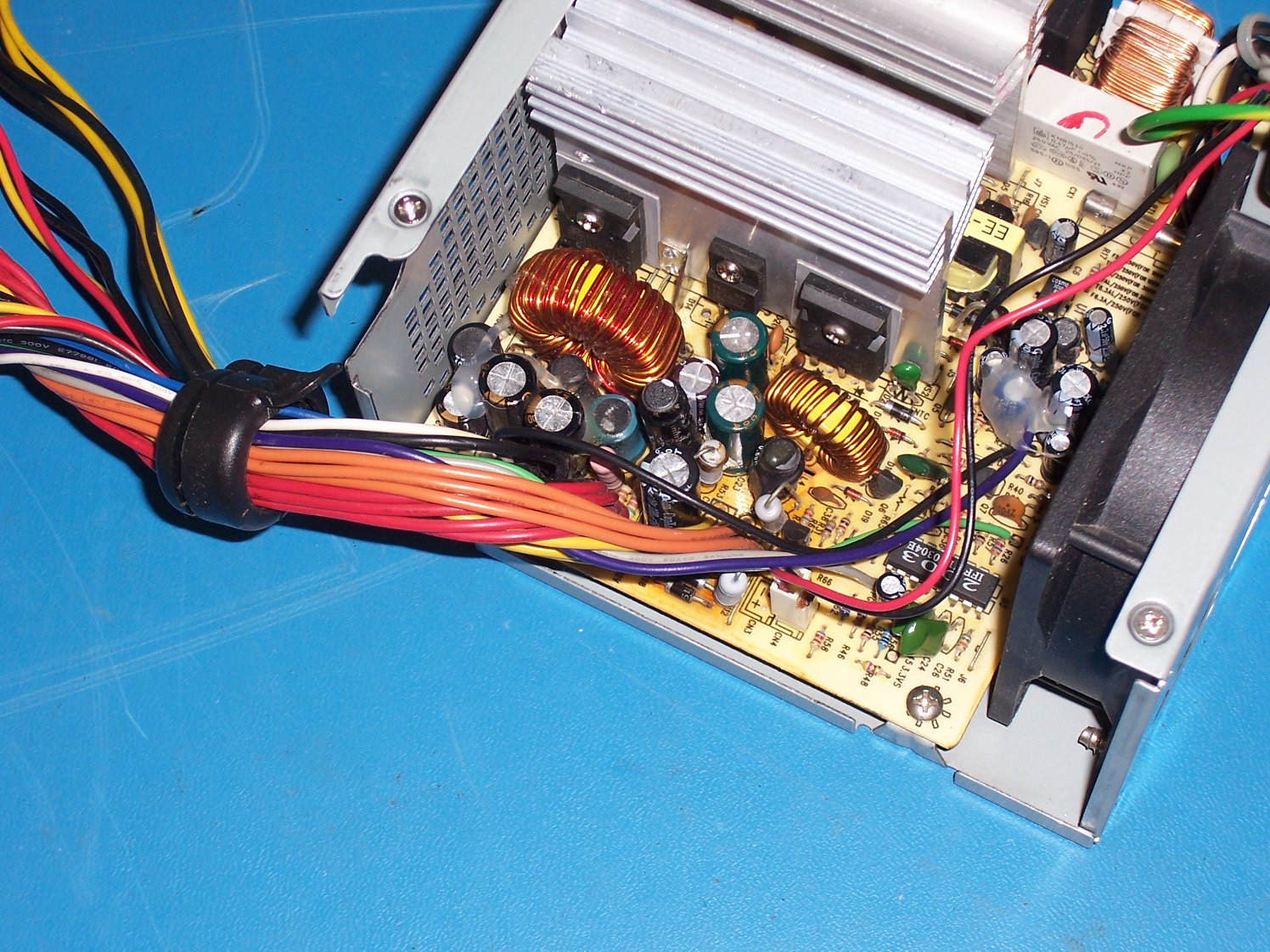

      Here are some pictures of the L&C B350 ATX completed with output capacitors replaced and sporting a much improved line filter and bridge diode. It is powering my FIC K7MNF-64 motherboard so that is where I will leave it for now. If I were to want to improve it more later, I would beef up the output diodes, especially the one on the 12 volt rail. I would also increase the lone 12 volt output capacitor from 2200 uF to 3300 uF or maybe even 4700 uF. Anyone have a recommendation for the value of the output capacitor?

        3300uF for 12V would be enough provided it is low esr and not GP.

          You used Teapo SC to recap those failed? I hope they measured in spec.
          Nevertheless, good work, as always!
