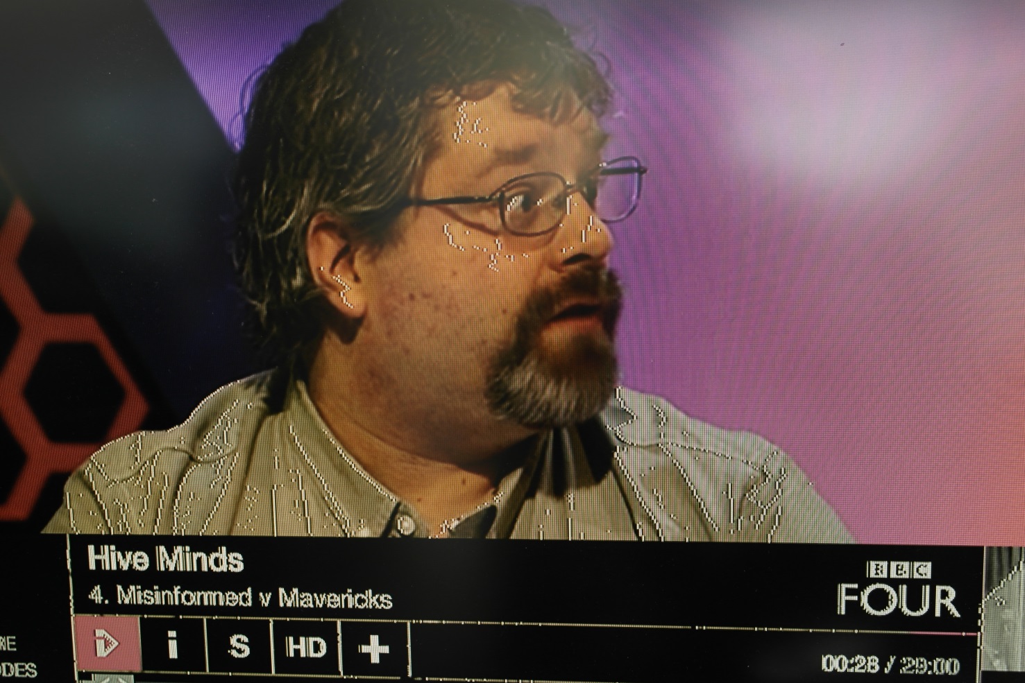

    Hi
    I have seen the same fault (see photo) a few times on LG's on this occasion it happens to be a 37" LC55, but have seen the same fault on different models & sizes. I do suspect the video board but wondered if anyone had come across this LG fault. The same fault is on the tuner and HDMI, When you look at the test patterns with the 'service remote'. the colours are fine, sort of hoping that it is a PSU or software fault, but suspect is is the main video or T-con board.
    Advice appreciated
    thanks
    junger

    Ahh this uses an Auo, I got one same model a few weeks back the lcd screen had failed and was causing some weird glitches like image retention and what looked like bubbles on the screen.

      kind of reminds me of the AS15 chip issues.
