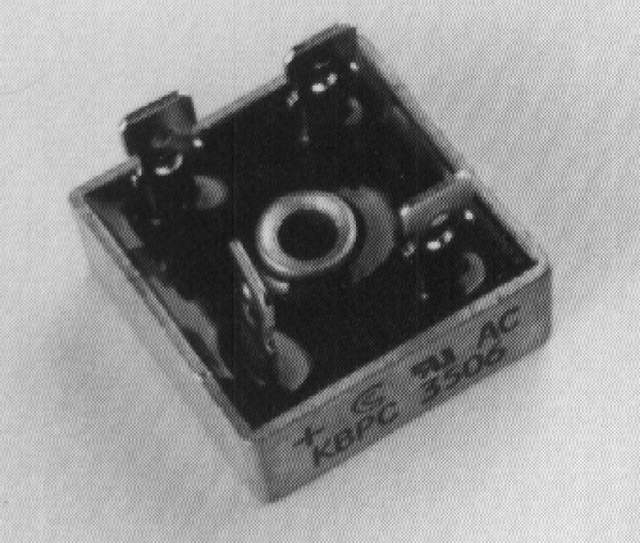

          Thanks for photos. I had hoped that this would help identify the input rectifier. Unfortunately not. It is highly probable that this rectifier has failed and blown the capacitor so it needs to be found and tested and then replaced if required.
          The identification requires some knowledge because these devices come in different packages. It can be found using an ohmmeter (multimeter set to low ohms). Each terminal of the capacitor will be connected to this rectifier. The negative terminal to neg of rectifier similarly the positive of cap to positive of rectifier. So you need to check that both cap terminals lead to the same device. The rectifier will need to be checked for shorts normally there will be a diode connected to every two terminals of the rectifier. No diode = a short. If the test meter has a diode test position select this function. A diode can be identified by placing the meter test leads across each terminal pair in turn. Then do the same with the leads reversed. A diode will give low resistance one way and high resistance the other.
          See how you go.

              Unfortunately as I said earlier the rectifiers come in different forms. I have to date described a single device with four terminals. The basic alternatives are:
              1. Four seperate rectifier diodes on the PCB.
              2. Two three terminal dual diodes each clamped to a heatsink both connected to form the four diode rectifier required.
              So when probing what the cap terminals are connected to, bear in mind these three possibilities.

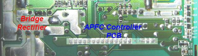

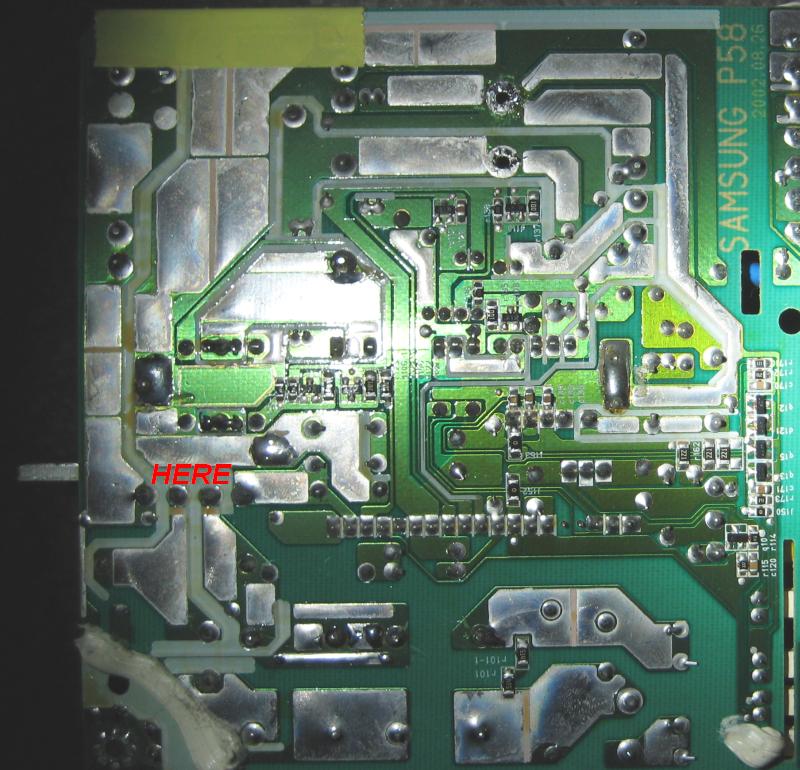

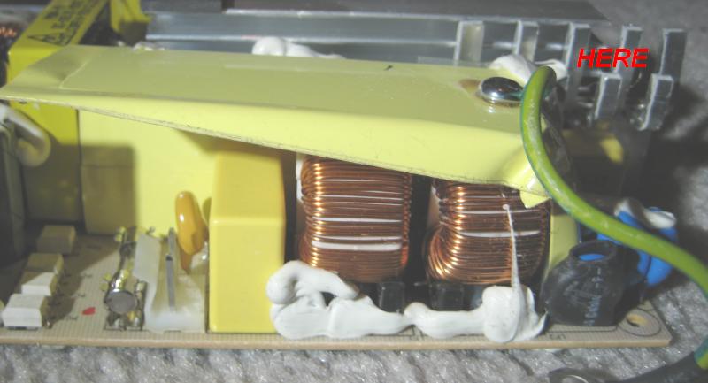

                from the pics and I am only guessing,
                I assume the mains is feed to the 2 pin connector and this part looks like mains type filtering etc
                its possible the bridge rectifier may be mounted on the small finned Heat sink HERE
                In fact looking at the bottom pcb tracks it fits with that location HERE
                (if I read it right)
                There is a chance as davmax has also said it may be stuffed so may be the quick option would be to just replace it.
                Since it has by the looks of it a multi pin PCB stuck in the middle of the mains section yep I'd say It uses APFC.
                  Yes!
                  I would agree as I cannot find more then one or two larger descrete diodes and the other 3 pin parts that are bolted to the other heat sink are all singles and I asume that they would have to be a pair.

                                OK found the issue...I got some 35 Amp Bridge rectifiers (cheap)
                                seems what its got stamped as AC + DC isn't the case
                                (now I guess I know why they were cheap, just hope there right specs and its only a case of some idiot stamping them the wrong way round)
                                NOTE HOW the +DC pin is in a different orientation to the other 3
                                AC & +DC is reversed on that pin..confusion rains
                                so yeah the above (post) is correct with the bridge and multimeter
                                the + - DC should show like 2 diodes in series one direction and open circuit the other
                                (mine show higher then the sum of 2 numbers wise)
                                With the package above AC I/P are diagonal to each other ditto DC + -
                                (I know thats not the package you have was just using it to check what my DMM would show in comparison to yours)
                                So either something is wrong with it or (more likely)
                                your turning on another junction somewhere
                                To be sure remove bridge or if you can isolate either DC + or - from the circuit
                                Test again (thats a bit of a tall order I know)
                                CapXon are I believe crap so maybe it did self destruct but there is a risk it didn't and throwing a new cap in could end in the same failure.

                                    BTW so we are all clear here I think the Bridge Rectifier is OK I think its just
                                    another junction turning on somewhere.
                                    I had a look and as I said before I think this is the "APFC controller PCB"
                                    (there are 2 vertical PCBs) and the one I suspect maybe it is buried between the yellow covered heat sink and the other big one so no way you will be able to look at whats on that without removal.
                                    (See the full pcb photo above if this is a bit unclear location wise)
                                    So maybe the next step, question is
                                    what is most likely to fail on an APFC PSU and kill the Mains type cap? while not in use?
