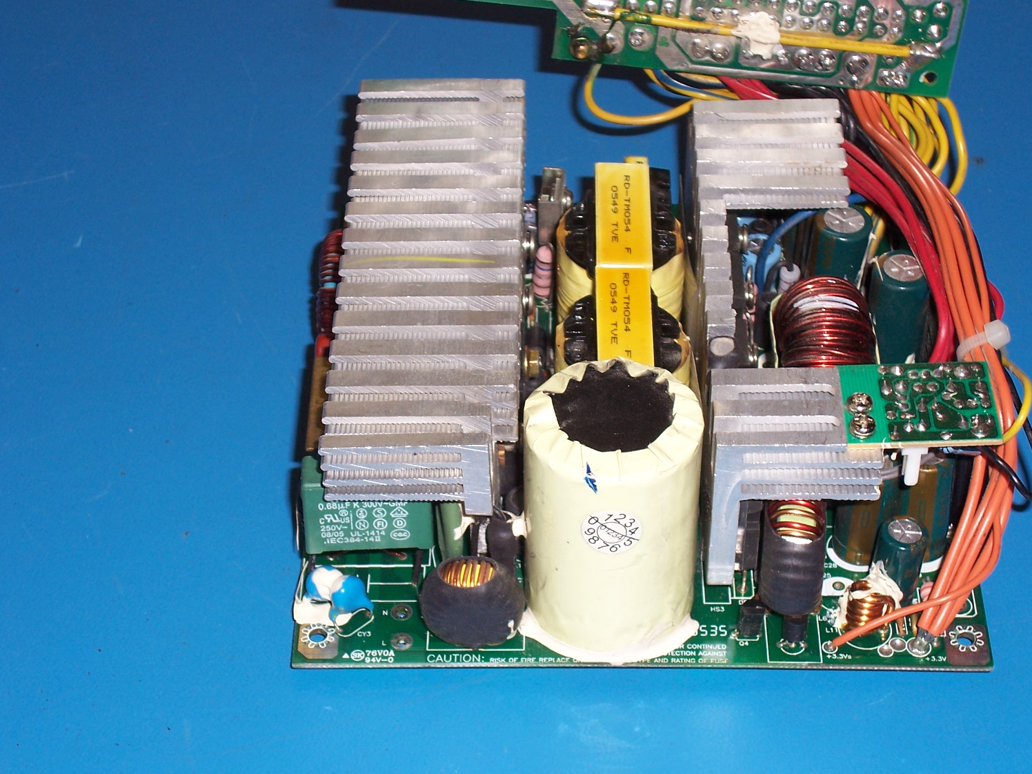

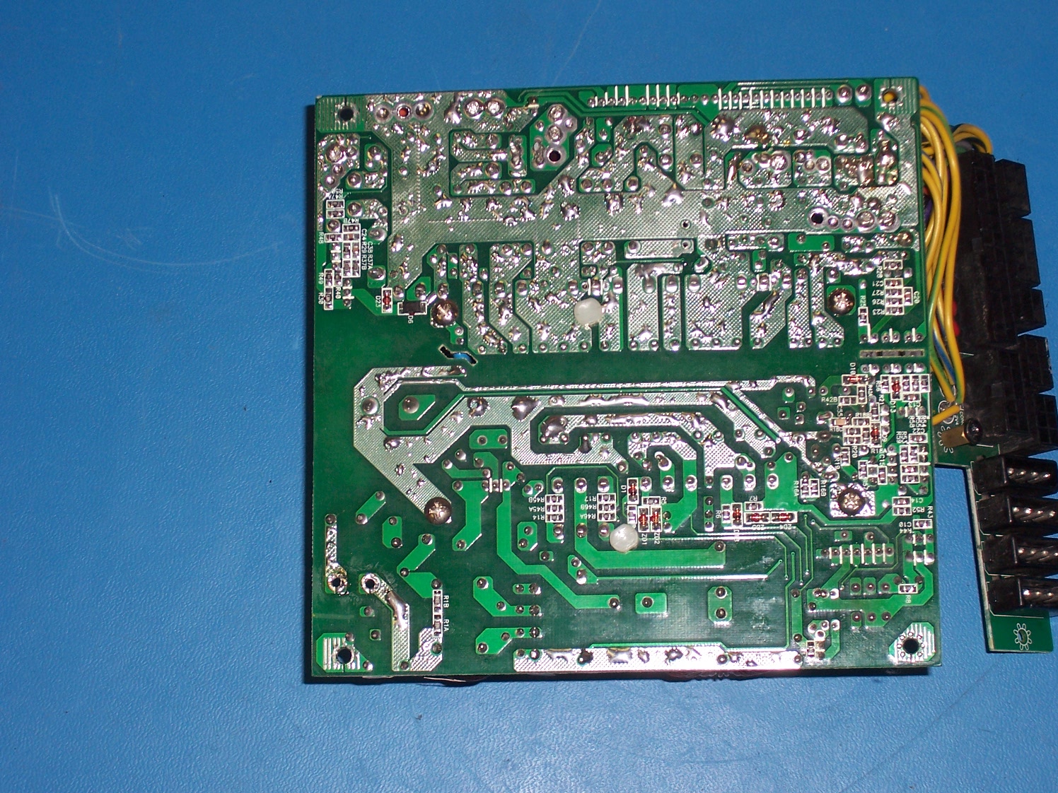

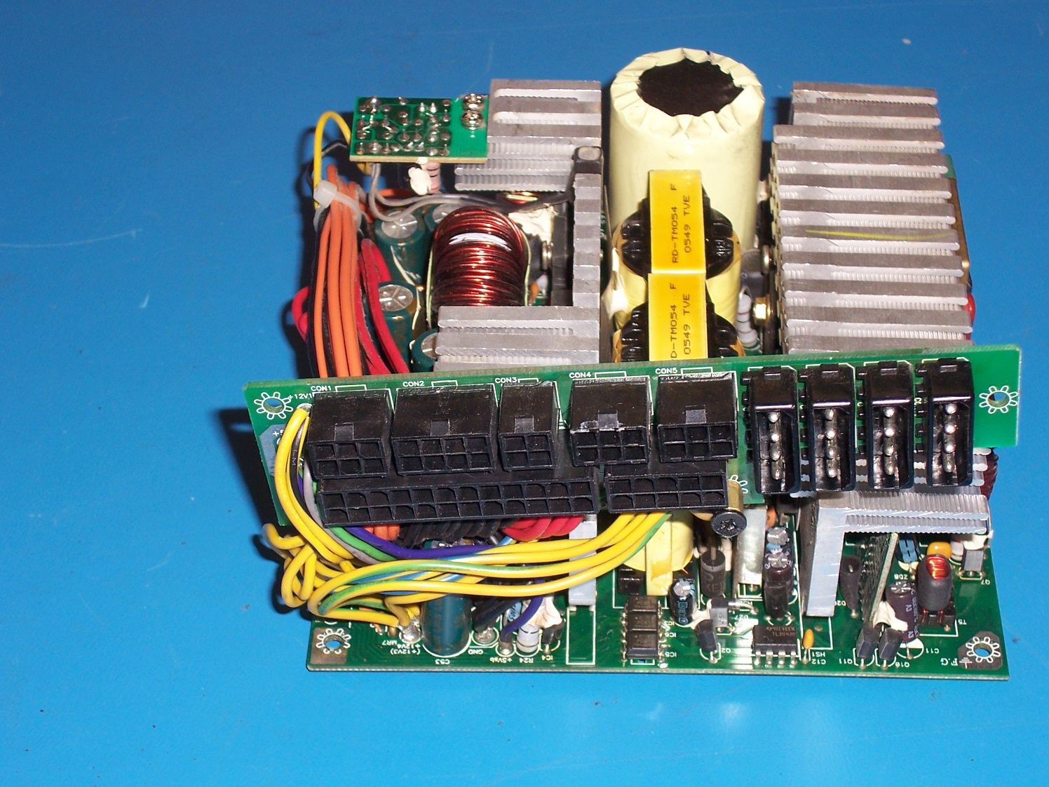

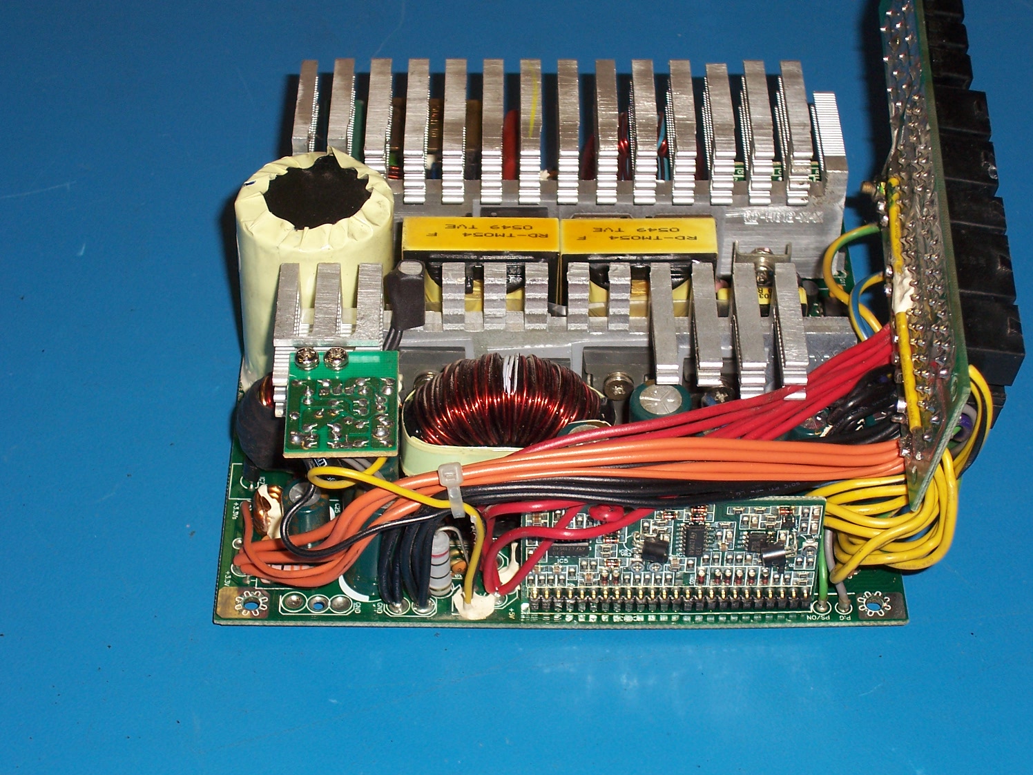

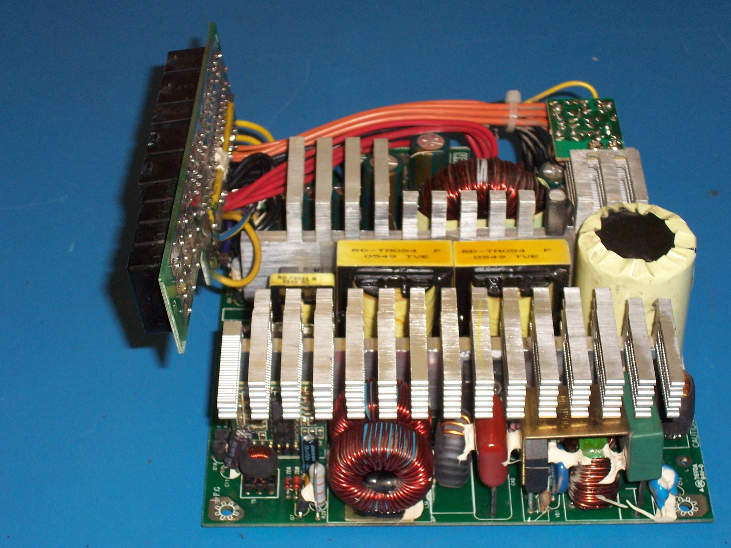

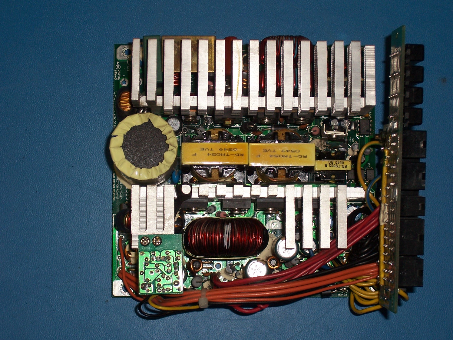

    Another power supply to play with, this time something that looks much better than the I-Micro units I have been blowing up! This is a Silver Stone SST-ST60F rated for 600 watts. Opened the case and first thing I found was a ADDA sleeved fan stuck. Next, I found six Teapo capacitors bulging. All six were Teapo SC series 2200 uF/16 volt capacitors. All six measured capacitance 24 uF to 57 uF. esr on all six measured 1.9 to 2.9. Definitely bad. Size is D10 L32. Only thing I found for replacement was Nippon Chemicon KYB series. Also found some Rubycons that might work. So what do you think?

    Another Death Adda victim. It's definitely worth fixing, though. If you gave it a full re-cap and gave the fan some proper lubrication, it would be a decent enough PSU.

        why the tape around the primary cap? strange thing to do.

              That thing has pretty much the same PCB Layout as my ST-65ZF, just a different set of heatsinks...
              So it's definately NOT Impervio as I mentioned earlier.
              It is made by Enhance...

                    Be careful with that double sided PCB, they are a pain and easy to damage. I wonder what is the brand of that primary cap and if it is 105 rated?

                      The primary cap doesn't really matter. Well, with a shitty line Voltage it may matter a little.
                      But 105°C or 85°C doesn't really matter especially when it's rather far from hot components and gets great airflow - as is the case here. So the Primary capacitor should be one of the last things to fail - exept it had to take some overvoltage...

                              The new output capacitors have arrived from Digikey and have been installed. I applied power to the power supply - no bang. The 5vsb measured 5.11 volts. Great start. Now all I have to do is locate some modular cables. Can't do anything more without them.

                                Those modular connectors look basically like the same as on the other side of the cables normally attached. So you can make one cable from two desoldered ones.
