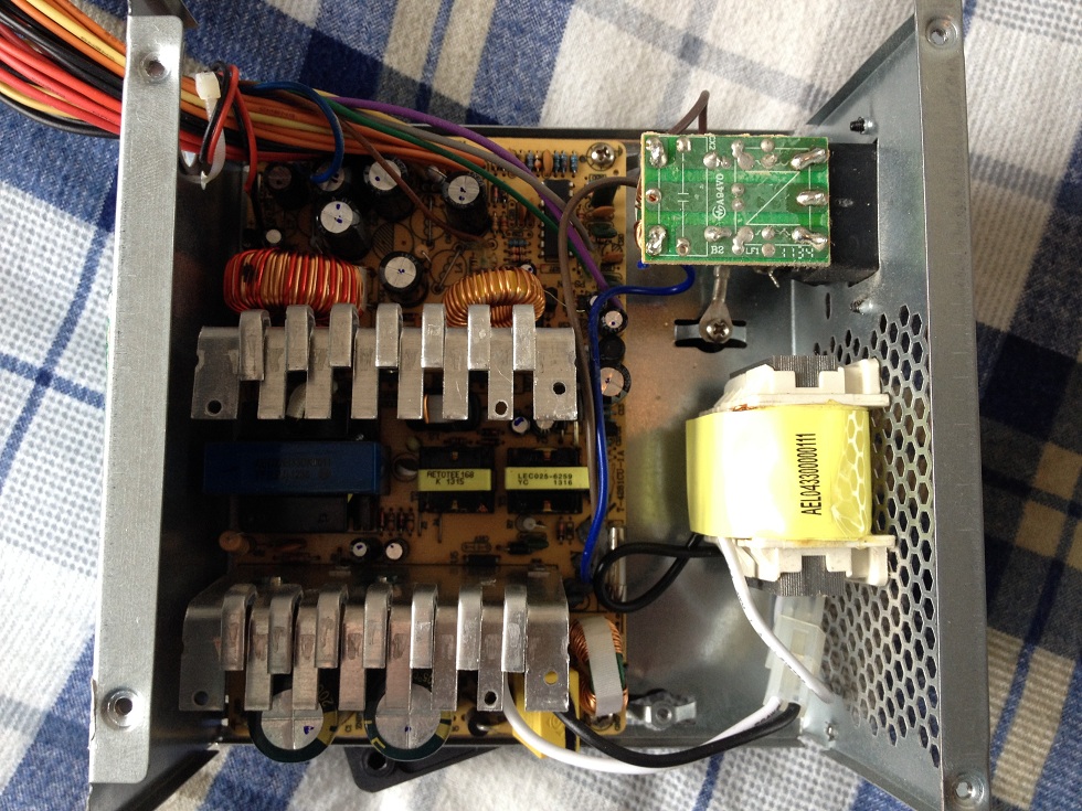

    Hello again,
    I've got a "Model: LPJ19-25E 3*SATA" PSU here which came with a case. (no worries, it was free )
    I only used the case because the PSU is having a "cheap" label which has got all the watt ratings on it and the chinese children that have made this unit only had to put a small sticker on it to make clear which unit it was on the list. The case is also made from very, very thin metal. It was all bent up at the place where you insert the power cord and ik could even bend the case with one finger, it is even more worse that the L&C units.
    So, i've opened the casing (with very little hope) to expect a ~150W unit with no input filtering at all. But after all, it's better than i expected. So let's take a look!

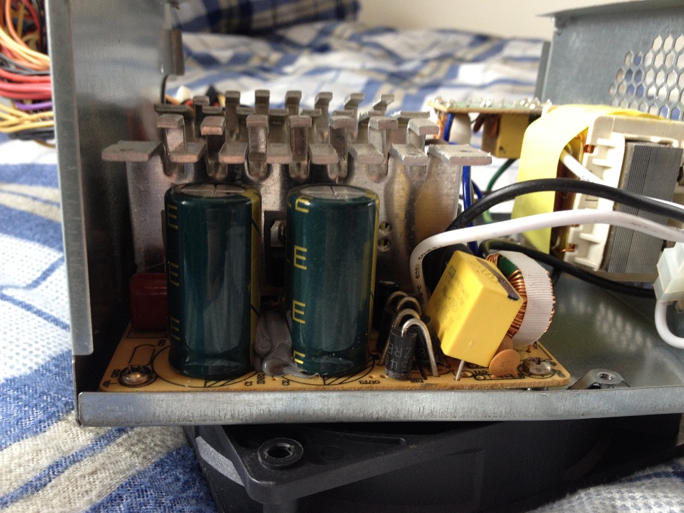

    Let's start with the primary filtering. This unit has got: 2 ferrite coils, 4 Y-caps, 2 X-caps and a NTC thermistor(?). Only missing a MOV here. The psu also has got a PFC coil (passive PFC) which looks like a real one, in can see some windings sitting in there. This really surprised me, a almost complete primary filtering stage, all the spots on the pcb for it are filled!
    And now the primary... Because this is a 230V only PSU the primary side has only got to do 2A continuous, by the time this PSU needs 460W from the grid it should have already been exploded. The input caps are 2 200V, 470uF, 105° (LE YC) which are a bit on the small side, i doubt if they really are 470uF. This PSU doesn't have a rectifier bridge but has got 4 1N5408 (3A, 105°) diodes which should be enough. And the primary switchers are 2 D304X (12A, 400V, 100W power transistor).

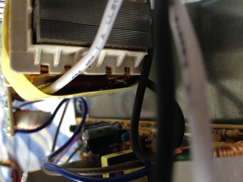

    The transformer is a AETOJEI33DN0011 which is probably a EI33. That will do about 250~300W.
    The heatsinks on this unit are a bit mediocre, i've seen worse on some cheap units but i've also seen far better on somewhat more expensive units.

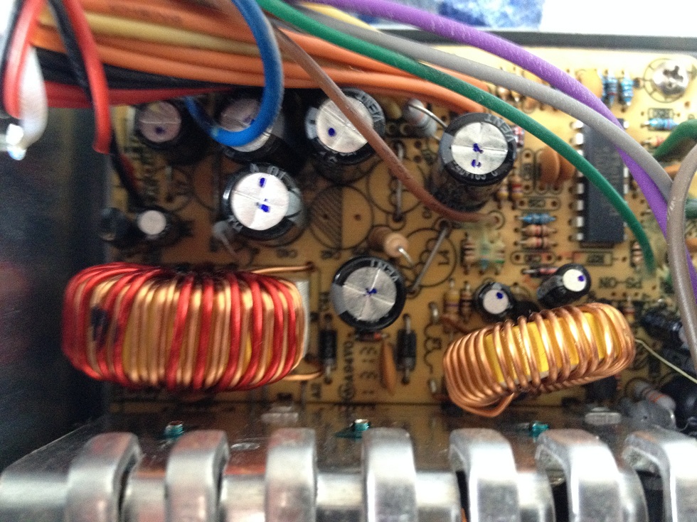

    The secondary side has got 3 recitfiers;
    12V: MBR30100CT (30A, 100V, Scottky )
    5V: S20C45C (20A, 45V, Scottky)
    3.3V: S20C45C (20A, 45V, Scottky)
    So this unit has got full Scottky, which is good. And it seems like this PSU is a 12V heavy design
    And the secondary filtering: (aren't sure of which volt line they really are, but this seems the most logic way)
    12V: 1x 16V 2200uF (YC)
    5V: 1x 10V 2200uF (YC), 1x 10V 1000uF (YC)
    3.3V: 2x 10V 1000uF (YC)

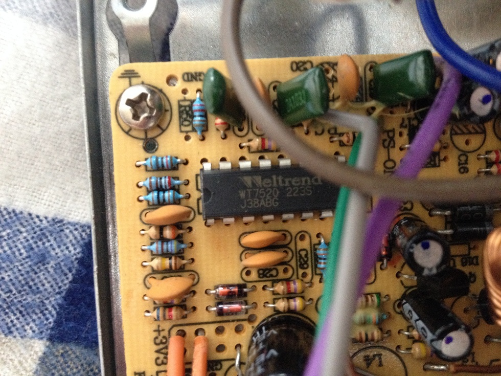

    And the pwm (or supervisor?) chip is a:
    Welltrend WT7520
    The PSU has also got a temperature controlled fan and the thermal probe is glued to the big coil at the secondary side. But isn't it better to mount the probe to the secondary heatsink instead of the coil?
    So what do you guys think about it? How much could this power supply really deliver?

      That's a shame that they didn't put pi coils. You can do that yourself using coils from a dead psu.
      Put some 680uF primary caps and you will have a 300W peak psu
      The 2 D304X switchers are capable of doing 300W and maybe more.
      Check the heat dissipation. That PPFC coil is blocking the airflow...
      Replace all the 1000uF caps with 2200uF good caps, except of the 5vsb and negative voltage.
      If there is only 1 spot for 12V use a 3300uF capacitor there.

                        The transformer isn't the main bottleneck. I have successfully pulled 400W+ from one EI-33, without anything melting.
                        The two main sources of losses are the output rectifiers and the output inductor. This is why you will see large toroids wound with beefy wire and 60A+ of diodes on a 24 or 30A output rail in quality, brand-name PSUs. To minimize losses and achieve higher efficiency.
                          So if i replace that 5/12V output toroid for a bigger one and put a ~40A recitifier in it it will do noticible more power that what it now could do?

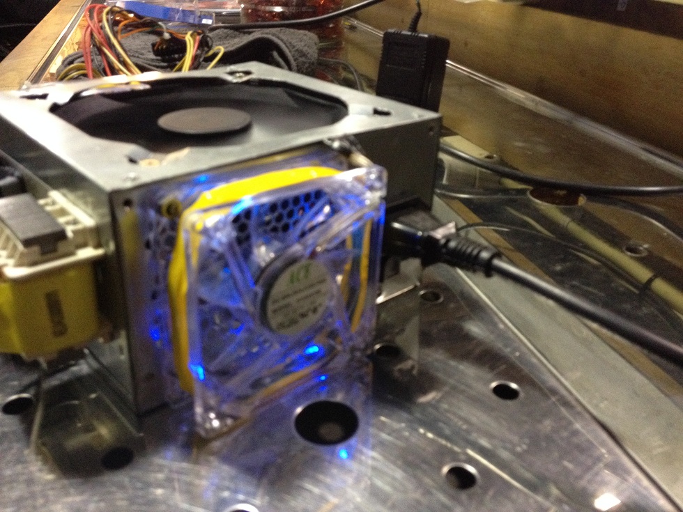

                          Anyways, i've tried to install the bigger caps in the unit, but they were too thick... So i was beginning to think outside the box, literally
                          So here i present, my tri-fan back to the future psu:
                          (you're now going to look at the attachements)
                          Oh well, overheating will be difficult for this one

                            Yes, if you replace the output toroid and use diodes of higher capacity you will get at least an extra 50-80W stable output compared to what it does now. Also regulation will be significantly improved at all load levels because the change in both voltage and inductance over the entire load range will be smaller.
                            Fun fact: Linkworld did actually make a PSU with three fans in it, just that they were all 80mm.

                                    That actually looks super cool. Probably not too safe with all of those exposed wires. But since this is for your own use only, it is fine .
                                    And no, don't remove the passive PFC coil. Besides improving the power factor, it also tends to act like additional filtering on the primary side (sort of like a huge common-mode choke).
                                    The PSU looks quite decent otherwise. I think 300 W peak and 250-ish W continuous is about right. Could probably do 250W easily without overheating, especially with that 30A schottky on the 12V rail.
