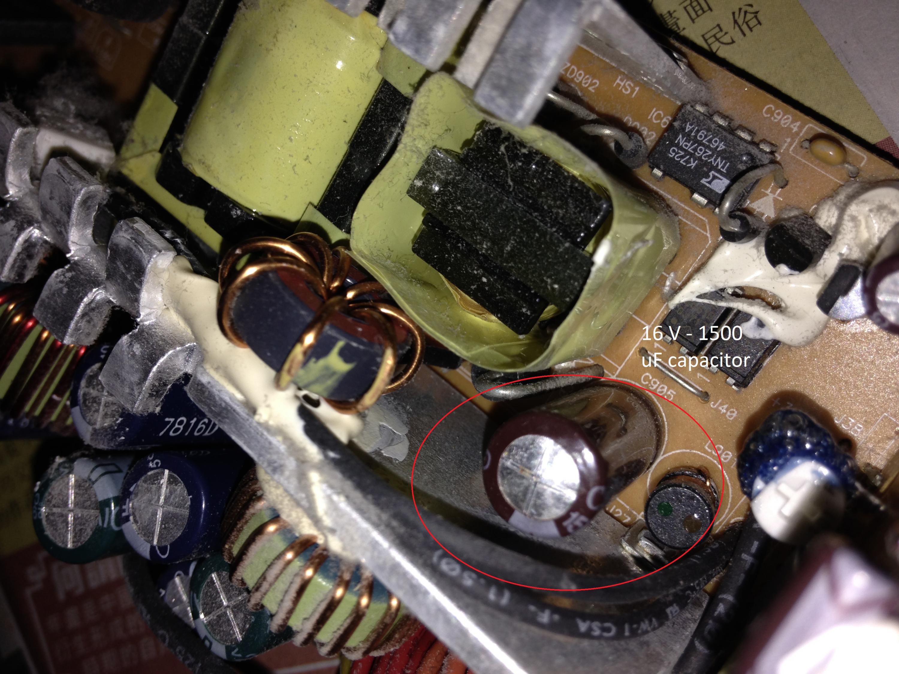

    Well, I can't complain as this power supply has been in my Dell vostro 200 slim computer at the office for 7 years. When the PSU died; it did not seem to take out anything else either which is a bonus.

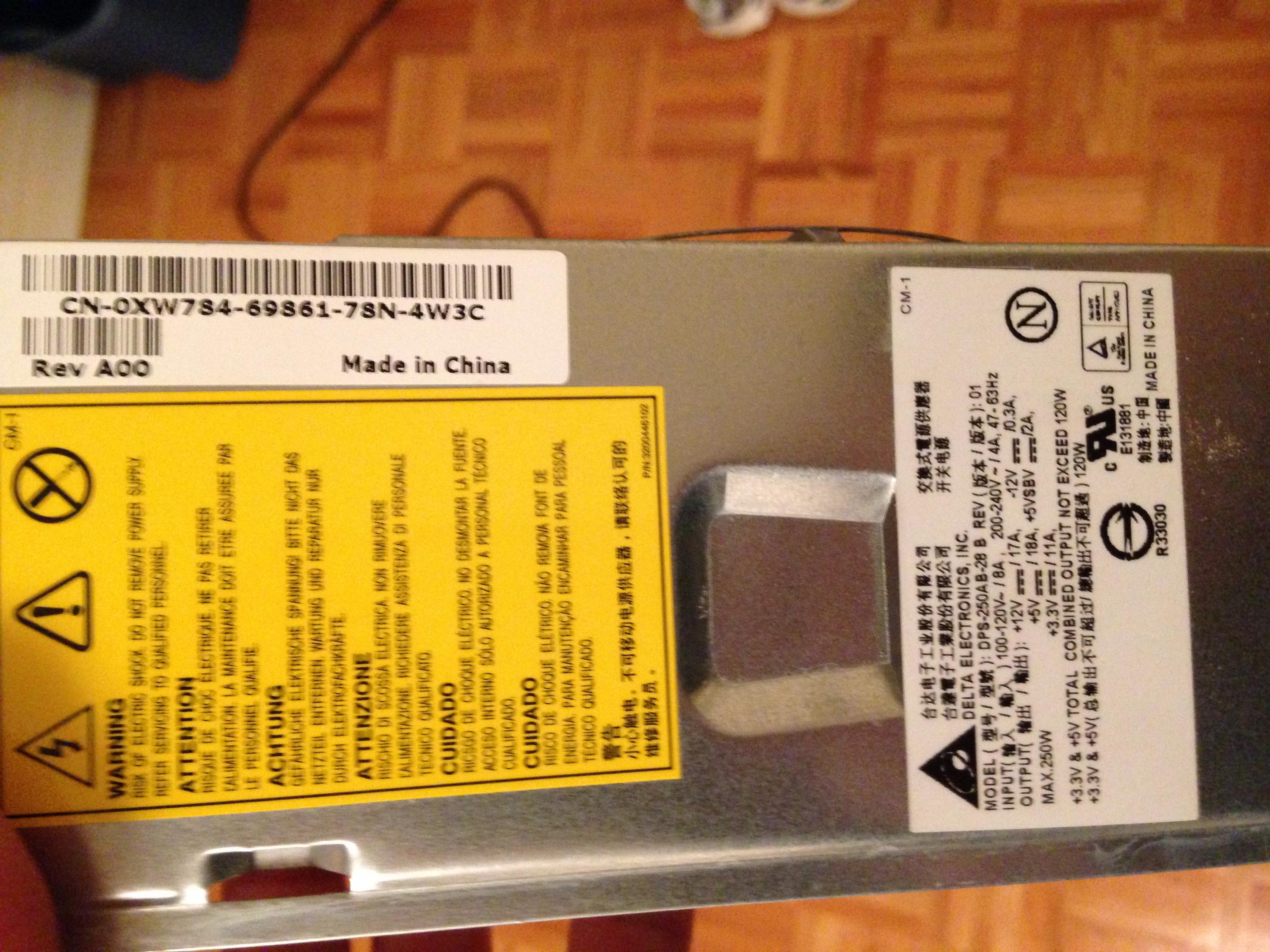

    The power supply model is:
    Delta electronics - DPS-250AB-28 B
    These slim form factor pc's from dell were marketed as the Dell 200s or the Inspiron 530s here in canada.

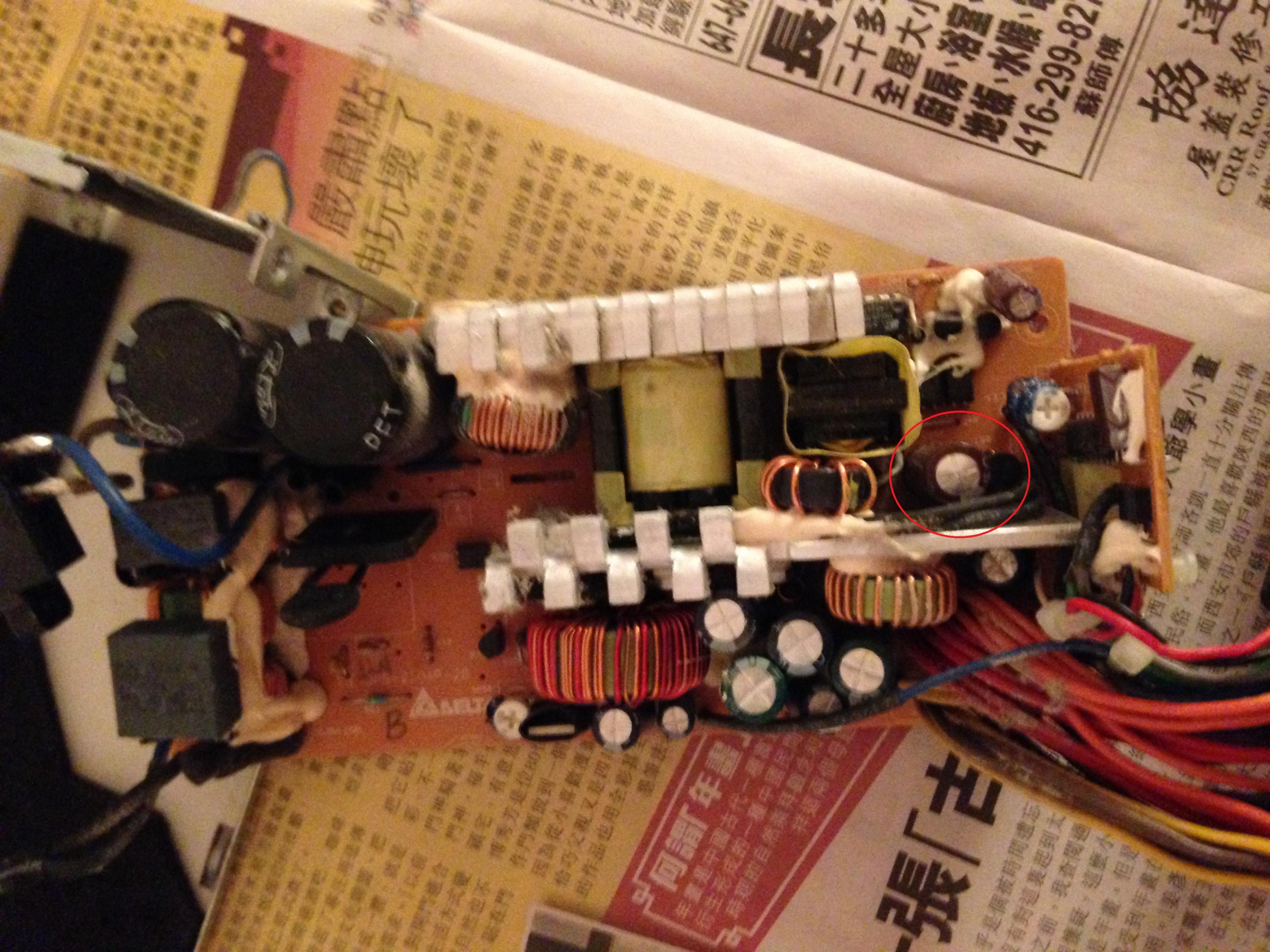

    Surprisingly, the PSU's are a TFX form factor manufactured from delta. The soldering inside was very good. Not sloppy.
    One morning, the PC just would not turn on. Looking at the motherboard, it was still receiving power (amber light was dimmer though) so I think it might have been a standby circuit capacitor that died.

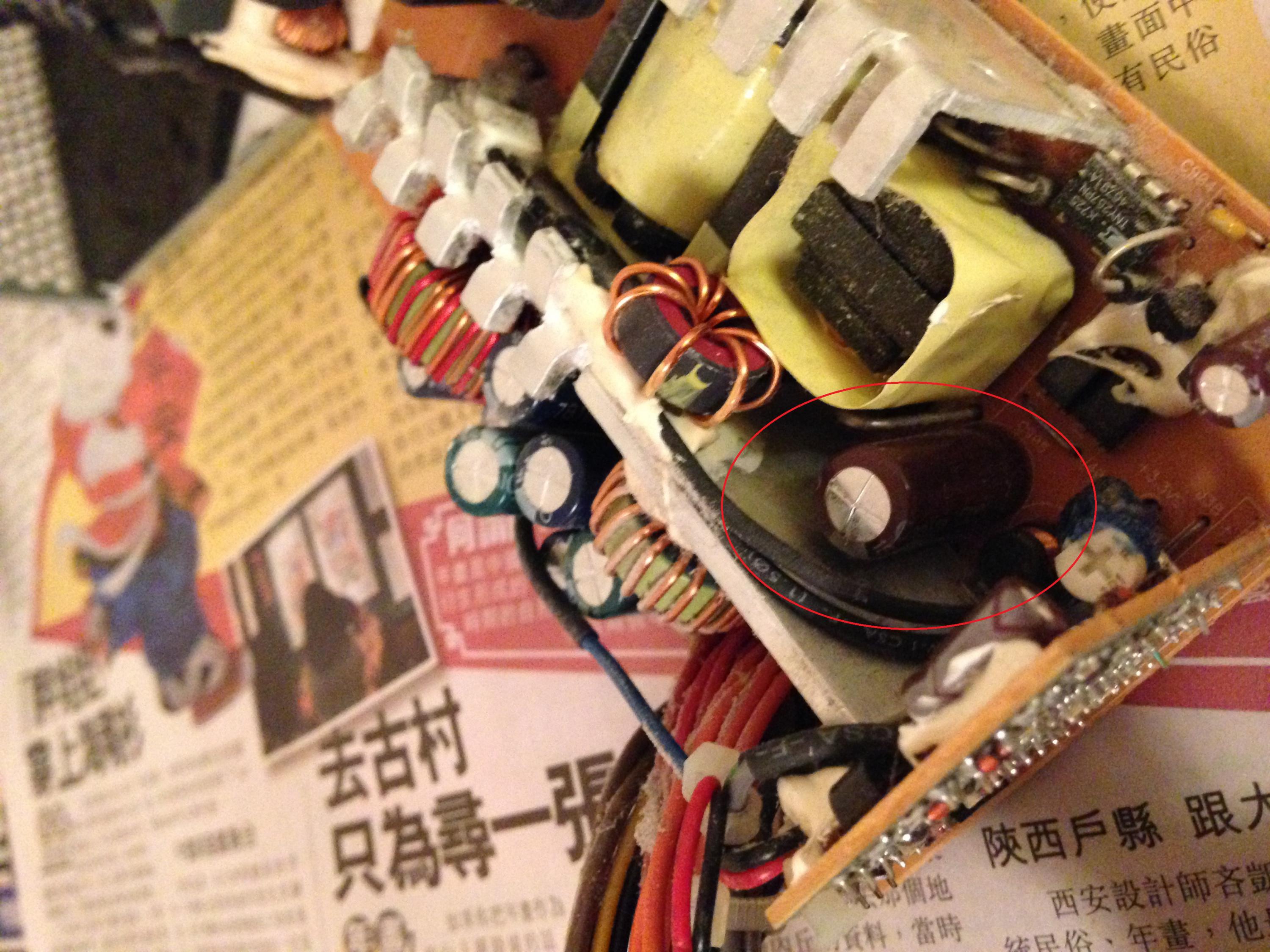

    Opened up this 7 year old psu (that sat inside a cupboard with a small windo) and the ONLY capacitor that was bulged was a 16v-1500 uF capacitor from.... CapXon.
    I replaced it with an old nichicon cap I had lying around and the unit powers up. I'm not sure how reliable it will be now and if any of the gurus can tell me if this is just a standby cap; that would be great.
    I have enclosed pictures. I apologize for the blurriness.
    There aren't many forum discussions regarding TFX power supplies so I'm adding to the knowledge base.
    BTW - I tested the badcap and it was COMPLETELY bad. 0 capacitance.

    That cap was filtering the 5vsb output. Depending on what series the Nichicon cap you replaced it with was, it may actually be more reliable now.
