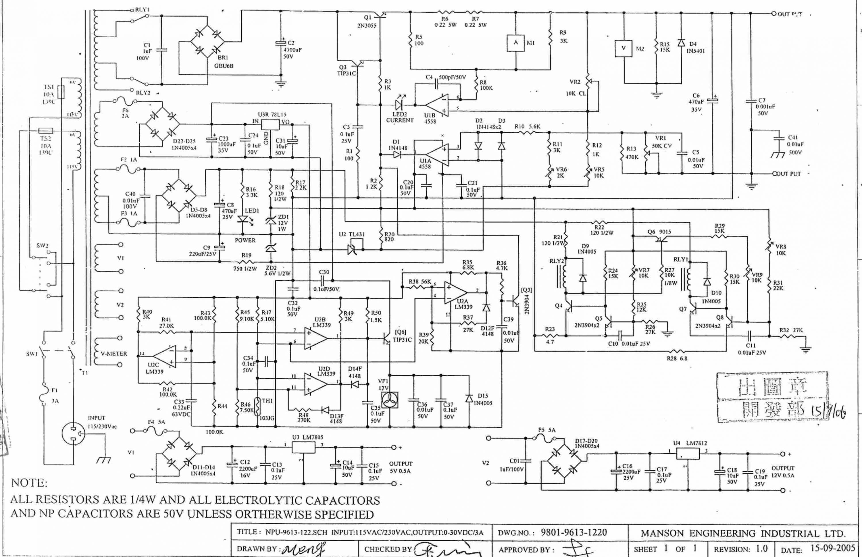

        Here is a schematic for a generic Chinese bench power supply 0-30V at 3A. They are all very similar and can be difficult to troubleshoot.
        Diode D4 (1N5401) is probably shorted and is stashed behind the output binding posts or sometimes located on the main board. If you can't find it, hook up another battery and look for the smoke. That's how I found it...
        There are a few other failures these power supplies have. The pass transistor Q1 shorts or the op-amp U1 fails.
        If the power supply is off and you connect a battery to the output, current will backfeed in and cause damage. You have add a diode across Q1 C-E to protect it.

                    A trace could have melted and messed up the meter but I don't see the reverse-protection diode in your pics. It could be on the small PCB where the wires solder onto the backside of the binding posts.
                    I would fix it, add the two 1N5401 protection diodes, and quit smoking.
