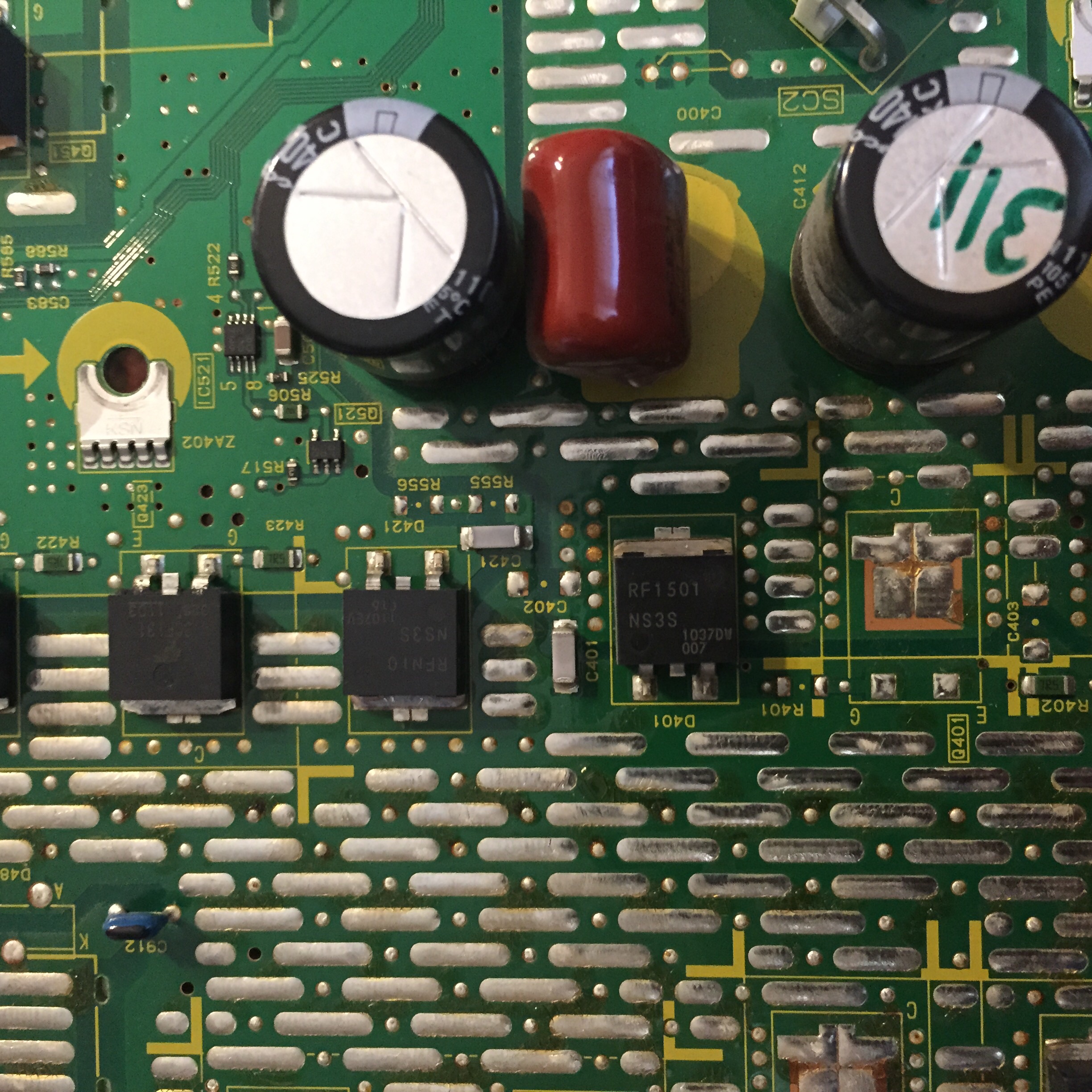

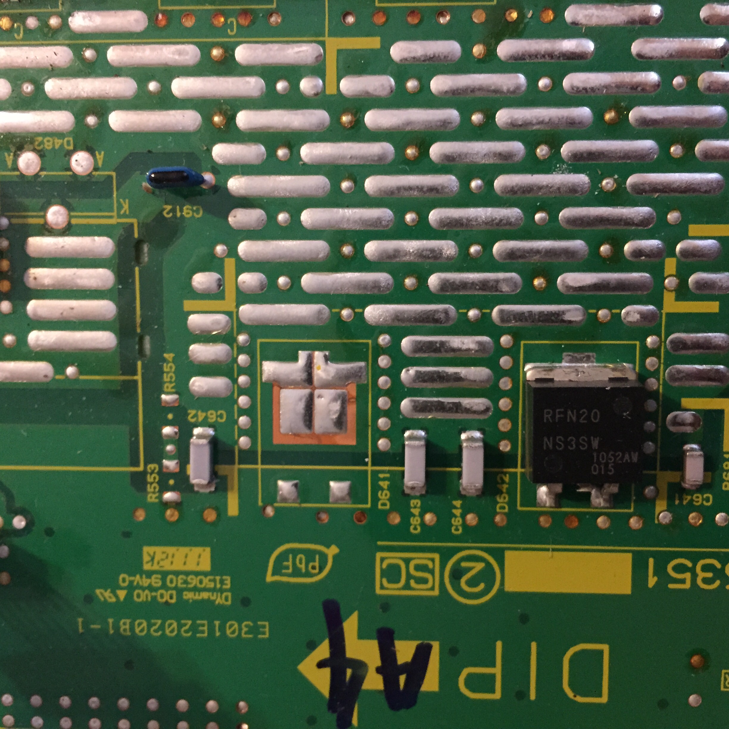

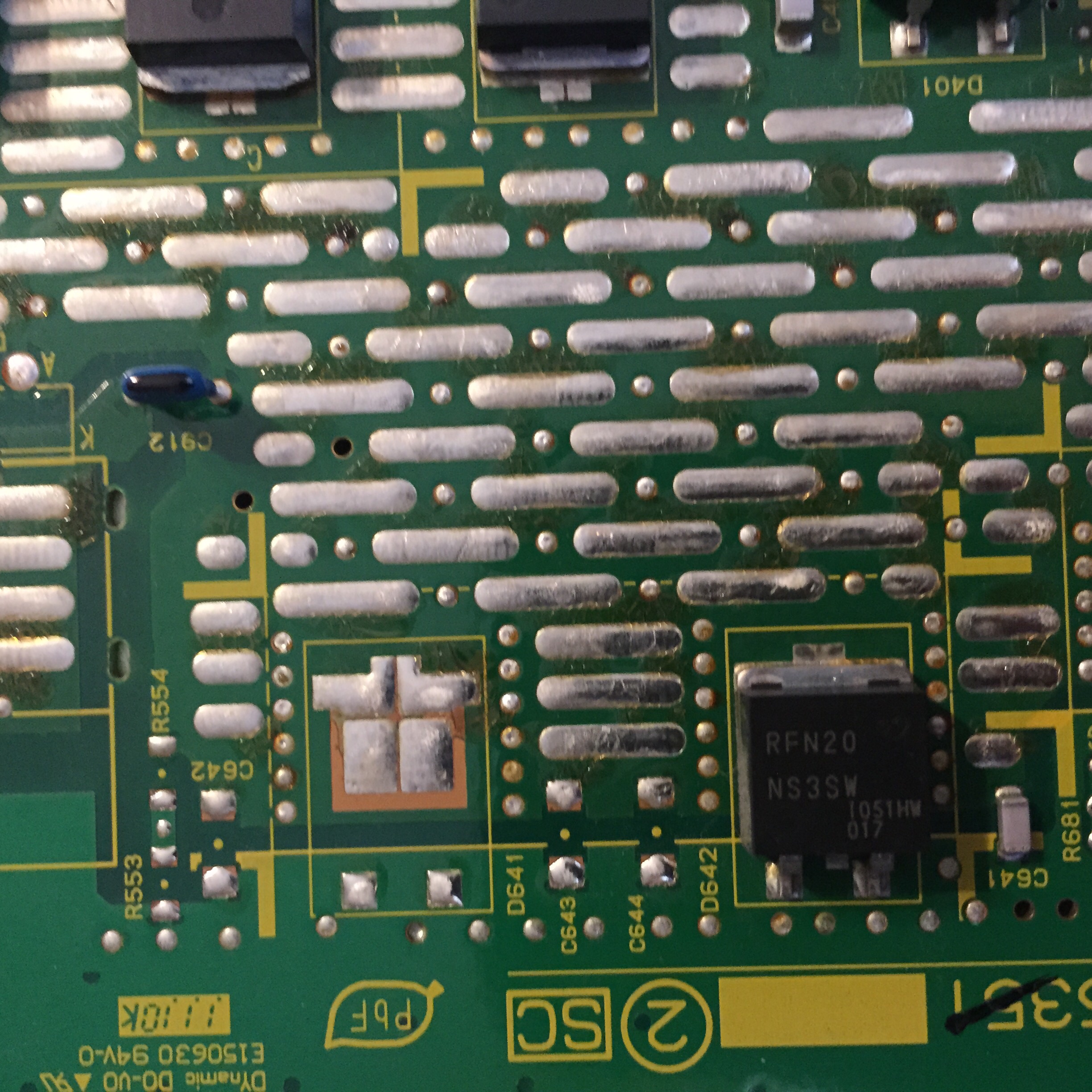

    I looked at the two boards the tnpa 5351 am and the tnpa 5351 aq and only difference is there is there are 4 suface mount caps one tnpa 5351 am that the tnpa 5351aq does not have c642,c643,c644 and c402.I was wndering if they are for noise reduction.here are some pics.
      Re: Tc-p50s30 sc board question
      Here c402 has one a cap the board suffix am
        The one suffix aq does not have c642,c643,644 here pic
          This am one here are caps c642,643,644
            I assume they are there for noise reduction i went ahead and put it in my tc-p50s30 ran it for like 10 minutes everything looks good.but i recommend you always get same suffix when possible.
