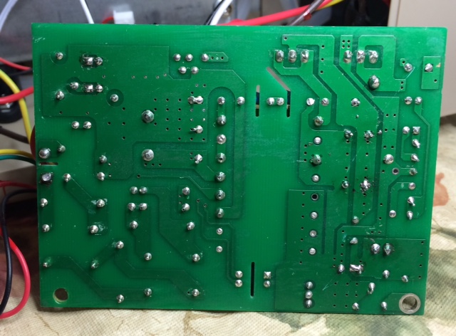

    About a week I went to turn the De-soldering Station and it did not come so I took it apart to see why
    and found a 5 pin IC chip so I look it up to see what it was and here is what I found---------->
    It has one of these regulator in the power supply FSCQ1565RTYDTU Power Switch ICs - Power Distribution 15A/650V QRC Power Switch
    https://cdn.badcaps-static.com/pdfs/...3d31708caa.pdf
    So let order two of them and see what happen
    I put one in and what do you know it came back to life
    So I look at old regulator with a magnifying glass and I see a crake from one side of the chip to the other side in the front of it
    https://www.badcaps.net/forum/showth...sam#post335581

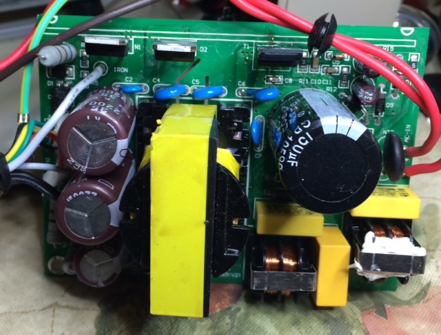

                  Well the ZD-915 was sick again
                  The switcher went out again
                  Here is what happen I went turn it on and it came on and went right back off in about one two seconds
                  Can anyone shed some light to why this switcher keeps going bad
                  I put a new one in and it started working again

                      • 31163
                      Re: ZD-915 Desoldering Station when on the blink
                      got a foto of the psu board?
                      it may have a bad or under-rated snubber cap or something.

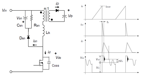

                        Snubber caps are the blue colored caps right

                            • 31163
                            hey, i just saw the other thread you bumped.
                            18v output.
                            25v caps - hell no.
                            for smoothing 18v you want 35v caps.
                            old rule, a smoothing cap should be atleast 1.5x running voltage to handle the spikes.
                            18+9=27
                            that's far too close!
                            also, if it pulses the element with DC does it have a reverse protection diode?
                              It is true that blue-coloured high voltage ceramic capacitors are often used in a circuit for that purpose, but it does not mean that every time you see a blue capacitor it is a snubber capacitor, or that if a capacitor is not blue, that it isn't a snubber capacitor.
                              You have to look at the schematic or trace out the diagram and figure out which capacitor is the snubber capacitor.
                              It is usually part of a resistor, capacitor and diode snubber network which is in parallel to the transformer winding that the MOSFET drives, in a flyback style switching supply. See picture for a typical circuit.
                              If the capacitor has failed, they probably didn't use one with high enough voltage rating.
                              -David VanHorn
                                • 31163
                                they can be blue or yellow or orange, colour is irelevent.
                                what we are talking about is resin-coated high-voltage ceramics. usually 1-3Kv rated.
                                you can use them for lots of stuff.
                                but snubber circuits see short but hgh spikes so high voltage caps are a must.

                                  By the way that what the voltage value that was in there
                                  Do these two 2200uf caps ---------> are uf value high enough for 13 amps or do I need 2500 or higher
                                    • 31163
                                    you lost me - what 2200uf caps?
                                    ripple current is in the datasheets btw.

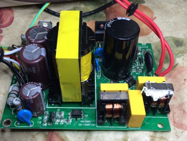

                                      We need photos, we have no idea what your power supply looks like.
                                      -David VanHorn
                                        • Jul 2011
                                        • 6059
                                        UpDate
                                        Here are some photos of the switching power supply for this unit
