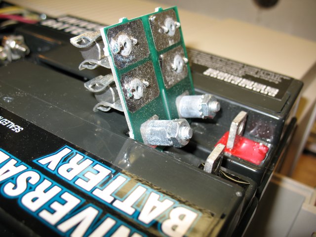

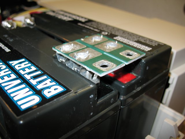

    I am replacing the batteries in a Smart-UPS 1250 that has been sitting for years. The last one I did had a different style fuse that was smaller, but the other ones I have use this odd circuit board with two 50 amp fuses.
    I can't get it to fit no matter what I do. There is no clearance above or in front of the batteries. Am I missing some angle brackets or something? Anyone have pics of one of these assembled? It's driving me crazy, I tested it with a temporary jumper and everything works fine, but I can't put it together without the fuse in place

    Got it to work by stacking two sets of the black spacers and using longer screws, And mounting it in front of the batteries with the fuses closest to the bottom. It barely fit, so I put a protective sheet of plastic over it in case the front panel circuit board may end up touching it.
    When I first tested it out, it went to low battery mode right away. I let it charge till the fan stopped, and it ran a 500W load in low battery alarm for over 20 minutes before it actually shut off. Hopefully it will recalibrate itself and work properly after the next charge.

      Re: Need help with Smart-UPS 1250 fuse
      For UPS units with batteries in series: be sure to charge the batteries evenly - each battery must have a voltage range of 0.1V after a 6 hour rest after being fully charged with the charger disconnected (e.g. battery A is 12.82V and battery B is 12.78V, which gives a range of 0.04V)
      Also, have you got a picture of the fuse board successfully fitted with longer screws?
        Regretfully, I don't have an assembled pic. I was too pressed to get it together and installed in the server rack.
