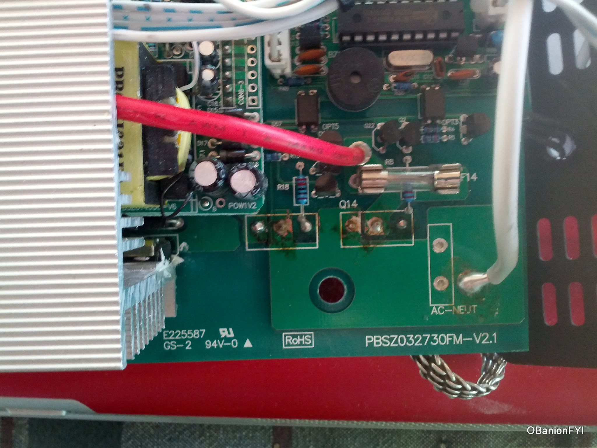

    Hello, members

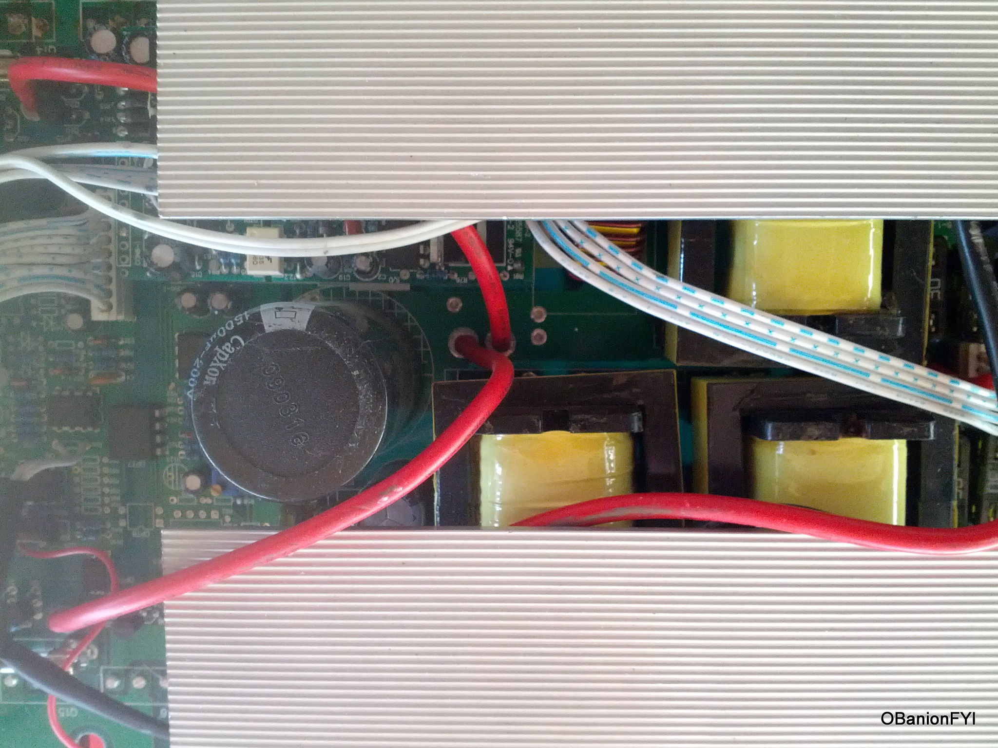

    I am having problems with this inverter after it has been repaired. What had happened was 120 volts ac was sent through the inverter backwards while being connected to a photovoltaic systems AC (2) 15amp circuit breaker panel. Smoke came out of the inverter. I replaced all the damaged components, capacitor, all fuses and all transistors. I purchased all same components or equals and installed them. I reassembled the inverter back together. The inverter now turns on, and(with the proper AWG cables connected to a deep cycle battery on the + and -terminals the inverter surges while charging any 120 volt AC electronics. While the inverter is in the on position and when the DC is inverted to AC, at best i get only 33 watts max in this surging back-and-forth on-and-off after inverting to 120 AC to charge any electronic devices. DC to AC, not fast enough cycles per second to keep the inverter at 60cycles 120 volts AC. I would really appreciate any advice if i am missing any procedures or i forgot something simple i was suppose to do. Thanks very much for reading about the problem, Mike

    Re: Power Bright 12v 1500 watt power inverter Model# PW1500-12
    There is high possibility the transformer is bad and if not that, than also some feedback components, not only high-power ones you replaced. Post some high-res sharp photos…

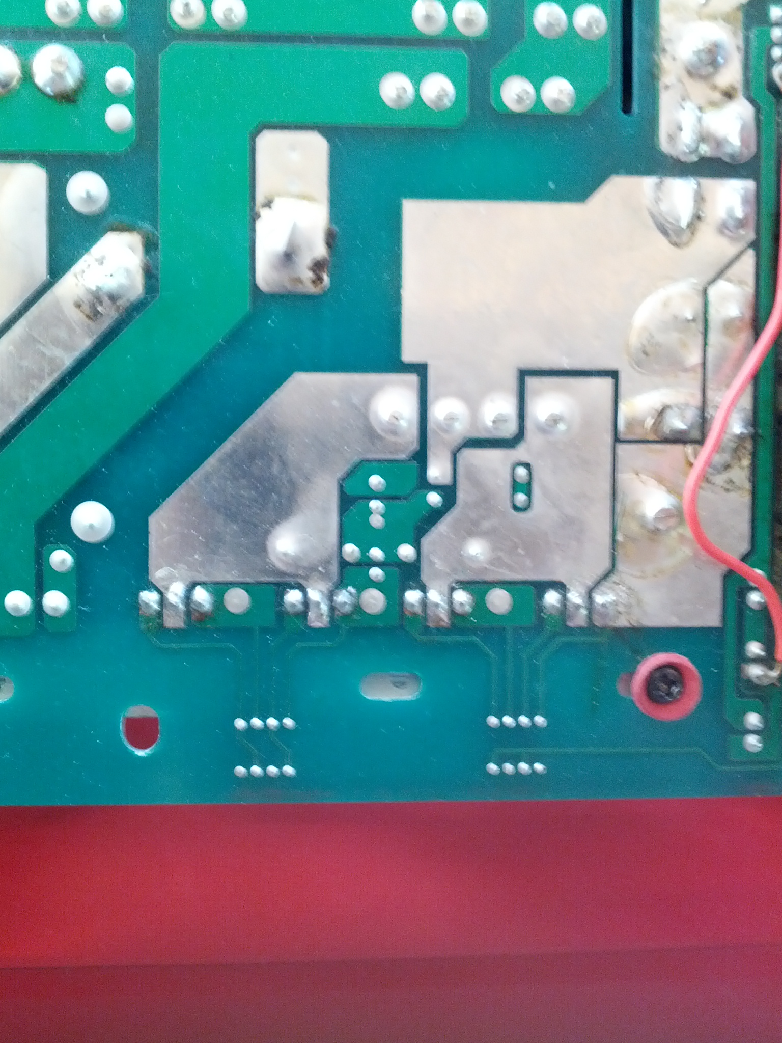

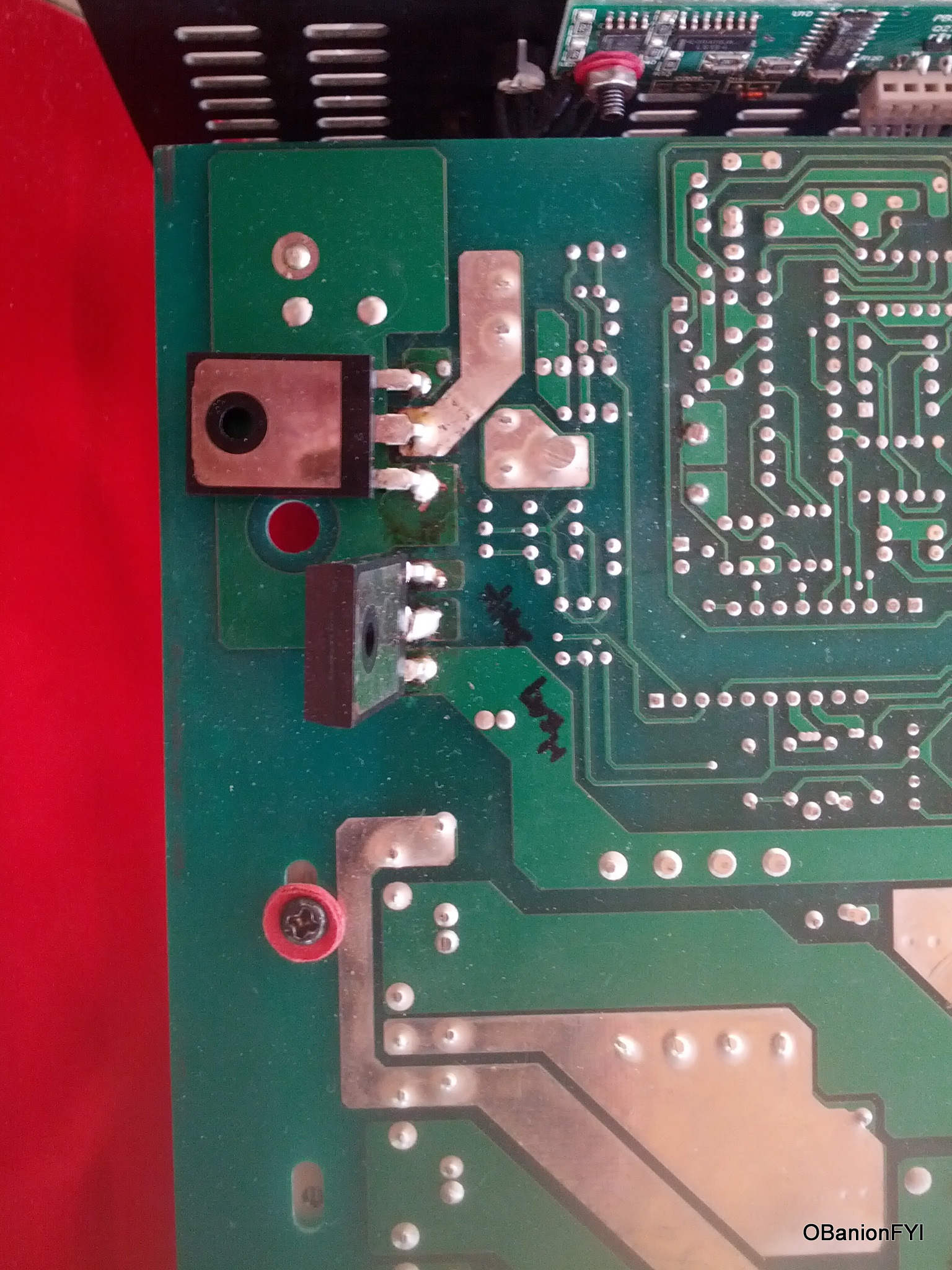

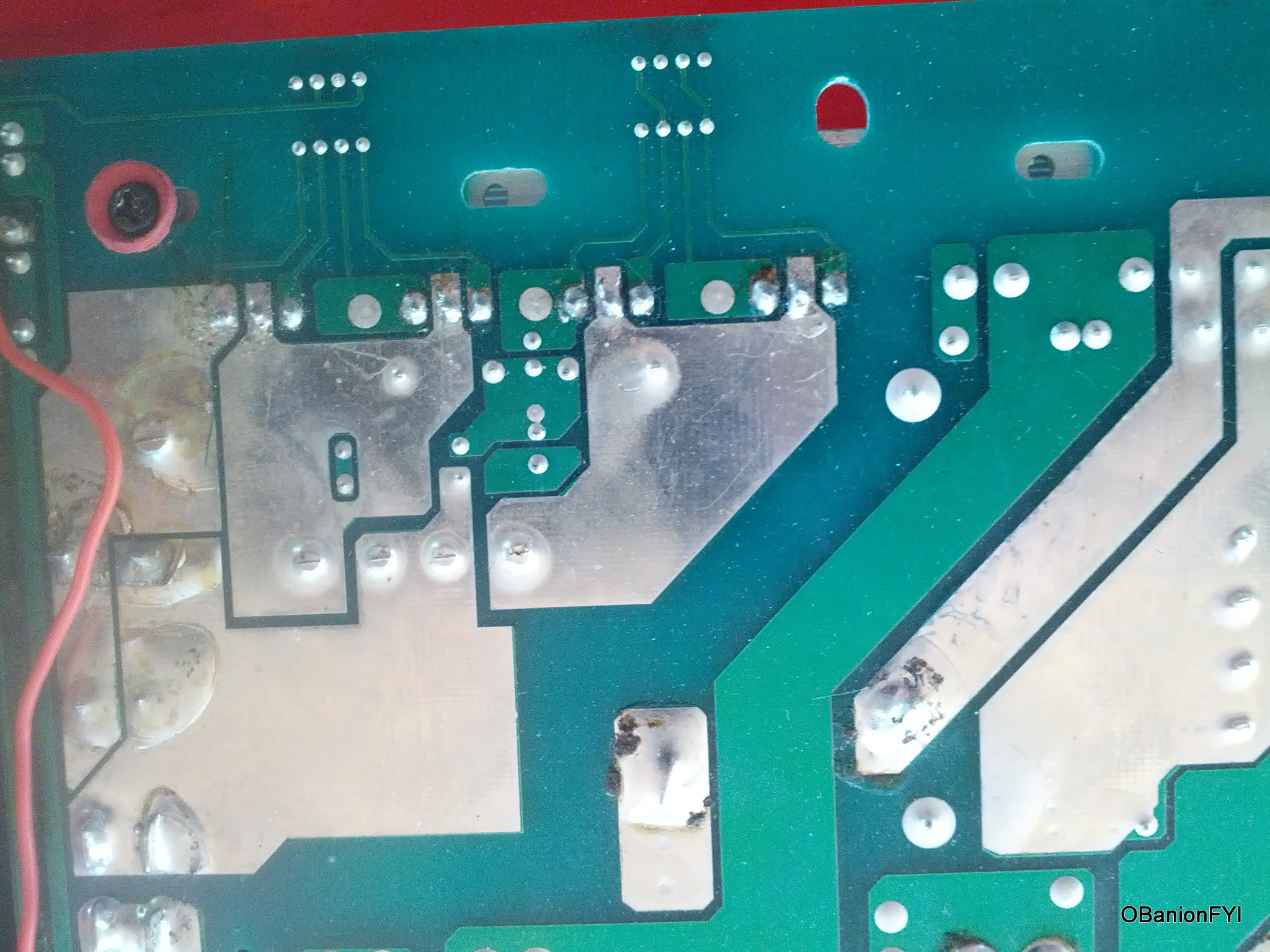

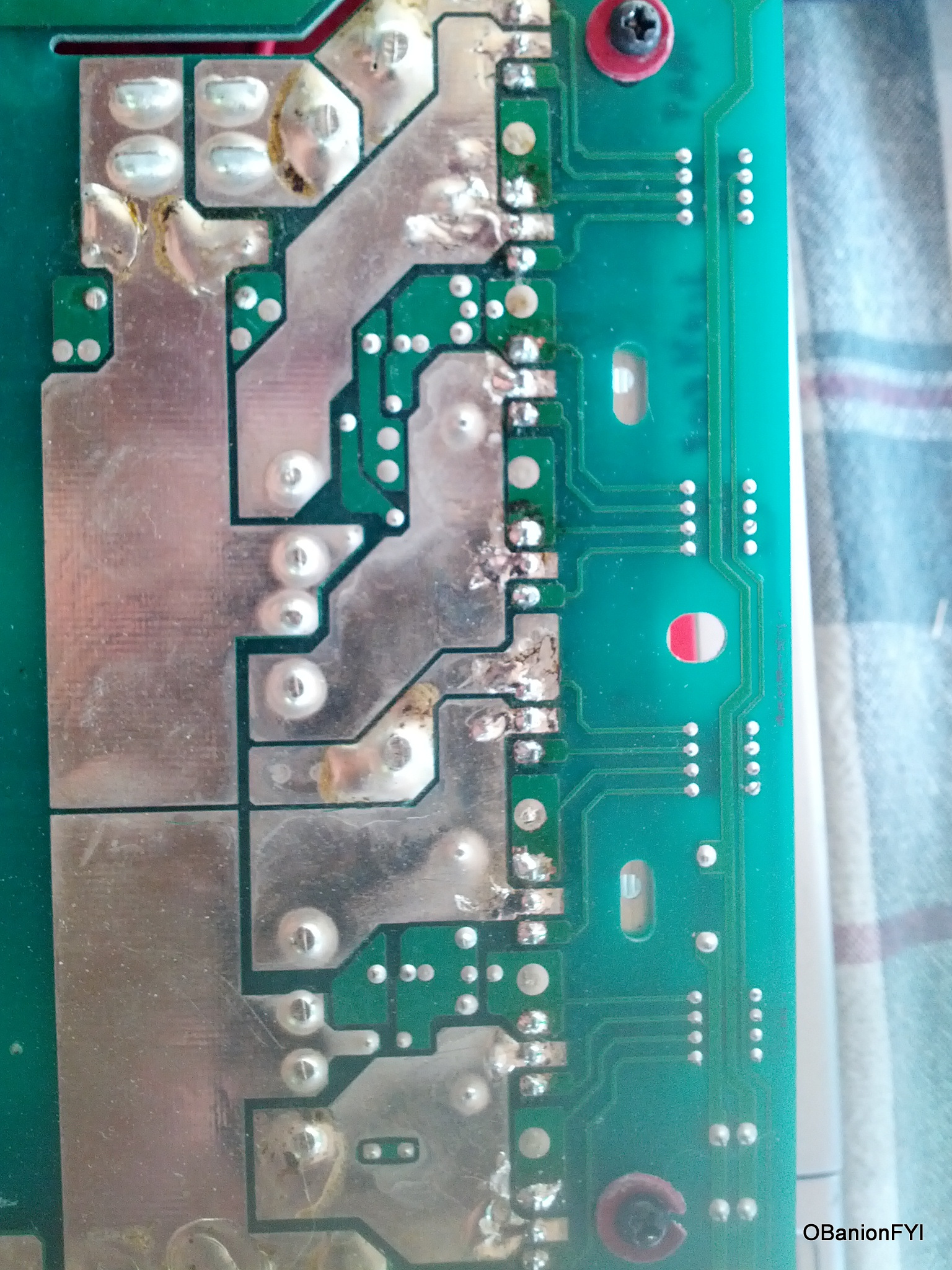

          Hi, this is the highest resolution pix's i could take up to 3M

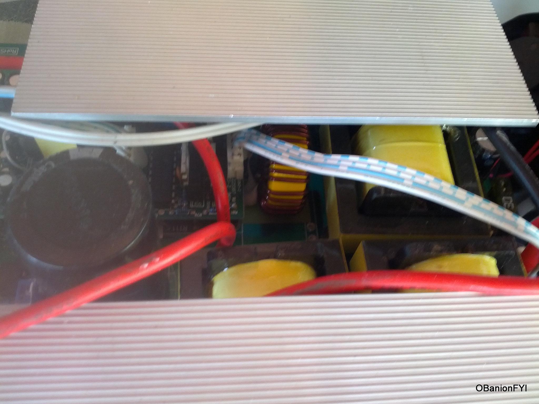

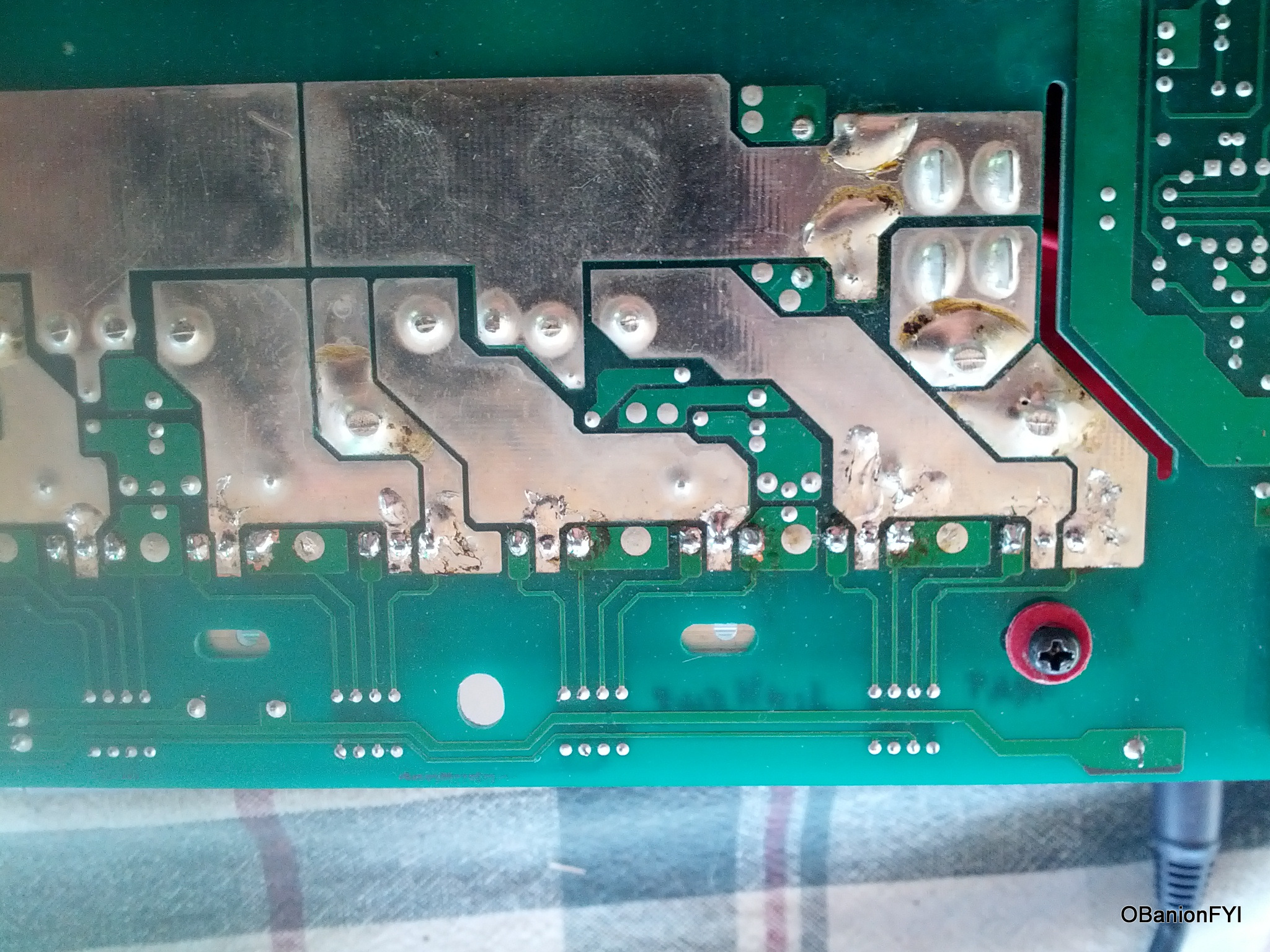

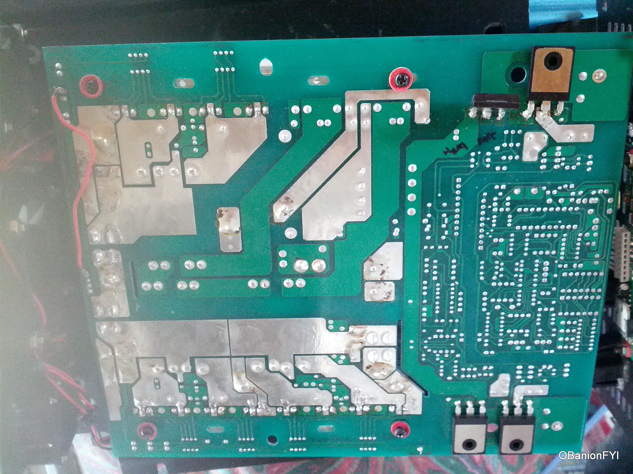

            More hi resolution pix's of PowerBright inverter repair and anymore help would be appreciate. Thanks very much,Mike
