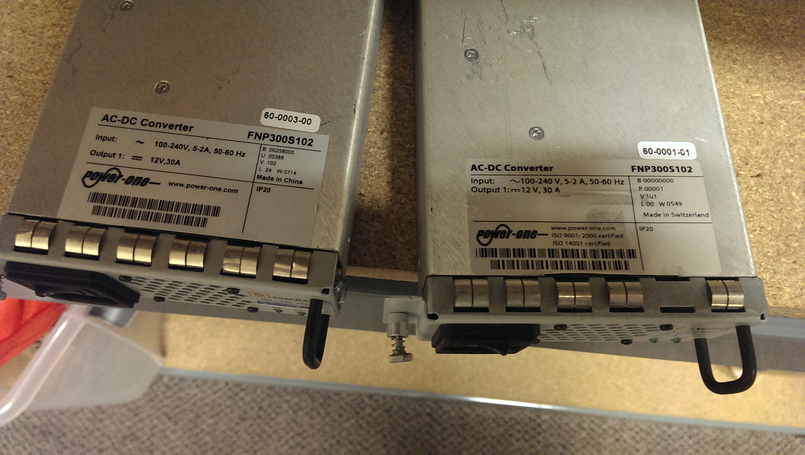

    Okay, I got two power supplies Power One 12V 30A. My friend bought them for a Cienna switch that was missing the two power supplies, but they were not the correct ones. He needed the 48V variant.
    I took one of them apart to check, it is a very good quality unit. They have a fan but are not annoyingly loud.
    I purchased one of these to test:
    http://www.ebay.com/itm/161270932210
    And now I just nee something like this... Would this work?
    http://www.ebay.com/itm/50pcs-x-2-1-...item336cab125c
    I don't know the size of the jack on the Pico PSU, unfortunately. I am still in progres of coming up with the power supply board to distribute from the power supply to all of the computers since I have some odd 20 or 24pin or whatever connector off the PSUs. I'll post a pic in a bit.

                I don't think it uses that much power. Maybe at spin up, but not all hard drives would spin up at once. Laptop drives would certainly use less power, but are slower and more expensive per capacity. I have attached a picture of my power supplies, as well as one of my dog - she loves whip cream!
