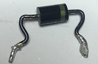

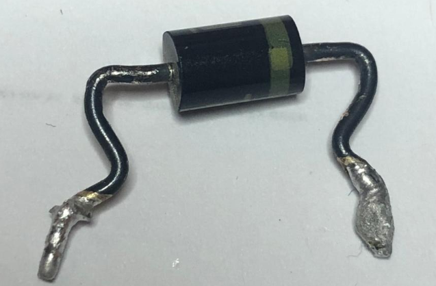

    I'm looking at the power source module of my Panasonic plasma TV TX-P42ST50. The TV goes into suspended state almost immediately and keeps flashing 6 times.
    That zener diode is marked on the board with the diode sign (D204), that much I know. It seems to be open completely in both directions and its legs seem dark, as if it suffered some heat.
    I'm having trouble finding a replacement. Does 21 stand for 21V?
    The only other clue I have it is connected across 2 of the legs of a transformer (primary side).
    Any idea how to find a replacement?

    I went ahead, bought 22V 5W zener, replaced it and the TV doesn't even try to power on now. I removed it again and we're back to what it was (6 led flushes and turns off). So burnt zener (or none) seems to work better.

      Not seeing any markings of the diode, I think it is something like a 1.5KE200CA which is a BIdirectional TVS protection diode. It being open on both ends, this is correct and not a failure. Basically 2 diodes opposing each other in one package.
      If that diode sits across the primary it’s not 21V. Hard to tell with no pictures.

        Oh that would make sense, learning something new every day. It seems I got to know about components just enough to cause problems :-).
        Anyhow, the markings are in the topic name: T3D 21 (with the digit 1 underscored if that makes any difference). The original diode has dark discoloration on its legs, as if it suffered some heat.
        I measured the voltage between those 2 transformer legs and my meter shows some 800~900V AC, but it only has 750V range, so not sure how reliable that is (I should've measure that before I ordered that zener diode). That value doesn't make much sense to me, as I tried to follow the circuit visually and it seems the transformer is fed almost directly from a bridge rectifier that produces 330V DC (I measured). All in all, more questions than answers.
        Still it seems that TVS diode is not the culprit here, so I might as well put it back there.

          ??? Huh? 800 to 900VAC? I don’t think so. Not sure what’s going on with your DMM.
