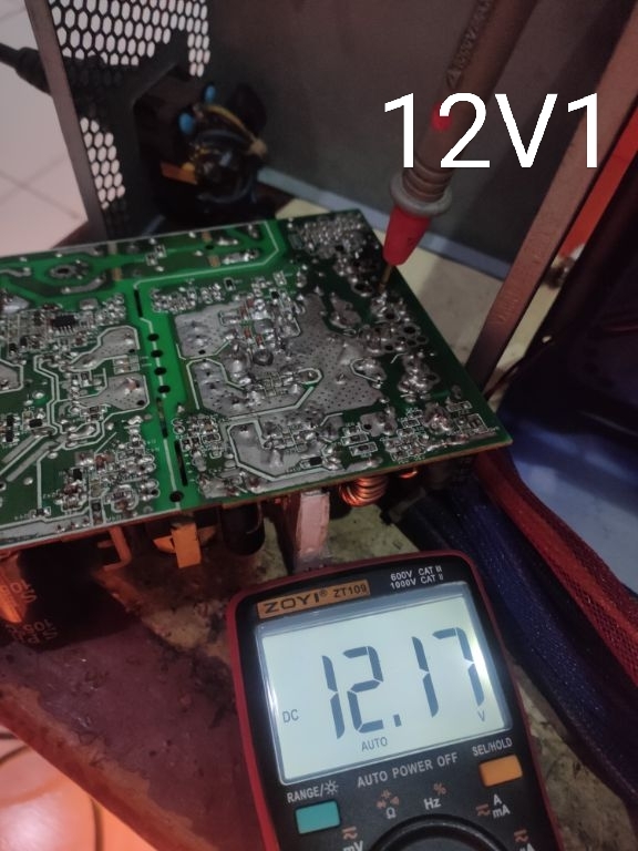

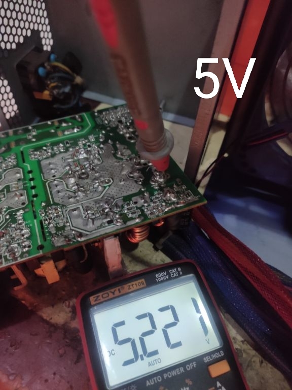

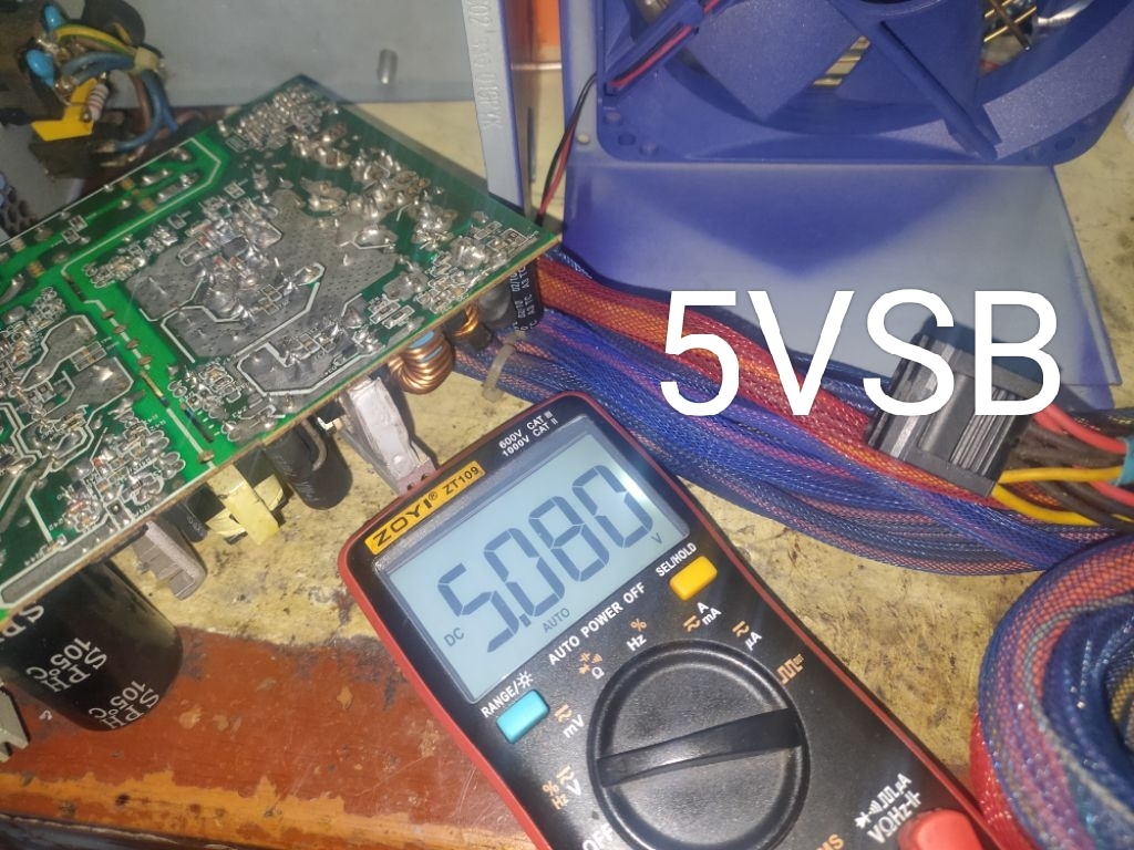

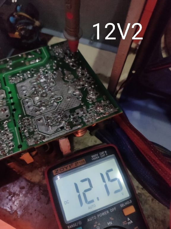

    I received the PSU today. A quick check revealed a shorted 12V output rail, which is caused by a half dead dual Schottky rectifier. I replaced it, and was able to turn on the PSU but very briefly for a few seconds before the protection kicks in and shut it off.
    I'm not sure what is wrong.

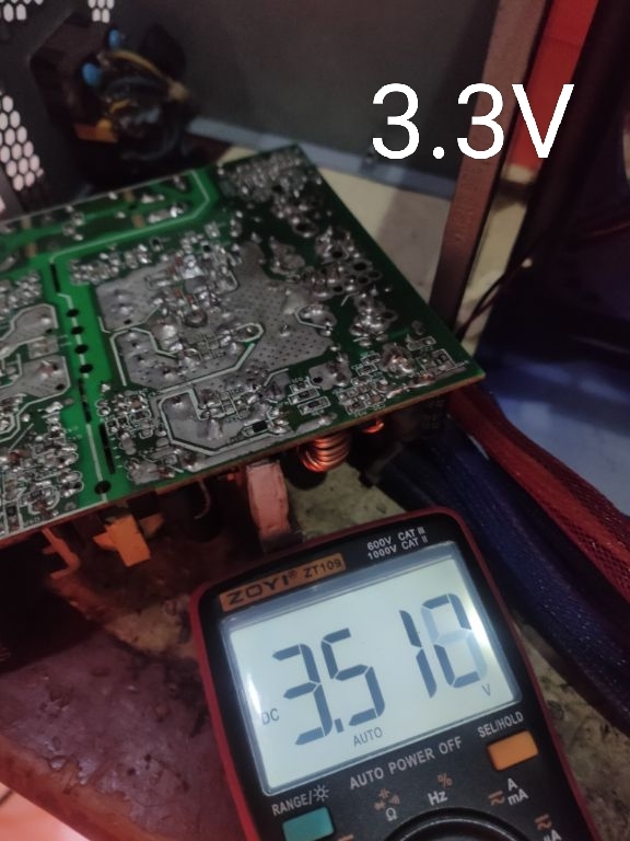

    All output rails seem ok, with 3.3V maybe a bit higher at 3.6V
    Interesting to note, my light bulb is shining brightly while the PSU is running, like there is a short, instead of blinking rapidly as usual when there is an active PFC circuit involved.

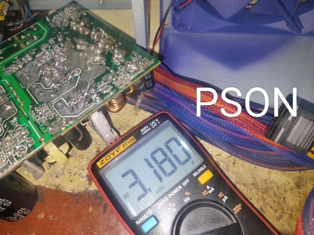

    PSON is 3V
    Any idea what to check?
    Should I disable the protection just to see what will happen if there is no auto shutdown?

    SOLVED. As I supected, it was indeed my DBT that caused the restart cycle.

        I think my dim bulb tester is preventing the PSU from working correctly.
        The PSU is actually going into a repeating cycle, where it will stay on for a few seconds then off.
        I'm just taking a guess here, but I believe it is because the DBT is limiting the current, and somehow it messes up the supervisor IC OCP detection.
        It begins right after I reconnected the 12V fan. Before that, the PSU stayed on, hence I was able to measure the output rail voltages.
        Hopefully nothing will go bang if I try it again with the DBT bypassed.
