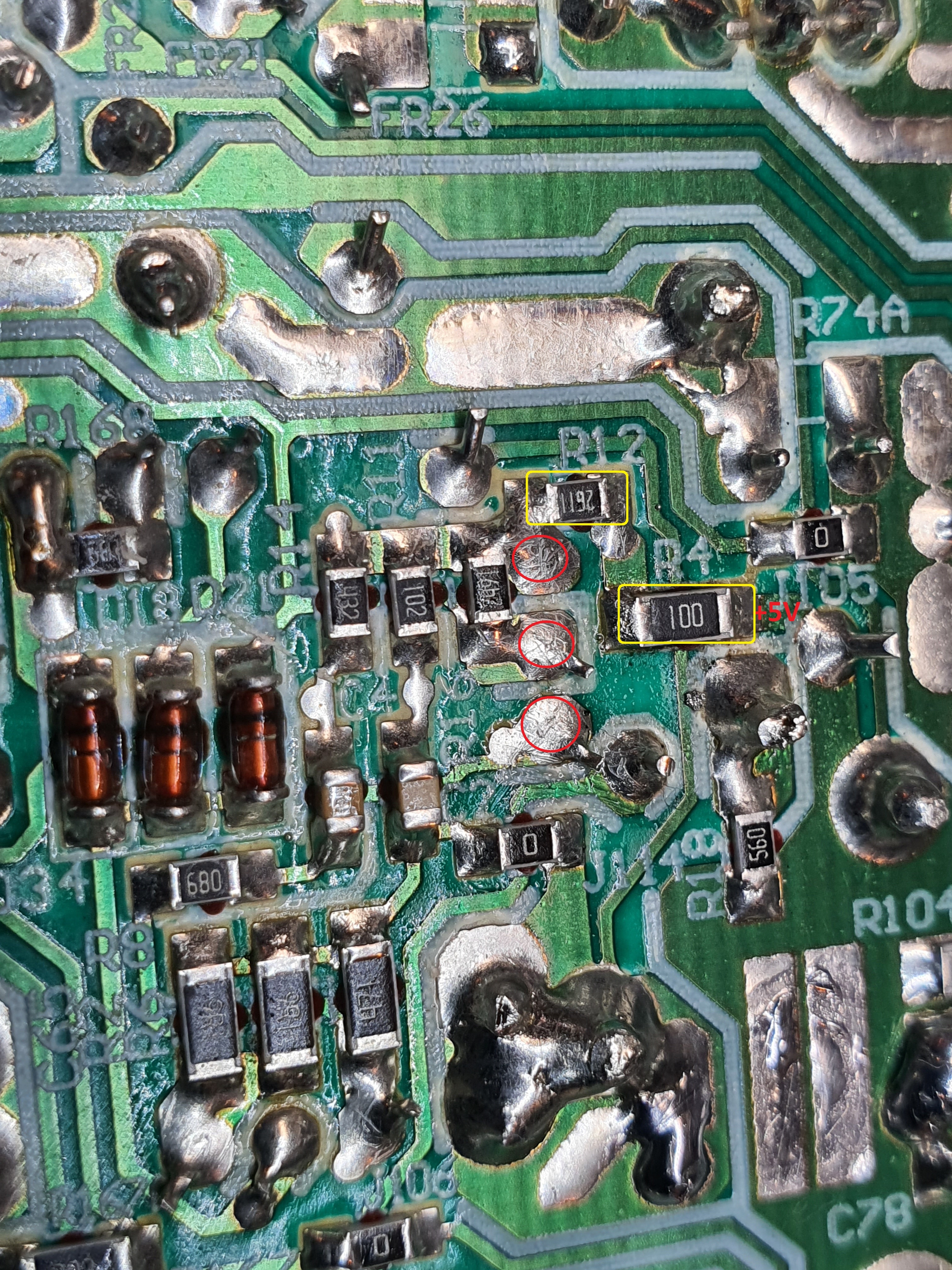

              I replaced the two 16V 2200uF electrolytic caps in the 5V rail today but it didn't help so the problem is elsewhere.
              So I followed your suggestion and went searching for the voltage comparator of +5V and I think I found it, it's a Texas Instruments TL431AC. It seems to be connected to the +5V rail via these two resistors:
              Now I just need to wait another month for the replacement comparators to arrive from aliexpress 😅

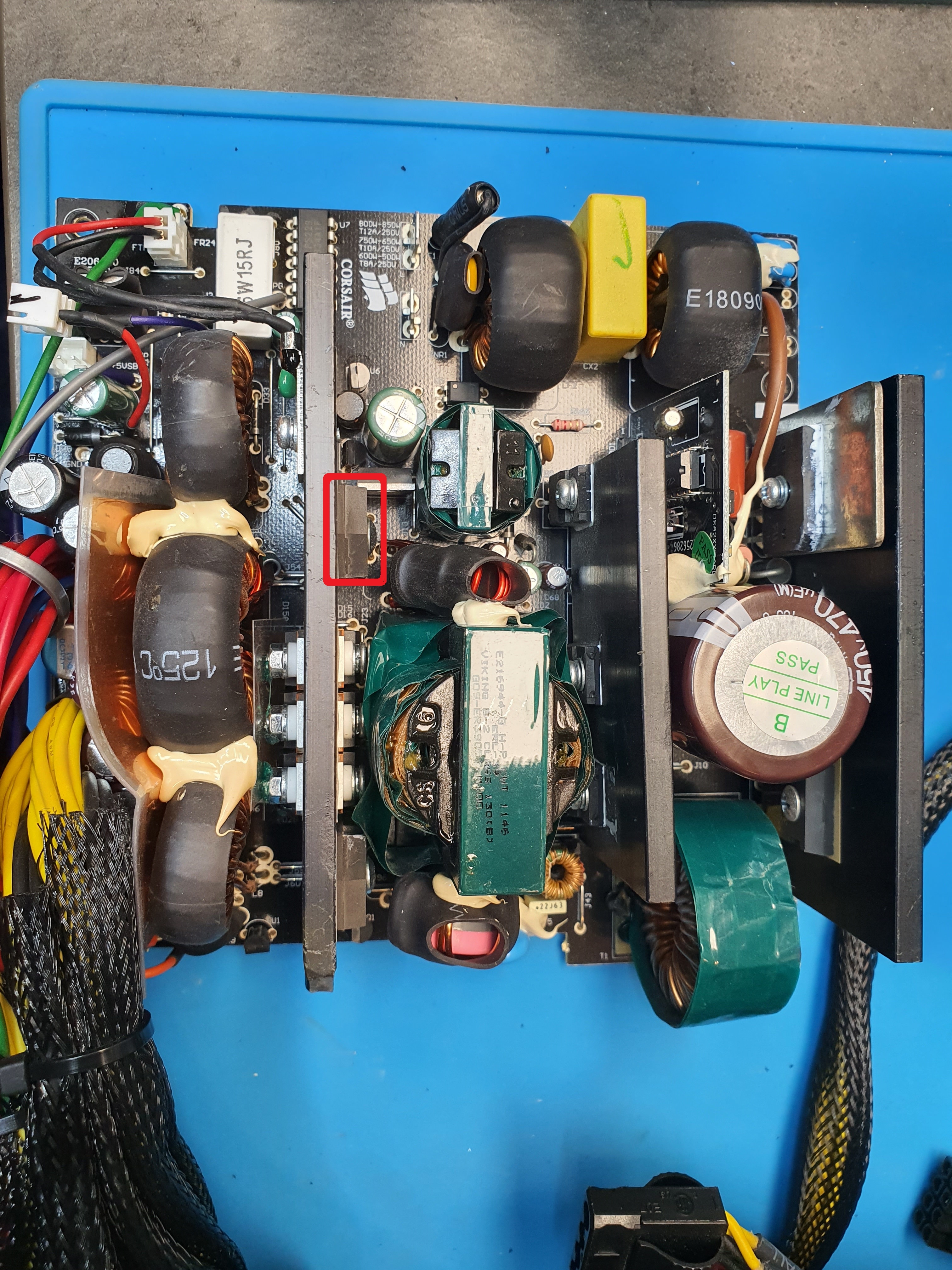

                  Thank you for the suggestion, I think it looks like 3.3V and 5V are on the same transformer. And the 5V output rectifier seems to be this one (STPS3045CW, circled with red colour):
                  Click image for larger version  Name:	20240220_212935.jpg Views:	0 Size:	2.76 MB ID:	3220517
                  Might as well order some of those rectifiers just in case, the voltage comparators were dirt cheap.

                    That could be for the 5v standby.
                    You still have 3 pairs of those dual rectifiers, which I believe one pair is for 3.3v, another pair is for 5v and last pair is for 12v.
