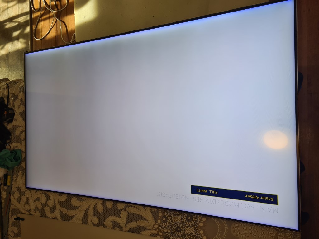

    Trying to fix Samsung Q6F with dark vertical area and when I unplug motherboard and turn on tv 1 backlight section is not coming on but with LED tester all the sections work. On TV power supply I measure on +side 130v for all sections and on -side I get 55v for all sections except the one not working which is only 5v.
    How do I tell if problem is PSU or strip? On the LED tester it reads 68v for all sections. I fully expect it to be a bad strip cause the strips and diffuser are so melted and cracked im surprised any LEDS work

    I guess its power supply board fault because i swapped the connector to the other strip and same line not working on that one either.

      It’s the backlights. Unplug both backlight connectors from the psu and remove the main board connector from psu. Plug in and measure voltage on backlights connectors. Should be the same output for both connectors. If so it’s backlights.

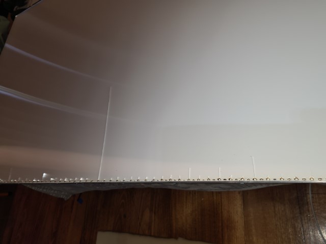

        Re: Samsung Q6F edge LED section not working
        Just to note though. Unless you have another plastic diffuser it’s not worth fixing. It will always have a line of light where that crack is and look like crap

          You 'MAY' be able to rotate the diffuser 180° degrees so the cracks are at the top and a fresh clean surface is mated against the LEDs but many of the diffusers I have see wont allow this. Either there are tabs on the diffuser to ensure it cant be install backwards/upside down or the etching stops 0.5" from the end instead of going all the way to the end. The lack of etching (not the right word but you get the idea) will prevent proper diffusion and distrubution of the light emitted by the LEDs.
          I read once where someone was able to take the diffuser from a larger TV and cut it to size for their TV. Thats likely not possible for you as TVs of this model larger than 65" are incredibly rare and Im not sure how good the edge of the diffuser would look after being cut as a DIY. The diffuser is plastic and melts/browns pretty easily. If you used a saw you would have to then come back and sand down and polish the edges to make it optically clear. Not impossible but man... that's a lot of work to get it optically clear enough not to get a halo effect near each LED.

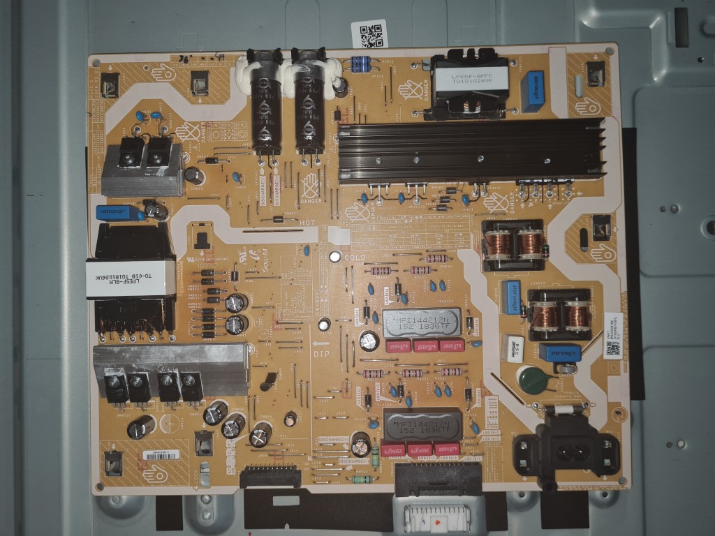

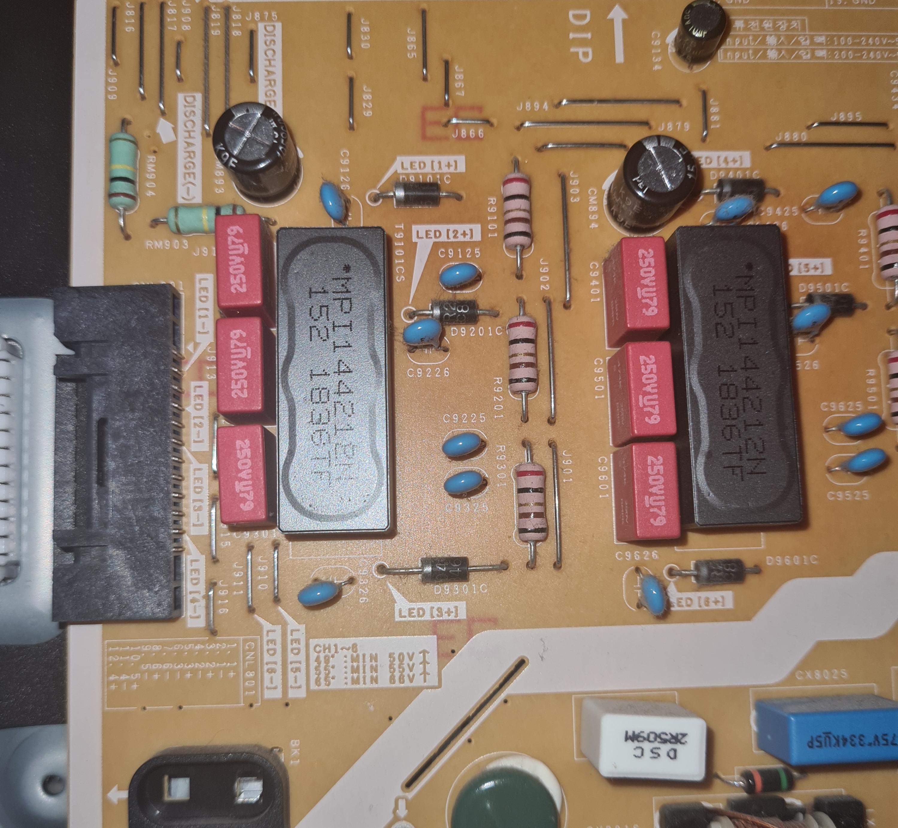

            Theres only 1 connector for backlights. 12 pins, 6 lines, 2 LED strips. Line 1 has low voltage on minus pin no matter which LED strip I connect it to so has to be problem with PSU. LED tester also shows no issue with either strip. On PSU all voltages otherwise normal +130v on all +pins and 65v on all -pins except Line 1 only showing 5v.
            Anyone know what I can try to diagnose problem?
            And yes I have a new diffuser for it, I had his tv for a while waiting for another 65 samsung QLED to come along
            I attach picture of power board if anyone can help. Seems its the same power board as NU8000 model too.

              Unplug everything from the psu and plug in. What reading do you get on the 6 diodes labeled led on the psu

                they're all 138v

                  Ah was just a loose connection at the PSU connector

                      If you turn it, it will cause the bottom to be very bright. They are meant to be one way, believe me I tried it lol.
                      Find a crack screen 65 on marketplace or something and then replace diffuser, and those LEDs for sure.

                        Oh no new problem the diffuser out of KS8000 is 3mm longer top to bottom and wont fit above led strip. Any ideas how to cut 3mm off the top of the diffuser ?

                                    Well used Dremel and it worked but yeah just melts so it's messy and slow. razor and straight would be way better.
                                    With diffuser on I can see I need LEDs strips asa few LEDs are dim.

                                        Still got a fair bit of blue seeping through the bottom. That QLED filter was burnt too at the bottom but I didn't replace that so I guss thats why.
