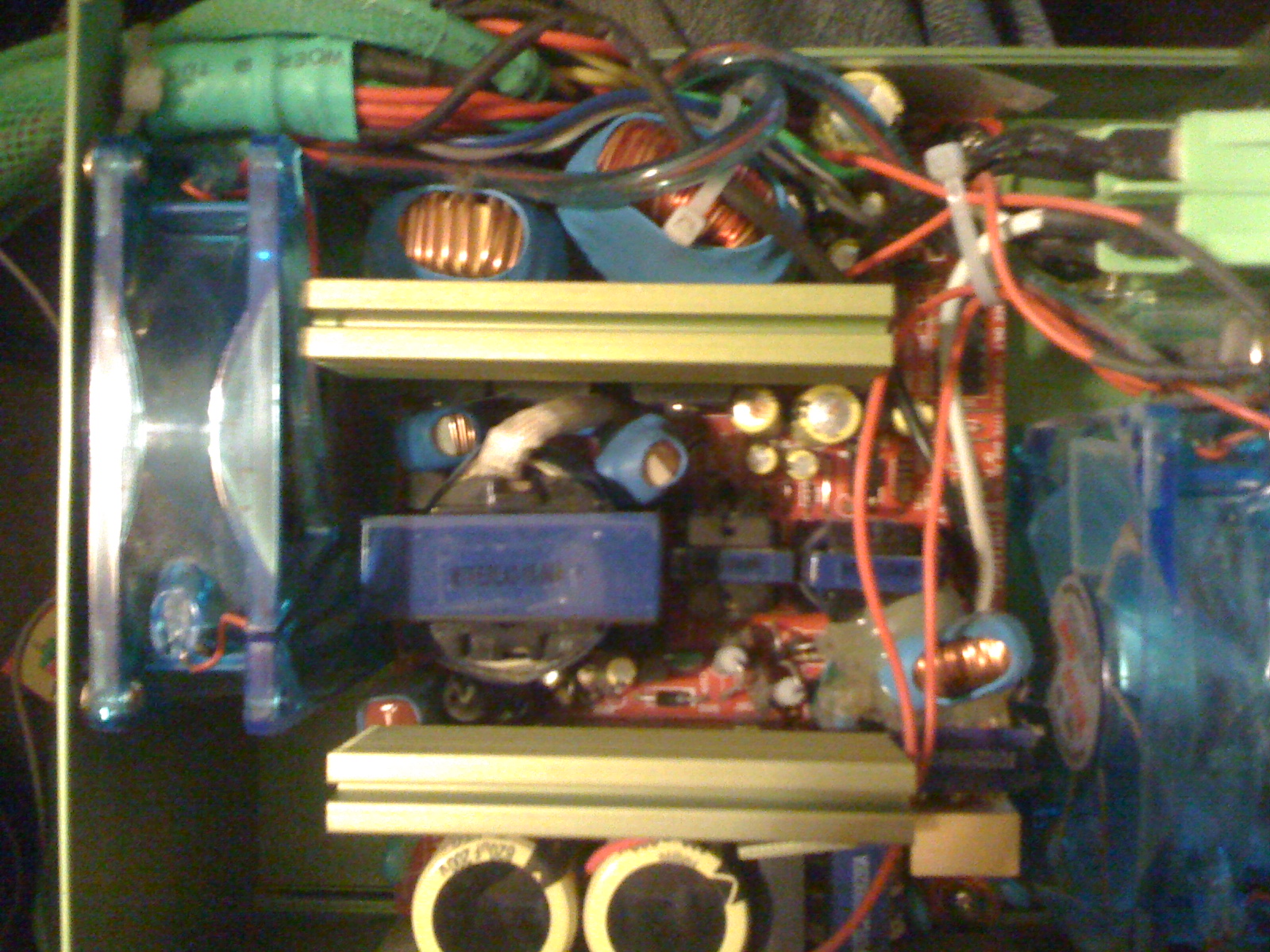

    I have an Aspire ATX AS-520W with 2 capacitors that are bulged and one of which was starting to leak. The PSU still works, but Ive decided to replace the capacitors to ensure the longevity of it. Question is, should I just replace those two, or should I replace the rest as well?
    The brand is Y.C, the larger cap is 2200uf at 10V (~10mm) and the smaller one is 1000uf at 10V (~8mm). I was thinking of replacing them with these:
    http://www.newark.com/jsp/Passives/A...sp?sku=69K7927
    http://www.newark.com/jsp/Passives/A...sp?sku=69K8202
    Will those work and are they a good brand?

    Re: Aspire PSU with bad caps
    I would replace all caps except the bigg 200v ones.
    The KXM caps you linked should be fine, the others are not LOW ESR types, wich will not a lasting choice (besides some other problems ).
    My suggestion would be to stick with UCC caps, Rubycon or Pnanasonic.
      I did a careful inspection and all the other capacitors appear to be fine. Would it be worth the trouble to replace them all, or would replacing just the failing ones be ok?
        If you really really like Newark, stick with United Chemicon, LXZ, KY, LXY or KZE series in that approximate order of preference (I don't know off the top of my head which of those series Newark carries. otherwise, look into Digi-Key, which carries UCC, all four of those series, Nichicon PW or HE series and Panasonic FC and FM series.
          How did you inspect them? I had a 300W Antec where one of the caps on the +12V rail bulged, but the other one looked and showed low ESR. But a few weeks after I replaced the first cap, the supposedly good cap bulged and its ESR went way up.
            The caps on that aspire look just like the caps I replaced on a friend's aspire PSU. The PC had the classic bad power symptoms too, spontaneous reboots, odd BSODs, disk corruption, and startup problems.
            It works fine now that a nice Rubycon cap has been added in place of a bulging one on the 12V rail.
              If you don't replace the other secondary caps now, you'll replace 'em later. Aspire/Apevia PSU's are loaded with Y.C. and/or Fuhjyyu caps, and they get quite hot and then vent. Young Year is the OEM for their supplies...they're not really known for longevity.

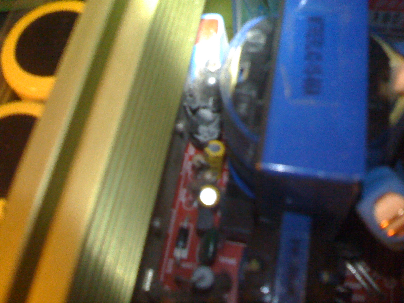

                              I also have a 66b pcb power supply labed ATX-AS500W its aspire brand. that hardware secrets review doesn't reflect all the models, mine has a thermistor and the second ferrite thing my heatsinks look alot beefier too. i bought mine used from my friend back in 2007 and have run it 24/7 for months at a time, it had no problem powering a e8400 cpu and a 8800 GTS 320meg
                              anyways i tryed to include in the pic the two fuhjyyus that are leaking 1 is a 1000uf 10v and the other a 2200uf 10v, i was thinking of buying some samxon replacements for those two caps from this site? do you think they would work?
                              also on the second pic theres some weird upright thing that seems to have its casing split in the middle its not a capacitor so iam not sure what it is.
                                Samxon will work just fine. Generally most power supplies have 2 16v caps on the 12v rail, 2 10v on the 5v, and two 10v or 6.3v on the 3.3v rail. Could you confirm this? If this is right, you could just get two of these (https://www.badcaps.net/store/produc...products_id=56) for the 12v rail, and four of these (https://www.badcaps.net/store/produc...products_id=57) for the 5v and 3.3v rail. Then it would also be wise to replace the caps on the 5vsb filter.
                                And whatever the second pick is looks it's screwed to the heatsink. Is it? If so it might be a primary switcher, but you would have to desolder the heatsink and take it out to get the part number and install a new one. Either that or it's the rubber sleeving getting ripped up or burnt off on those big resistors in the primary sections of power supplies.
                                  yeah it looks like a rubber sleeve and the top and bottom parts are still there just not the middle as some of the sleeving flaked off, its not attached to the heatsink, oh yeah this power supply still works.
                                    okay after letting it sit a few years i finally took it apart and replaced both leaking caps 1 with a used 2200uf 10v nichicon from a 1999 athlon xp and the other a rubycon 10v 1000uf from a 2004 hp p4 board. now the power supply is working great again. and has manual fan control which keeps the old fuhjyyus cool voltages are great and its powering a athlon xp rig with bloated GSC capacitors all over it. i figuere shit should power shit.
