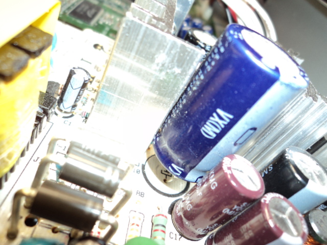

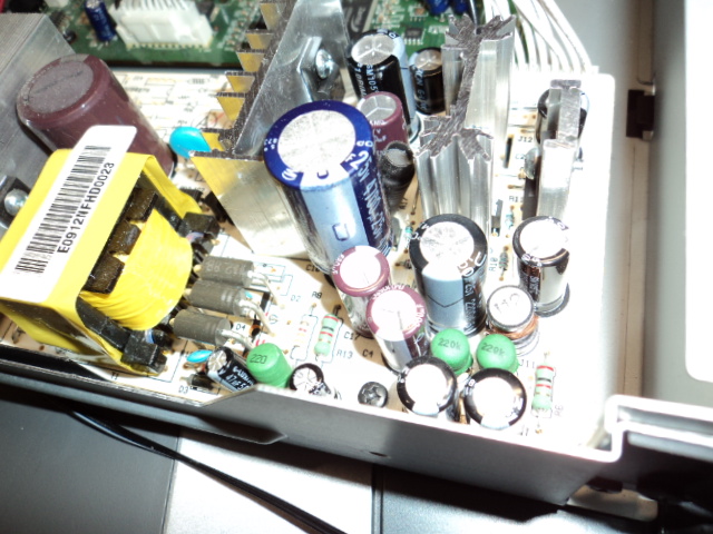

Hi guys:i had here a satllite receiver that failed so i troubleshooted iti found a eletrolitic cap out of specs in the power so idid not same size same specs to fit there 4700uf,10v 105degrees,so on my scrap i found a biger cap olmost double size it did not fit there,and same 4700uf but 25v 85 degrees, then i soldered extra legs from some jumpers to the existing legs and soldered it in place,end of history it works now great,my question will it fail on the long run? or it'll be ok and i don't have to order same caps anymore for now,
i hate to make an order on my credit card just for 2 or 3 dollares?
