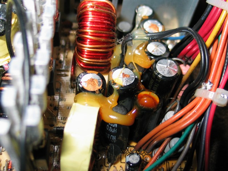

    Allied AL-C350ATX - another crap by DEER. Note the 2005 on the small sticker
    And let's see why it was thrown away:

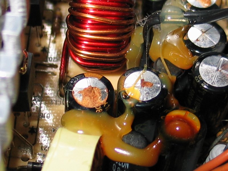

    It's full of bad caps:

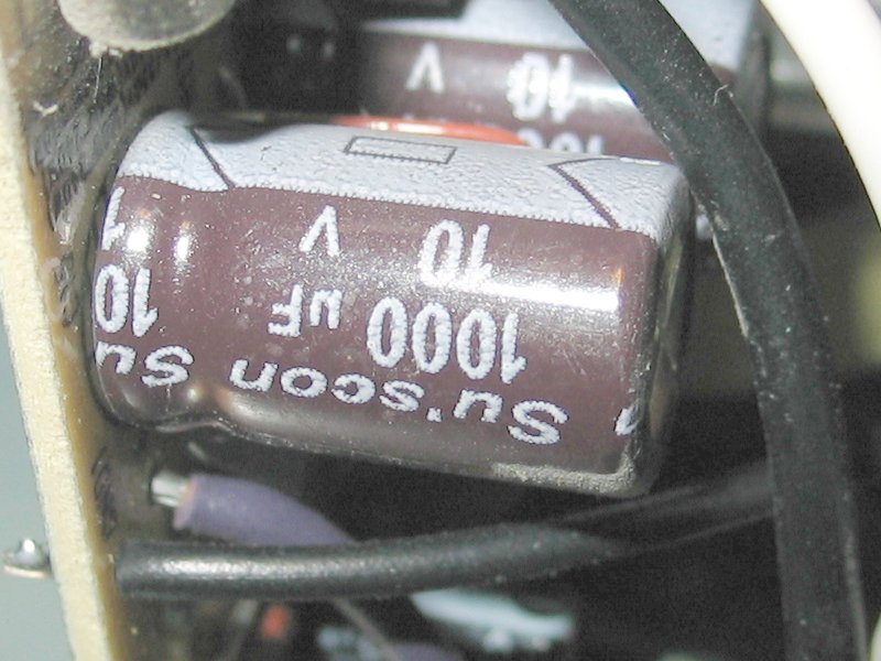

    This looked like a Nippon chemicon cap from top but I knew it can't be true:

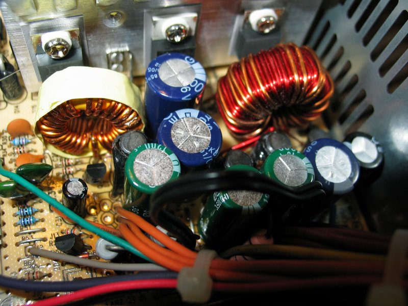

    New caps: Nippon chemicon 1200uF/16V, YAGEO 2200uF/16V and one KOME 1000uF/16V

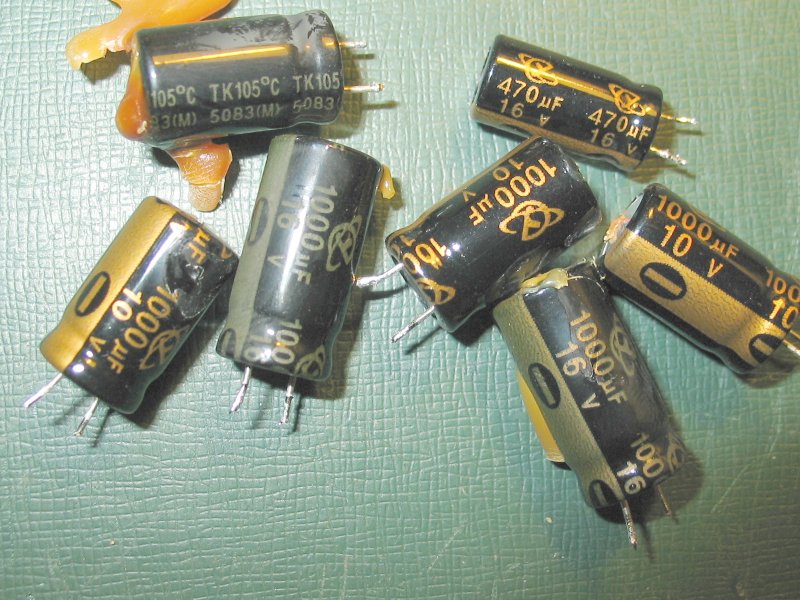

    The bad crap:
    Remember the sticker saying temperature controlled fan? That was probably the cause why it died so fast - the fan was running VERY slow and some moron placed the dummy load resistors right next to the (crappy) caps! I shorted the NTC termistor to force the fan to run at full speed - that will hopefully make it live a bit longer.
