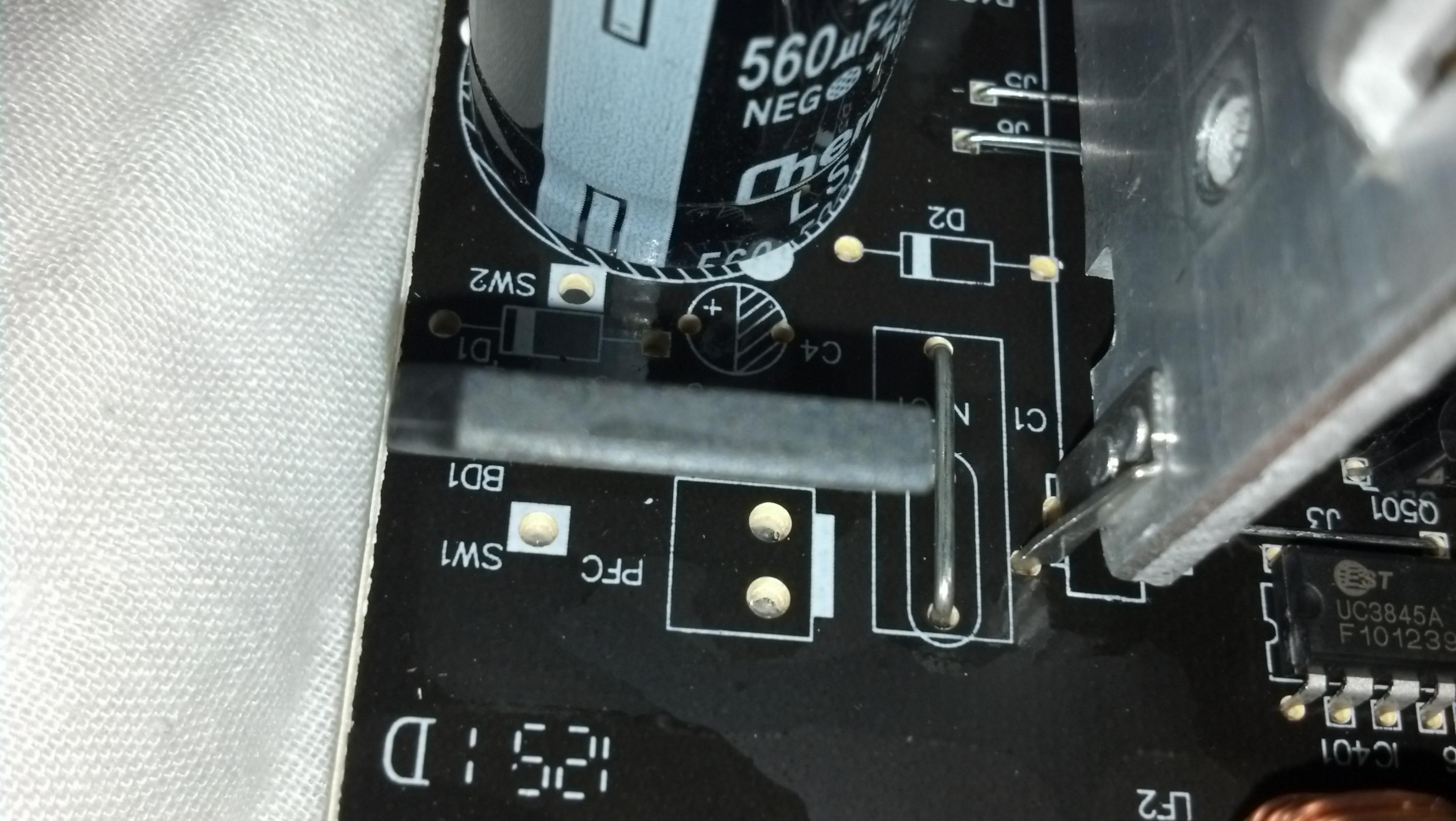

 Thanks for the reply. It is a voltage doubler. When you say "connect that" mid-point to one of the AC legs, what are you referring to?
 Edit: Oh okay I see SW1 and SW2 holes in the PCB, so I could just put a voltage selector switch there and it should work?Last edited by Pentium4; 07-30-2013, 12:11 AM.Comment

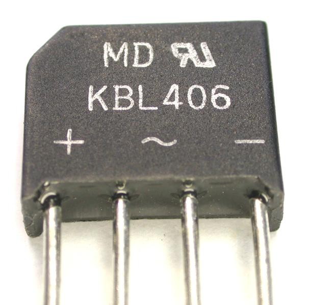

 (ASSuming you've got a packaged bridge rectifier, like a KBL406)
 The positive of one (call it C1) will go to the "+" from the rectifier
 The negative from the other (call it C2) will go to the "-" from the rectifier
 The negative of C1 will go to the positive of C2. This center-point, in supplies with the "voltage select" switch, is connected to the AC line, when in the "120V" position.
 See how the switch works with C5 and C6 in the diagram? That center point does not connect to the line when set to "240V," otherwise, each cap would have ~340V across it!
 But for 120V-only use and no switch, you need to run a jumper to permanently "set" it up as a doubler. Connect the jumper from that center point to either outer leg of the rectifier. If you've got four individual diodes instead, trace back and make sure you're going to either line or neutral with that jumper! If you connect the center point to the wrong diode lead, you'll partially short the rectifier out.
 No need for a switch, a simple jumper will do. Saves you from having to mount the switch. Last edited by kaboom; 07-30-2013, 12:16 AM."pokemon go... to hell!" Last edited by kaboom; 07-30-2013, 12:16 AM."pokemon go... to hell!"

 That should've been "to either inner leg of the rectifier." One of the two leads with the "~" by them.
 Sorry for the bad info...
 Just make sure one "SW" point goes to either "~" and the other "SW" goes to that cap "center-link."Last edited by kaboom; 07-30-2013, 02:45 AM."pokemon go... to hell!"

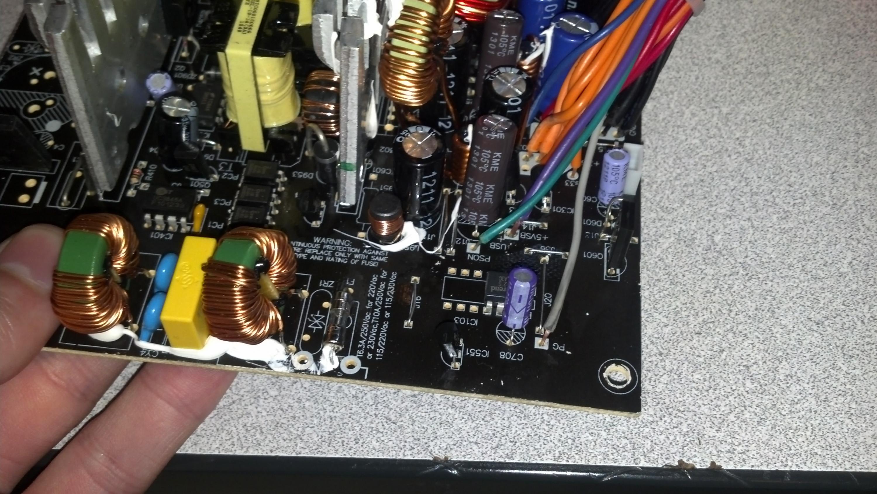

 It would be great if I could see more of that board, specifically from its AC input up to the line rectifier. There may be a place for a thermistor- it looks like there's a place for one where a jumper has been "substituted."
 Quite typical. That thermistor is omitted and a too-large fuse is used, to allow for the surge of those two caps charging."pokemon go... to hell!"

 Wow, good catch. I think this is the first PSU I've seen with no NTC Thermistor! I do have some lying around, should I add one?It would be great if I could see more of that board, specifically from its AC input up to the line rectifier. There may be a place for a thermistor- it looks like there's a place for one where a jumper has been "substituted."
 Quite typical. That thermistor is omitted and a too-large fuse is used, to allow for the surge of those two caps charging.Last edited by Pentium4; 07-30-2013, 01:35 PM.Comment

 If this PS doesn't have a line switch, adding an NTC will greatly reduce sparking when you plug it in. It'll reduce the inrush the two caps and rectifier see as well. If it does have a line switch, an NTC will reduce wear on its contacts.

 Ahh, a sample. Bet you the production units are/will be even worse!
 2.5 ohms at 25 degrees Celcius, and supposedly 8A average. They run hot at their full rating, so it's always better to oversize. At 2.5 ohms, it'll still "thump" a little, but better than no resistance at all.
 Is that thermistor 3/4"-7/8" in diameter and about 3/16" thick?
 It's "soiteny" an improvement!

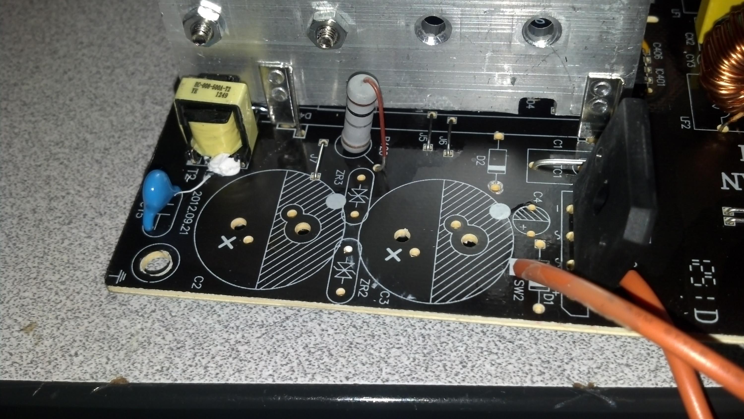

 I was pleasantly surprised to see the 560uF Cheng input caps test 575uF. I don't know a whole lot about MOV's, what are the most important specs? Are 7mm MOV's sufficient or are bigger ones recommended? I have some 7N271K's here http://www.gemkenz.com.tw/Varistor/N7%20TYPE.htmComment
 Re: Convert 230V only PSU to 115V?
 I'd say it's more important to have equalizing resistors across those two caps. 100K, 1/2W; 220K or 330K, 1/4W.I was pleasantly surprised to see the 560uF Cheng input caps test 575uF. I don't know a whole lot about MOV's, what are the most important specs? Are 7mm MOV's sufficient or are bigger ones recommended? I have some 7N271K's here http://www.gemkenz.com.tw/Varistor/N7%20TYPE.htm
 Obviously, in order for MOVs to conduct, the voltage across them must rise above their rating. As the MOVs will be across the caps, guess what have to charge up first?
 I'd personally settle for equalizing resistors w/o MOVs rather than MOVs and no equalizers, provided there's some form of an input filter.
 I could suggest better if I actually saw that portion of the board.
 Add them if you want, but make sure those equalizing resistors are there."pokemon go... to hell!"

 My apologies for not having anymore pictures up, I will take some tomorrow. Thanks for the consistent replies The two slots are labelled ZR2 and ZR3. I don't think it has bleed resistors either The two slots are labelled ZR2 and ZR3. I don't think it has bleed resistors either so I just unplugged it while it was running and the caps went down to 0.33V so I just unplugged it while it was running and the caps went down to 0.33VComment

 You should also have a "ZR1." Either across the line, or from either + or - of the DC bus to GND/chassis.
 They're not bleeders, they are equalizers! When they are connected in series, without the "center link" connected to anything, small leakage currents can cause each cap to have slightly different voltages.
 Ex- 240V in, rectified not doubled, with extreme leakage: 340 across both, with one having 140V and the other having 200V. The two resistors even this out. Again, that was an extreme example to illustrate the purpose of those resistors.
 Equalizers usually draw a milliamp or so. Or usually ten times the leakage of the particular caps in the ckt. Bleeders draw more current, and are [i]specifically[/i used/sized to discharge x microfarads in y seconds.
 Your caps discharged quickly because the unit was running from them.
 Usually, you end up with 40-80V left when unplugging-while-running, because of low voltage cutoff. Sounds like this supply will "attempt" to run even with low line voltage- could be stressful to the switchers."pokemon go... to hell!"
