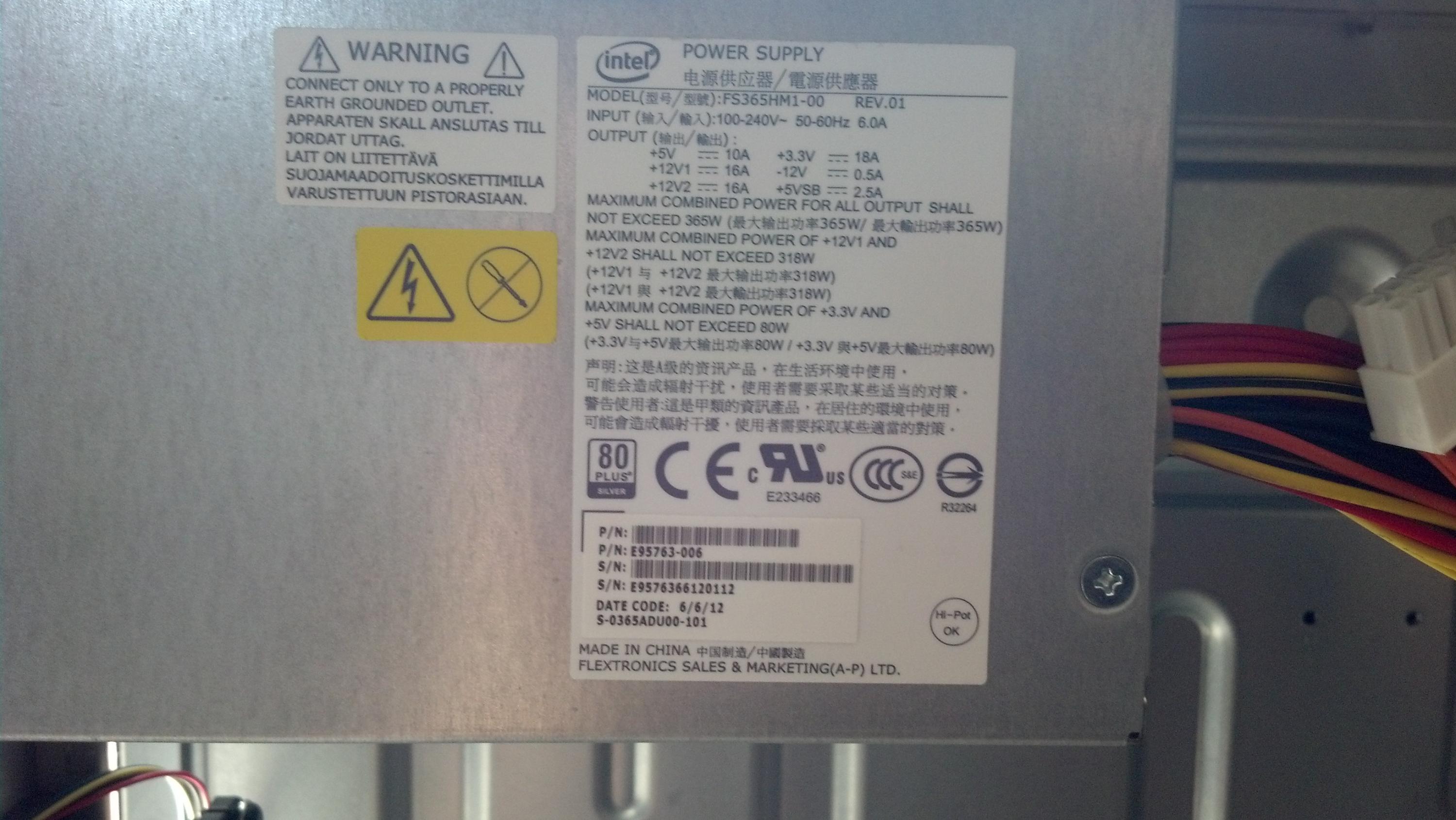

                                  Check it out, looks like this Intel branded power supply is made by Flextronics. Unfortunately I cannot open it up and void the warranty because it is in a server for a client....
                                  It looks very well built but the cap choice is poor....270uF 450V Elite cap on the primary, the rest are Taicon and CapXon....Taicon aren't terrible but CapXon in a server PSU? Whyyyyyy that is a low 5V rating but shouldn't matter much in this server
