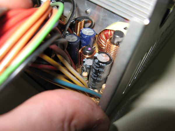

    veden ms-300w

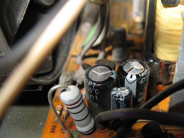

    fuhjyuu working many years
    bulging fuhjyuu not so lucky, psu not start

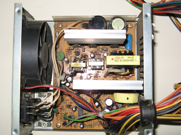

    With that main transformer and those heatsinks, 160W total power would be pushing your luck, let alone 160W on just the +5V and +3.3V. No I/P filter, can't see the I/P rectifiers.

      hey it ran a p3 866 for a while. no zeners either (which is a big negative in my book.....but anyway its just trash lol
      hey it has 470uf primaries
      problem is how to find a replacement. probably the smallest thing i will find these days is a 500w bluestorm
