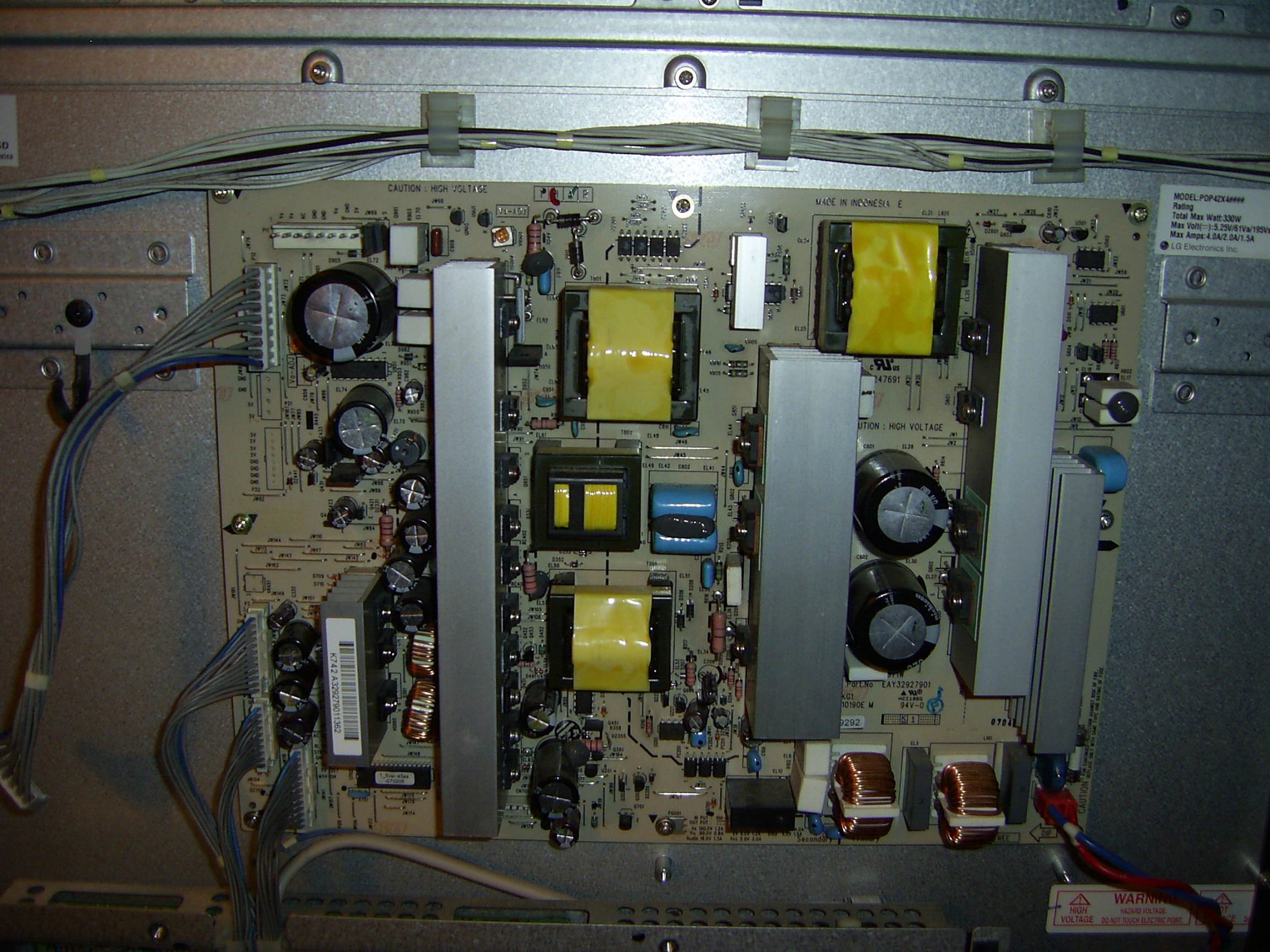

    LG 42" plasma power supply voltage double normal
    I am working on a 42PC5D LG Plasma tv and after replacing the Y sus board and Y buffer board still having problems. At first the fuse was blown on the Y SUS. So I replaced it with another one(another y board) and the tv powered on for about 5 seconds showing just the color pixels lite up before tv cut itself off. The fuse blew on the new board also. The tv will stay on with the Ysus and Zsus boards disconnected. Sound works fine.
    So I started checking the voltages on the PS board. Sometimes the power checks fine and others it is double what its suppose to be. i tried to adjust the Vs pot and voltage goes down alittle but not enough. From 423 to 368 volts. Its suppose to be 192v. I am new to component repairs but am learning alot reading forums and such.
    What will cause the voltage to remain high is my main question.
    I could just replace the power board but that doesn't help me understand whats wrong with the broke one. Any help is appreciated.

    Re: LG 42" plasma power supply voltage double normal
    Also the voltage to the sound board is high . 6v is 12v, 3.4v is 7v, 12v is 24v etc.
      This is a picture of the PS
        You probably have a multimeter that has a low/near dead battery, but there in no indication on the lcd. We get this at least once a week.
        Replace your battery with a fresh one and redo your readings. All readings should also be DCV.
          In case you did not know, you should also have a load on the high voltage of the power supply for the voltage to run stabilized. For my LG plasma the training manual recommended two 100W bulbs in series. Also be very careful working with these as it take a while for the voltage to bleed off the capacitors.
            You were right retiredcaps the meter battery was causing the high voltage readings. Now that the readings are correct coming off the power board I still do not understand why the tv cuts off with the ysus connected. I bought a used board off ebay and it tried to turn on when first connected but now tv cuts off after 2 or 3 seconds. Could it be the board I bought has problems also?
            I tried to get a voltage reading at the connectors when I first turned on the tv but barely get .1v and tv cuts off. I hear a wine in the chip on the ysus for a sec right before tv cuts off. Any thoughts as to what to check next?
              I did get the 5v reading but no Va or Vs
                The SMPS seems to be detecting a short and not turning on the high voltage power which is why you are not getting a voltage reading. It sounds like the new board may have been fine but you have a problem farther downstream that is blowing the Y-SUS. I have attached the training manual that should apply to this model. I would do the diode tests on pages: 41, 46, 47 and 48. You should also check the Z-SUS for shorts.
                  Thanks so much for the service manual. After doing the checks you suggested on my old and the new y buffer board it looks like both are bad. I will try to return the one I bought on ebay for a refund and buy a different one and see if that works.
                  Haven't checked the Ysus yet. Now I have my doubts as to wheither its good either. Too late to return that one ifs its bad. Checked all the voltages per service manual on the SMPS and all are present at the connectors. Hard to get good repaired boards these days. I try to buy boards from tv's with broken screens as they seem to always work compared to buying rebuilt ones.
