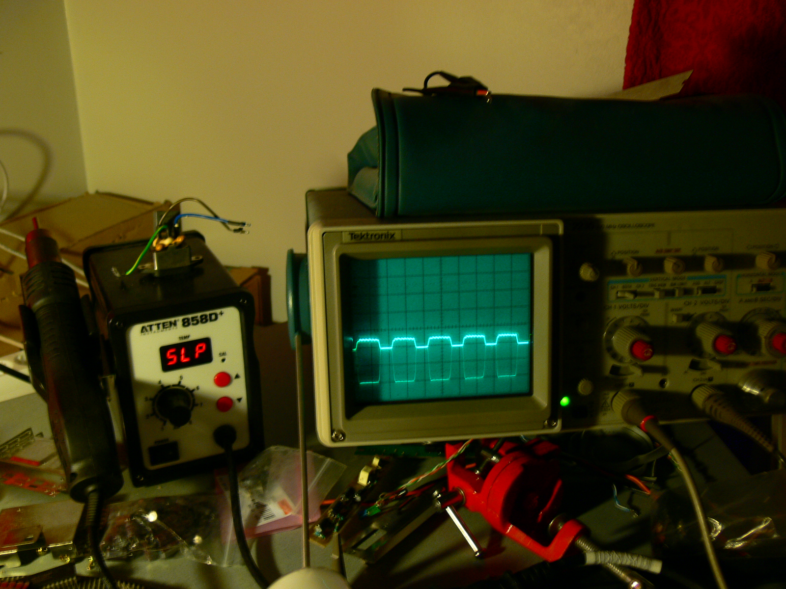

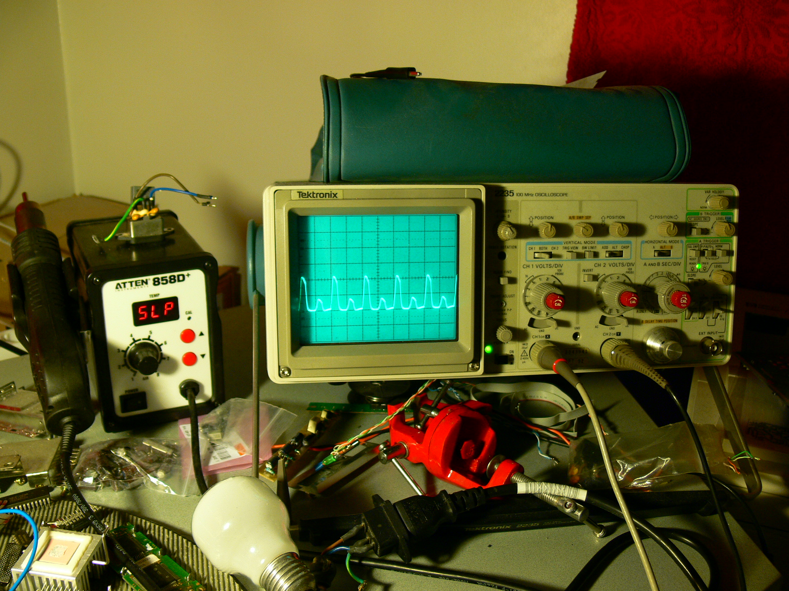

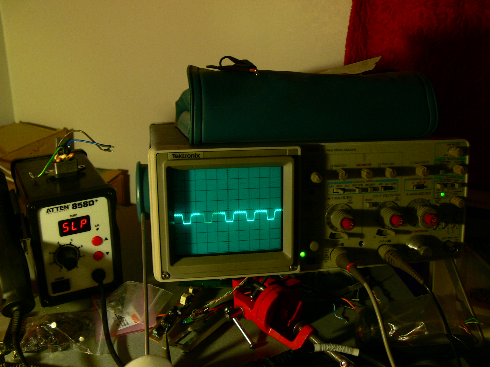

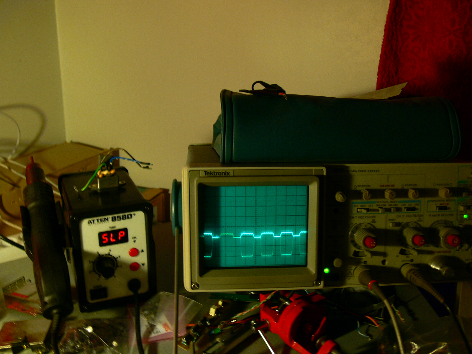

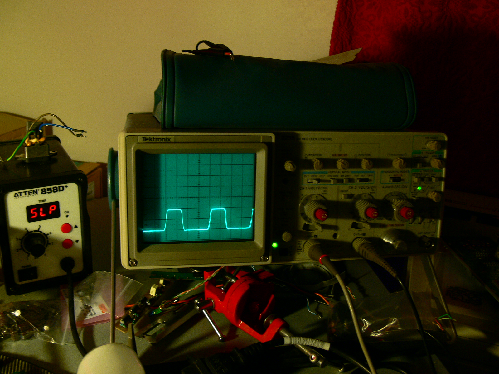

                                    Ok, i promised some scope shots. The settings stayed the same: 5V/div for both probes, 10ms/div (that's milliseconds), both channels DC-coupled. Channel 2 = permanently hooked up to the negative leg of the mains cap (used as "ground"-reference). PFC components not in circuit
                                    Picture no.1: PSU plugged into the mains (through bulb-tester), but not turned on (ie. only 5Vsb on); both probes hooked up to the negative leg of the big mains capacitor
                                    Picture no.2: Ch1 probe before the gate resistor of one of the PFC FETs
                                    Picture no.3: Ch1 probe on the (tied together) bases of the totem-pole transistors
                                    Picture no.4: Ch1 probe on the Vcc supplying the totem-pole
                                    With both channels switched to Gnd, the "base line" is the first horizontal line above the lower edge of the 'scope's reticle.
                                    EDIT: Out of sheer curiosity, i scoped the 5Vsb line as well (Ch2 on the secondary ground (black ATX lead) and Ch1 in the purple 5Vsb lead), with the same settings as above, and i ended up with the waveform visible in picture no.5 If i scope the 5Vsb "normally" (single channel, ground clip on secondary ground, probe tip on 5Vsb) i get some ~20mV ripple at some tens of kHz (the 5Vsb chip's supposed to be switching at 67kHz).
                                    Something's fishy here.....

                                      Do you have an isolation transformer?
                                      I think you should put the PFC parts in, and run the PSU with the lightbulb trick. Then scope each gate pin of the three PFC MOSFETs.
                                      A 1ms period is 1kHz; most switching regulators (PFC, SMPS, etc..) run at 50kHz-100kHz.
