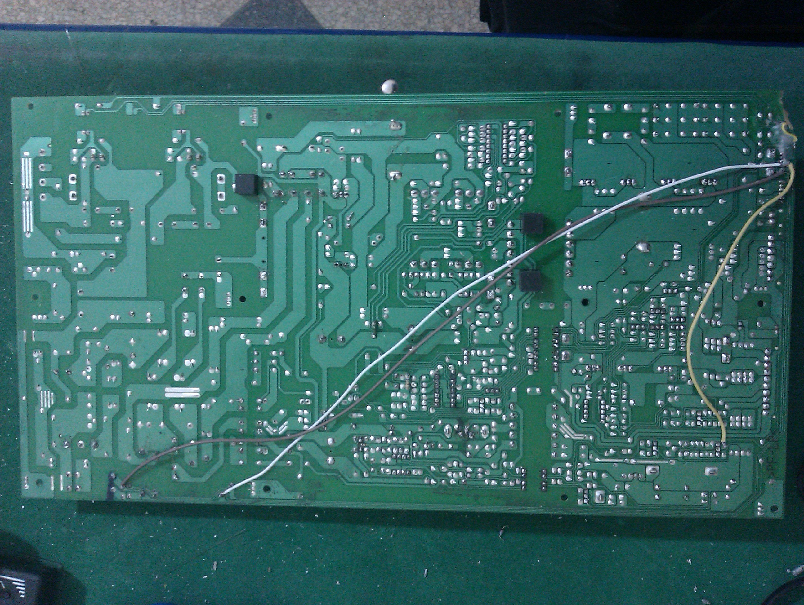

    hi guys,
    I need your help
    to tell you I am not a professional on electronic
    I repair office machines (copier, laser printer ...)
    I have a problem with a power supply board for a copier
    apparently had a hard blow
    many components are burned
    I tested and changed I think the majority of burned components (bridge rectifier, filter capacitor, some resistance)
    the problem I do not found the original circuit FA3647 I replaced by FA5317
    and a transistor 2SA1015 by A733
    now I have low output voltage ! 0.7V
    i would to know if FA5317 equivalent for FA3647 or not ?
    and transistor A733 can replace A1015 ?
    for now i can't do anything before I found the replacement for these components
    Thank you and sorry for my english

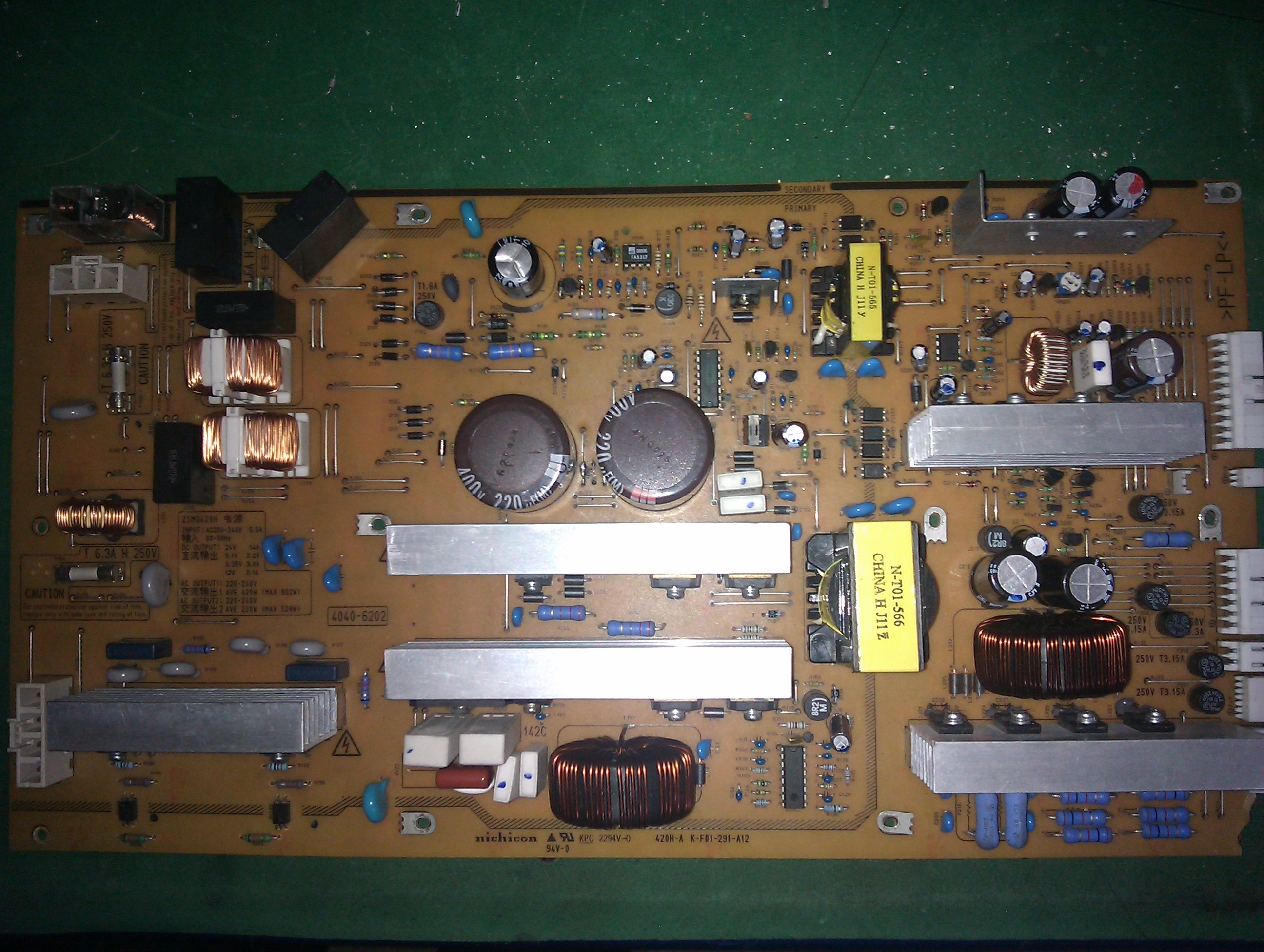

      If a photo of the board can help I can take a photo and upload it .
      the dc voltage in Vcc pin of
      power ic FA5317 fluctuate between 9V to 16V
      the test voltage in secondary ( diode shotky) = 0.7V
      it is a complex supply
      it gives 3.35V - 5.1V - 12V and 24V
      and 220V to power supply the lamp in fuser unit
      here is a picture of the board in ebay
      http://www.ebay.com/itm/KONICA-MINOL...-/170915607745

        FA5317 is *not* a direct replacement for FA3647. If you'll look closely at the block-diagrams (or internal schematics) of each, you'll notice several differences:
        1) pin 3, the current sense - it's marked with a "-"on FA3647 and goes to the inverting input of a comparator (internally), and a "+" on the FA5317
        2) 3647 seems to only need a resistor for setting the switching frequency, while the 5317 needs a resistor and a capacitor
        3) there also seems to be some extra circuitry in the 3647 between the FB pin and the internal oscillator

          Re: equivalent for ic switching power supply control
          Was the FA3647 damaged (burnt, blown up)? Can you take good clear pictures of top and bottom side of the board?

            thank you Khron666 for your explanation
            I thought even if the internal diagram is different the result is the same, but this is not the case

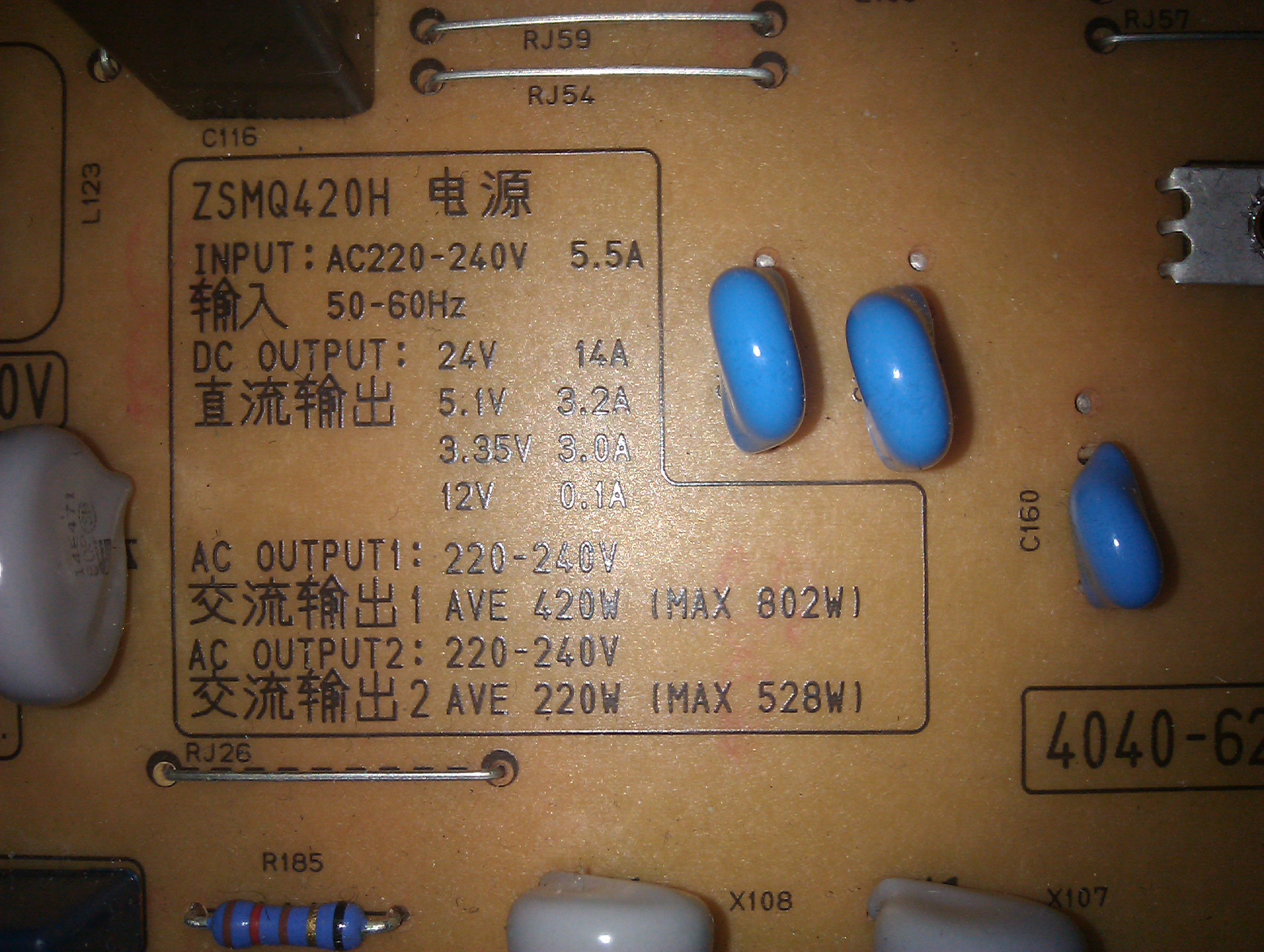

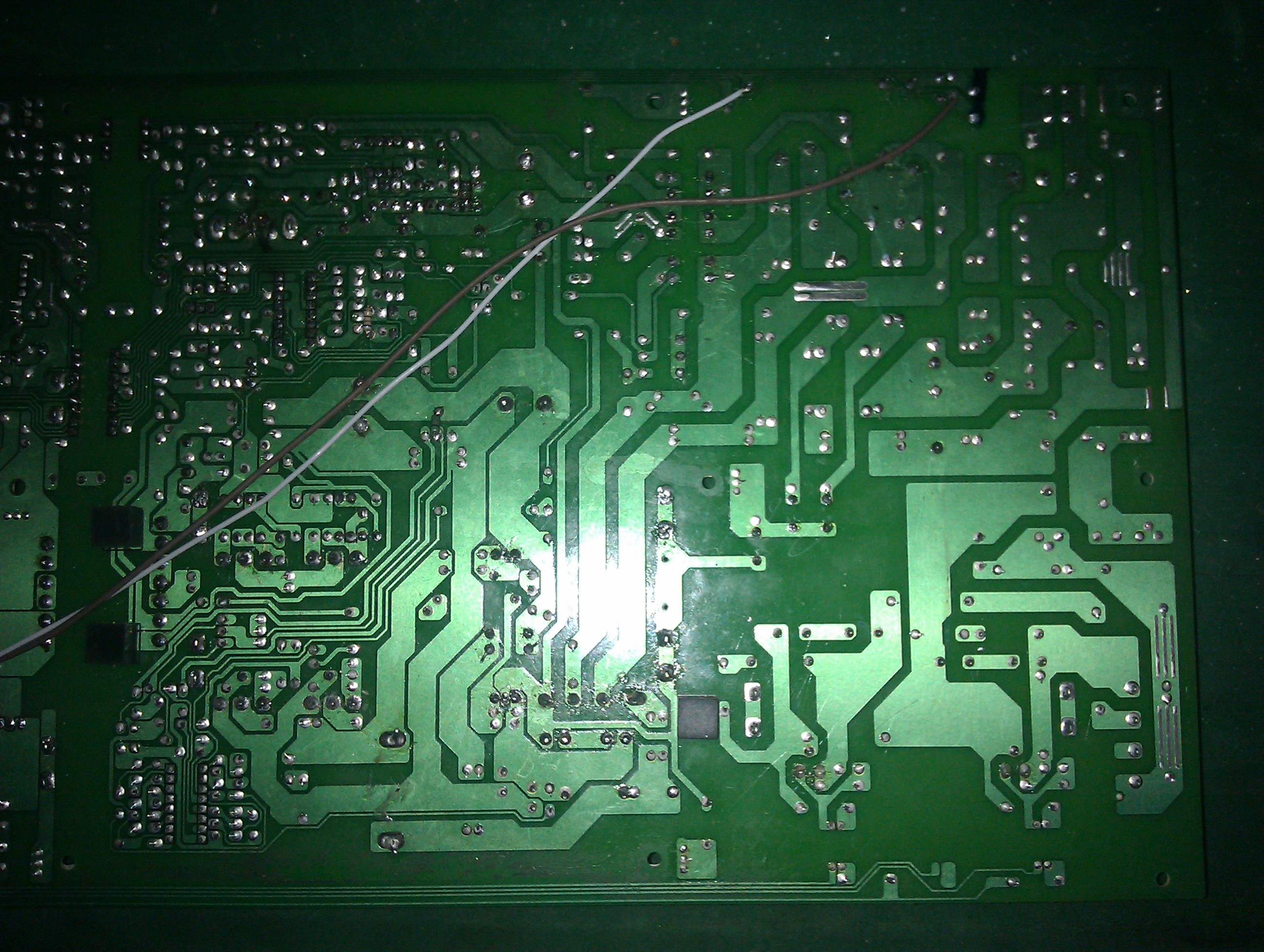

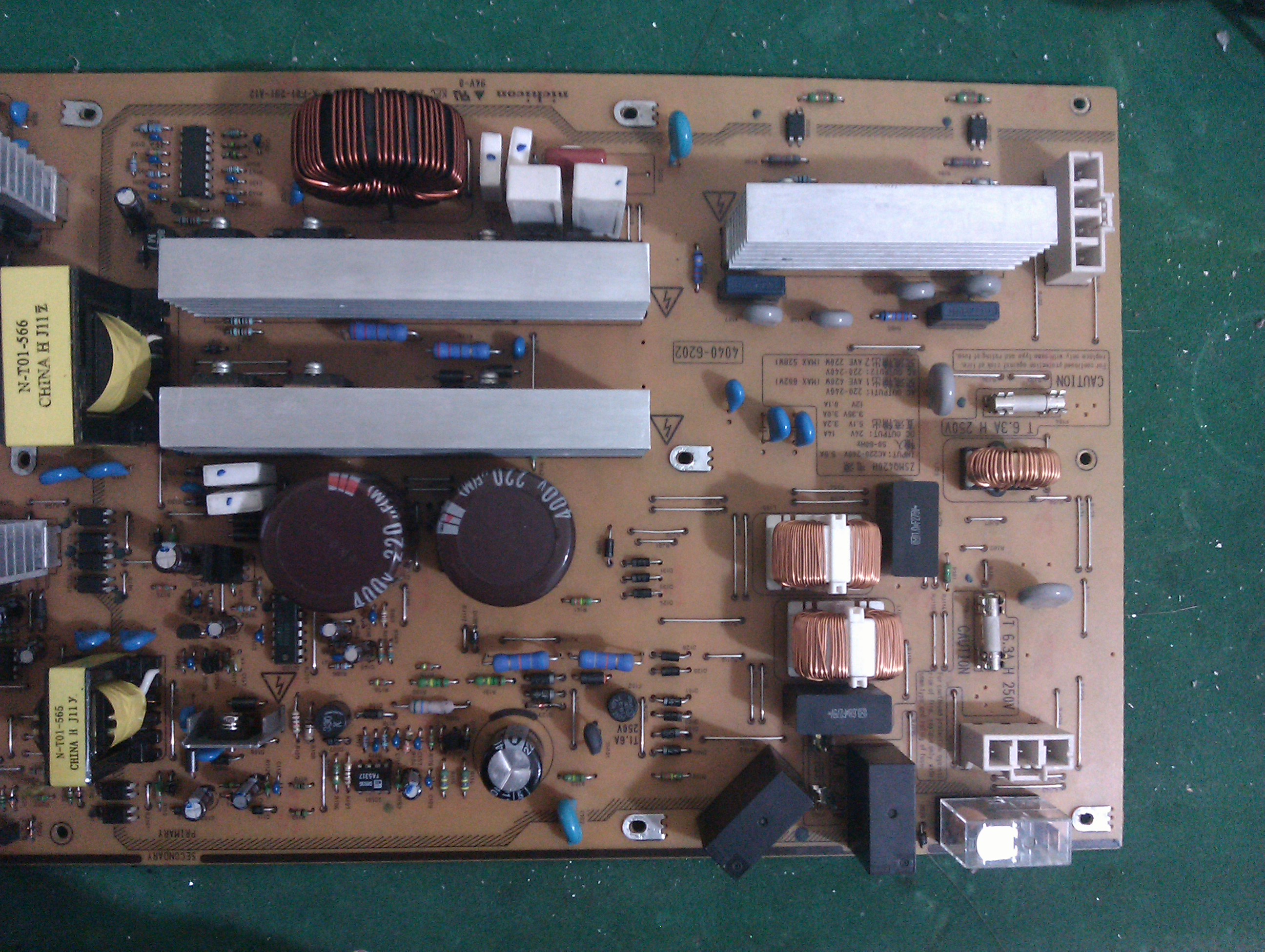

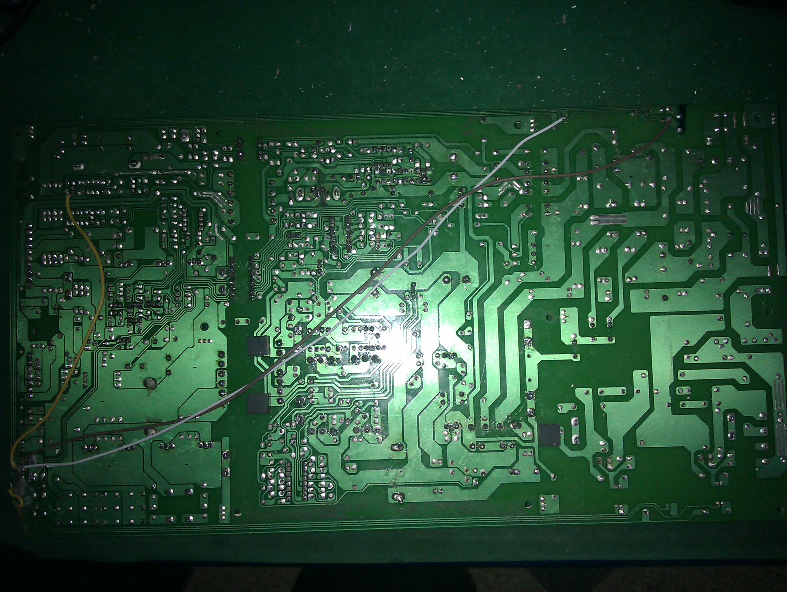

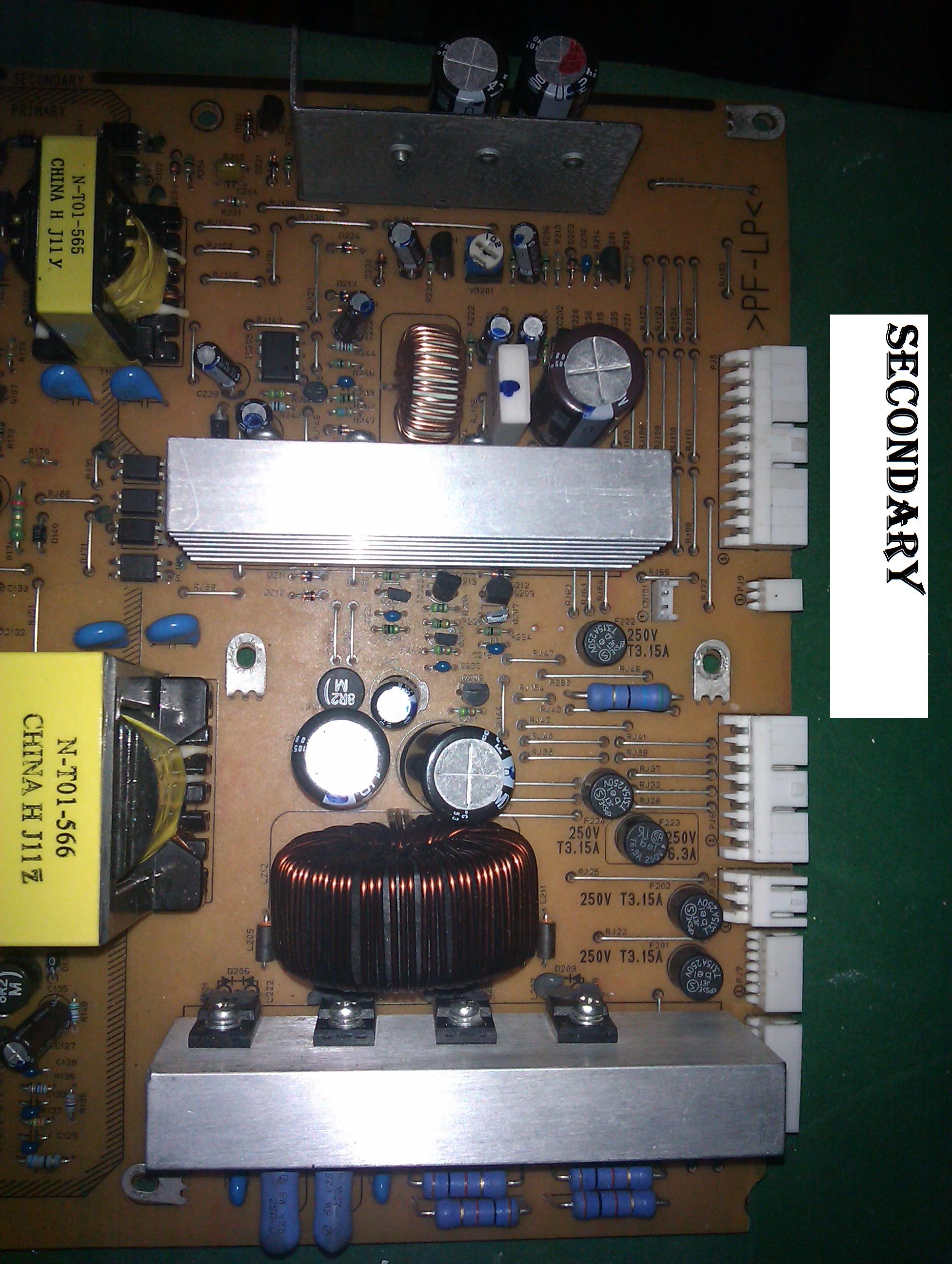

            hi budm the FA3647 blown up
            I hope that these pictures in attached files are clear to you because the board is a little big.
            the board is fragile the slightest shock can break him just as you can see in
            the picture in extremity of board but this is not a big problem,and with all
            these components the board can deforms easily .
            I changed several components burned into the board , I can tell you these components if you want
