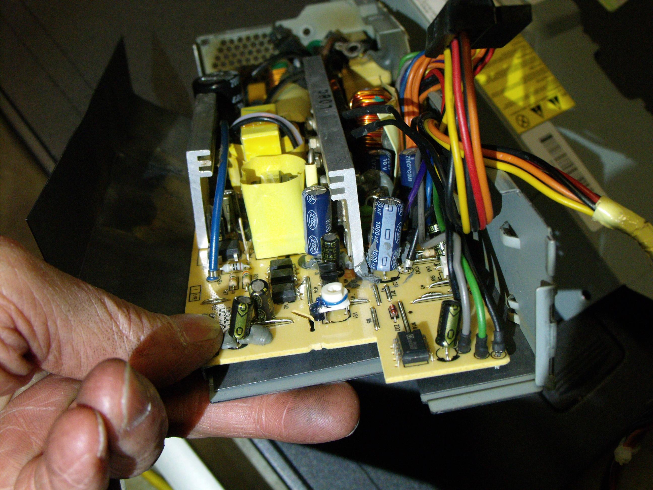

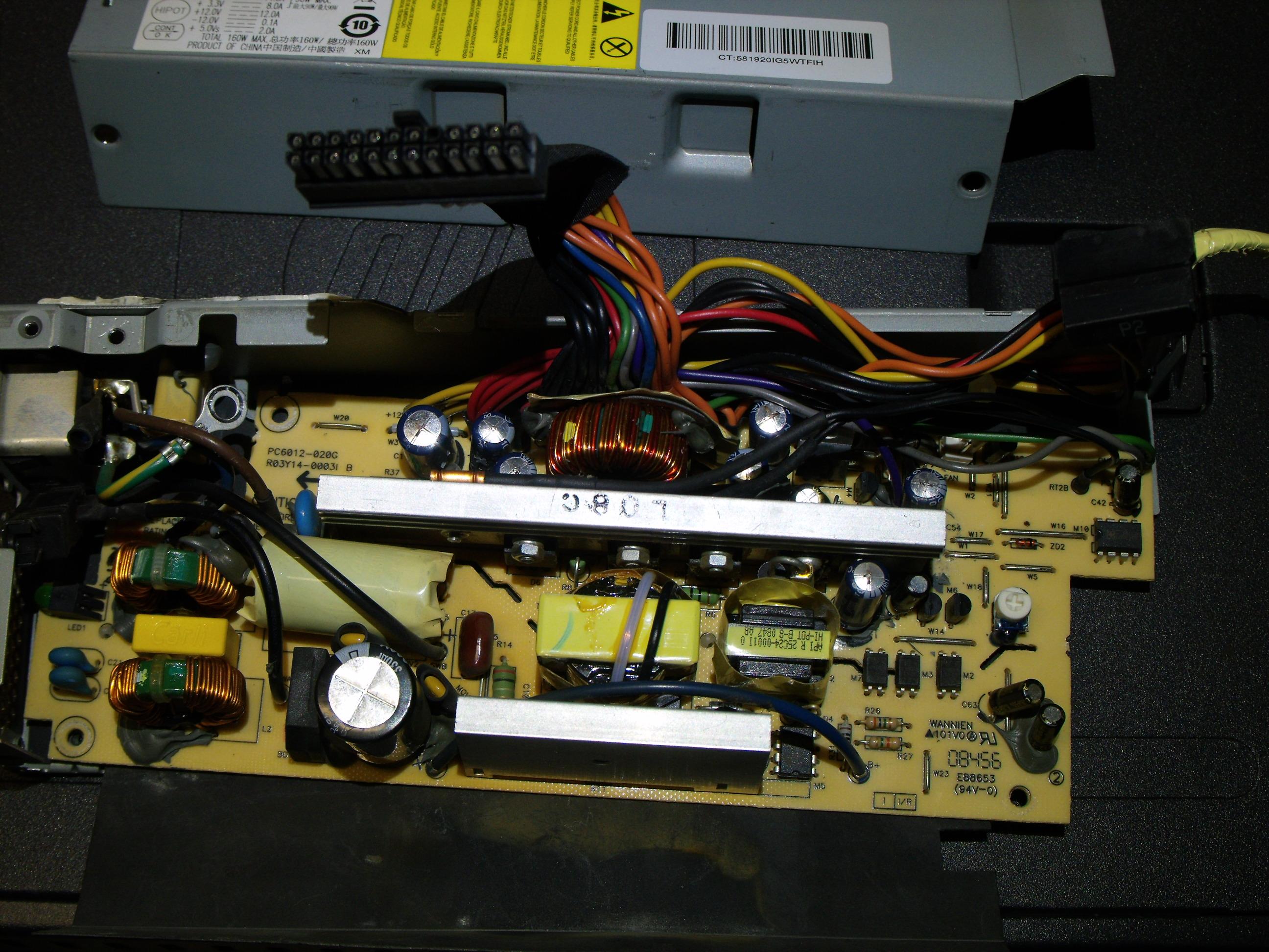

    need suggestion on caps for dead AcBel/HP 5188-7520
    I got a "free", dead HP Pavilion Slimline Pc. The AcBel PC6012 / HP 5188-7520 PSU has 7 bloated caps and I want to replace them to see if this will get the PSU working for further diagnosis or just up and running.
    It's got:
    6 - Ltec 1000uf 10v LYZ 105c caps
    1 - Ltec 1000uf 16v LYZ 105c cap
    What should I replace these with? This will be my first PSU cap redo.
    I looked at these but need some advise;
    Panasonic eeu-fm1a102L - 10v (x6)
    Panasonic eeu-fm1c102 - 16v (x1)
  • Khron
    • Sep 2006
    • 1350
    • Finland
    Re: need suggestion on caps for dead AcBel/HP 5188-7520
    Those look like some good choices, actually
    Just don't forget to change all the small(er) caps too, "just in case".
