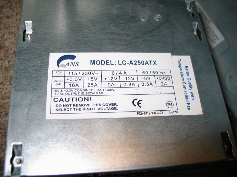

    Ans Lc-a250atx

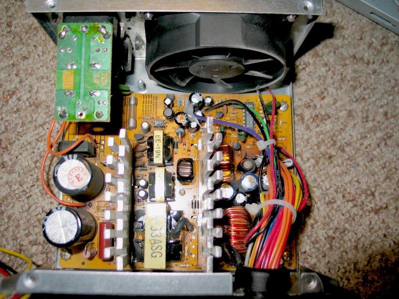

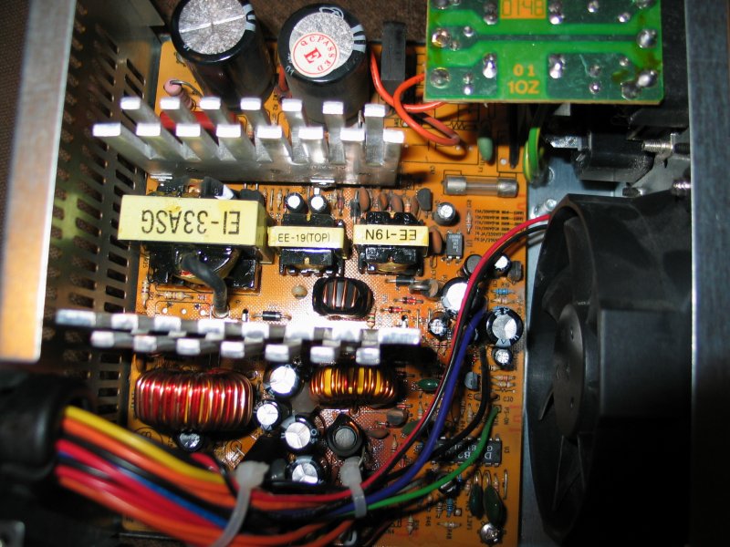

    Typical LC crap, this time with "better quality because of quiet fan"
    Empty inside:

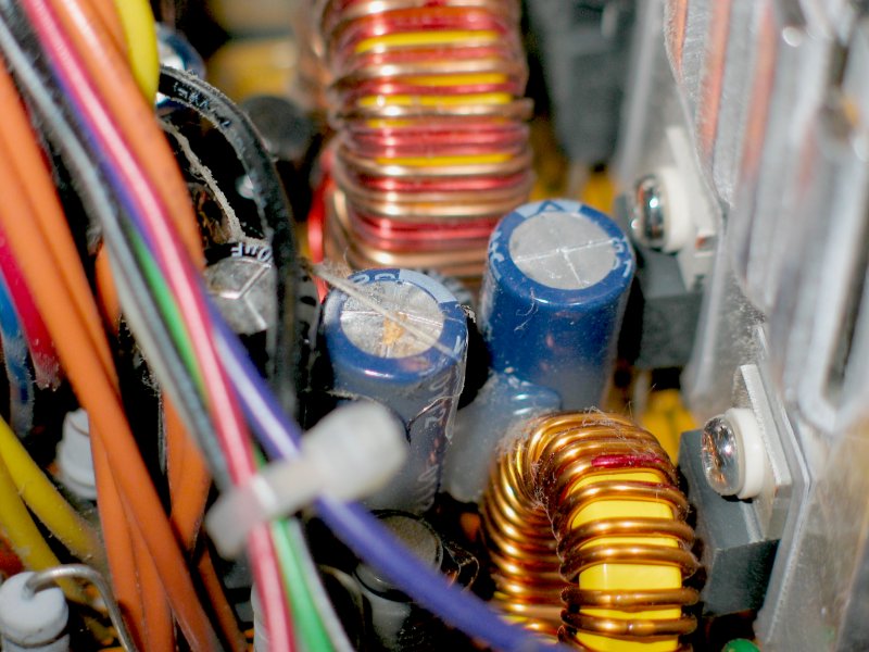

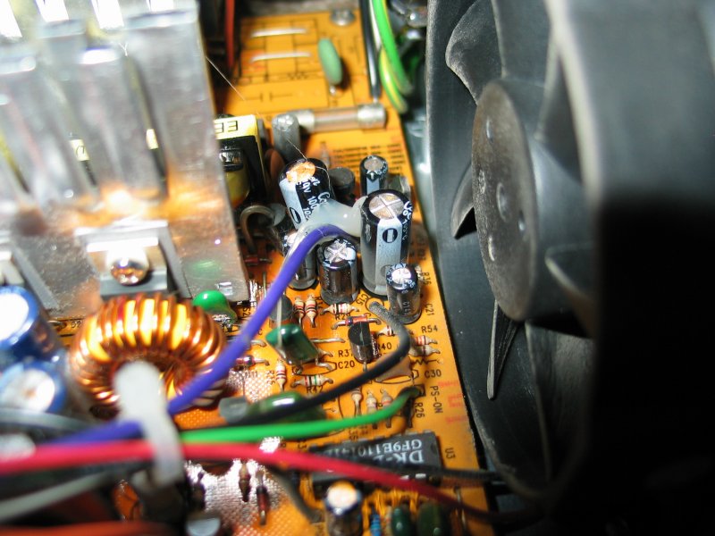

    Bad JunFu caps:
    Bad Canicon caps:

    Looks like their '400w' models!
    Seriously, from what I've seen, Canicons are some of the worst. I've seen them fail, leaving Fuhjyyu and the like alone!
    You know there's something wrong when you open up a PSU and are glad to find Teapos.

      At least the fan is quiet comapring to "300W" models with no fan control.

        I have replaced the two 2W resistor near the +5v wires with 5W big ceramic version.
        It seems every time I repair a psu it's an L&C alright.
