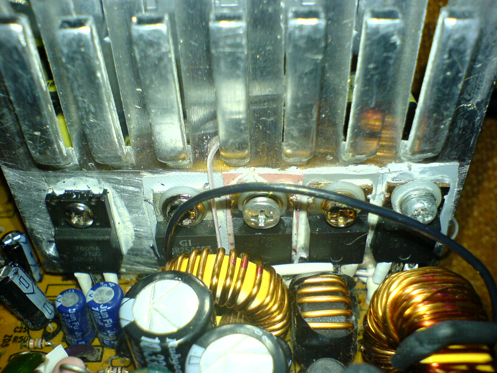

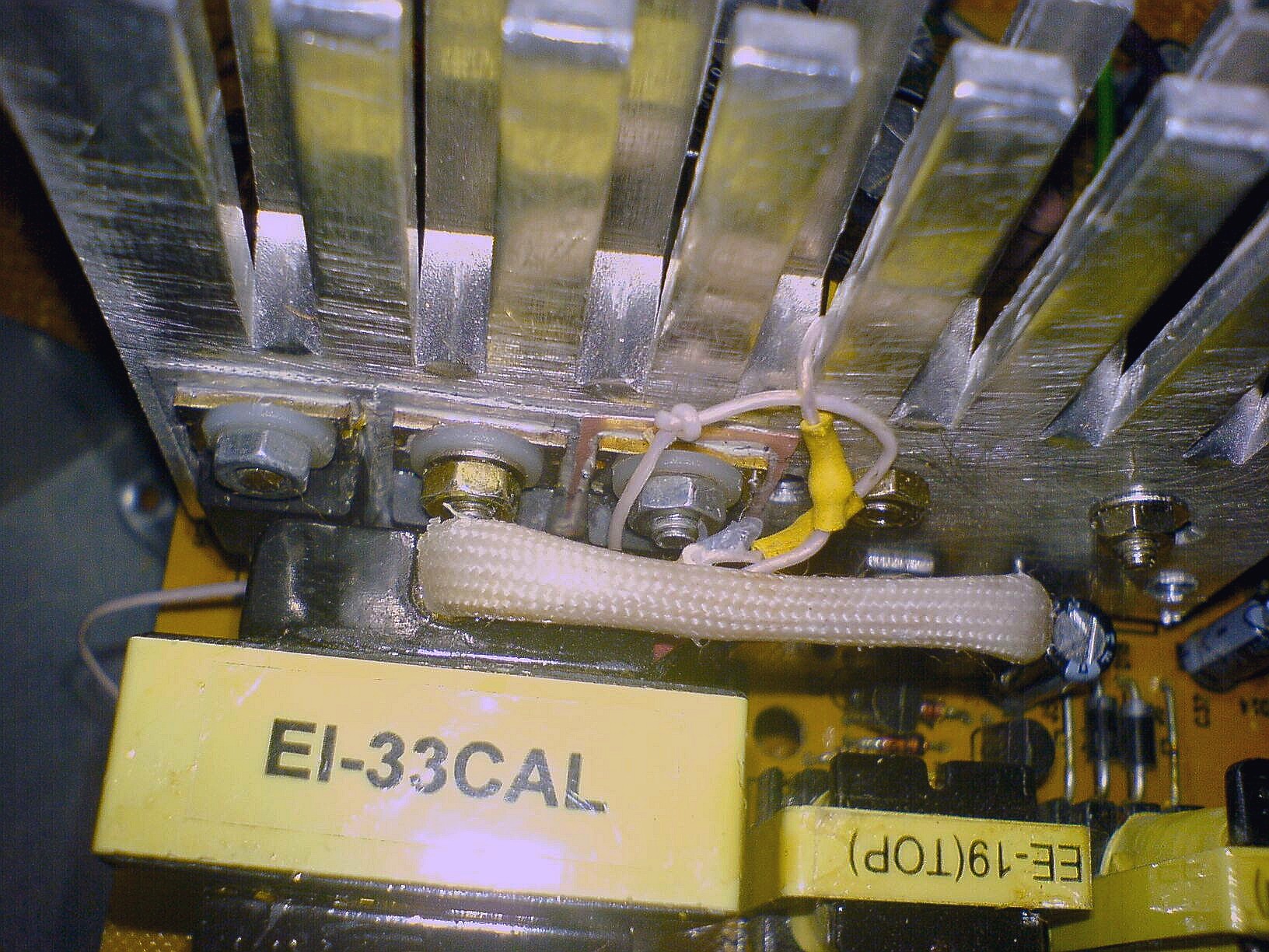

          First I want to thanks for reply.
          This photos is with PC-ATX modify by me for synchronous rectification.
          I wanted to see one made industrial.

                I will provide some information but not now, and I want some photos or schematics, because I work on this topic from 4 years (is on of my personal project) and I invested too much time and money.
                Regarding efficiency: with same load, the temperature of radiator of rectifiers is with 28ºC lower, in same conditions of ventilation.
