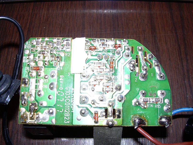

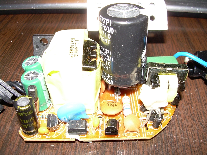

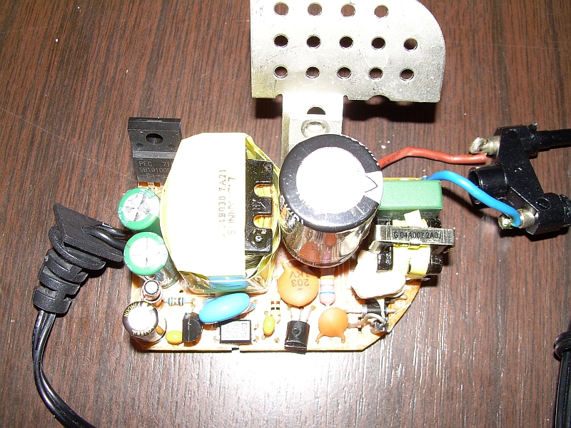

    Got this 12V 1.5A psu and I wonder if it is possible to lower the output voltage to 8-9 V ?
    I have no idea if it is possible without redesigning the whole psu or changing the transformer.

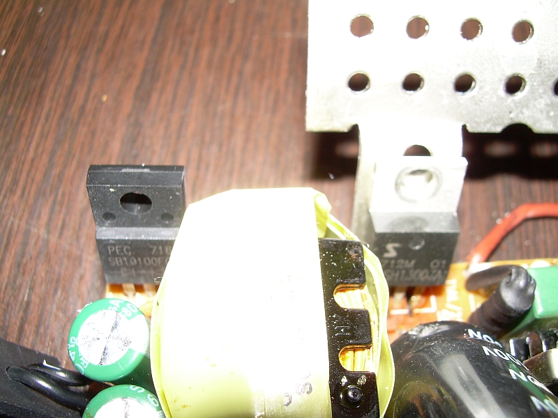

    The TO220 on the left is a SB10100FCT and the TO220 on the right is a KSH13007A if it matters.
    Re: Lower output voltage from 12V to 8V possible ?
    Possible, just that it'll need a higher minimum load to work properly.
    You can adjust output voltage by adjusting the resistors on the TL431, which is the TO-92 package on the secondary side of the optocoupler. Just to the left of it in picture 2.
    The TL431 will have a voltage divider from output to ground, with its middle point connected to pin 3, by replacing the lower resistor of the divider (the one which goes from pin 3 to ground), with a higher value it is possible to decrease the output voltage.

        Looks like R11, the through-hole resistor next to the TL431, is the lower resistor (from adjust (pin 3) to ground).
        Looks half decent, with a fuse, and input filtering. I'd just replace those caps too

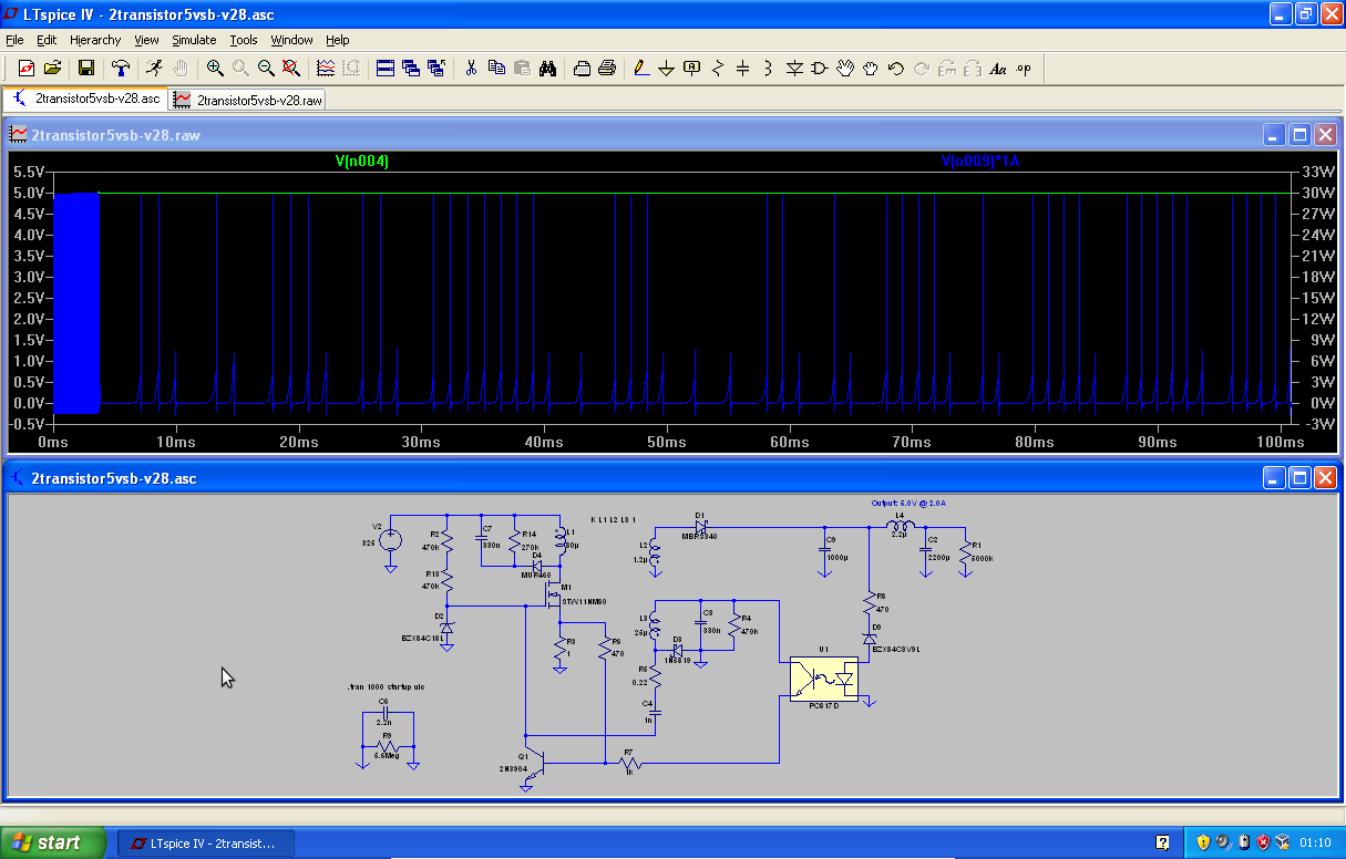

                        I've played around a lot with the self-oscillating two transistor design. I kind of finally understand it -- ish. The auxillary winding is important for start up but it forms a much more important part of the operation of the supply. It essentially drives the MOSFET gate effectively allowing it to operate at high frequency and reasonable efficiency. The gate drive capacitor couples the drive pulses so the supply can start up (a large capacitor slows start up but increases drive current.)
                        This design will also start up with just the load from charging the output capacitors up, then hiccup to keep the output in regulation, and still be fine with heavy load after doing so. See below. It doesn't require a TL431, can just use a zener for feedback.
                        Only real application I can see a supply like this useful for is driving LEDs. It's very efficient and cheap. For standby supplies it's too expensive to implement for more than about 2A. Though I have seen a three-transistor variant in a 32" LCD TV... for the backlight inverter power! (About 150W.)
