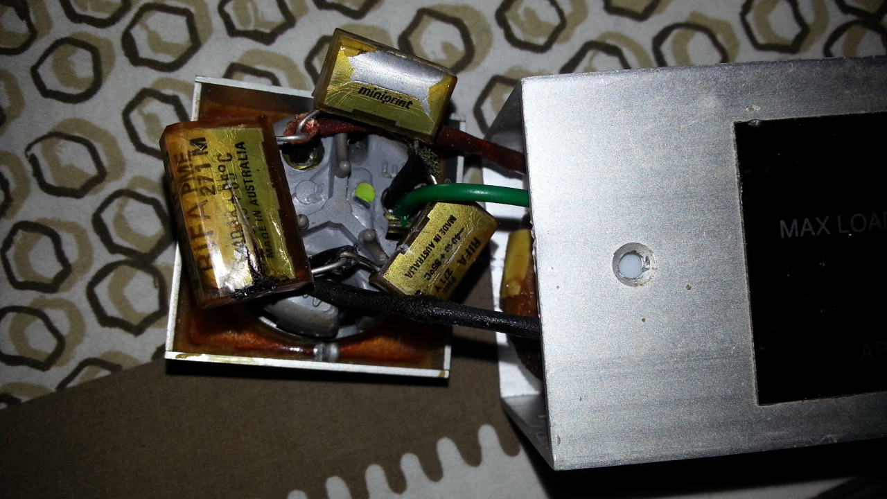

Mains filter - it was easy to find out why...
  • japlytic
    • Oct 2005
    • 2086
    ...it was not doing its job of filtering out mains noise.
    A bad Miniprint (by AEE or Rifa) X-class unit was found inside an Aegis CZ5000 mains filter.
    This cap, along with the two Y-class units were replaced and the problem was fixed - Miniprint and other clear epoxy encapsulated units are often problematic.
