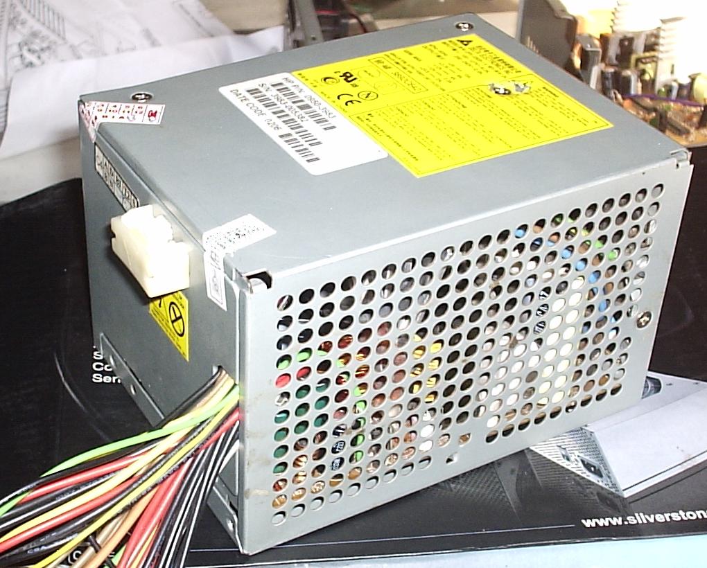

    i dont want to skimp on picture sizes, but i limit it to 1024x768 resolution.
    the grill:
    in anyway, you can't mount it in an ordinary case. but that's not a problem for me, i almost always place the psu outside the case. fortunately it's me that when people see this oddity they will always agree of my explanation. i explain to them that it is better for their hardware to run much cooler and last longer with that style. it's not that i'm lying, i'm not (at least i believe i'm not ).
    anyway it looks not that bad. but feel free to disagree :

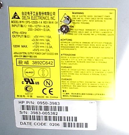

      on the label, it says:
      Code:
      DELTA ELECTRONICS, INC.
      Model: DPS-125EB-1 A REV: 04
      INPUT:	100-127V~/4.0A,
      	200-240V~/2.0A,
      47Hz-63Hz
      OUTPUT:		 +5V ===/ 15A,
      		+3.3V ===/ 8A,
      		 +12V ===/ 4A,
      120W MAX.	 -12V ===/ 0.3A,
      		 +5VS ===/ 2A,
      +5V & +3.3V Total Output Power Can't Exceed 80W.

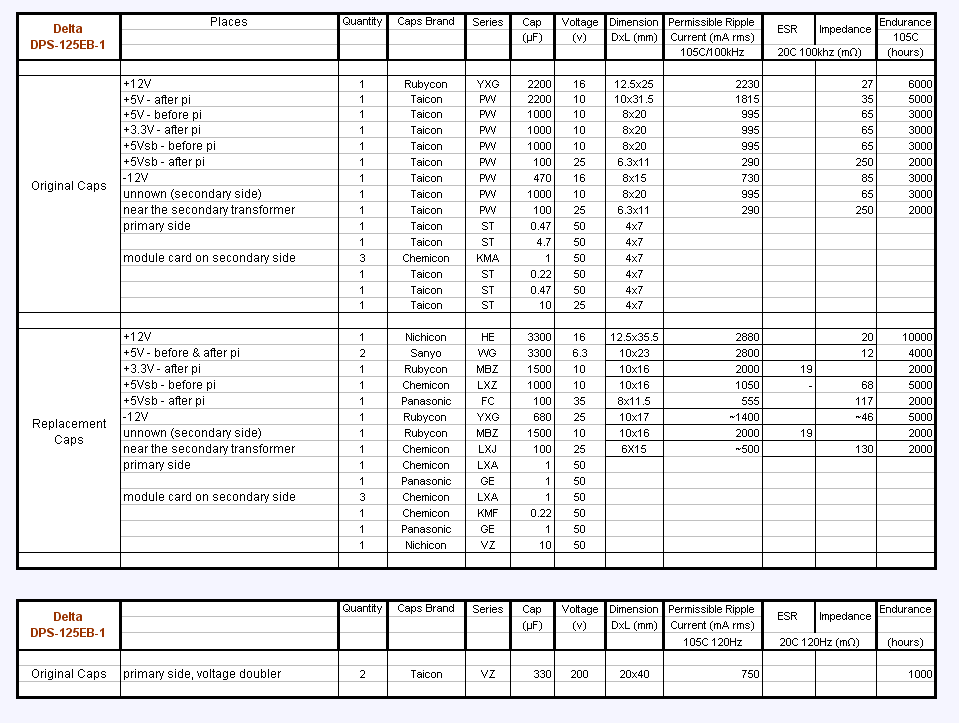

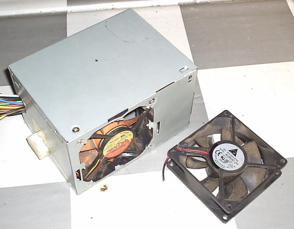

        oh, the original delta fan is dead. i replace it with my spare thermaltake fan. and i take all the pics after i recaped and "re-fan-ed" long time ago. the fan is connected to a small module/card in the secondary side area. the caps was almost all taicon pw series, except one 2200uF 16v 12.5mm Rubycon YXG.
        the delta fan is:
        DC BRUSHLESS
        model: AUB0812H (// obviously the high rpm type)
        DC12V 0.26A
        Delta Electronics, Inc
        Made in China.
        this is not a cheap quality psu, but i dont know why this delta fan is the first to fail. maybe because it's not a ball bearing?

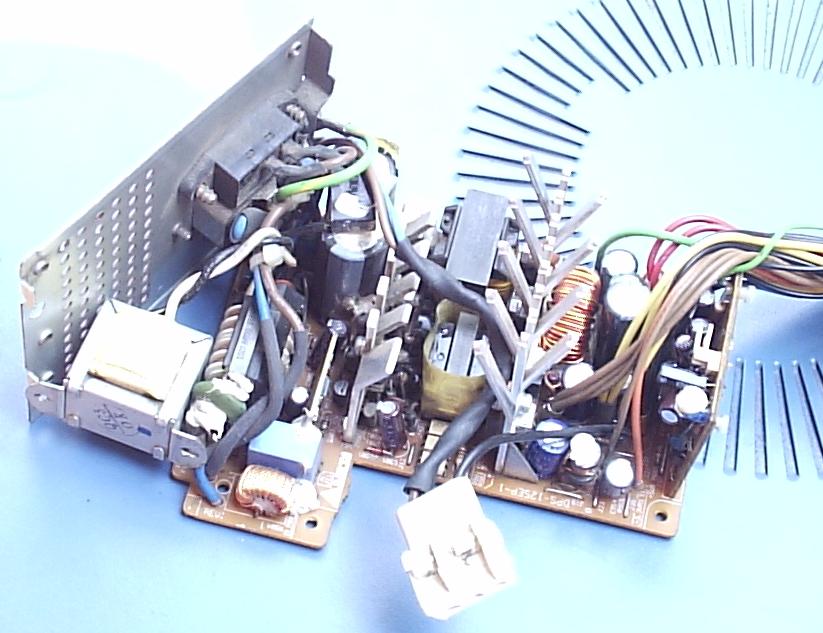

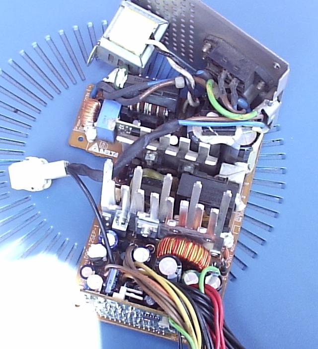

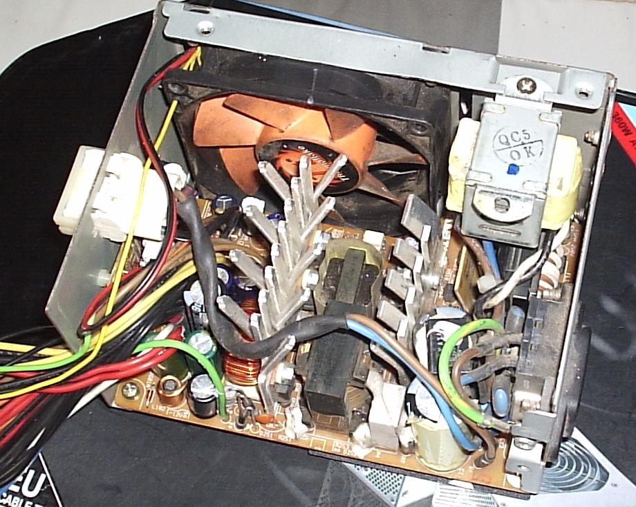

          finally, i was able to figur out how to dismantle the casing, so i could see the inner side. this is its look now (after recapping):
          Scottky Diode: MBR2045 === 5V <- that's the only one i could see
          it has a passive pfc. the input filter is complete. i guess the original taicon caps is taiwan version of nichicon japan.

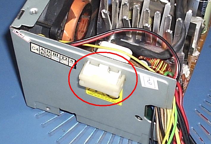

          i wnder what is this white connector for.. (line, neutral, ground)
          days are so short when you actually do something..

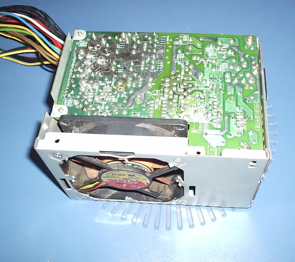

            the back of PCB:
            obviusly, when the fan died, the middle area was burning hot.
            the dark/shadowed area on the left is fine, it is a thick shiny solder trace.

              (incomplete) list of its caps:

                  As I said in the Power supply build pictorial, the little extra connector is for a internal battery, these psu's were used in HP Vectra vl600's, and they could have a small internal back up battery that connected to that connector and another that connected to the motherboard.

                    • Krankshaft
                      • Jan 2007
                      • 2328
                      Re: Delta DPS-125EB-1 120W PSU
                      What's that transformer shaped object for in the Delta EMI supression??
                      I've never seen one of those in PSUs in the US unless it's just a choke in a different package.
                      Like this:
                      http://wpcontent.answers.com/wikiped...ommon_mode.jpg
                      Which I have seen in many PSUs before.
                      • linuxguru
                        • Apr 2005
                        • 1564
                        Yup - it's probably a PPFC choke, which I've seen on several PSUs.

                          Sorry to resume such an old thread but I have a question about this PSU: I have one DPS125EB A and I can't start it with the jumper between green and black wire as usual.
                          Is there something more to turn it on?
                          The 5V stand-by is working and if I not wrong I tested this PSU in the past.
                          I have a doubt about a small connector with 3 wire: 2 are black and the central is green. What kind of connector is this one?
