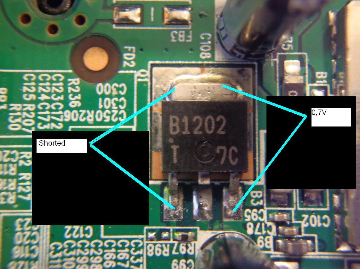

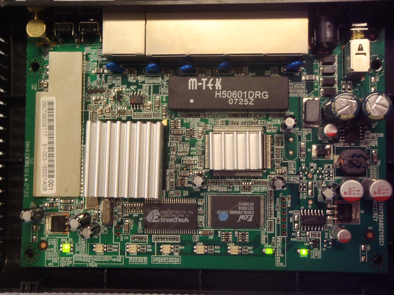

    Good morning,
    I´m trying to fix a Zyxel P-320W wireless router for a friend, his description of the fault is that the wireless connection is very wacky. I´ve done a total recap since all the capacitor was of a bad brand (Jun Fu if I remember it right) but this didn´t solve the problem. However, I found one component inside which seems broken. It´s shorted between two of the pins and measures no voltage on the output. The input is 0,7V. On a identical circuit on the PCB I measure 0,8V and 1,5V between ground and pin 1 respectively 2.
    Please see attached pictures. Anyone that can suggest what replacement component to order? There are MANY different transistors to choose from and this is not my speciality

    You should remove and measure it out of the board, but a 2SB1202 or 2SB1203 could be used.
    The wireless don´t work, works with weak signal, or works-stop-reappear-disappear, cycling ?

                  Re: Zyxel P-320W with bad component
                  More like works-stop-power cycle-works for a while. But I´m not 100% sure.
                  I´ve measured the transistor out-of-circuit now and it´s completely dead, no contact whatsoever between pin 1 and 3.
                  I´ll try to locate a new one, let´s see how it goes
                    Found one at Digikey
                      If it is working fine for a short period of time but then power-cycles, I doubt that transistor is the cause of the problem - if it was shorted, the router likely wouldn't work at all. I'm more inclined to think that the small caps around it are the cause of the problem. What brand and series are they? If they are not from a well-known Japanese brand, I think it would be a good idea to change those as well.
                        They are all Ruby's, changed them a while ago from Jun-Fu.
                        I´m also a bit confused whether this transistor actually causing the problem but that´s the only broken component I´ve found so far. Let´s see what happens after I replaced it.
