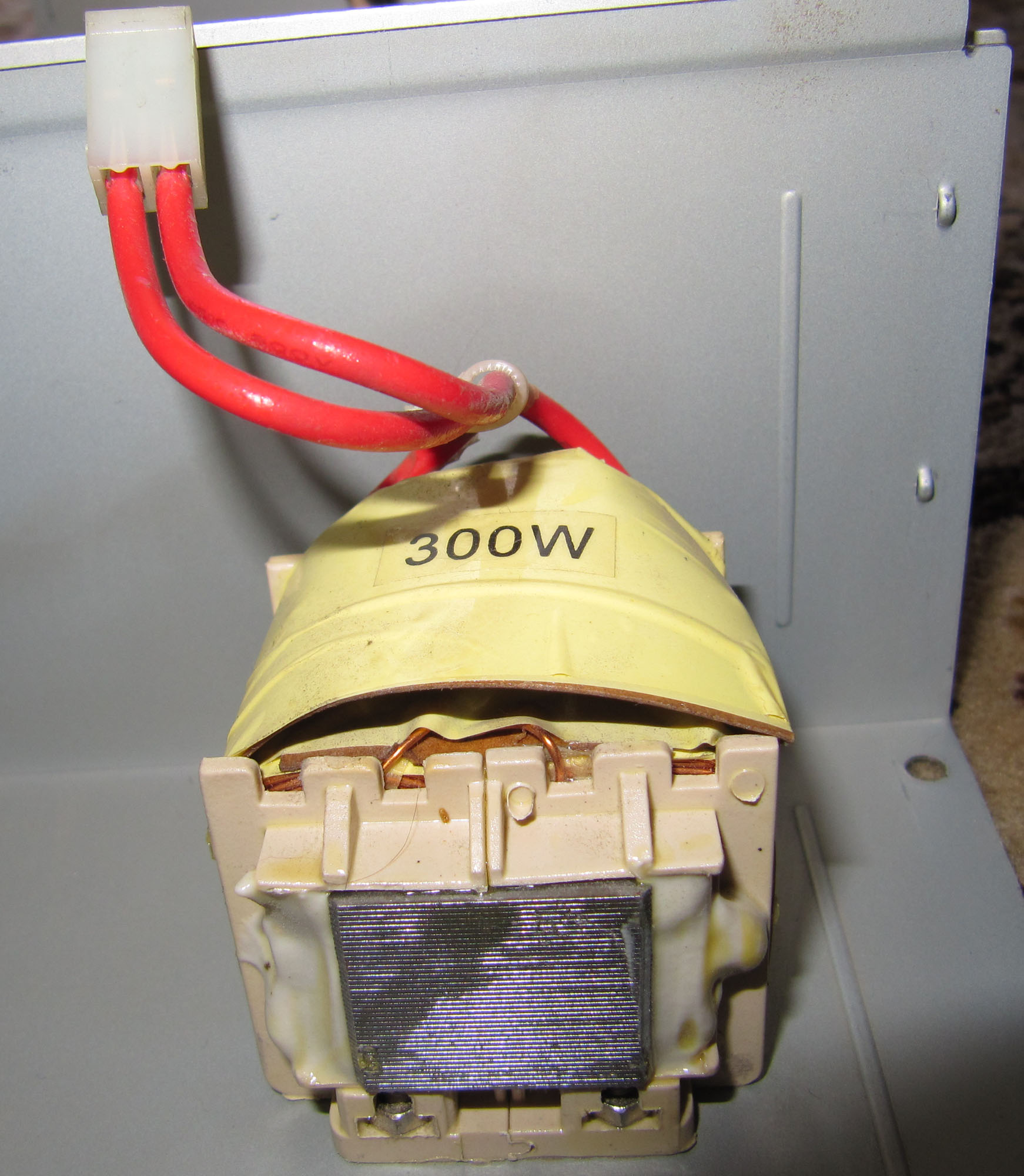

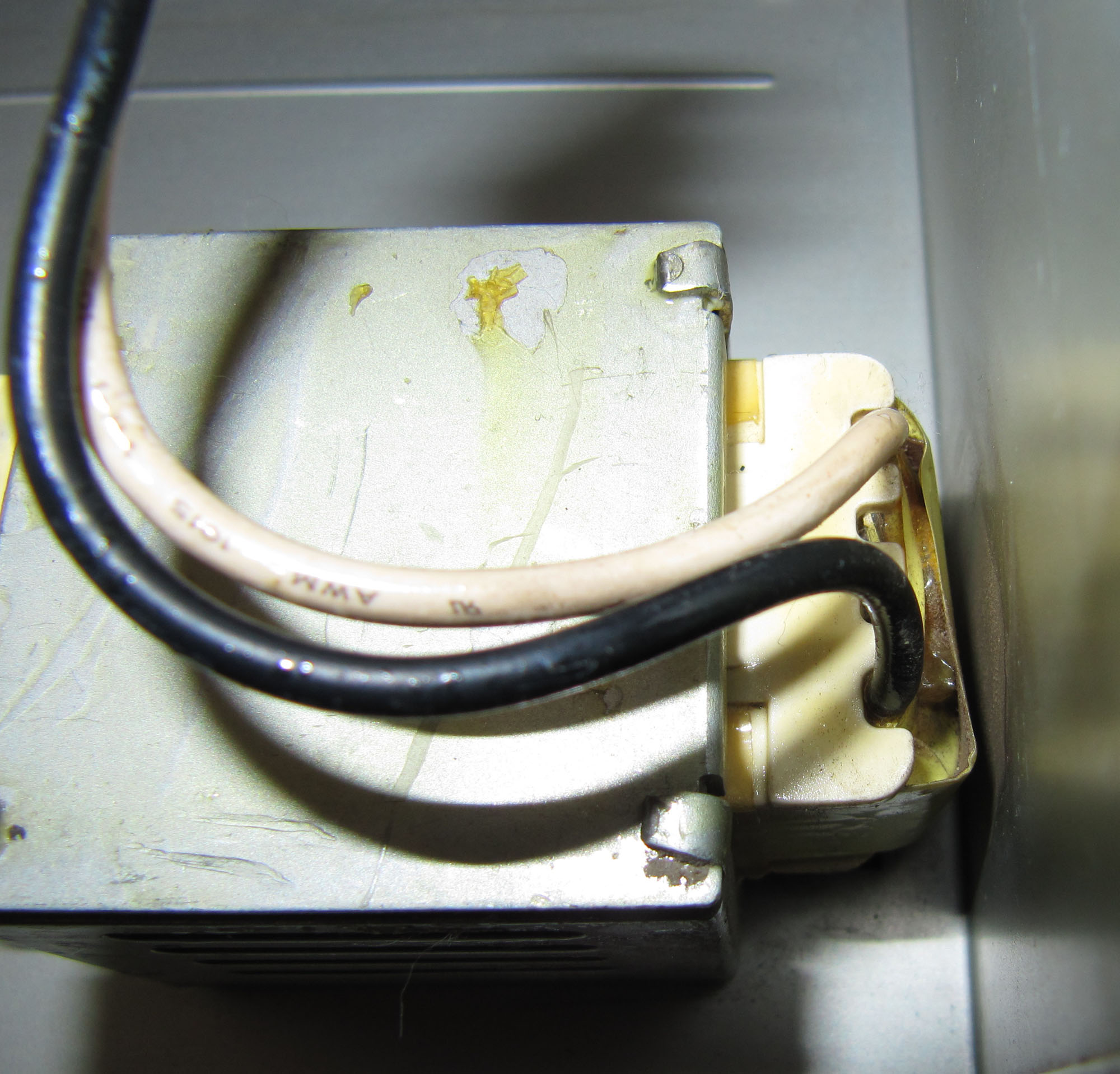

Same model, different PPFC chokes. Are they real? (MPT-350P)
  • goodpsusearch
    • Oct 2009
    • 2850
    • Greece

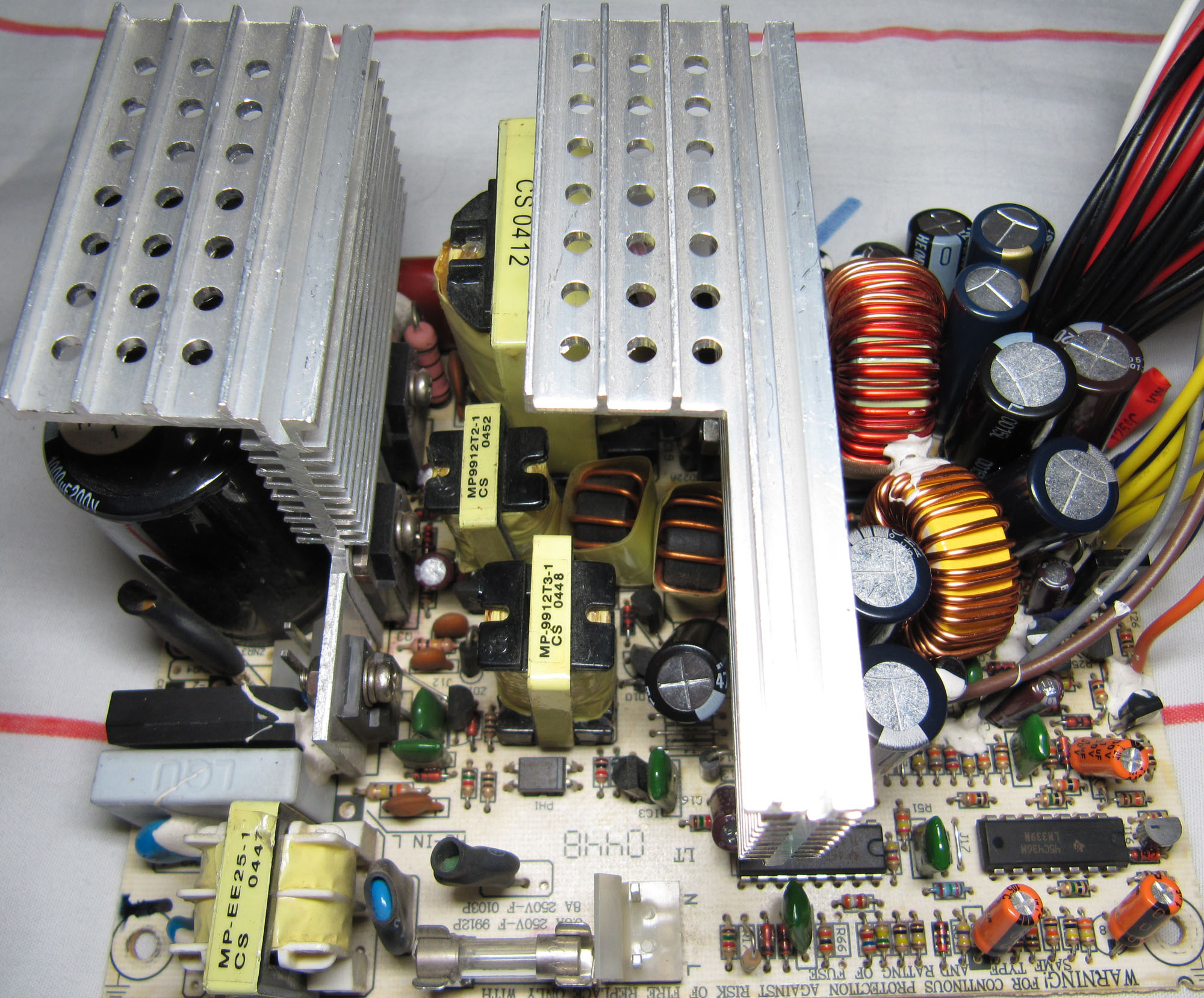

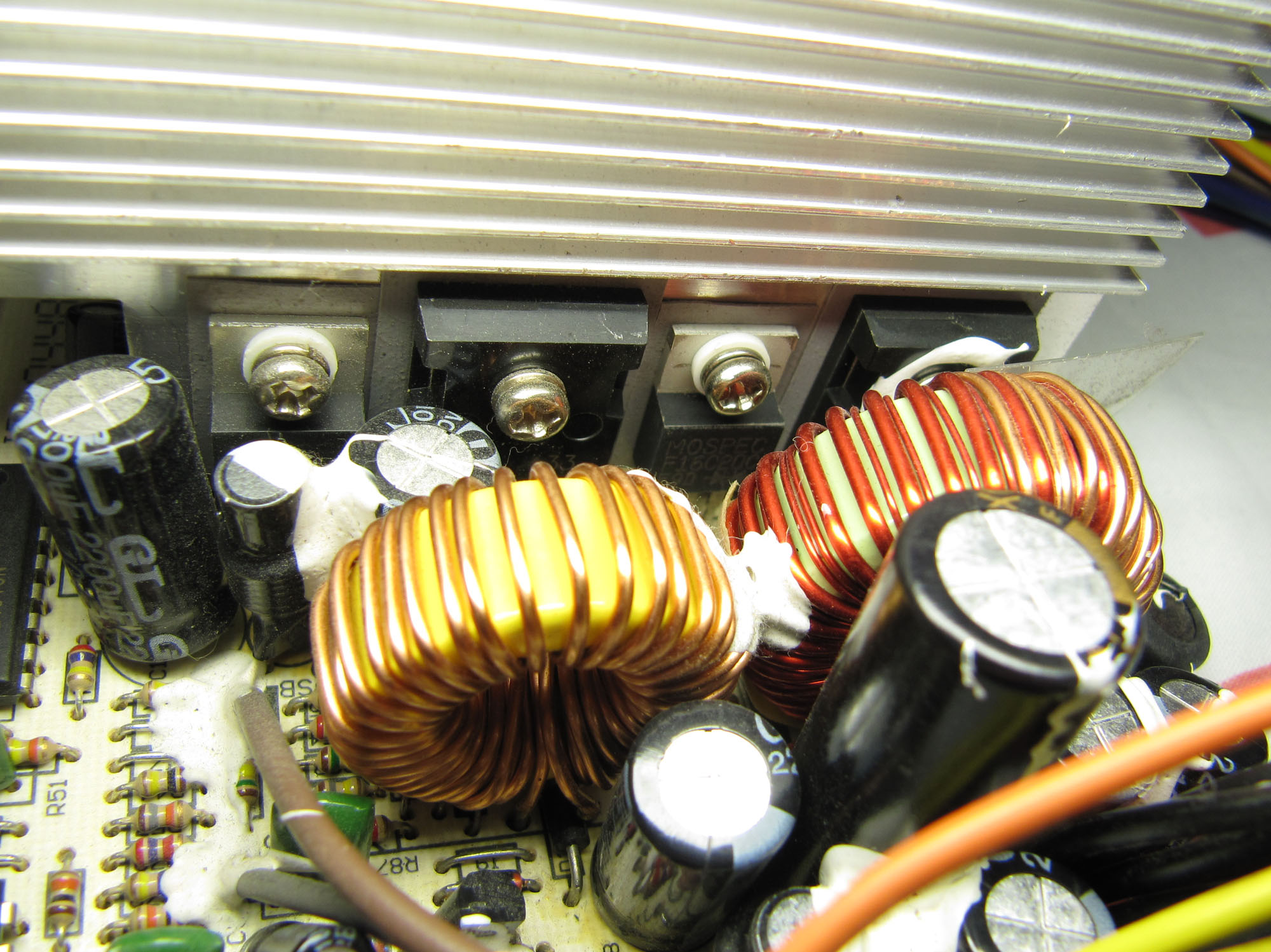

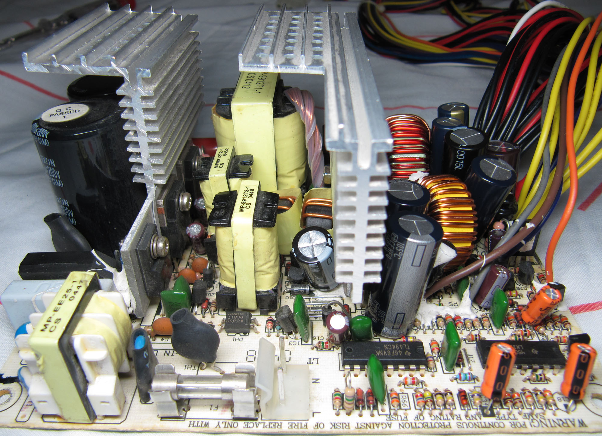

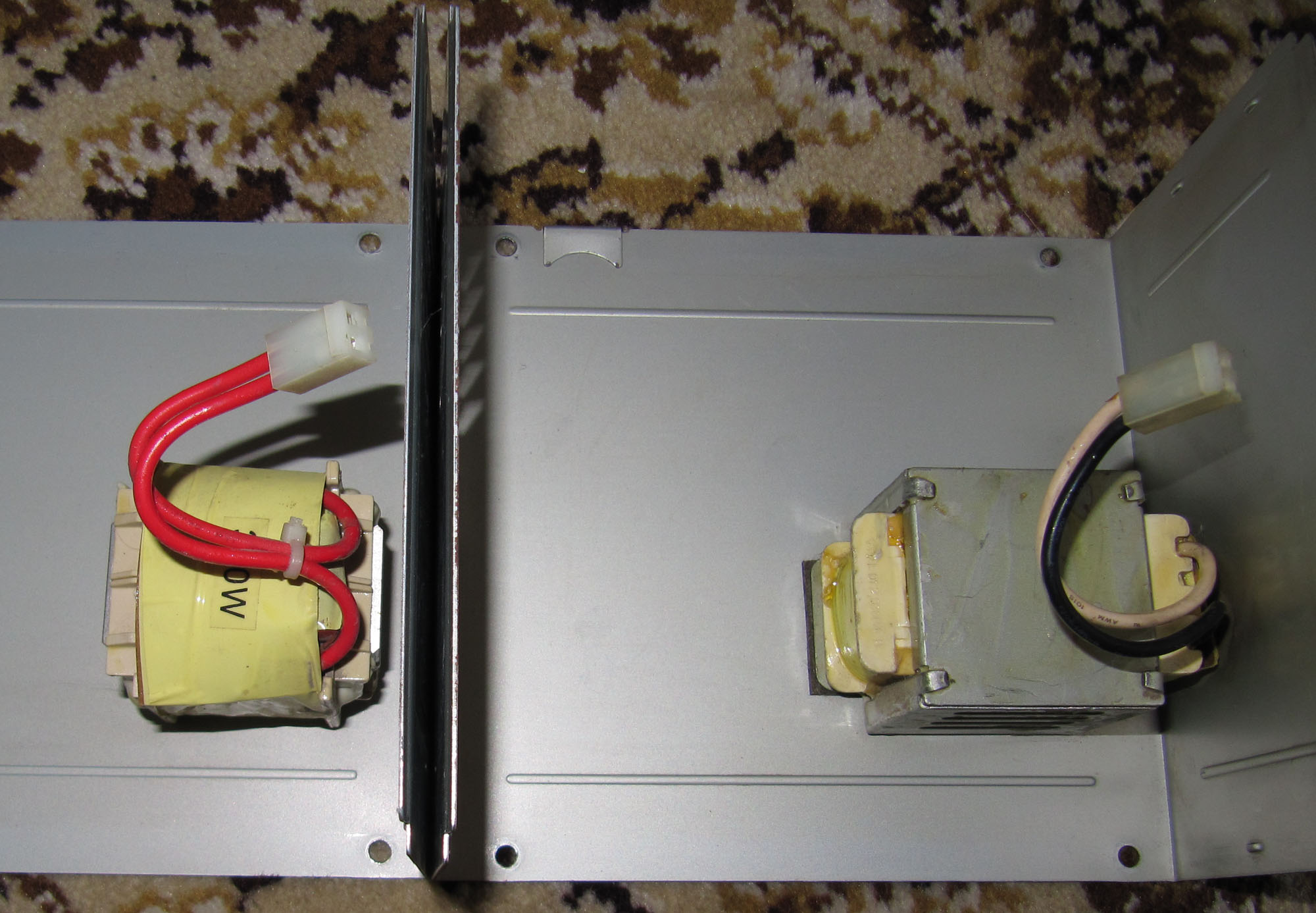

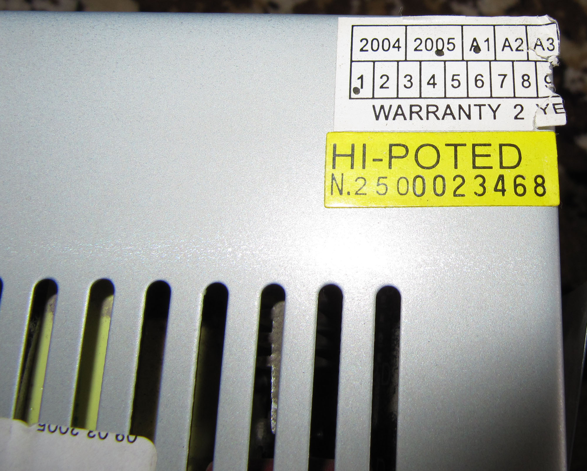

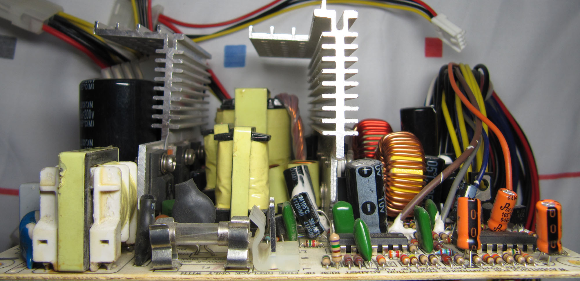

    The power supply is Macron Power MPT-350P. I already had a 2004 model and now I got another one made in 2005.
    There are some differences between them and one of them is the different pfc chokes. Are they real?
    If they are not fake, which one is the best?

    Re: Same model, different PPFC chokes. Are they real? (MPT-350P)
    They both look real - I can see some coil wire in them. I'm guessing the one with black and white wires is probably better, but the only way to know is to try a PSU with both of them and see which one gives you a better power factor.

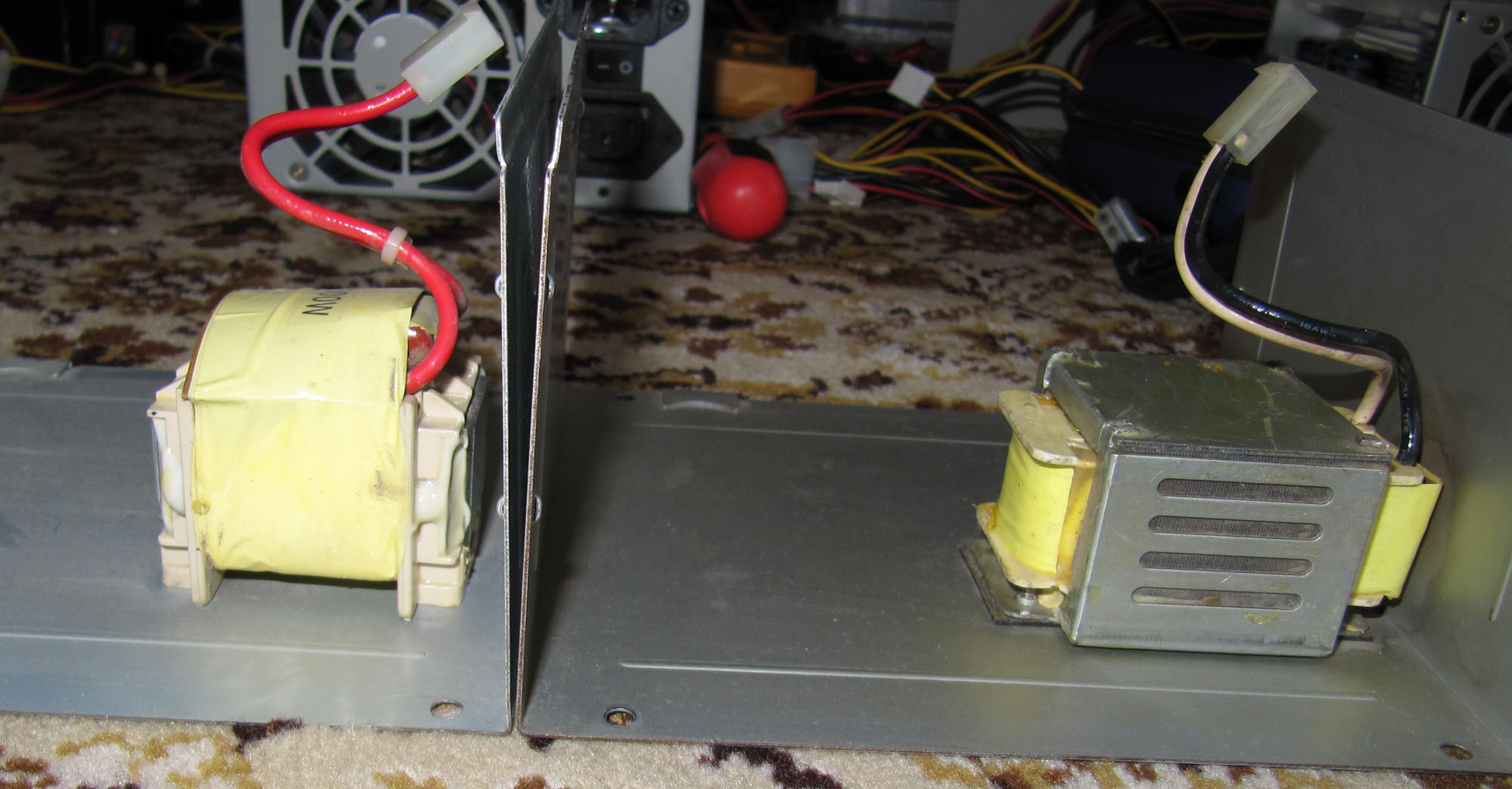

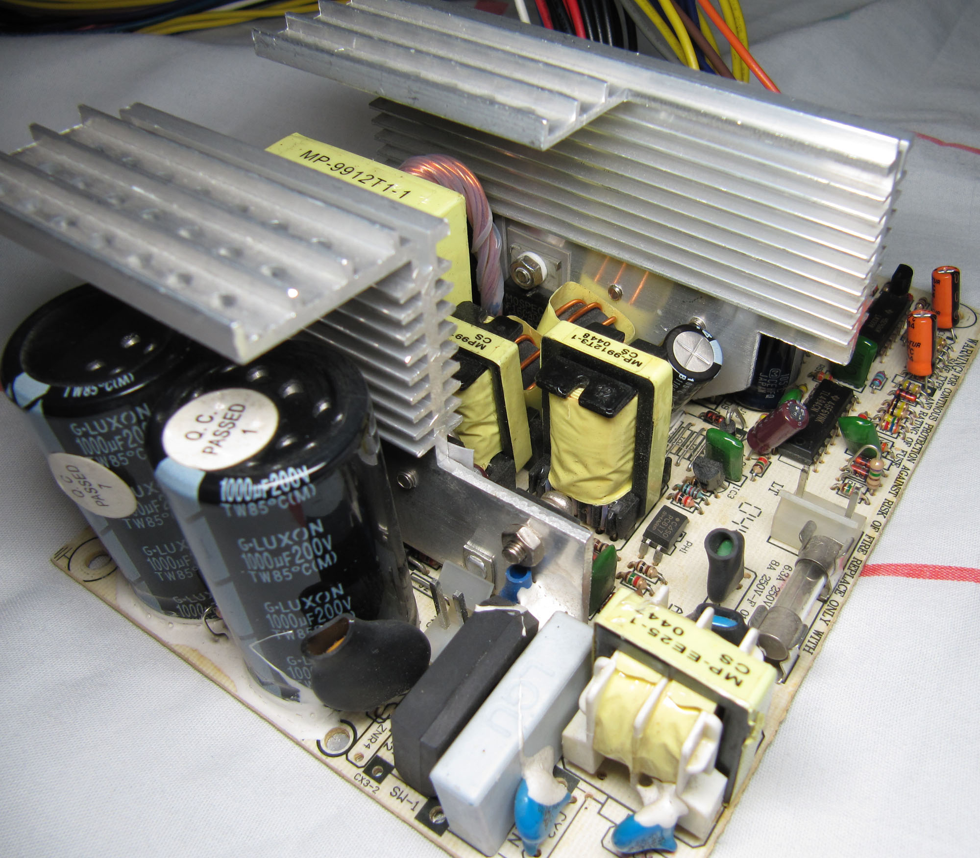

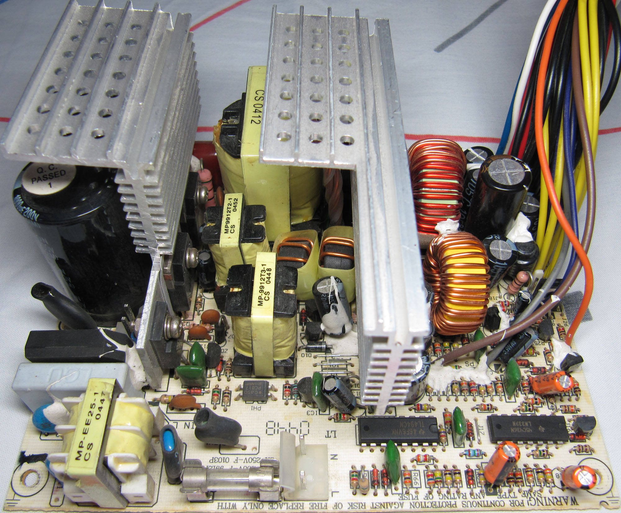

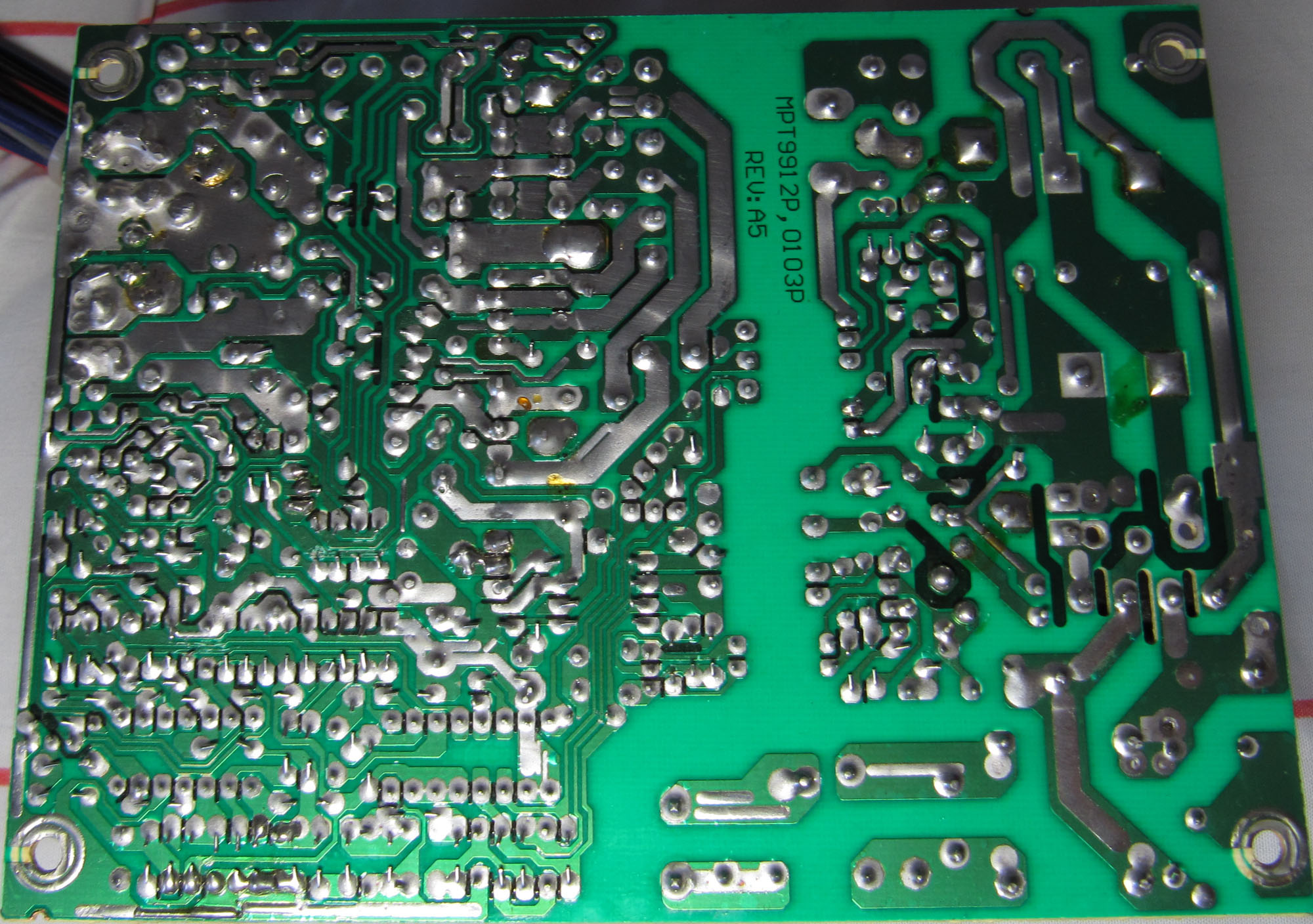

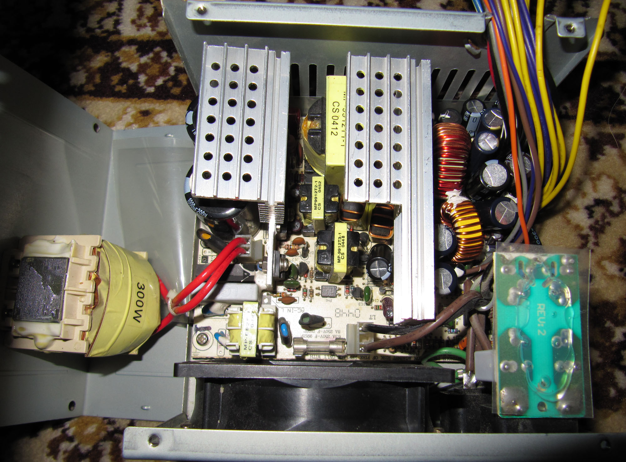

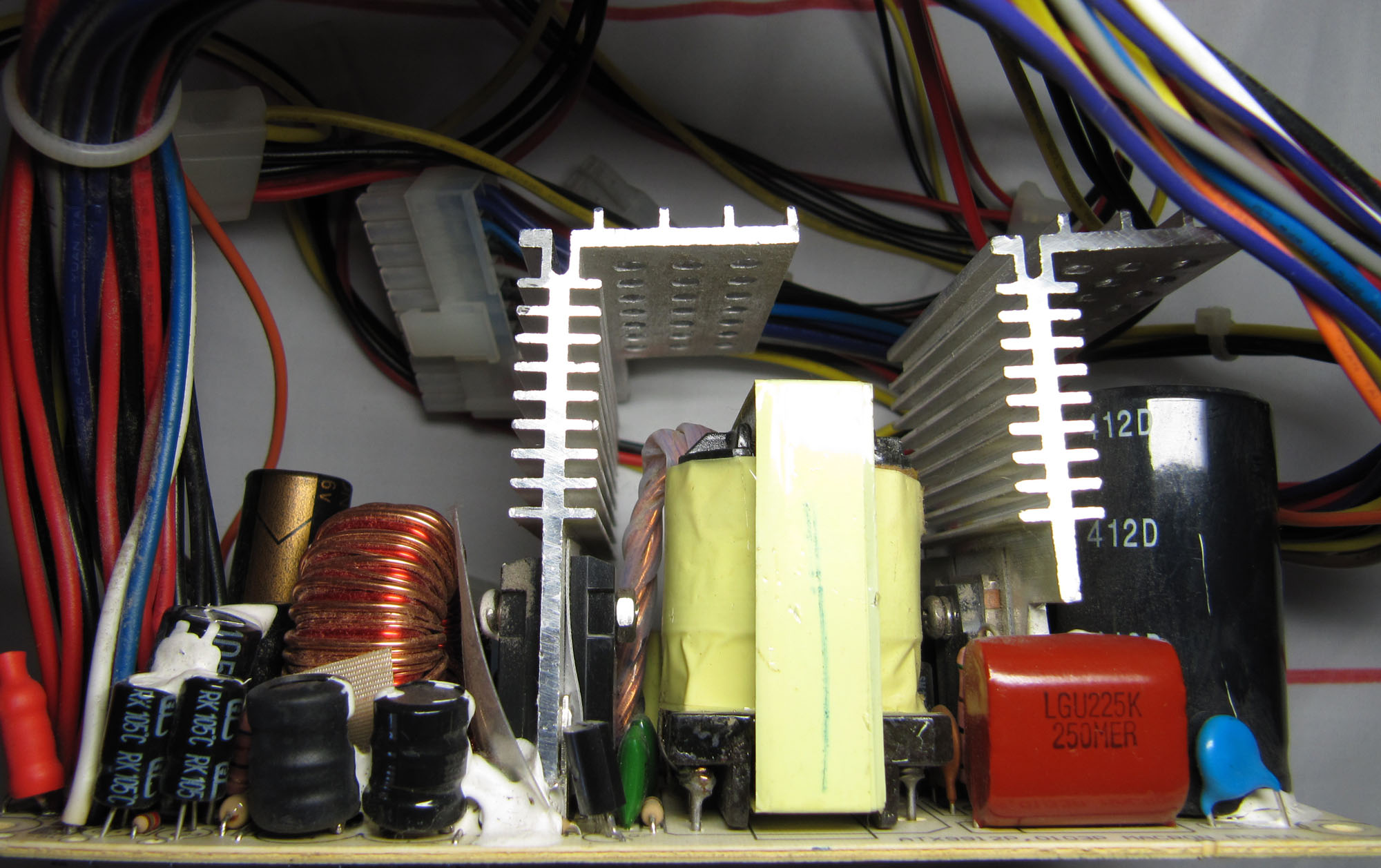

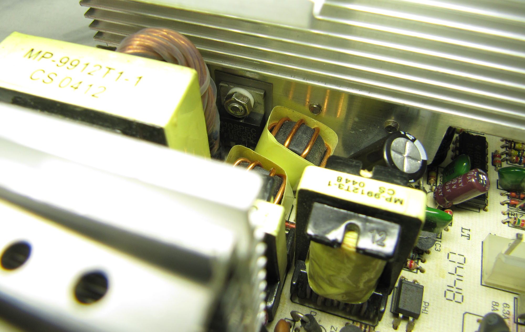

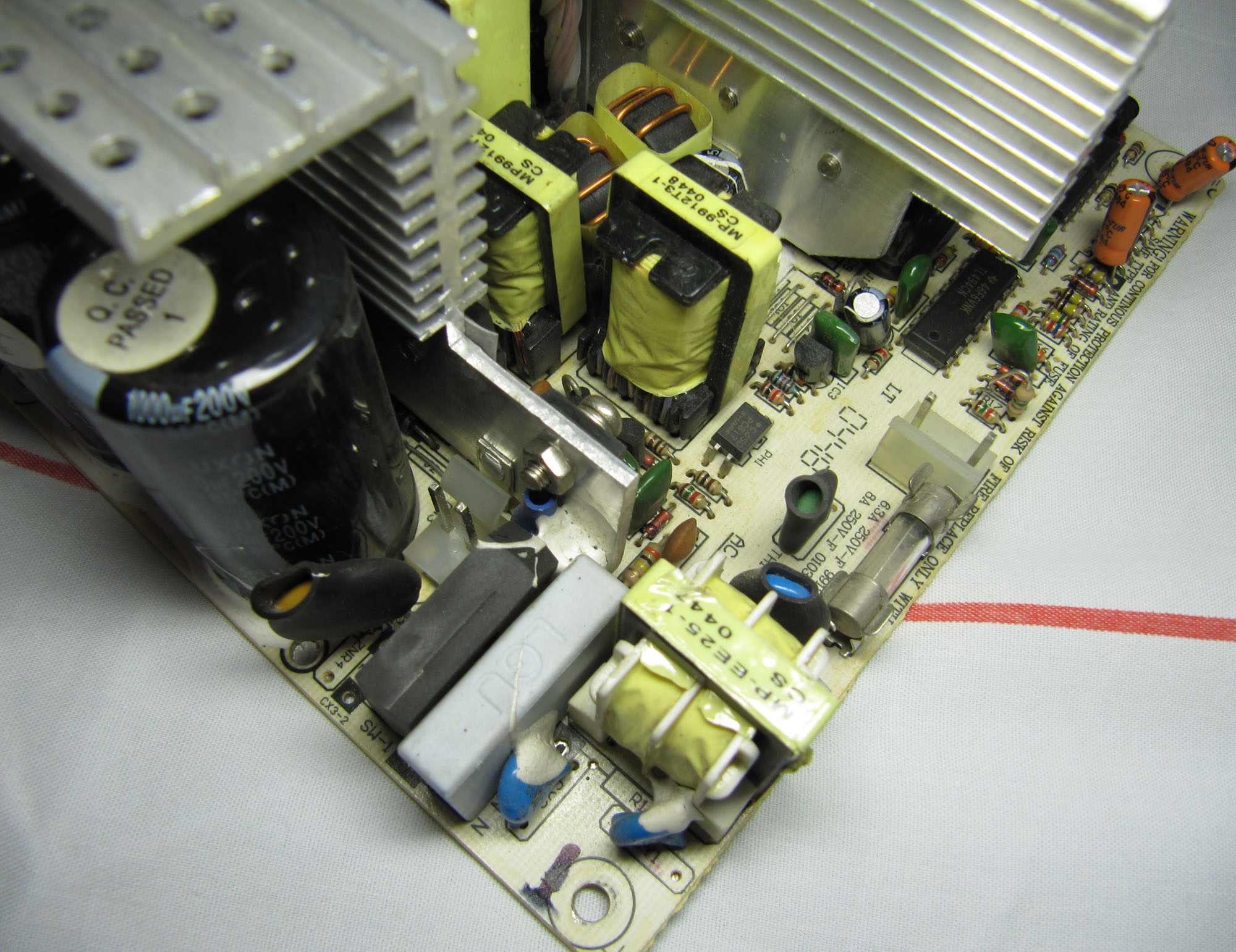

      More differences
      Thank you! Another difference between the 2 models is that the 2004 one has 18AWG wire except the 12V connector for the CPU being 20AWG.
      The 2004 model also has the ancient AUX connector. The 2005 model includes a 20+4 ATX connector and every wire is 18AWG.
      One last difference is that the primary caps of the 2004 model are Fuhjyyu 1000uF while the 2005 model has G-Luxon 1000uF primary caps that are slightly smaller that the Fuhjyyu caps. And that of course has an impact at capacity:
      Fuhjyyu capacitors were found to be 1000uF caps while the G-Luxon caps' real capacitance was only 909uF

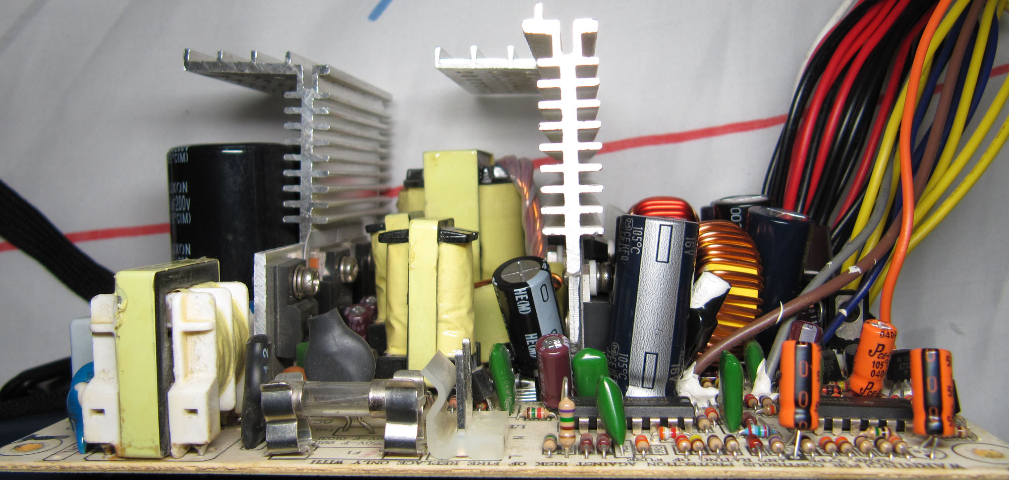

      I attached some photos. I am tempted by the idea to replace the 12V rectifier (F16C20C) with something bigger. Will it make any change? What do you think?
        For what it's worth, i've seen Fuhjyyu primaries bulge, so... I wouldn't trust'em either way, even if they measured ok. Like C(r)apXon, they're BOUND to fail (sooner rather than later).
        And about the G-Luxon measuring a bit low, electrolytics have standard +/-20% tolerance, so it would still be in spec anywhere between 800uF and 1200uF

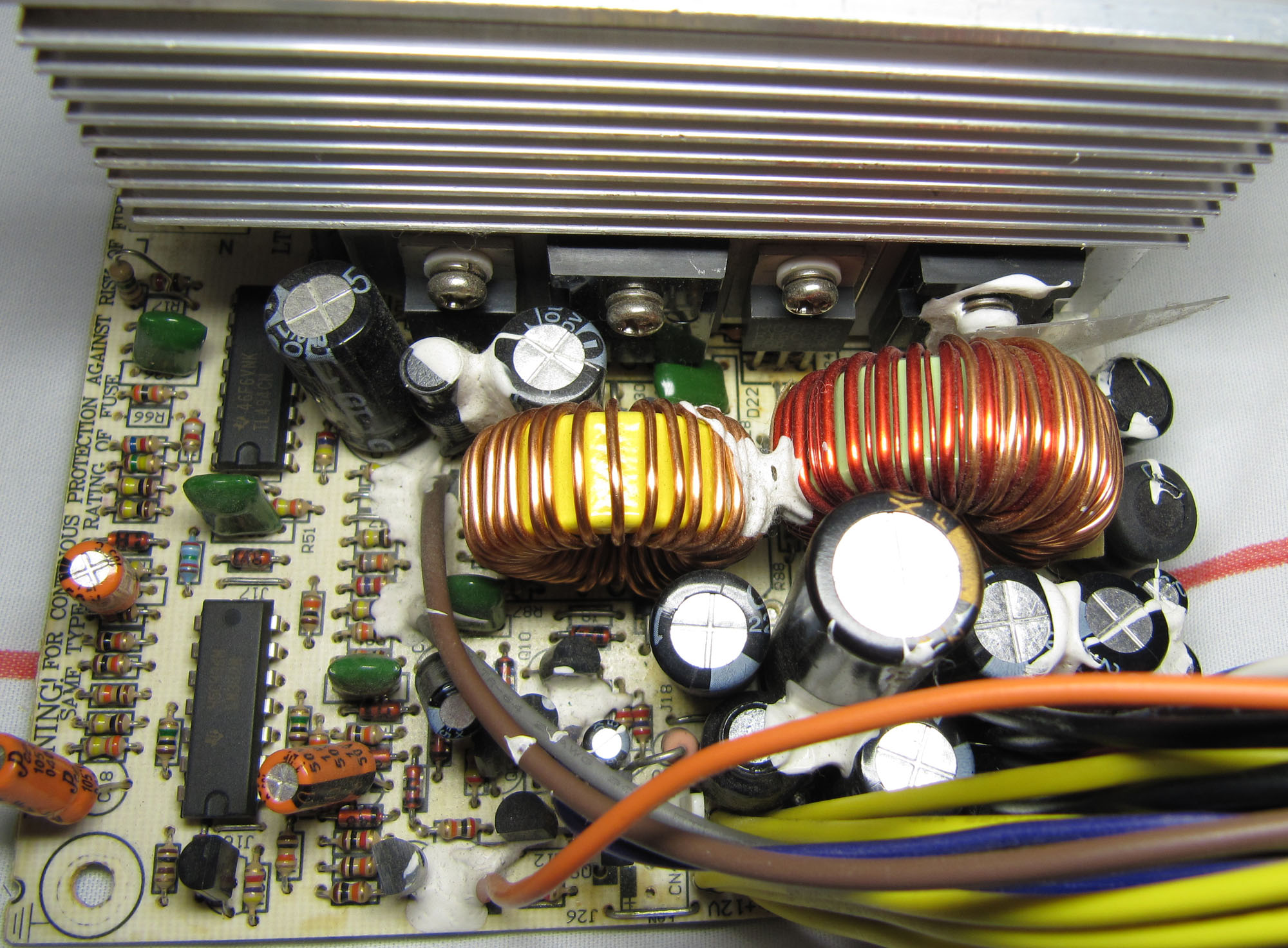

              There is an empty place for a second 12V rectifier on PCB.
              I can use the following parts from dead power supplies:
              MBR20100CT
              F12C20C
              F16C20C
              I can't decide which of the following I should do:
              -replace existing F16C20C with an MBR20100CT (20A)
              -replace F16C20C with 2xF12C20C (24A total)
              -add a F16C20C in parallel with the existing F16C20C (32A total)
              How many Amp do you think this psu could provide on the 12V?
                Go with option 3 (adding the 2nd F16C20C). Even if you aren't loading it to 32A, they will be more efficient when not heavily loaded. The PSU would probably handle 20-25A OK
                      Actually, the MBR20100CT by itself may be just a tad more efficient because it's a Schottky rectifier and has a lower forward voltage drop. (the forward voltage drop times the current passing through the rectifier gives you the power that is wasted as heat).
                      If you look at the typical forward voltage graphs for these rectifiers, you can actually tell how much power your be wasting as heat per given current draw.
                      Let's say we draw 20A from the 12V rail on the PSU.
                      - With the MBR20100CT, the forward voltage drop will be just a bit less than 0.85V - and that's worst case scenario. So for 20A, the rectifier will be wasting 0.85x20 = 17W as heat.
                      - With 2x F16C20C rectifiers in parallel, the forward voltage drop will be very close to 1V (each rectifier will be handling only 10A, so you're looking for the forward voltage drop at 10A). Therefore, each rectifier will be wasting 1x10=10W as heat, or 20W total for the two in parallel.
                      So, as you can see, the MBR20100CT is a bit more efficient. Now try repeating the same excercise for 10A and 5A of load. In each case, the MBR20100CT should be be more efficient.
                      There is, however, something else that's important too.
                      First, the 2x F16C20C in parallel will be contacting the heat sink over a larger area, so they may actually run cooler.
                      Second, the single MBR20100CT is limited to 20A of current. Beyond that, it will likely begin to produce a lot more heat and may eventually become less efficient than the 2x F16C20C rectifiers. Also, the 2x F16C20C rectifiers will be able to handle up to 32A of current. The rest of the PSU may not be able to supply that kind of current, but you're not limited to 20A anymore so that's also something to consider.
                      In the end, though, I think I too would recommend you go with the 2x F16C20C rectifiers just because the PSU looks like it may handle 20 to 25A fine.

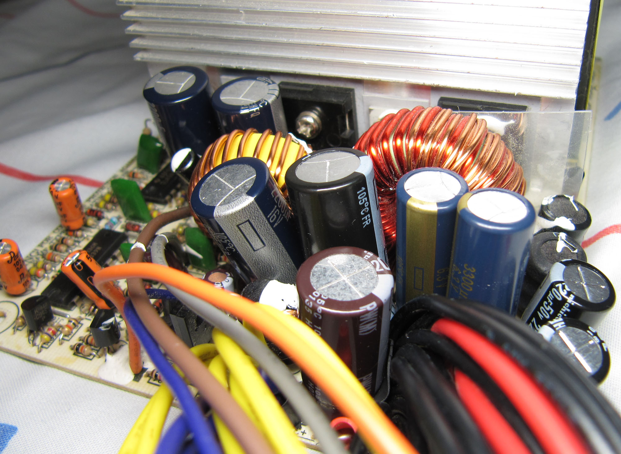

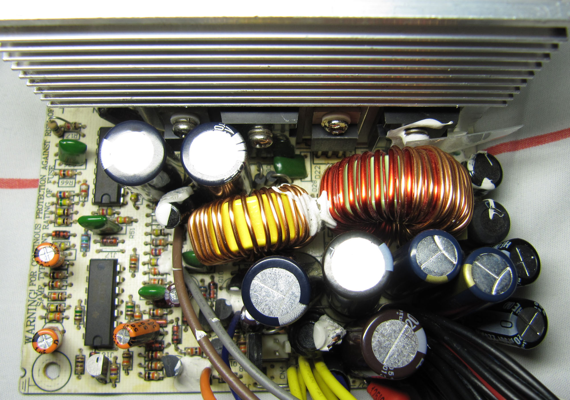

                          I did the replacement momaka and c_hegge suggested and everything works fine
                          I let the psu run fanless for some minutes and 10W load at 12V and the secondary heatsink remained cool.

                            That's a great source of info!
                            I did a full recap on that thing and now it powers an Athlon 64 3000+ without even getting hot and its fan remains fairly silent.
                            I did not change the orange 1uF caps and the primary 1000uF G-Luxon caps (too expensive).
                            2x1000uF 200V G-Luxon -> left alone
                            1uF 50V G-Luxon -> 1uF Nichicon PW 50V
                            3x1uF 50V Jpce-tur -> left alone
                            4x10uF 50V G-Luxon SM -> 4x10uF 50V UCC KY
                            1x470uF 25V -> 1x 470uF 35V Nichicon HE
                            +12V
                            1x3300uF 16V G-Luxon LZ -> 1x3300uF 16V Panasonic FR
                            +5Vsb
                            2x2200uF 10V GL -> 2x2200uF 16V Panasonic HFQ (from an old Intel PII motherboard)
                            +5V
                            2x2200uF 10V GL -> 2x3300uF 6.3V Panasonic FK
                            +3.3V
                            2x2200uF 10V GL -> 1x2200uF 16V Panasonic HFQ and 1x2200uF 16V Nichicon PW
                            -12V and -5V:
                            2x220uF 16V GL RK -> 2x220uF 50V Nichicon HE
                            It is very hard to fit 12.5mm diameter caps on those 10mm pcb spots.
